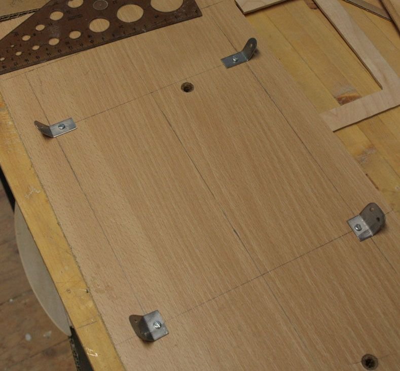

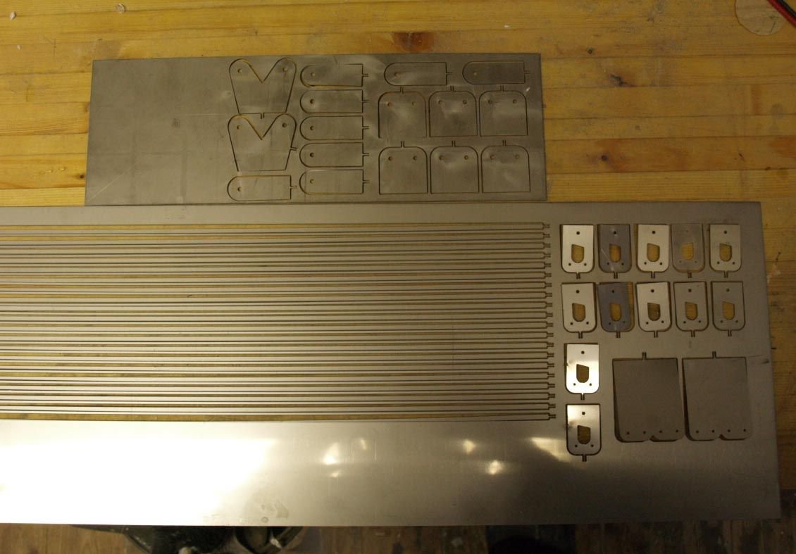

Here comes the ingredients for the gear
the basic-platte from the gear-box
First fitting
so is the theory
ad now it works
Currently, without solid bearing, it takes close to 1,5 A, sonds many but in the realassembly it is with ball bearings and so I`m sure that the runnng amps would be lesser.

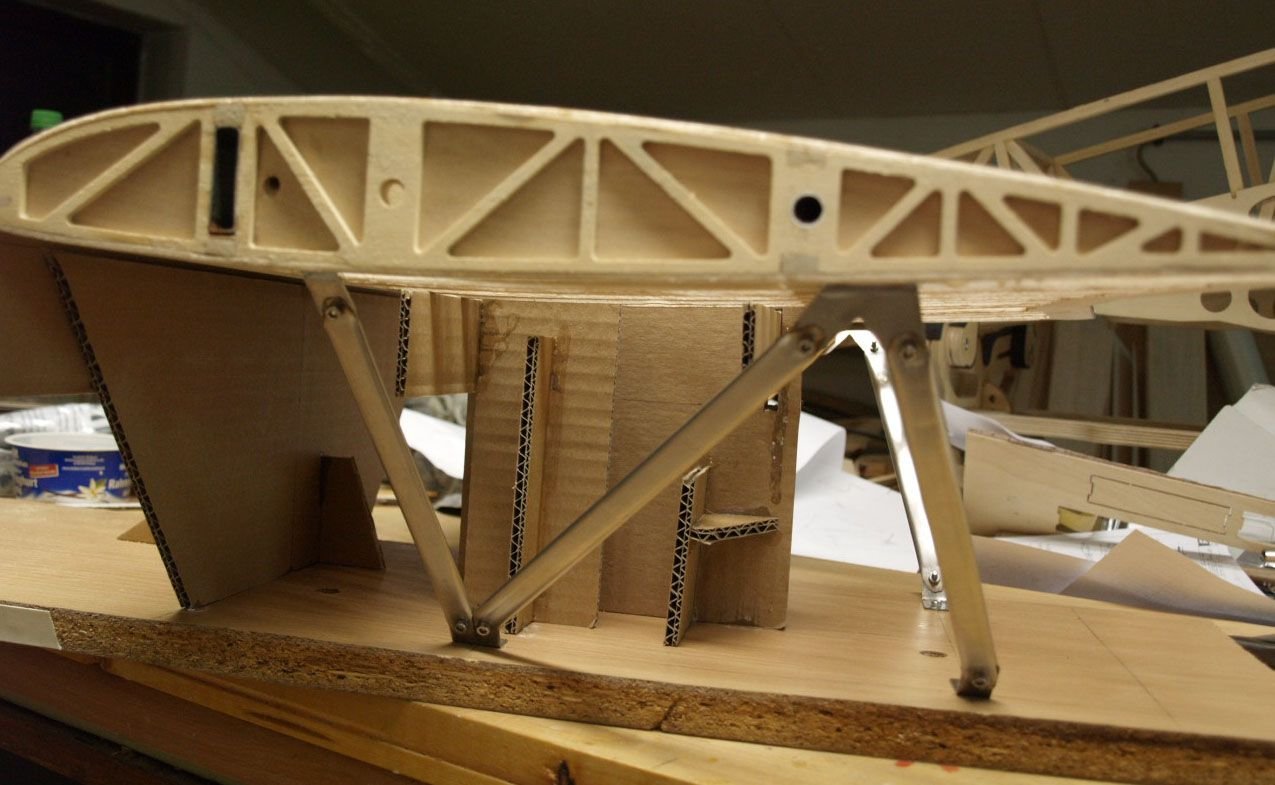

The next step was to build a "dummy-gear-leg" the shockadsorber and the gearstrutt.
it fitts as well
it fitts also to the template
and > well done
the wooden strip in the middle of the hull stays for the retrackting screw, I hope you see the principle.
So I sended the complete dummy to the "Gear-Maker"

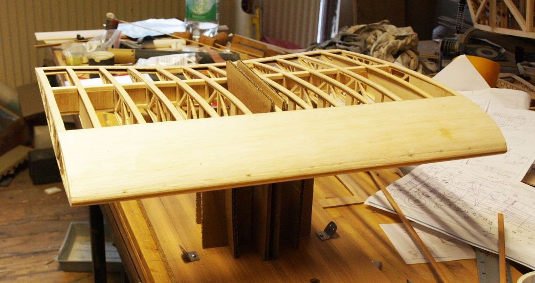

While waiting for the shockadsorbers, I worked on the tail.
The plan was, just like in the original aircraft, to realise a variable longitudinal dihedral
the next turn for the milling machine > here are the parts
build
the most important part, the tail boom
also build
the whole thing was to heavy so I`ve done some changes to save weight.
You can see the working screw,with this I can cange the setting angle of the tail.
Now it is completed.
and so with the elevator added.

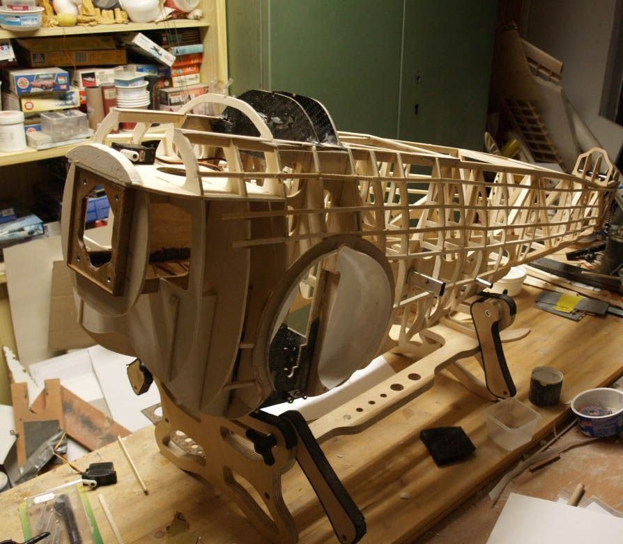

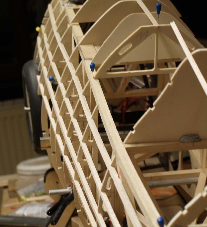

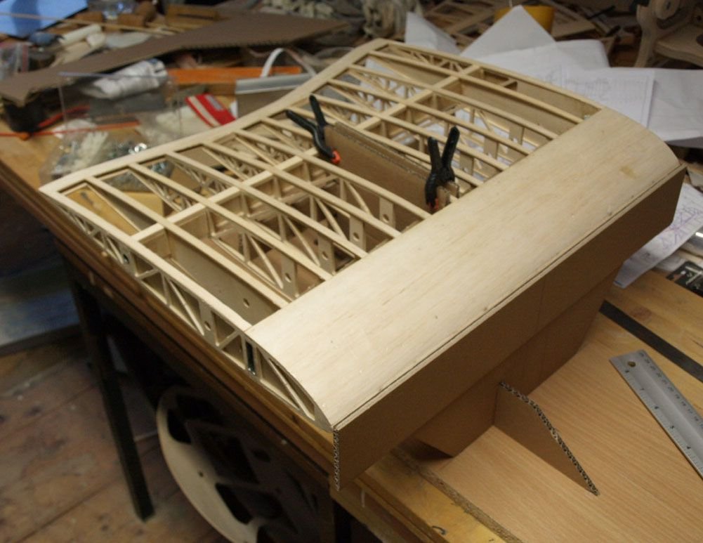

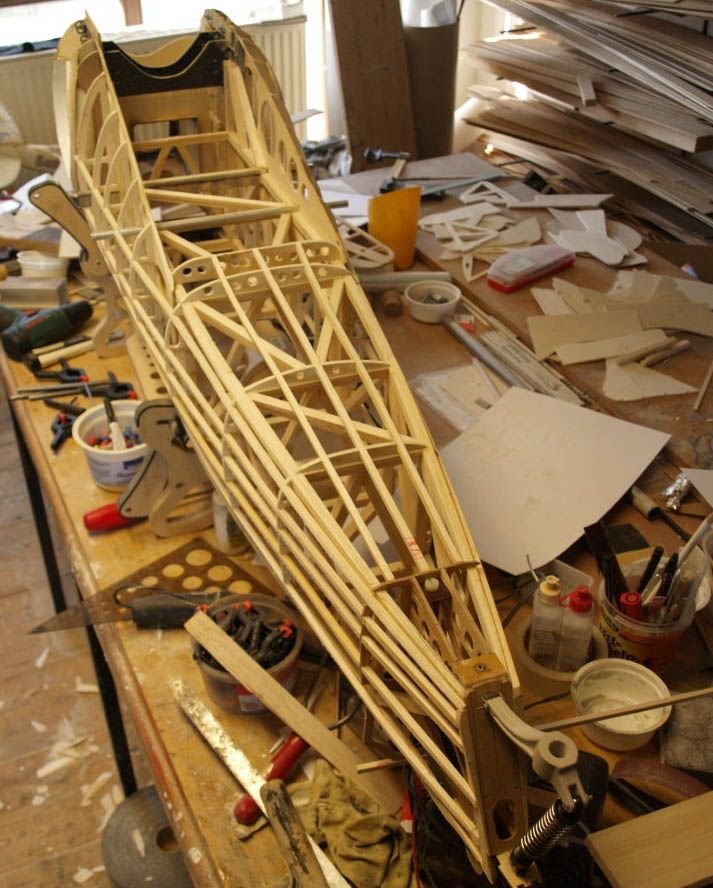

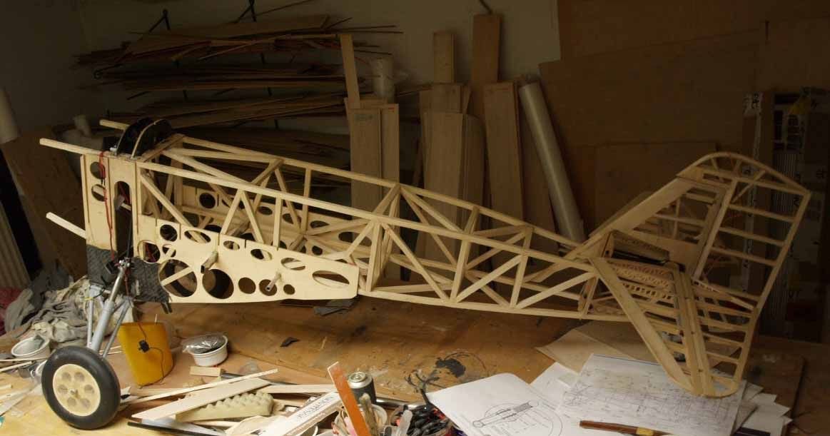

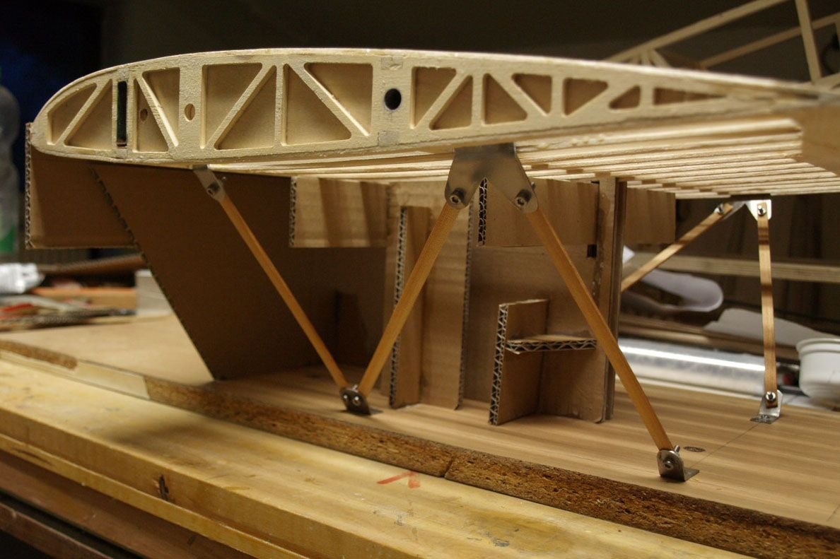

The next part is the hull. By starting this model, I decided to work so close as possible to the original structure. My first idea was to buildthe hull-structure also from stailess steel tubes. But, I canceled this.The reason is simple, if I replase the tubes with strips, a damage is very, very easier to repair than with tubes.
I started with build two ladders
and than,step by step, it looks like a half-timbered house, and, so it should do, light, but very strong

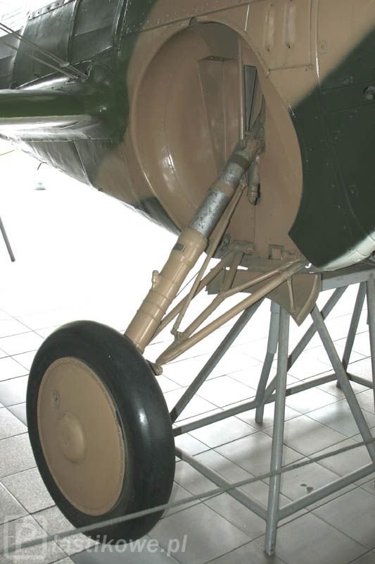

And than, Christmas Eve............. The parcel arrived when I was at work and my wife was the silence in person.
unpacked > the long, long awaited shockadsorbers.
Bernd Lieseke, from http://www.hawe-modellbau.de/ has done a very good job, he topped my concept and I`very, very happy
On the same evening I buld one leg in my dummy and it works as well and looks very good too.

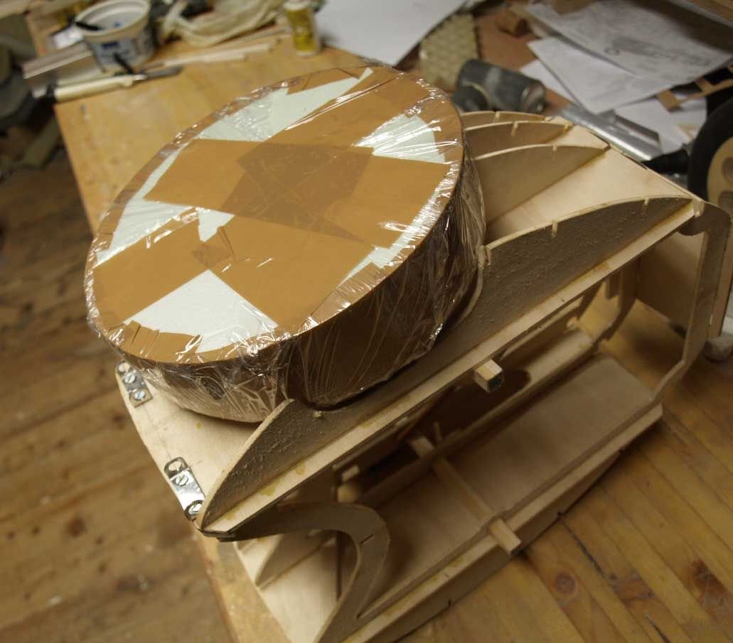

Currently I`m working on the wheels. It is very difficult to get the right wheels, with this big diameter an very tiny tyres. So I decided to make my own ones. Max Merkenschlaeger had done it years before (see the drawing) and here are the parts.
I also started with the lower bearing block of the retrakting screw.
I promise to update this tread in the future quicker.............

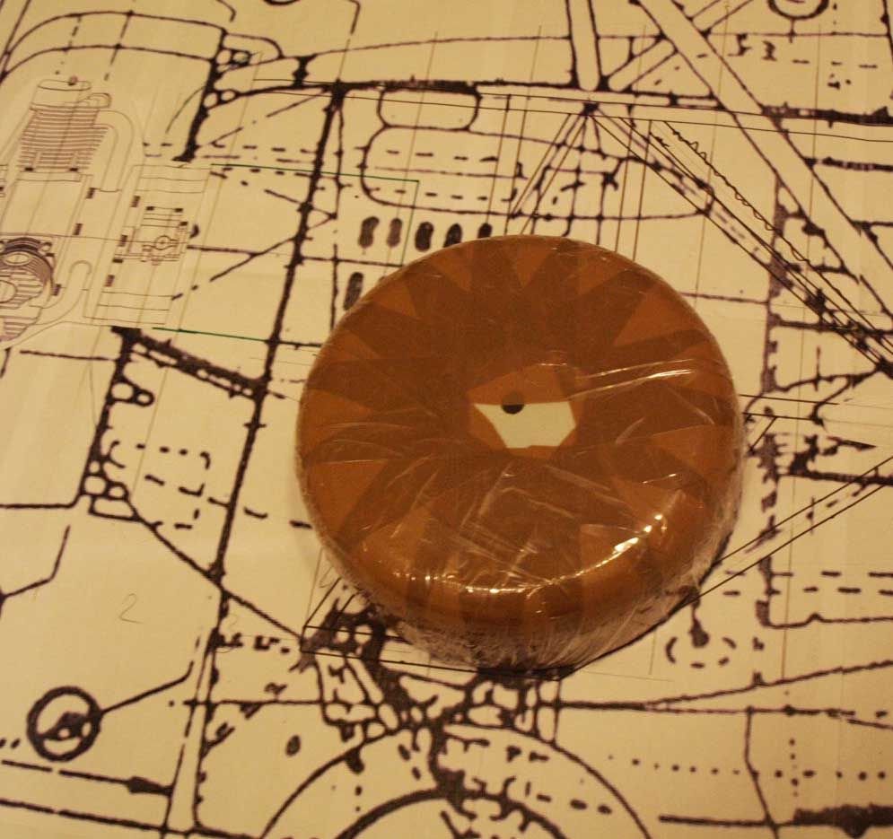

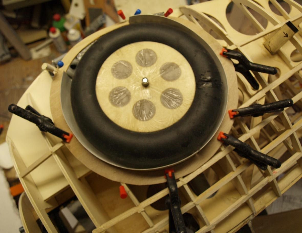

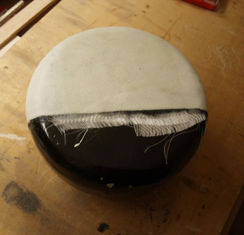

O.k., we continue with the wheels. Nowhere you can buy wheels with 185 dimerte whith 45 mm tires. You have to make them your self. The parts for the rims I had always shown, now I putted them together.
After some work on the lathe, the first wight control.
72 gramms are not bad but I drilled some holes an here is the result
20 gramms per wheel, 40 in summary, o.k.
Now the tires.
I use rubberstring (normaly the use this in big airconditiones as gasket), glued it to a ring in a template and here it is
The last step by the wheels was covering the sides with glasfiber.

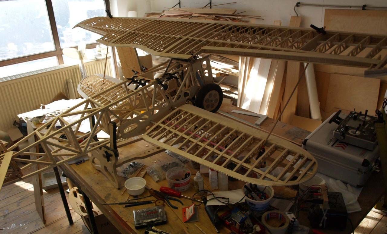

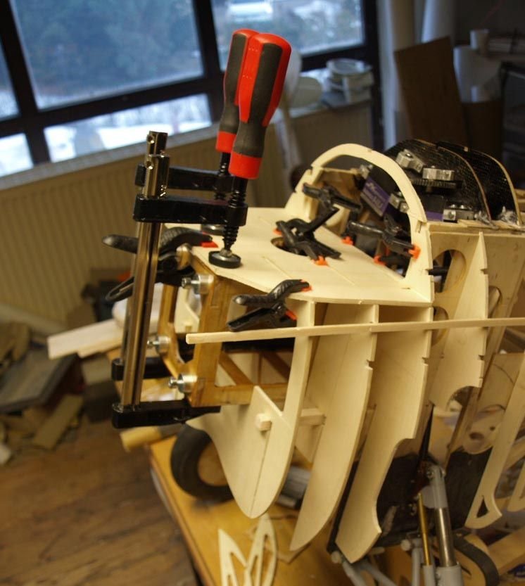

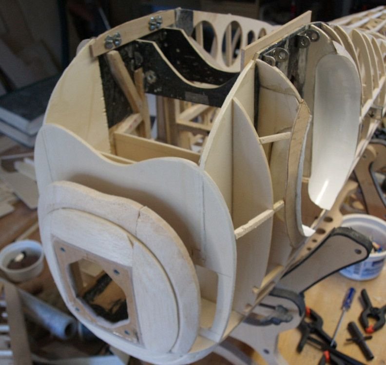

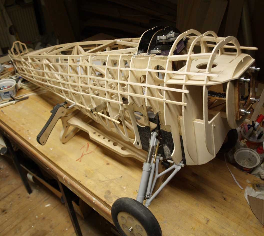

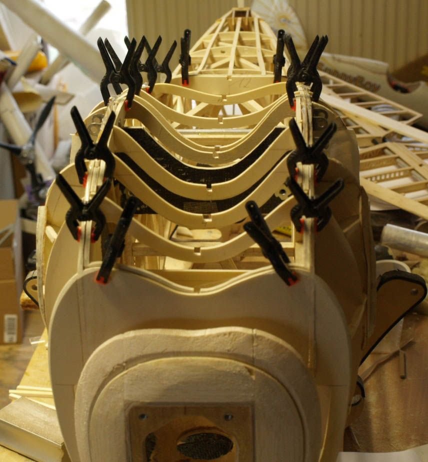

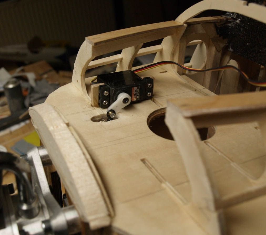

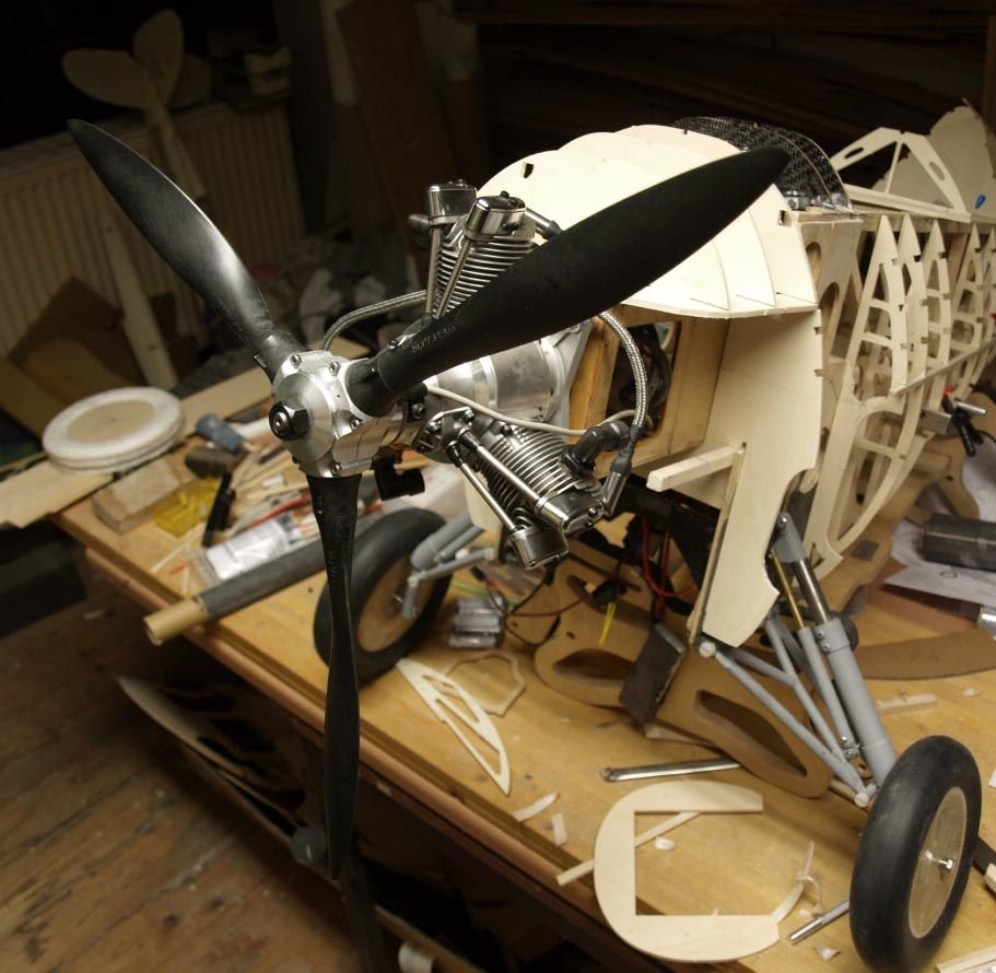

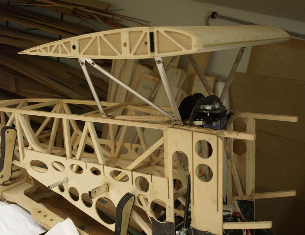

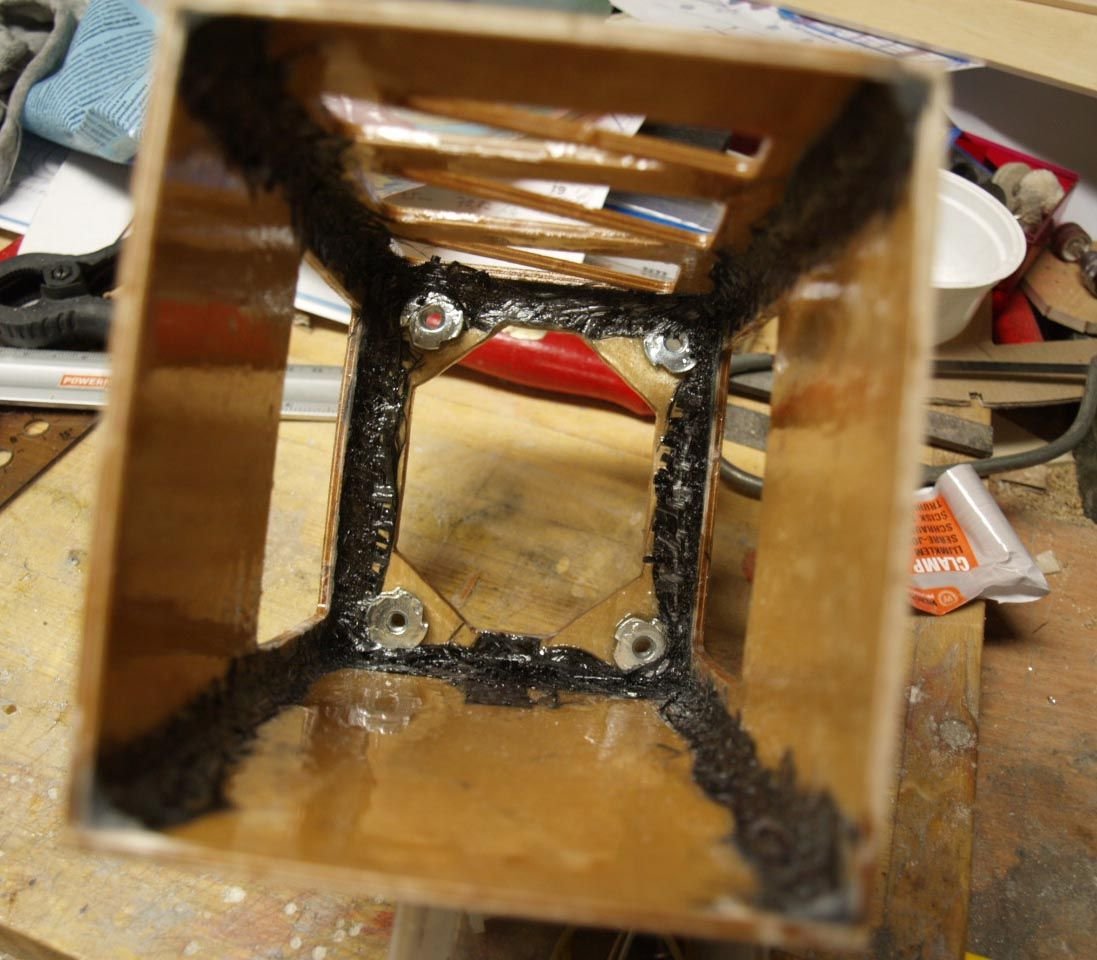

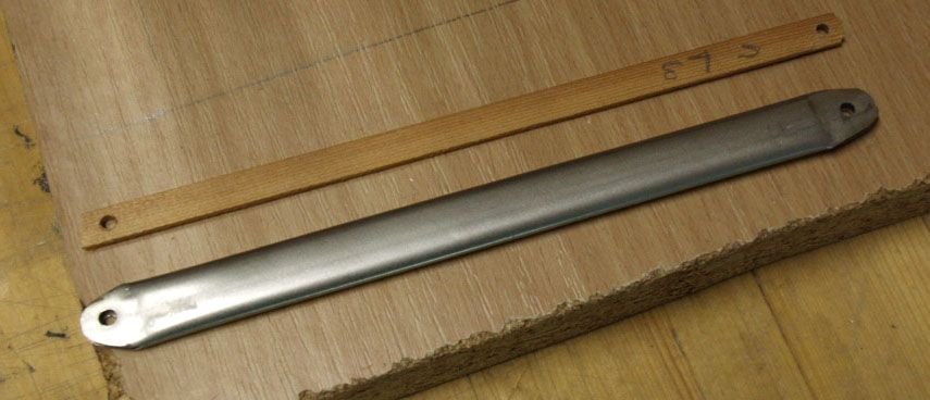

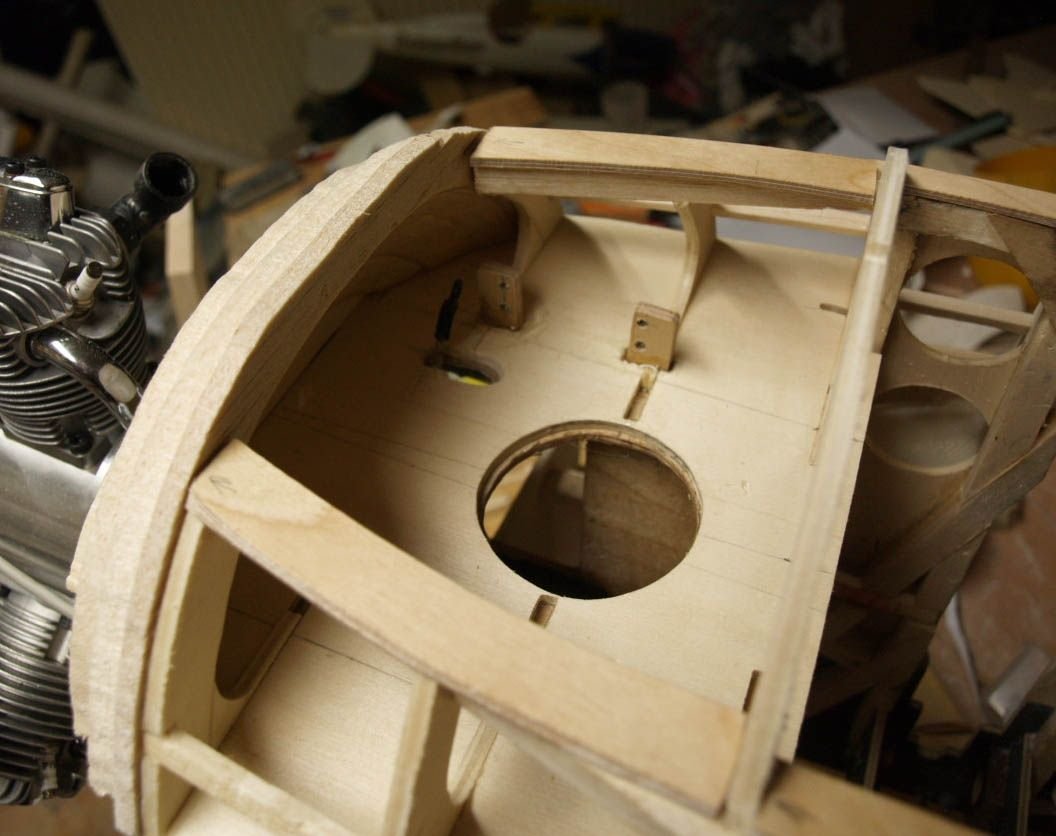

Now I continue with the fuse.

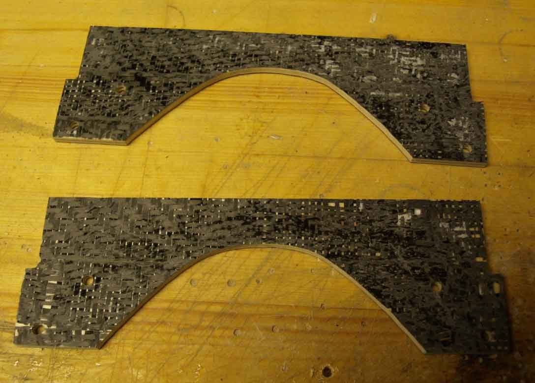

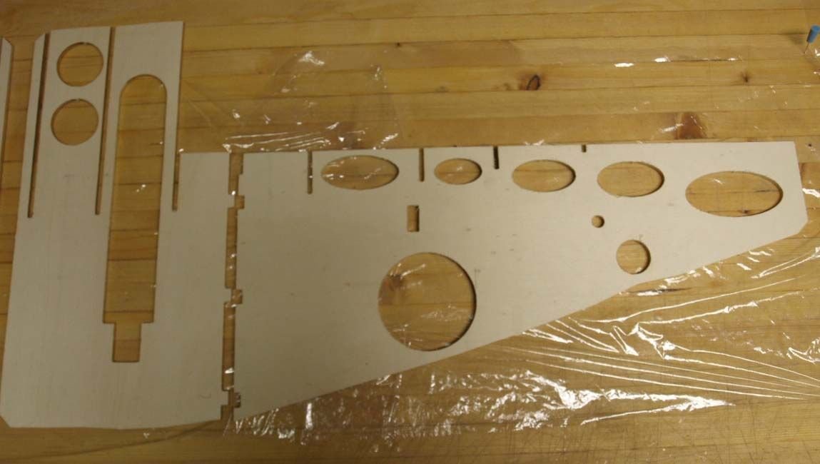

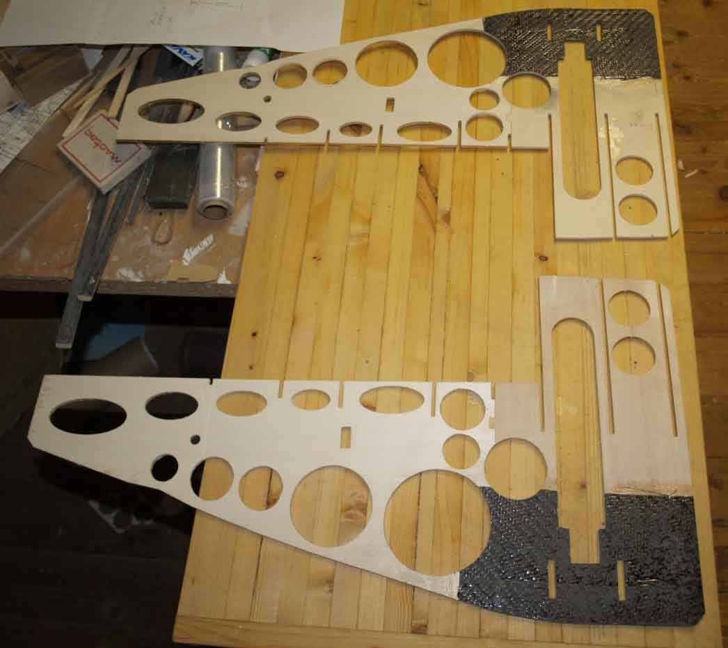

At first I hat to prepare the vertical decks. These parts are very important. They carry the lower wing and the landing gear.
The milling machine from my buddy wasn`t big enuogh to make it as once so he did it in two parts.
I glued them together and they are covered with carbon fiber.
As next parts I cutted the gear bridges from carbon fiber covered plywood.

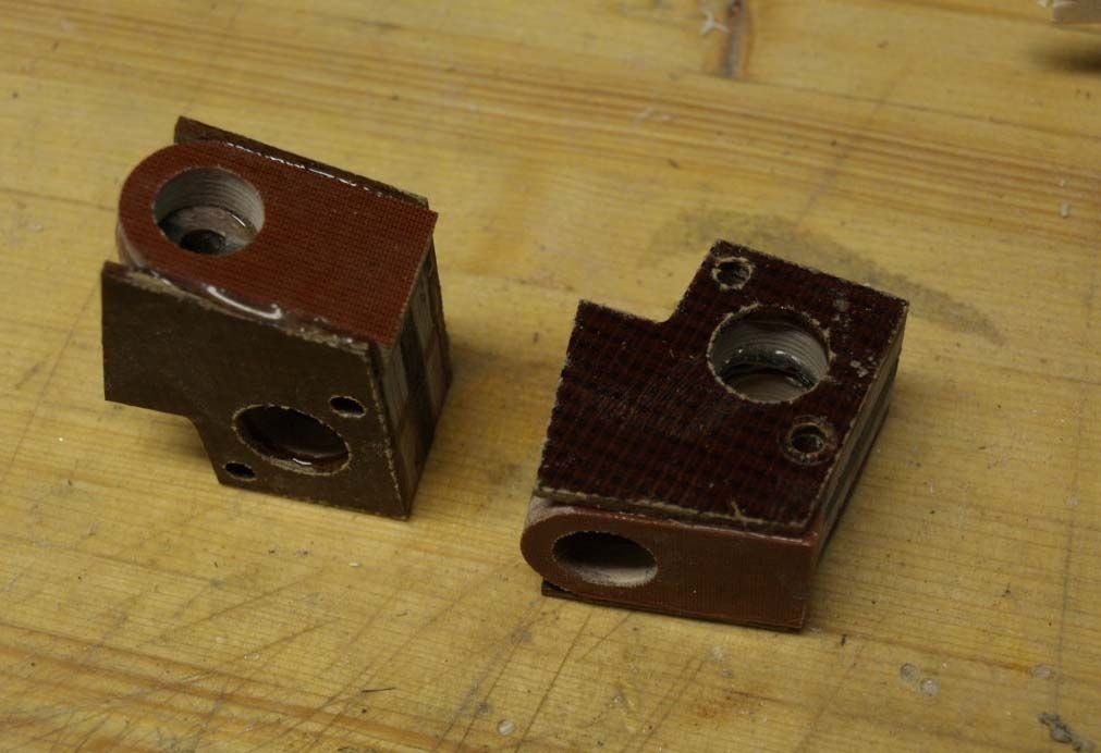

Now I need two bearing blocks, they fix the screw spindles. The parts are cutting fromn "Novatex", light, solide and easy to work with.
assambled

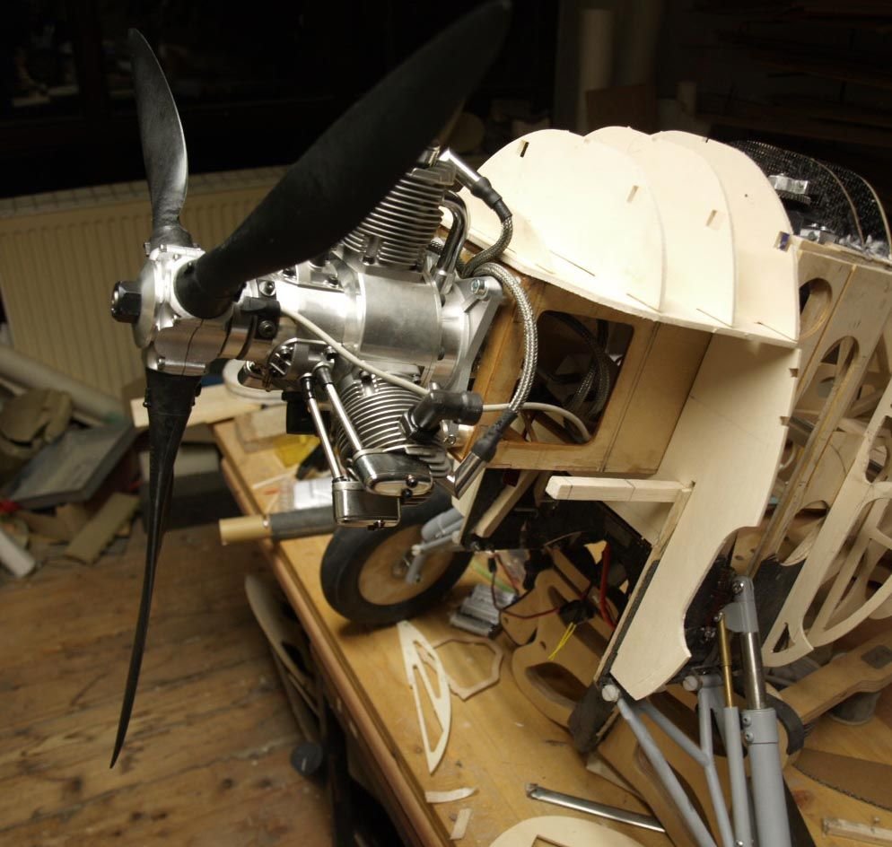

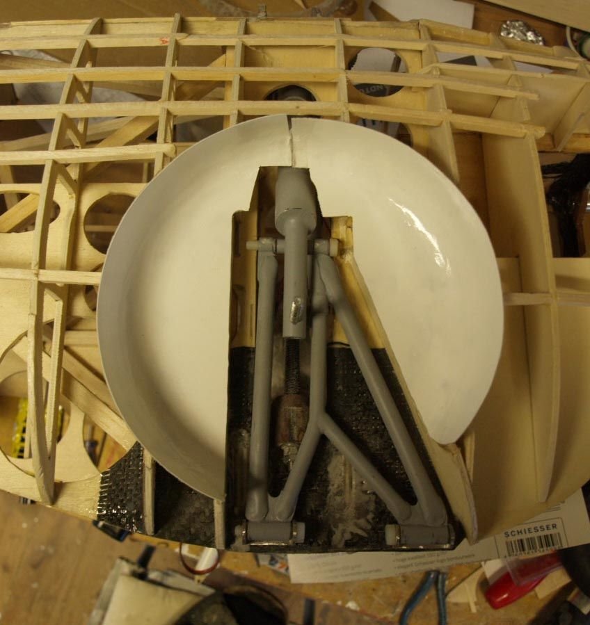

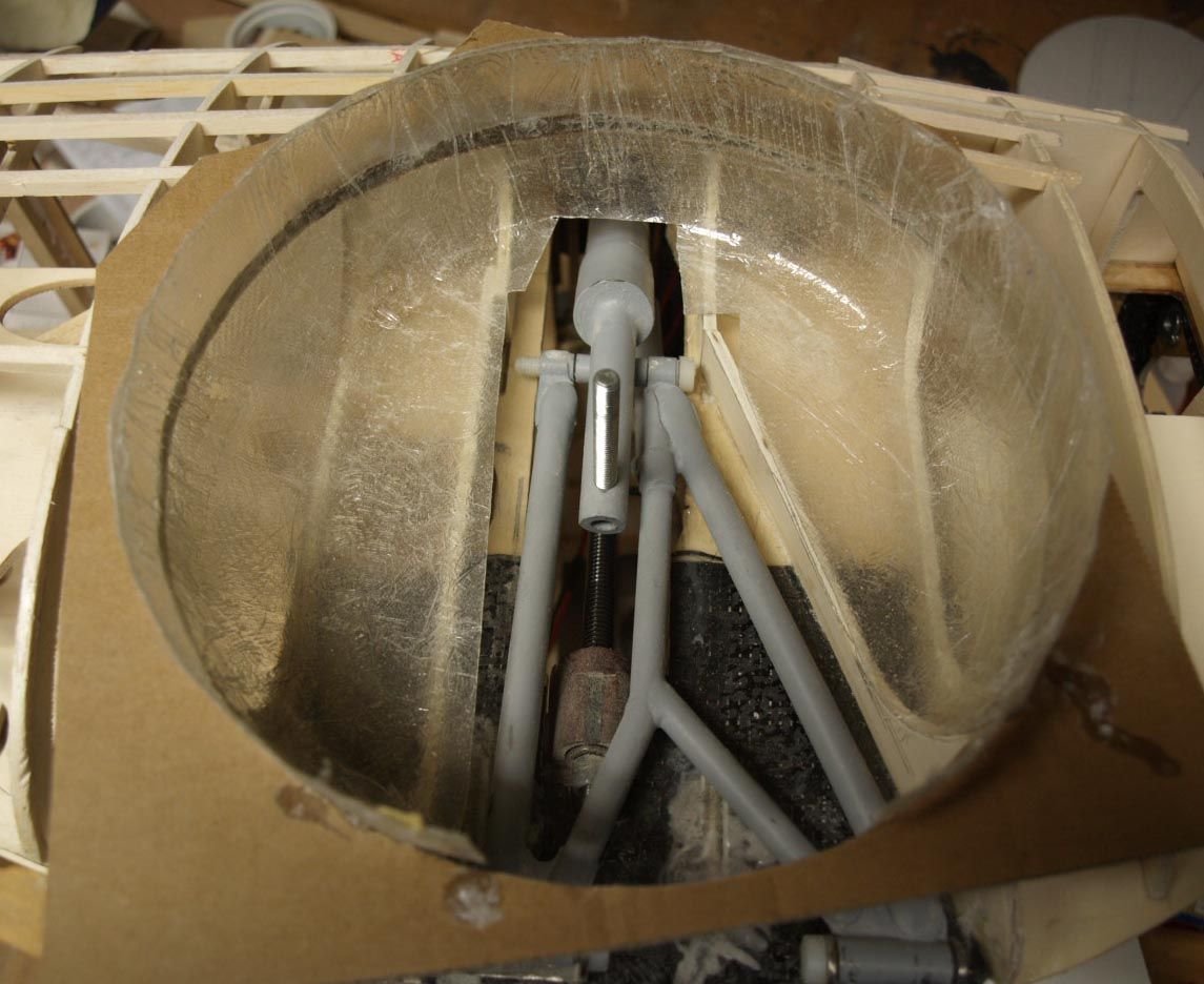

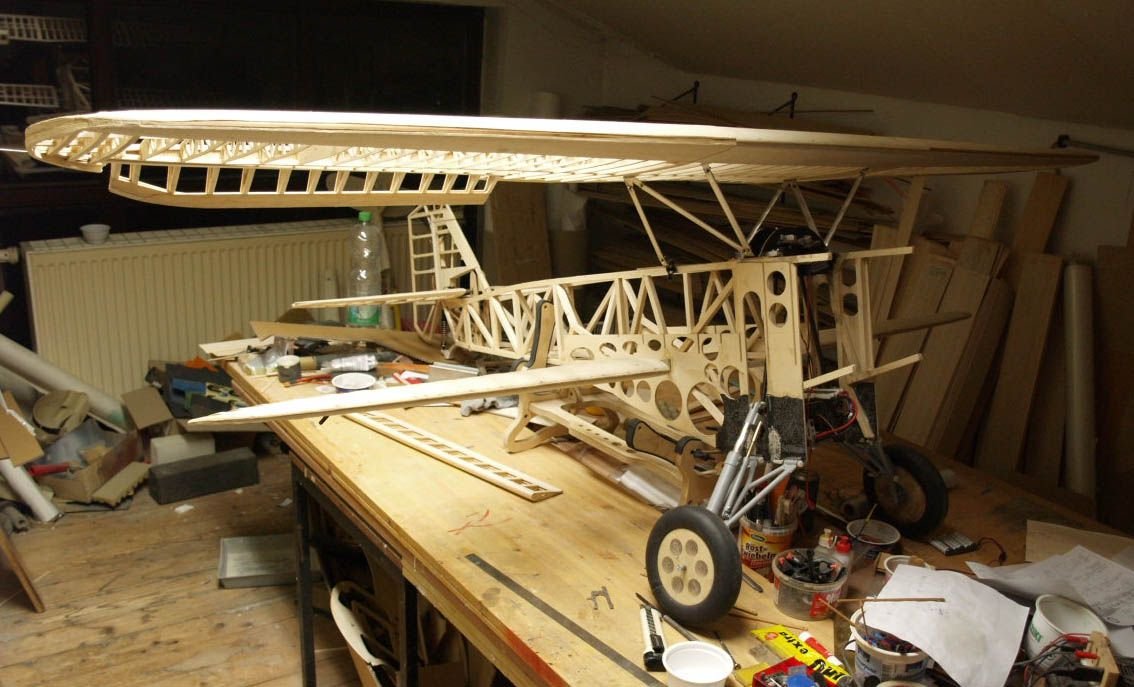

Till this time I was on the bright side of life, in my minds the landing gear was finished, all my fears abiut it were in a long, long past.
I builded a gear box, assembled it.
built into the fuse, it looks great.

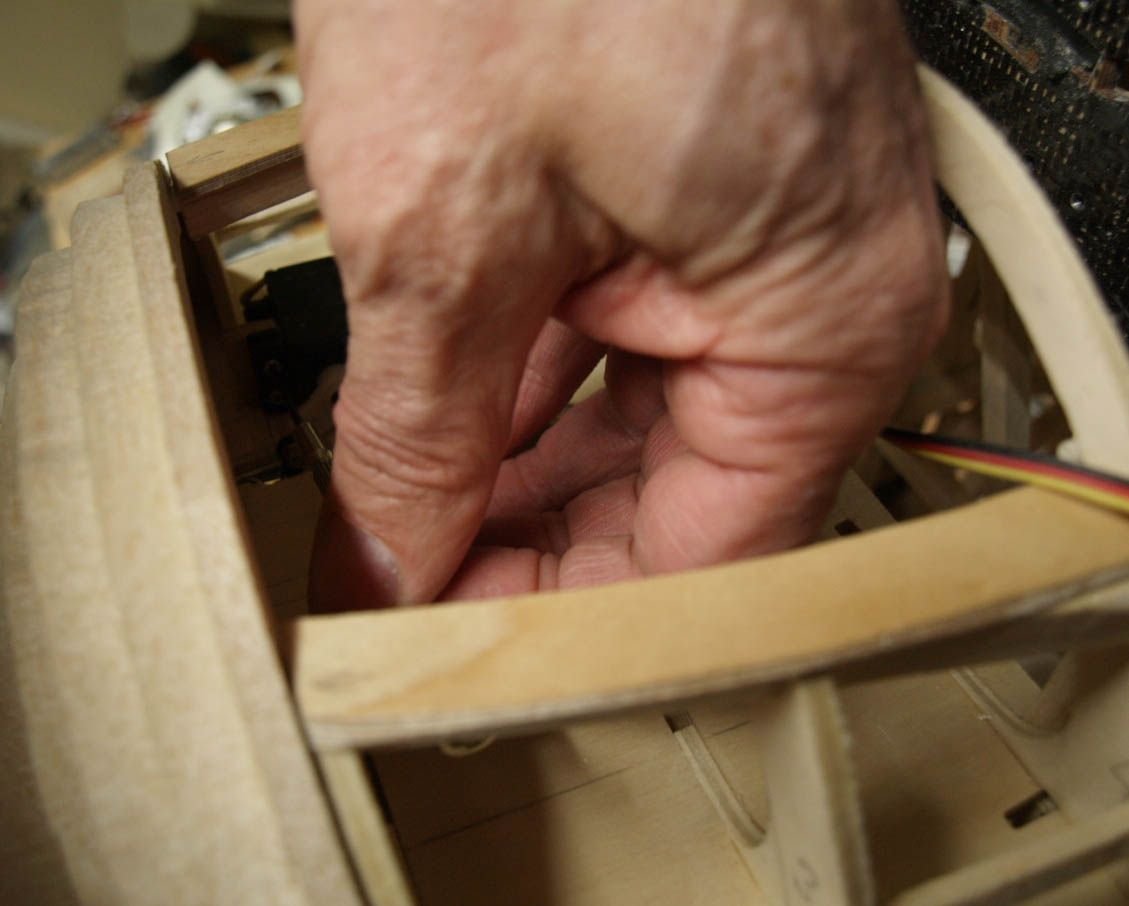

But then, the first test > se your self > a real desaster:
The drive was to weack, the transmission ratio was complete wrong, the current consumption to high, and I was destroyed.
The next gear attempt I started with a worm gear.
It also failed.
In our modelling club the guys helped methink and we found a solution.
Now I use strog servos as drive, 40 kg power. The electronic is removed. The first attempt with tooth belt looked promising,
the final solution now ist a spur gear.
I marked my success on my studio door
And here it is

Now it stand on his own wheels for the first time
It is time to adding wings, I`m sure it will be useful for an aircraft.

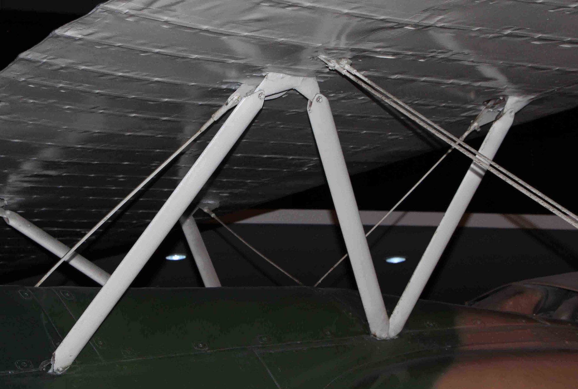

At first the son of one club members done some metalwork for me. He owns a small company that is cutting parts with heavy water jet. This are the fittings to hold the upper wing and the flying whires. The small strips are the flying whires.
As the next I`ve done a device, an apparatusor so to simulate the upper part of the fuse. I had to fix the middle part of the upper wing.
the most is done from corrugated board, it had only to hold the right position.
Than I simulated the struts with wooden stips.
Some futher metall work andI replaced the wood with metal.
To compareto the original aircraft

first test, first building all components together, one thousands hours of messuring, glued, fixed
Every time when I build a biplane together for the first time, I`m embrased > an tremendous block
So, this is the current status, I`working on the engine mount, my "milling"-man is working on the formers, hope to see you.......

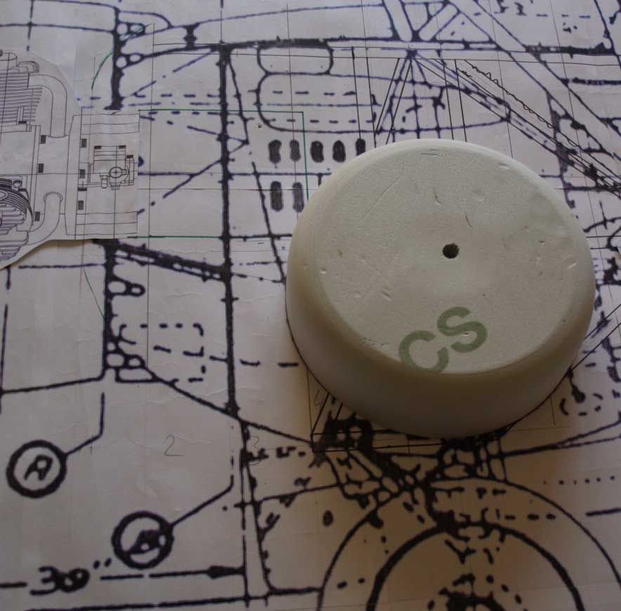

the first quick snap assembly of the nose with the engine doom
The engine doom ist glued together, it will reinforced with carbon fiber.

the engine doom is reinforced with carbon fiber

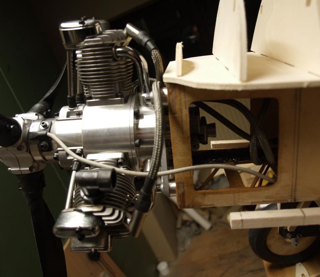

As the next step, I snapped all together and the engine took place for the fist time, hip hip hurra
the prop is a varialble pitch propeller from the german fakturer Ramoser, great stuff

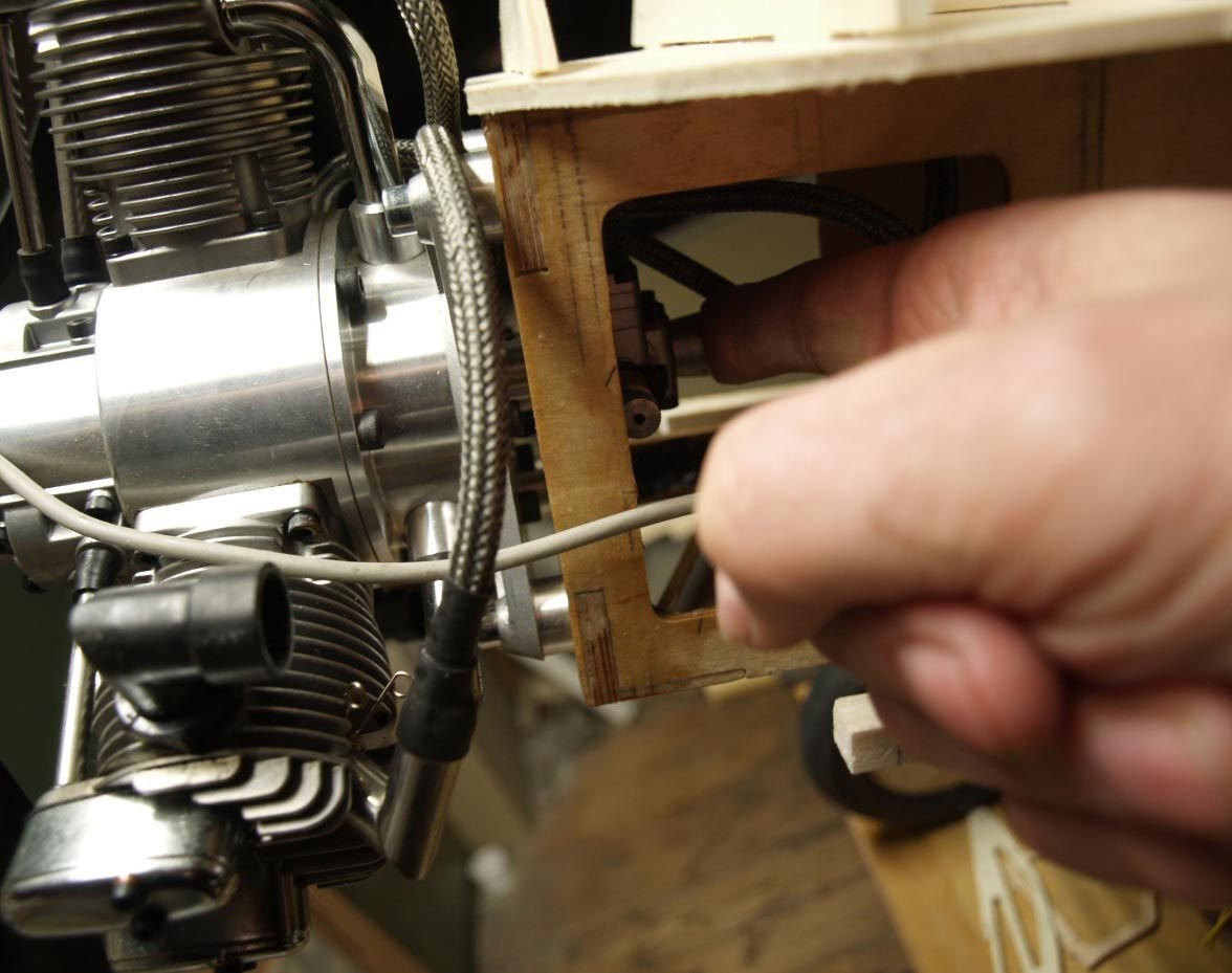

The big holes in the sides f the box should give me the access to the carburetor. Fortunly, the original aircraft had a big service slot at the same place
So I didn`t need a complicated solution for chooking, I can do it with a finger
Now, all fits together, the holes for the ignition and the throttle-servo are doe, so I can glue the whole thing together

Now the side parts of the formers and the spars are added, looks great ?
but, before I starting the sheeting, I`ll do the wheel houses just like this. Seems it would be easier to manage this now. Its always not so simple to make holes onthe right position into a closed sheeting.
For this, I`ve done a ruffian, I try to laminate this things not in an negative mould, I`ll doit over a core, as positiv....
After isolating the core with package tape I reactivatet the fuselage dummy, I used to make the gear.

The first attempt for the wheel houses failed. Normaly, I had to know, I used for segregating the core from the fiberglass kichen foil an this doesn`t work good, no usable surface.
but, nothing is so bad that you couldn`t use it for other things, I had a nice template for adjusting the wheel houses
Than, after covering the core with fiberglass, filling, sandning, filling, sanding...
by the way, I saw that it wasn`t necessary to make complete parts, so it was very, very easier to demould.
The first side is ready.
For better gluing the sheeting, I added a ring from thin plywood.
The other side is done, now I removed the gear complete. It only took 5 minutes, good to know for any further service works

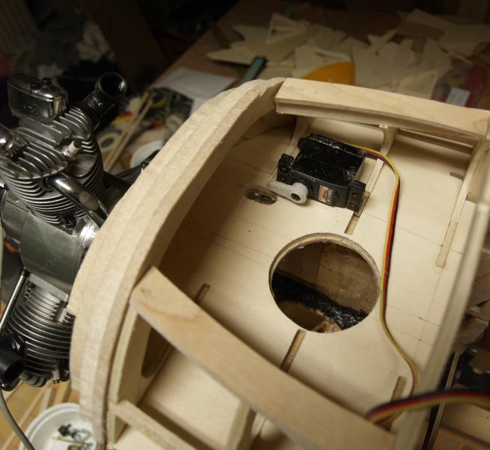

Before I can start the sheeting I had to build a servo mount for the throttle servo, It`s easier to do before the hull is closed. Also I want to have a simple access to this. It`s also possible to handle this with big hands.
Now I filled up the nose with some balsa
I try to start sheeting on the bottom,so I added some formers and spars.

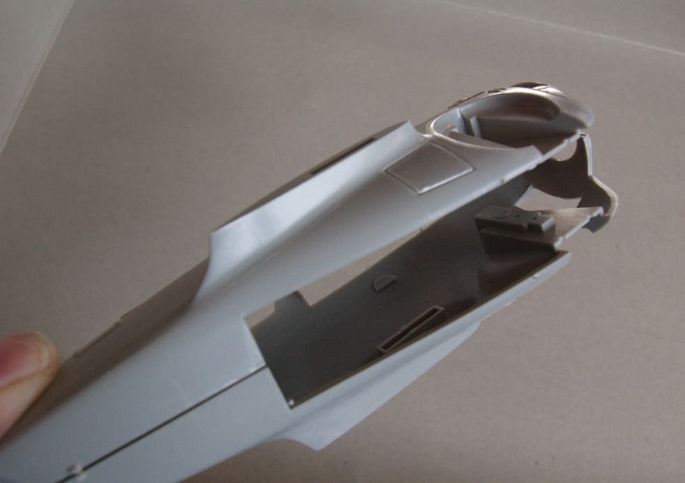

The big hole in the bottom will stay the major service door. In the plastic kit they realised this so, and this was the example for me.
The frame of the service door is finished, after drying I can start sheeting
