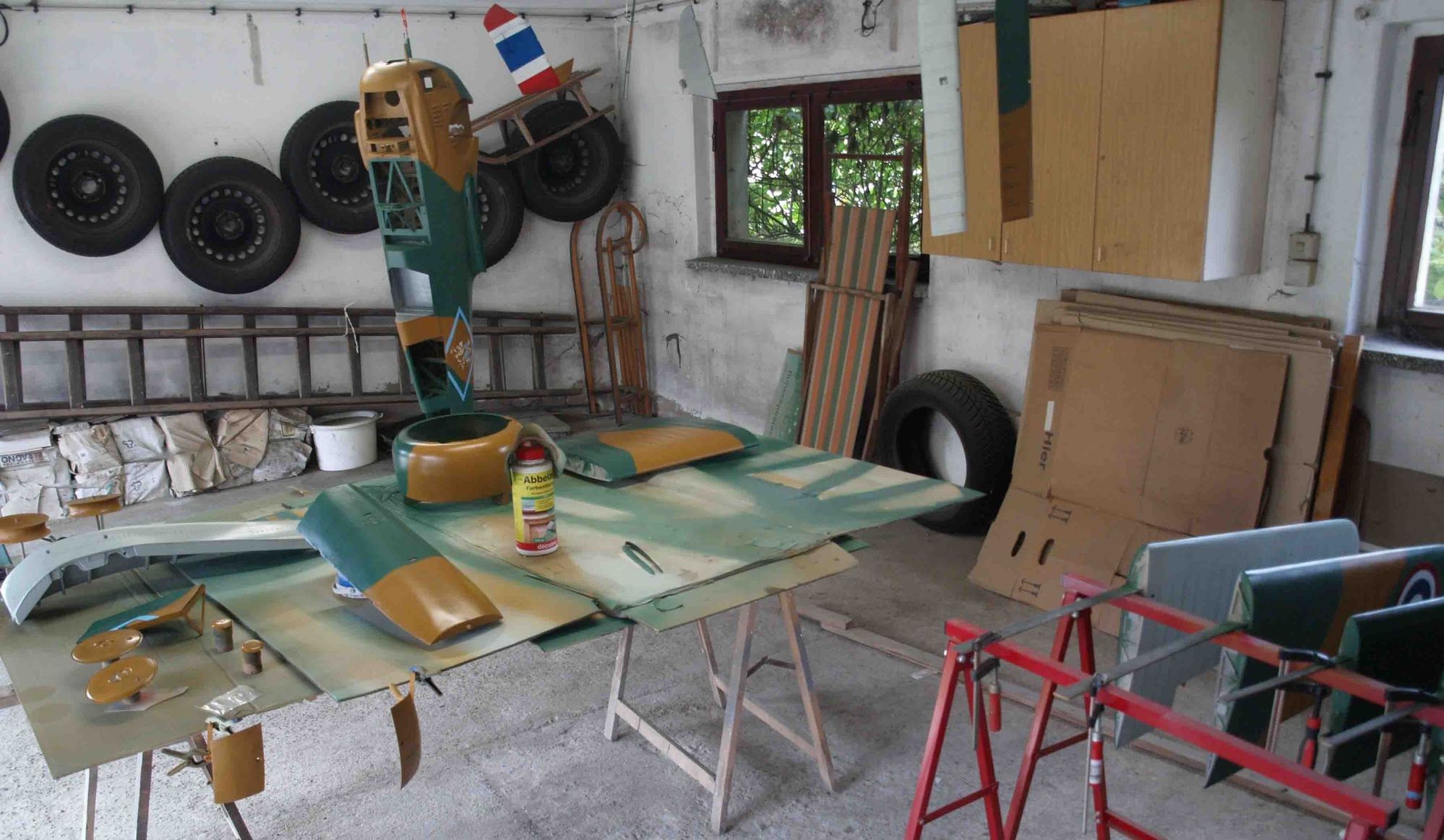

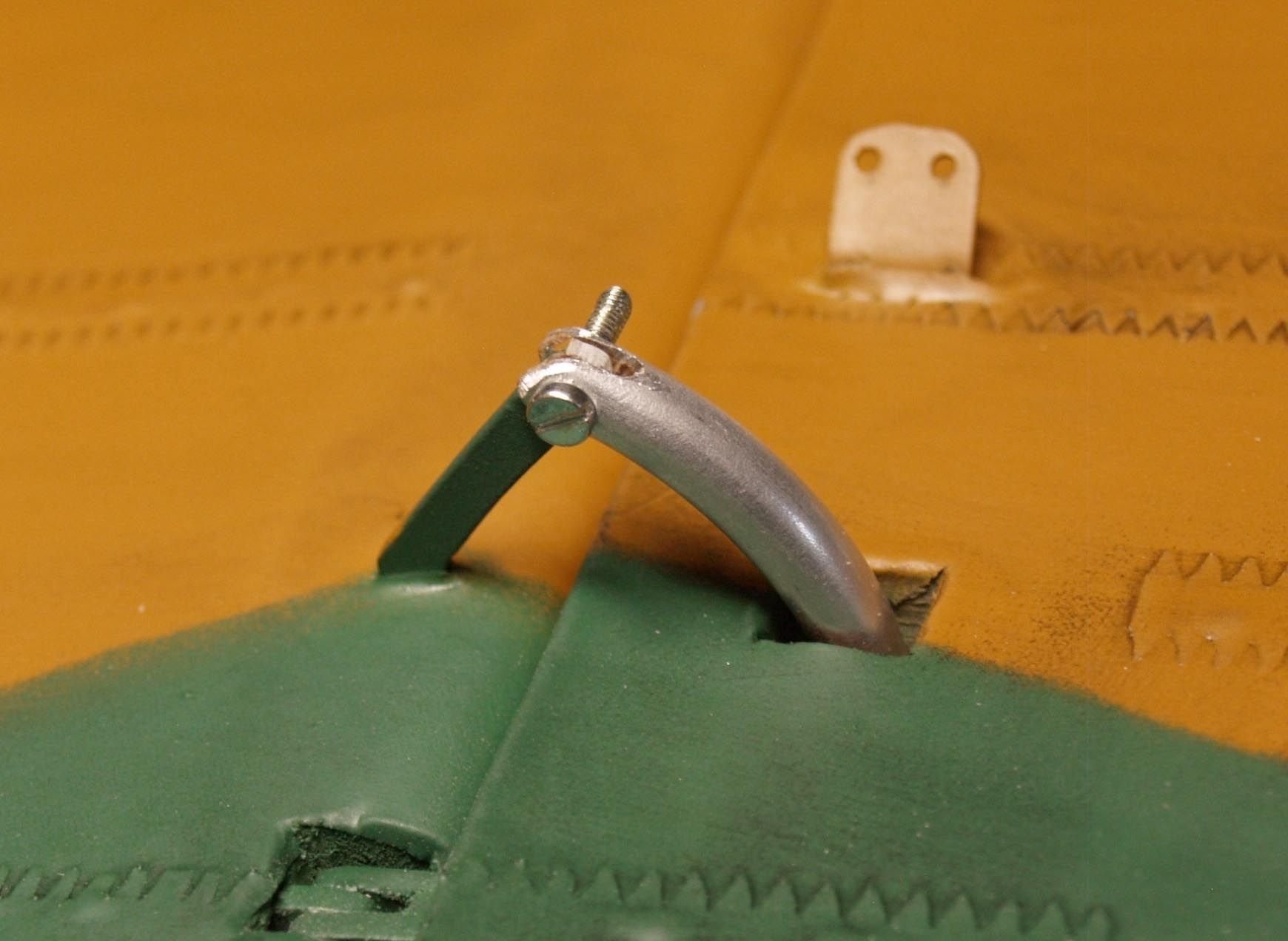

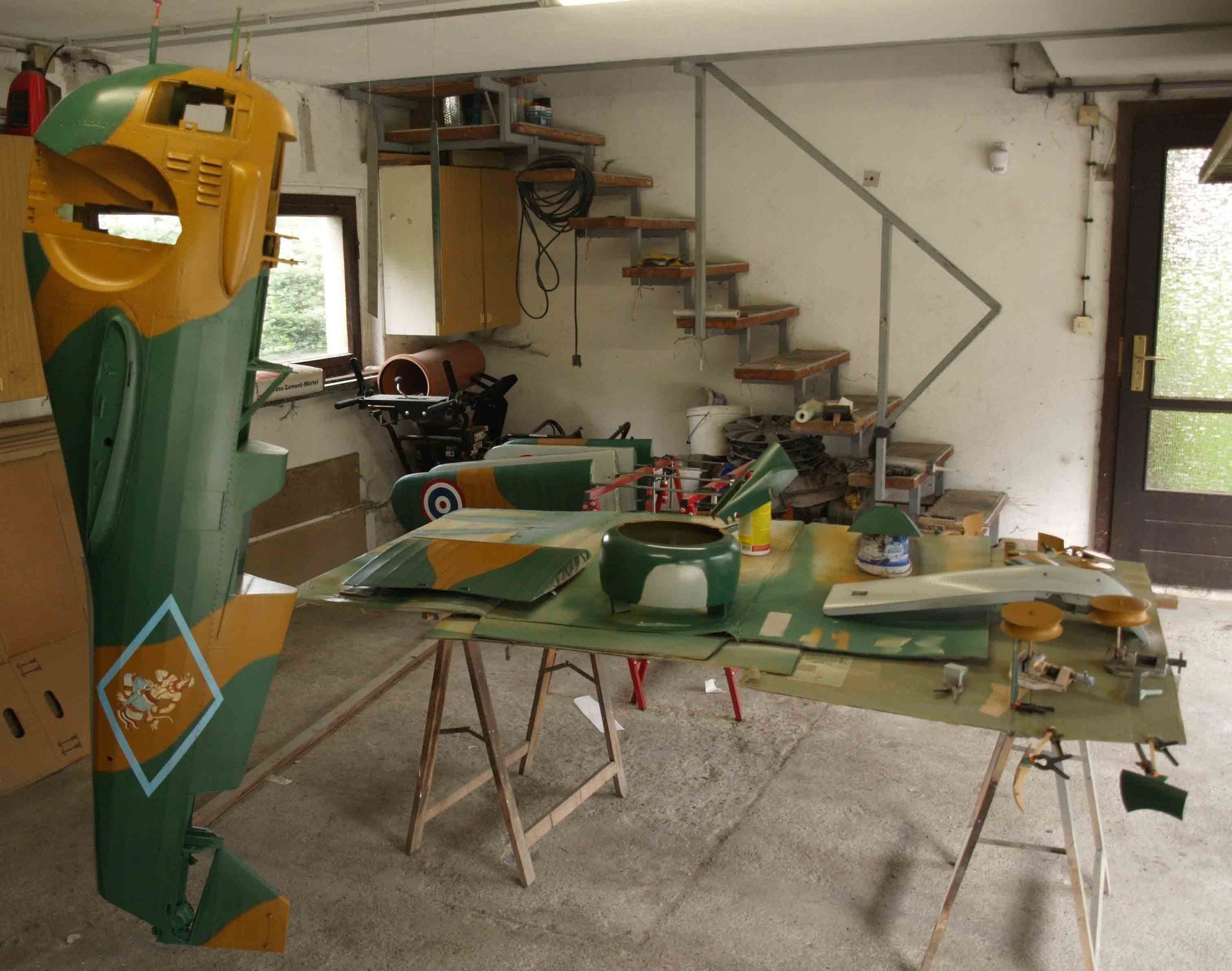

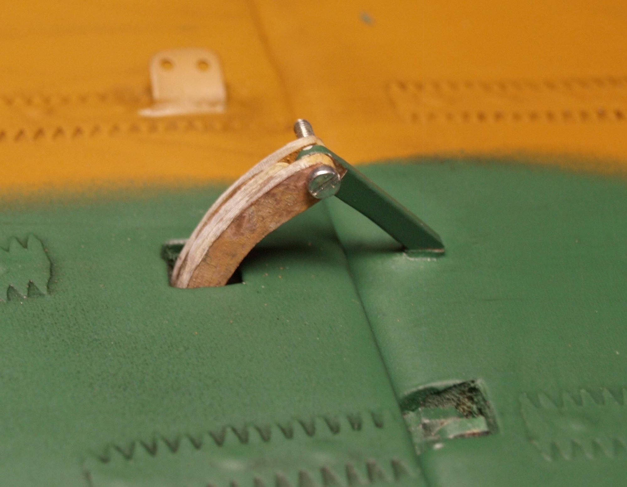

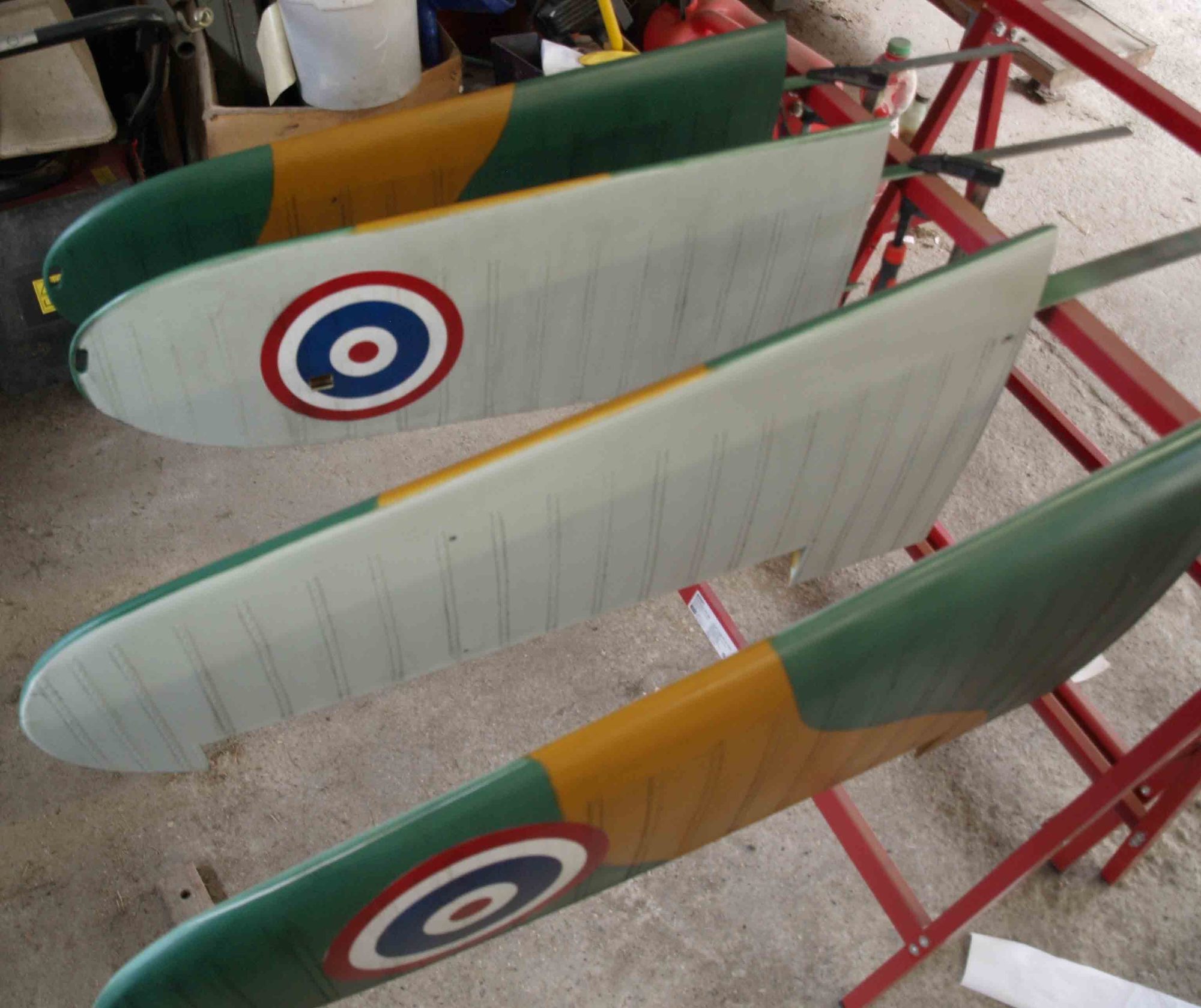

I haven`t been lazy the last few days, just a little distracted....

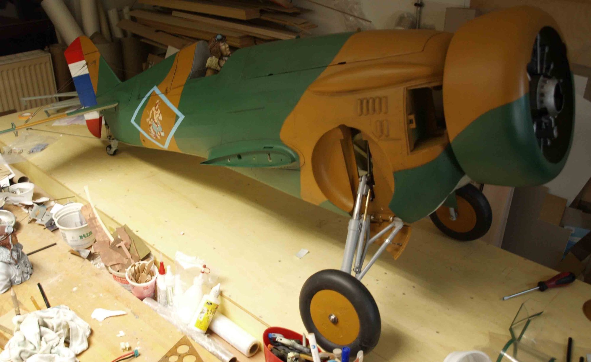

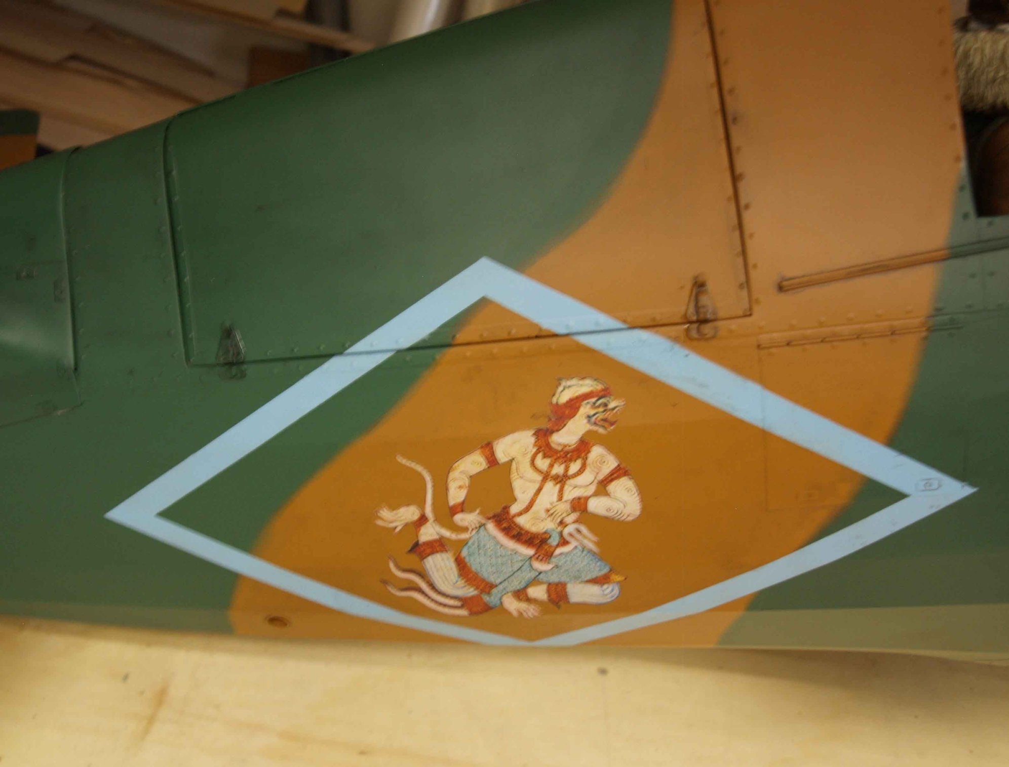

As the next step, I added dull cote to all the parts.
How you can see, I`ve done a little wheatering, not so heavy. I dont`t really like those very aged plans.
Now I can start bringing the pieces together.

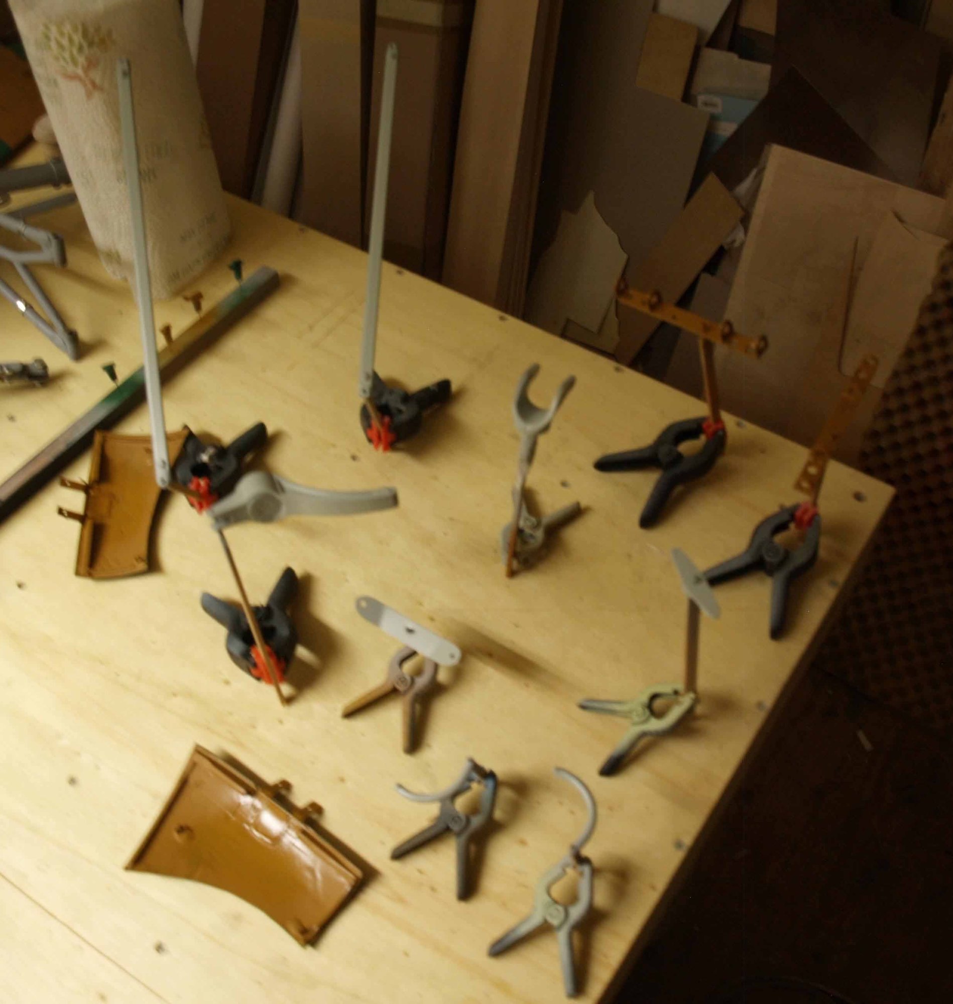

When i started, I noted that the counterweights for the elevator looking terribly.
The new ones looks very much better

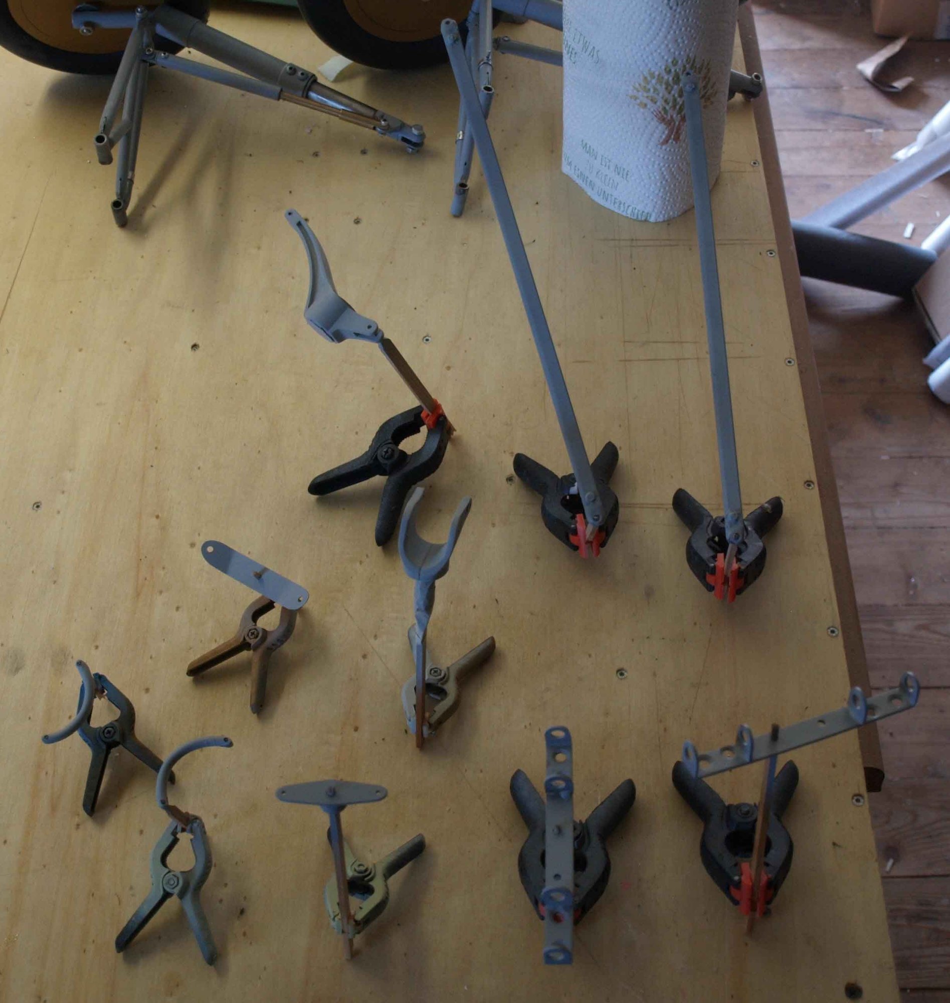

I`m sure, you all know this. You take the model apart for painting, put a lot of small parts into a box > and forget to paint them.
Fixed!

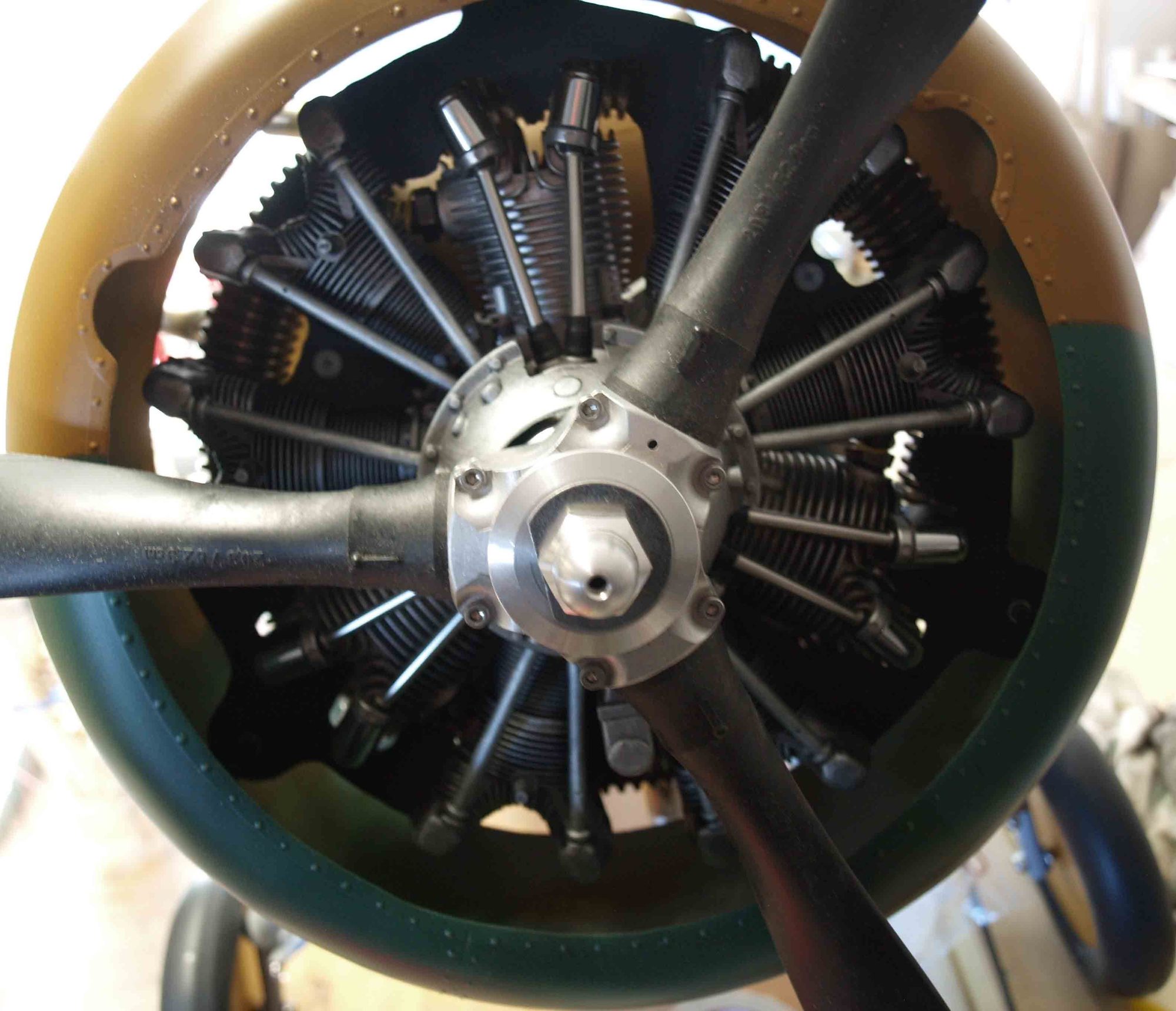

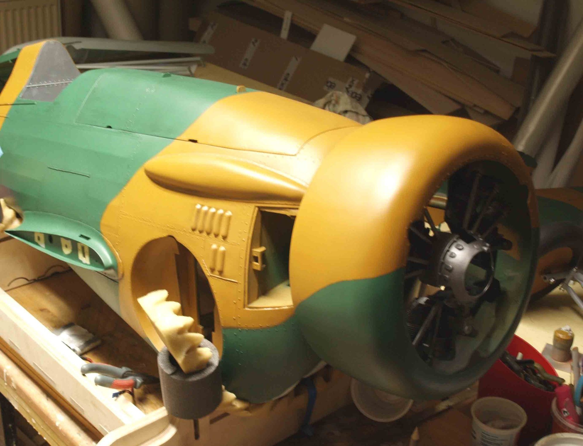

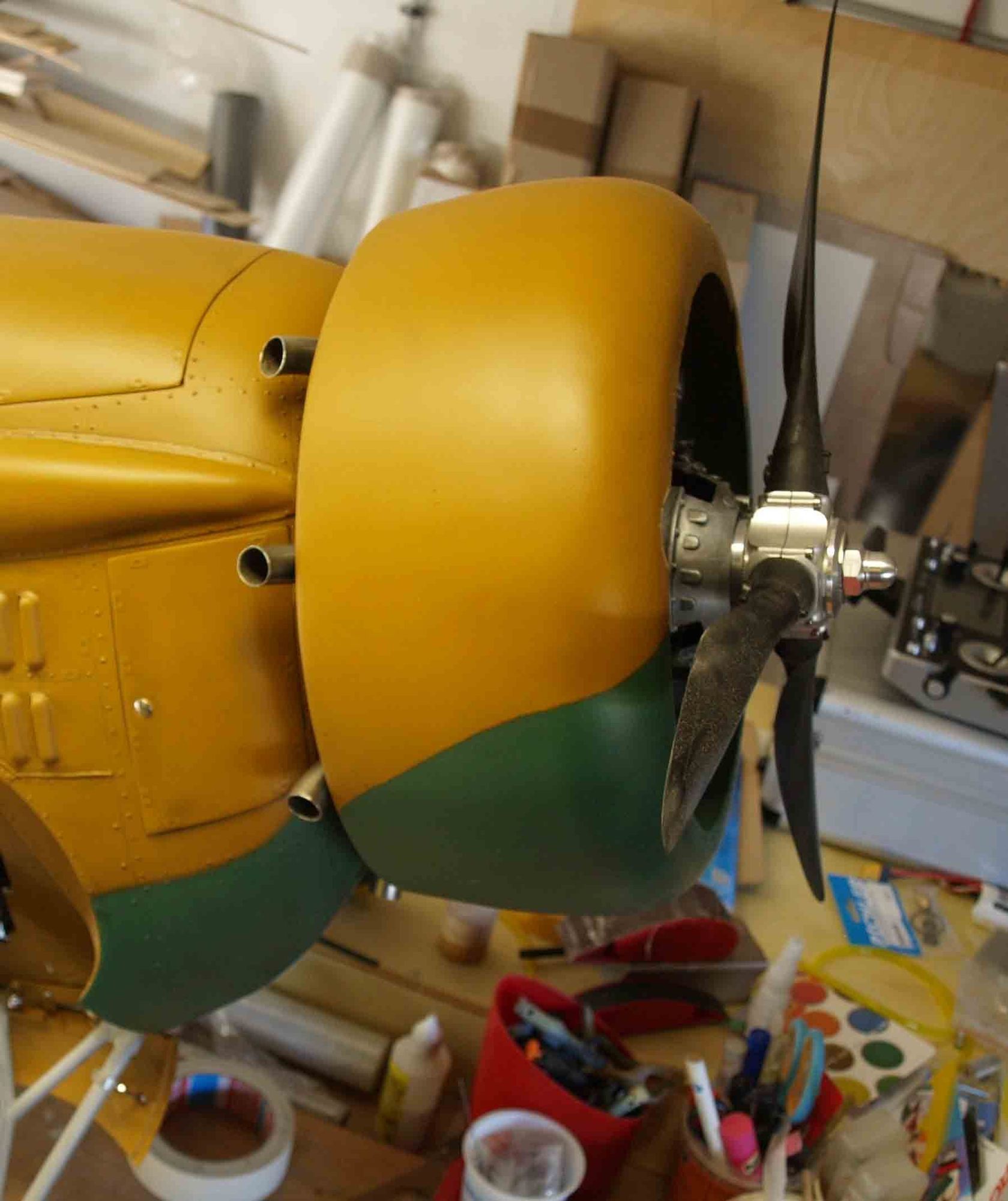

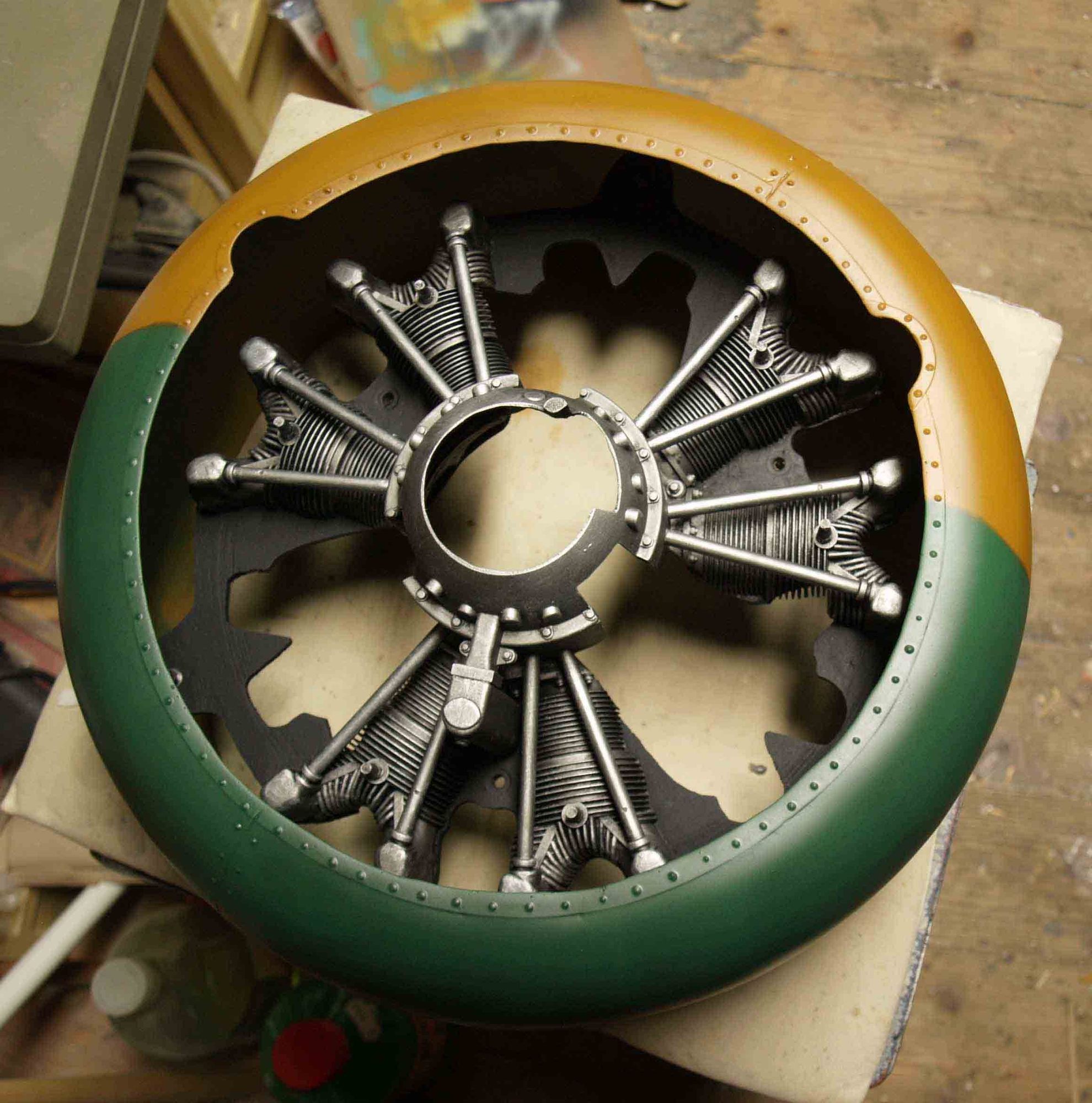

Now I finished and varnished the engine dummy. Just added to the cowling.
It`s amazing how strong the cowling is now.

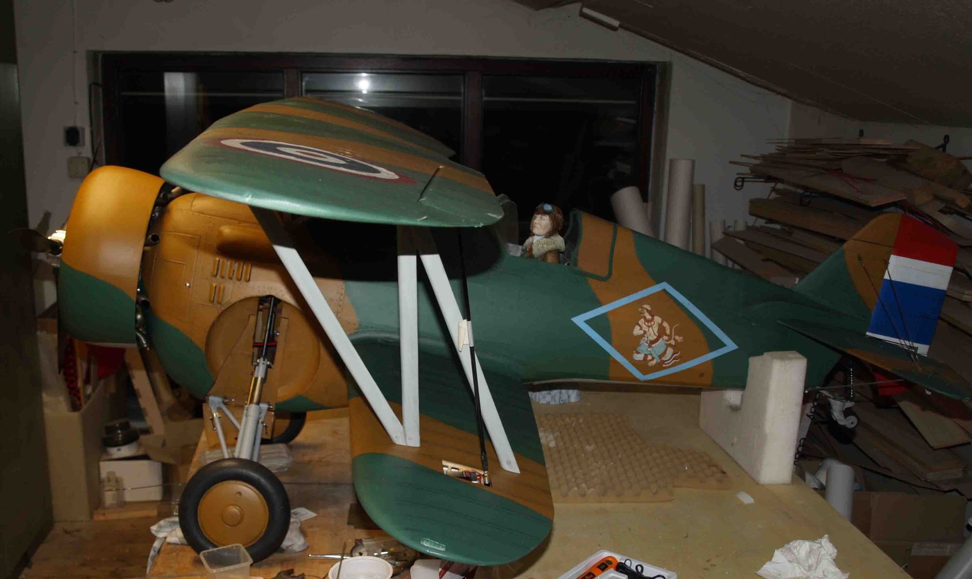

I`ve mounted the cowling to the fuse to see if it all fits.
Doesn`t looks bad, doesn`t it?

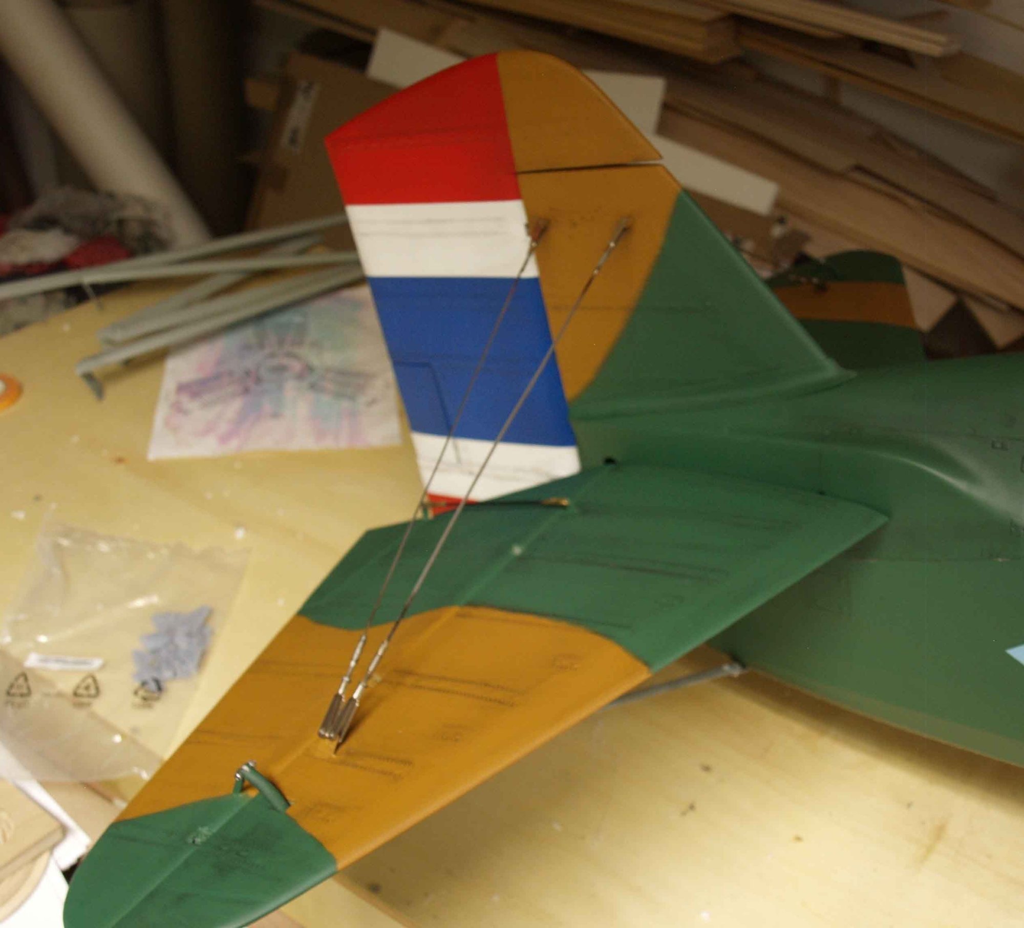

Thank you guys, your echoes makes me proud.

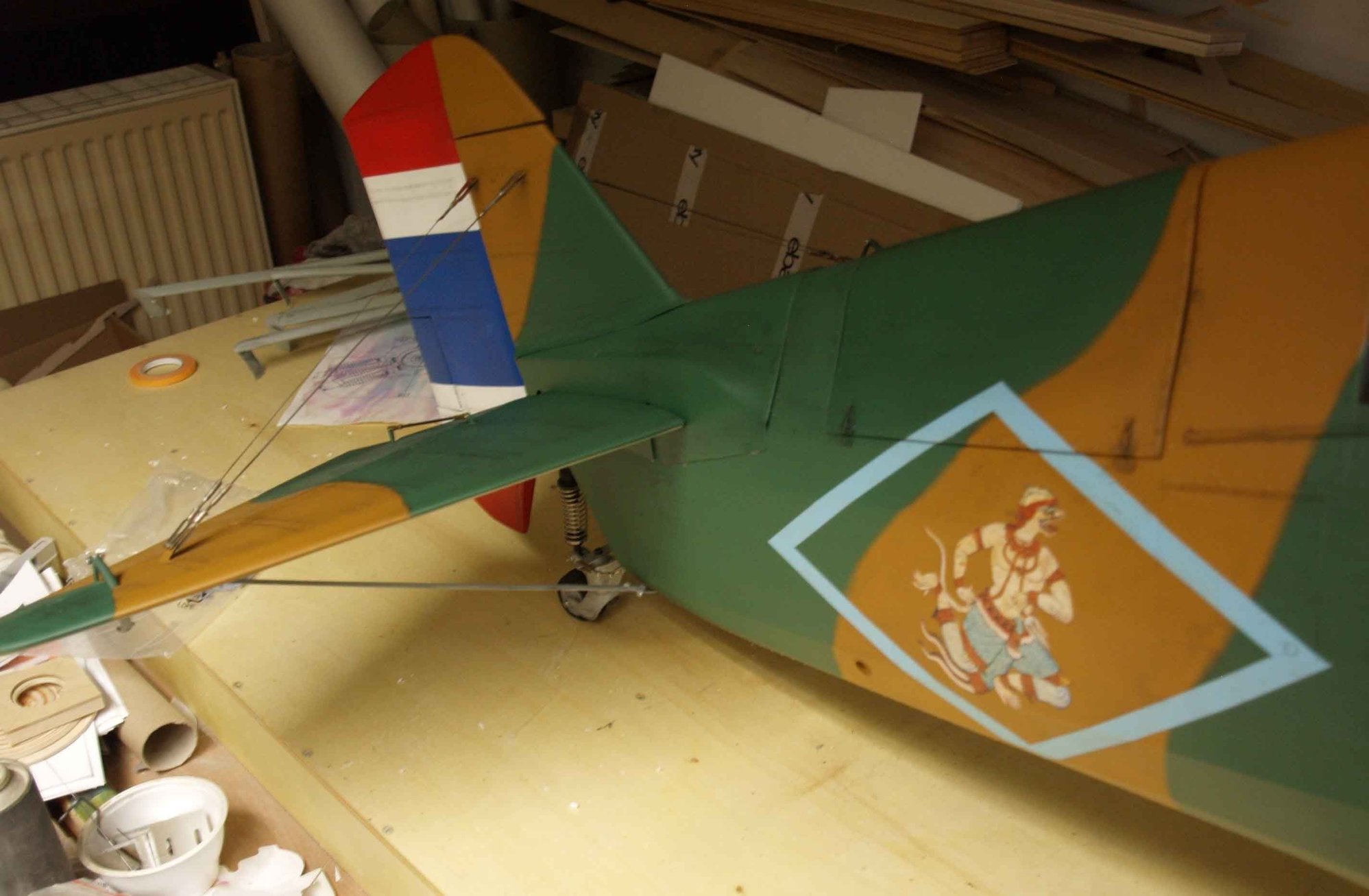

The tail is completed now, it works as well.
The cover of the elevator mechanism and the door at the back are also done. The printed parts comes out very nice.
So the plane is standing on its own legs.

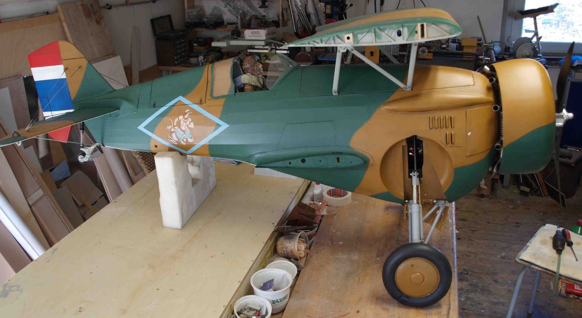

Thank you Mike but i.m.o, my claim is semi-scale, to museum-scale, a lot is missing.

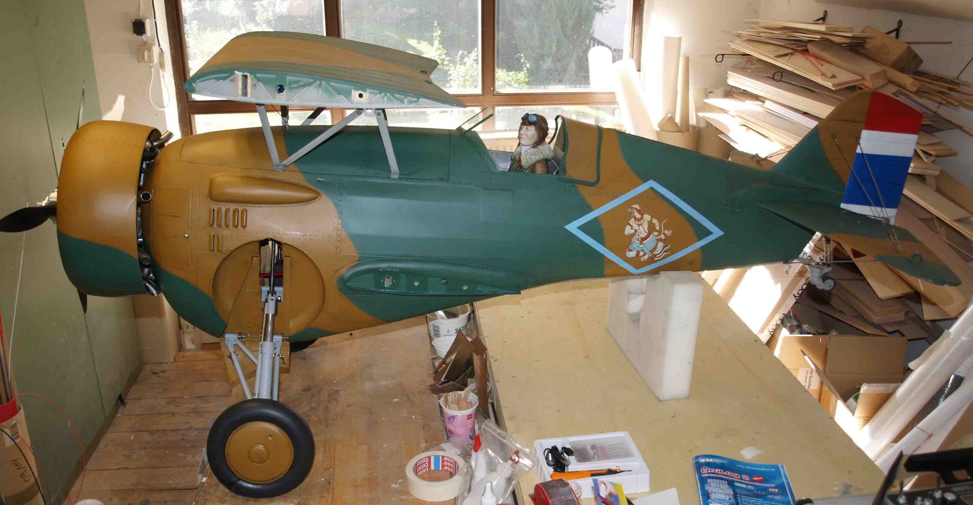

But, fully motivated I put the model together today.
When I compare a top view of the original with the model > close to this.
I didn`t match the color tones but the scheme is close.
At the same time I took the opportunity to weight the plan.7,2 kg, without the engine and some scale parts. The engine with the propeller weighs 2,35 kg. So I hope (if I don`t need lead) to finish with lesser than 10 kg. I had calculated between 10 and 11 kg. Mission accomplished

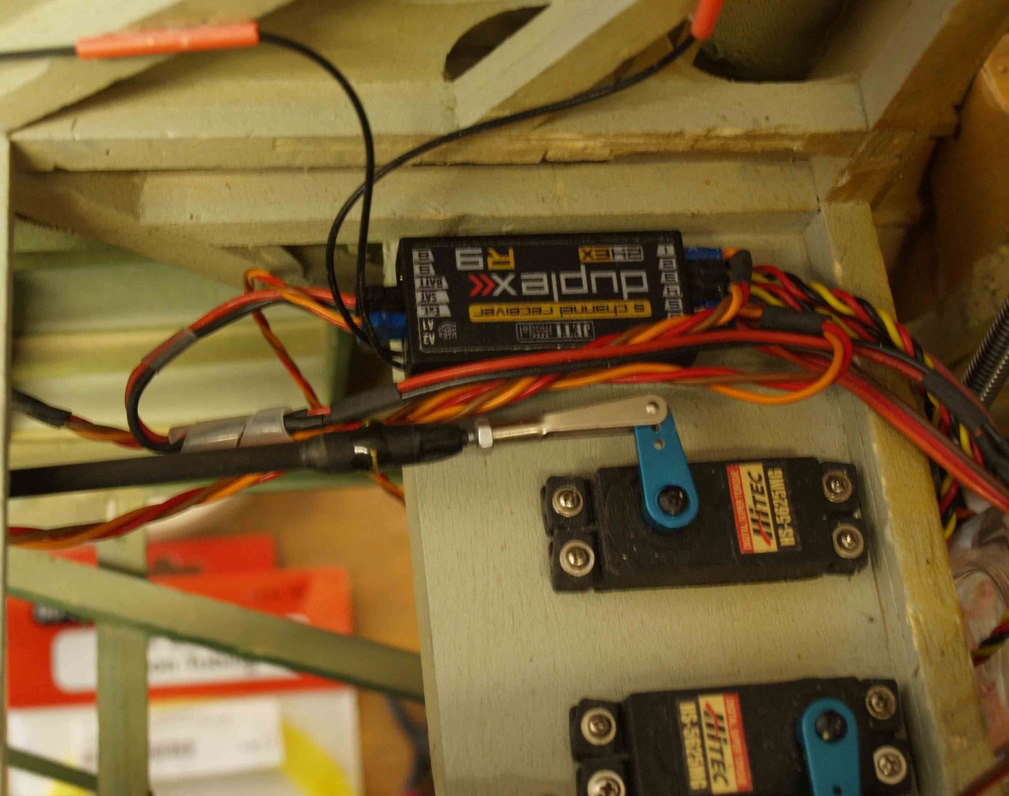

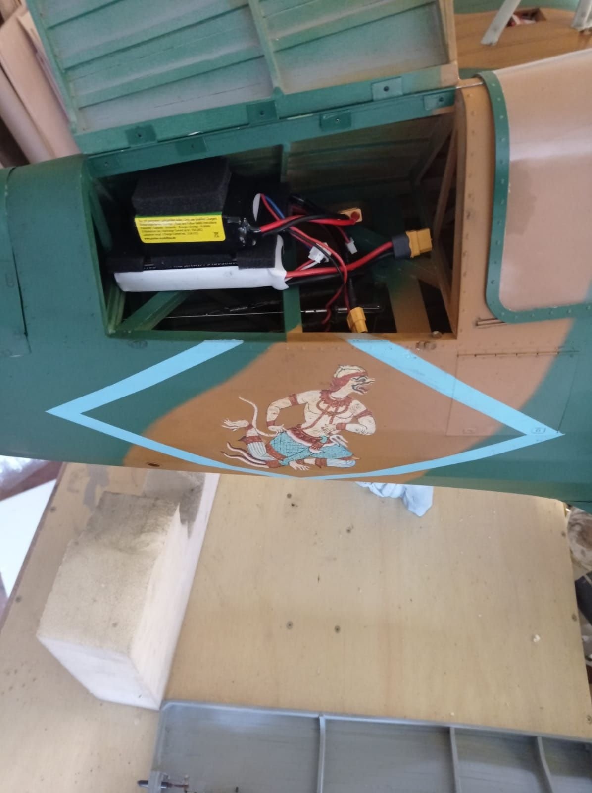

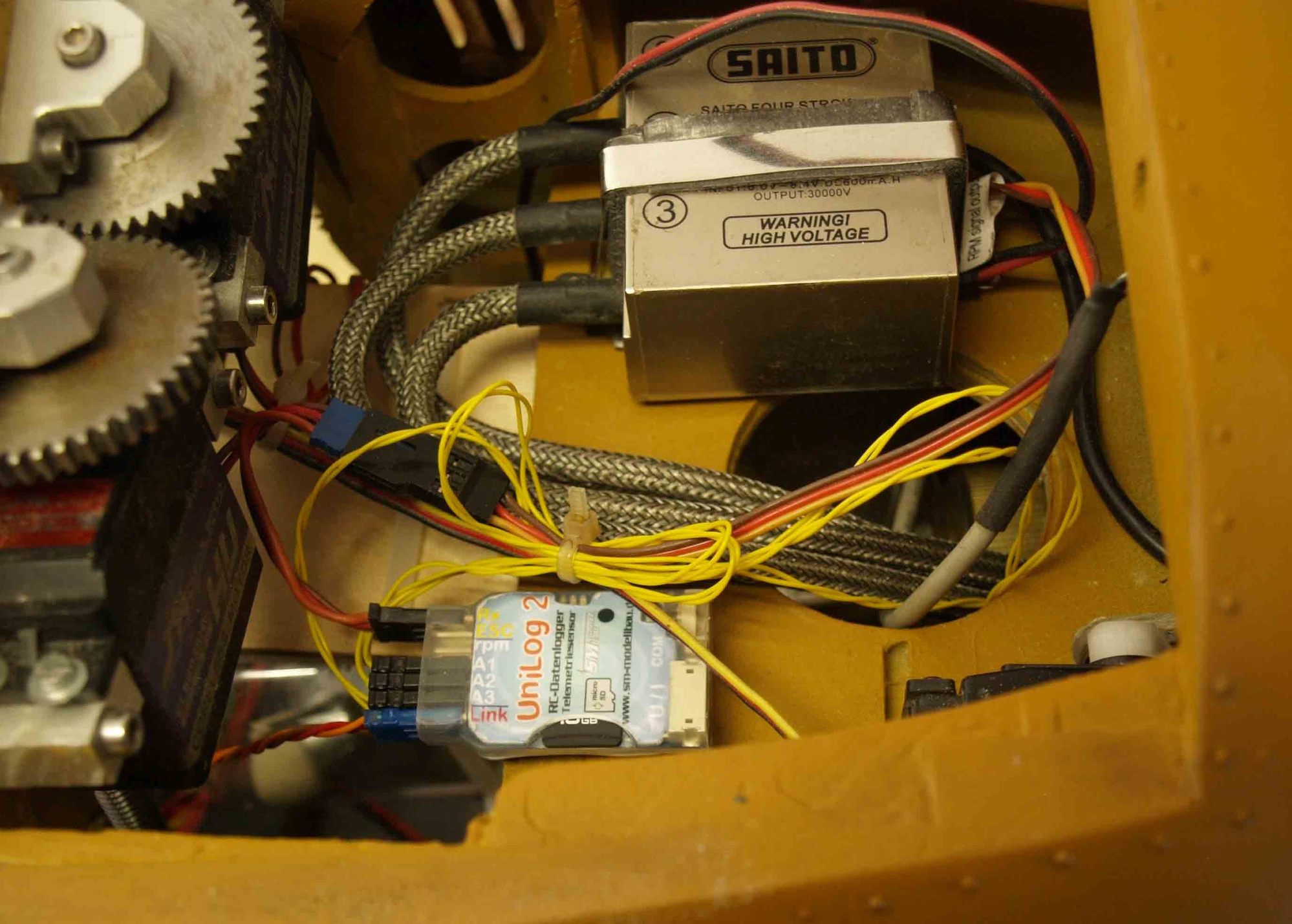

The electrcal installation is finished yet.
It looks a little bit trashy, but I can put a lid on it
My plan with the large service hatches works as well, I nave place enough for engine setting and choking with my finger.
When I have attached the temperatur sensors I can start with the first rolling tests.....

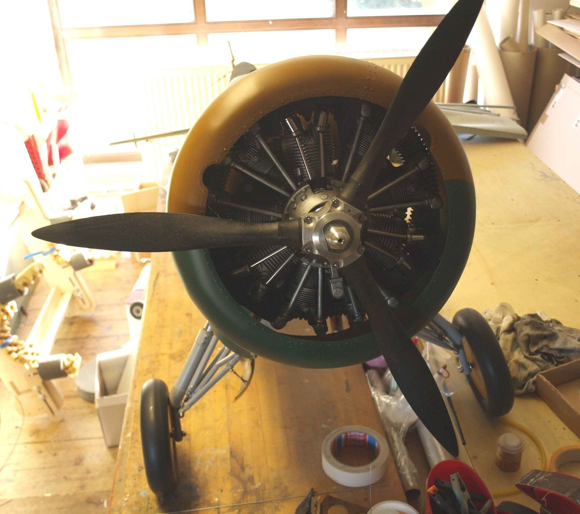

Now I turn into the finish line.

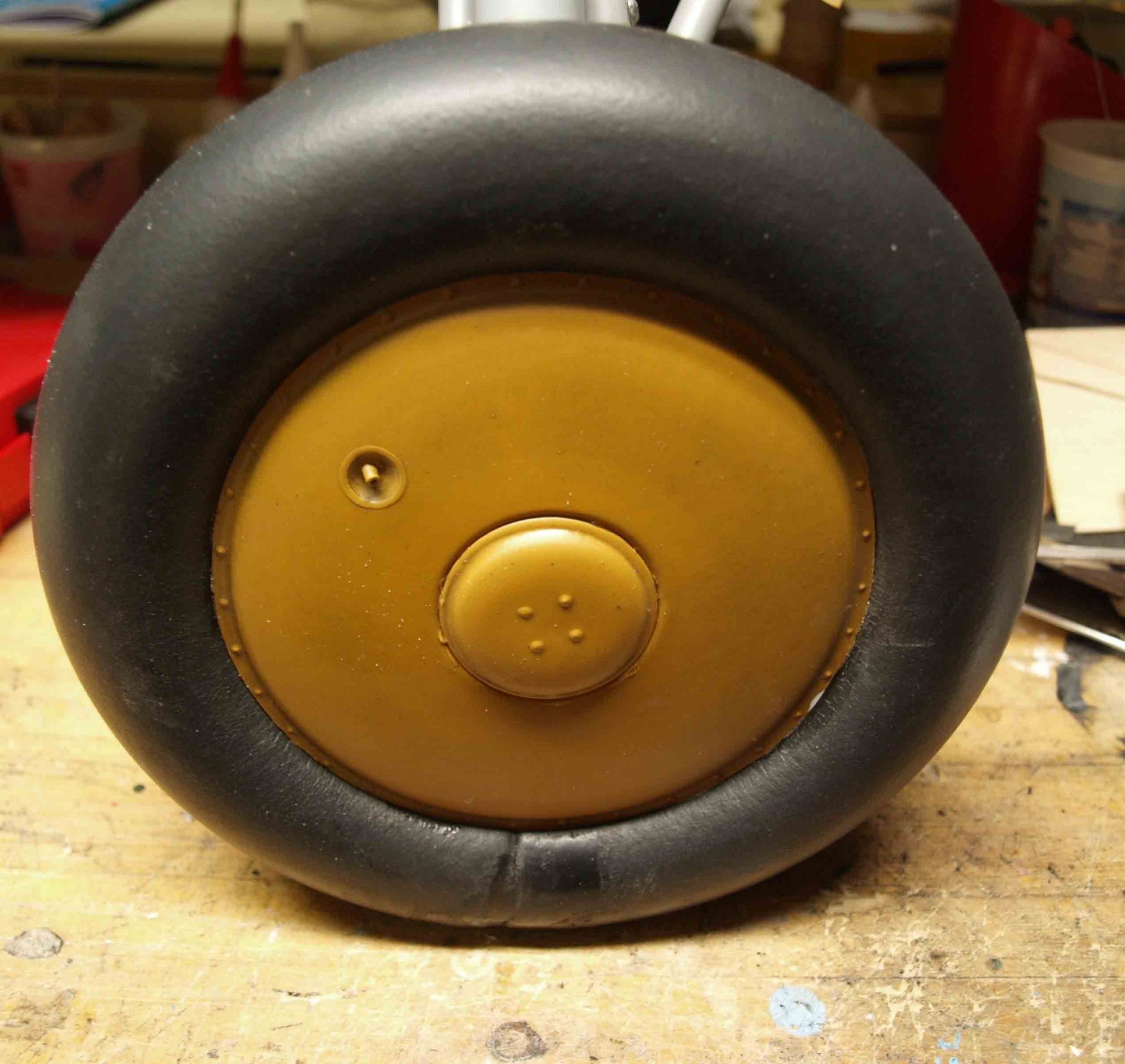

The cowl with the engine dummy is mounted. From a distance more than a meter it looks like a real nine cylinder (I hope so)
The hubcaps are added.

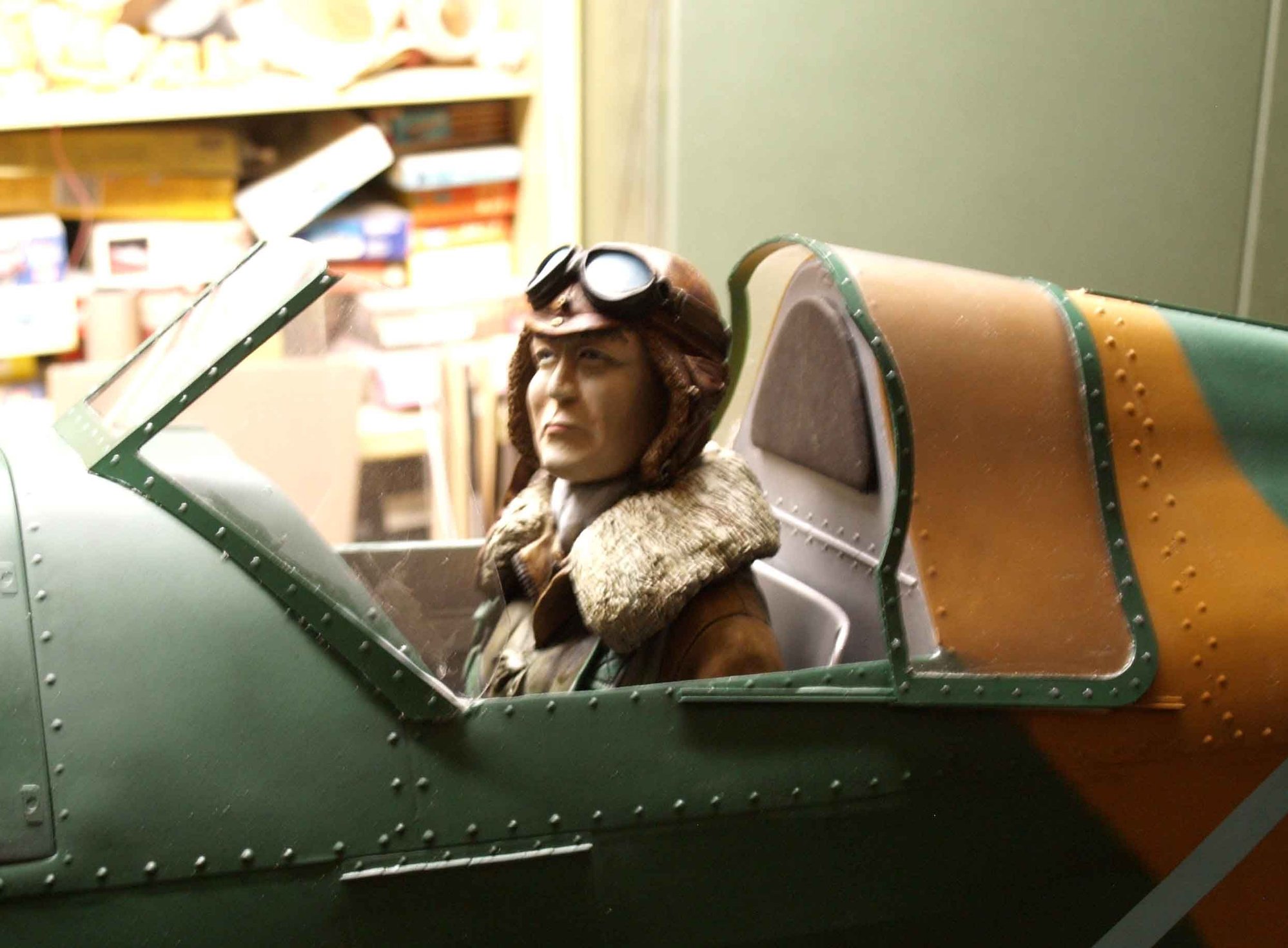

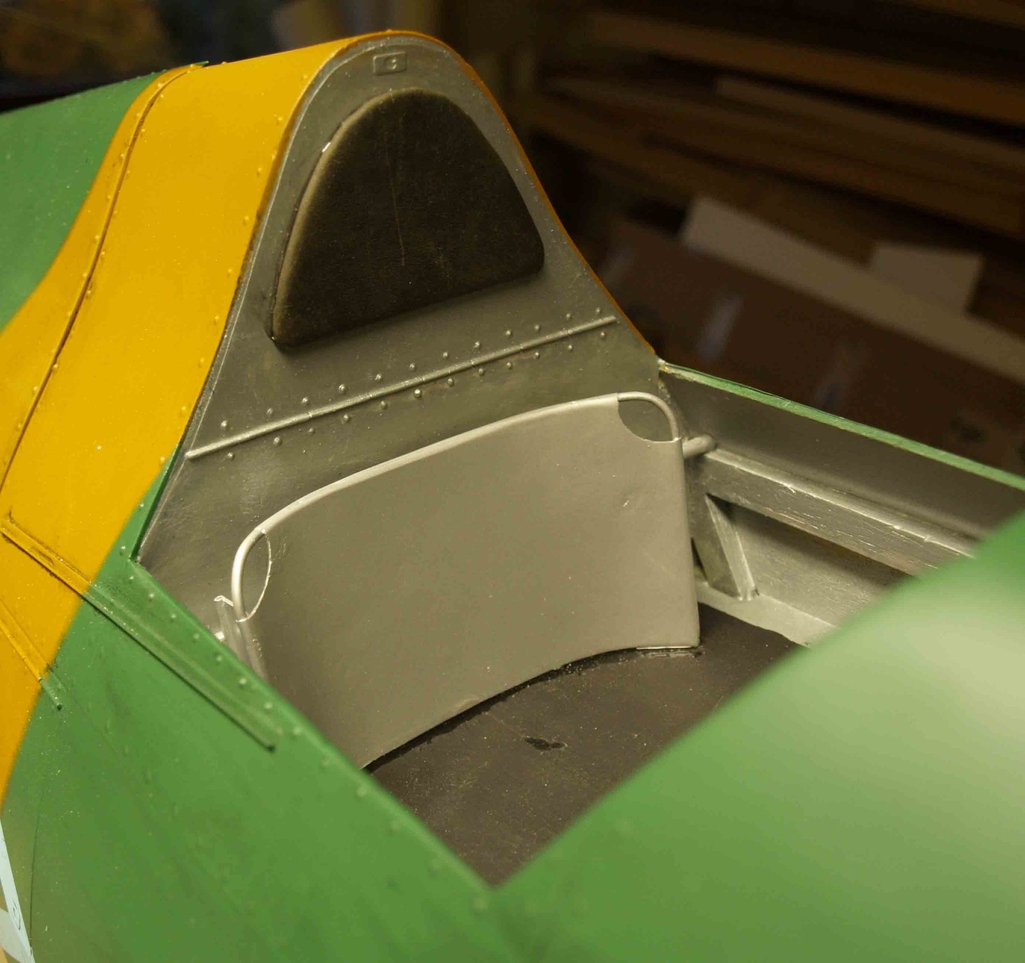

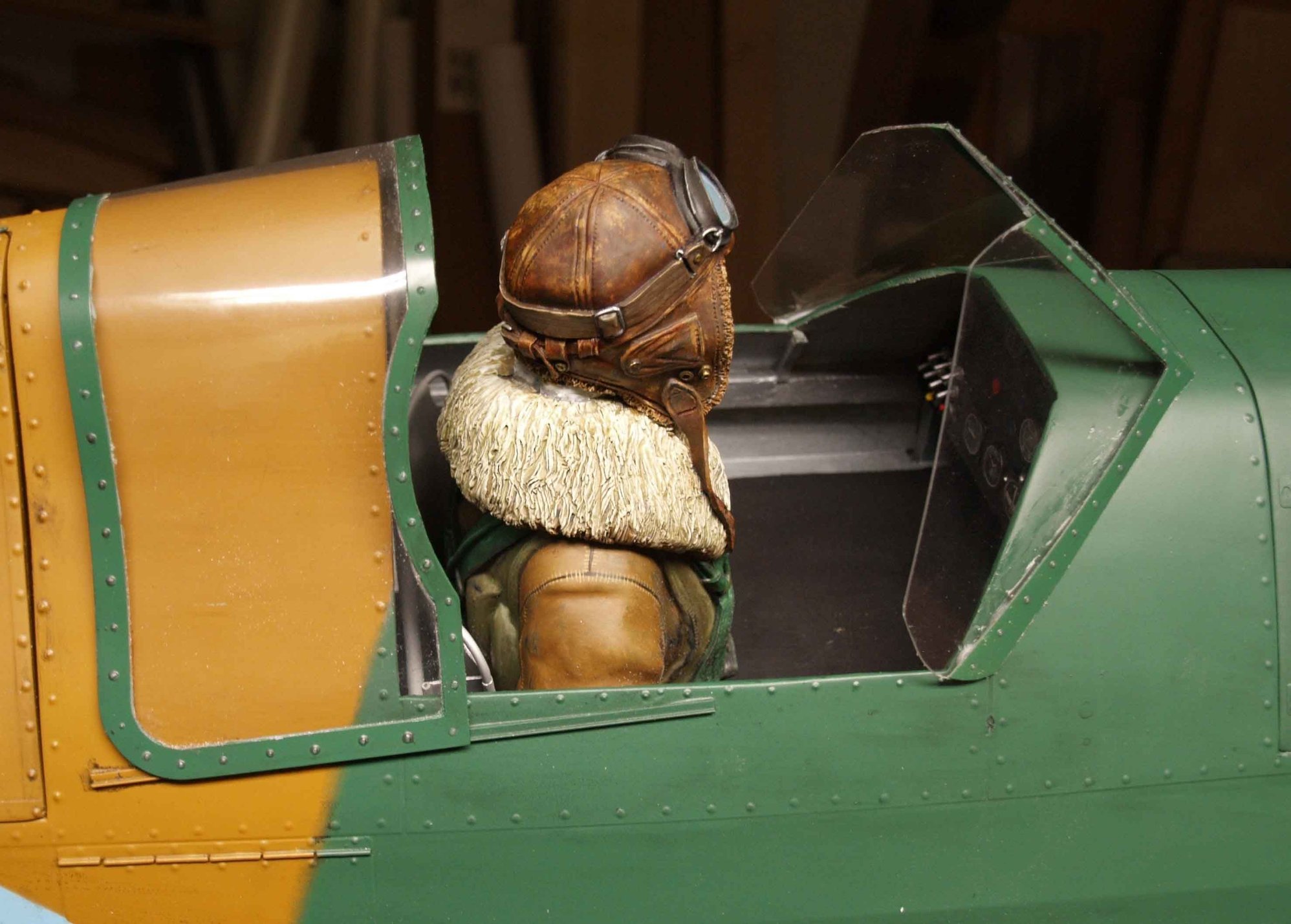

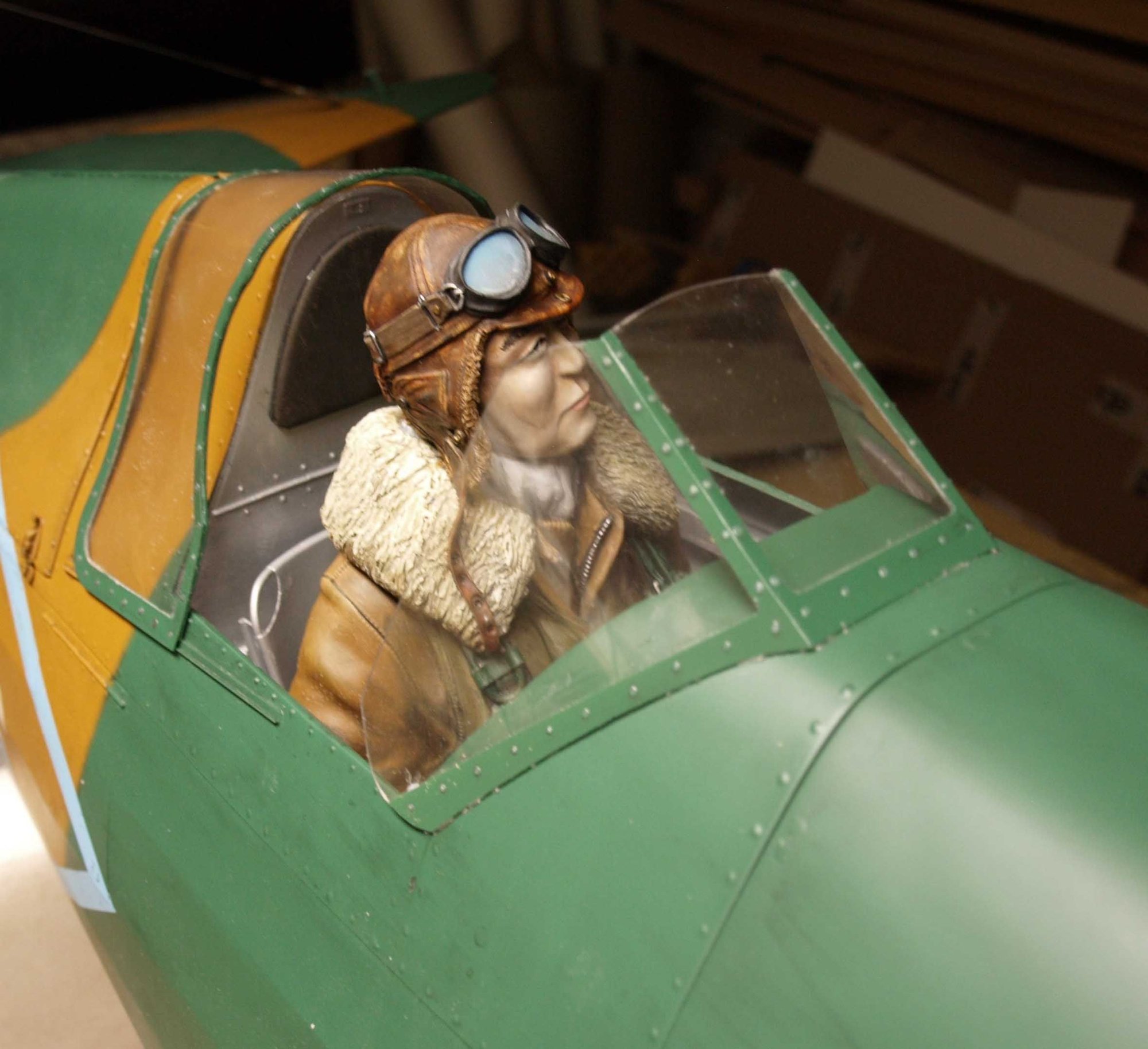

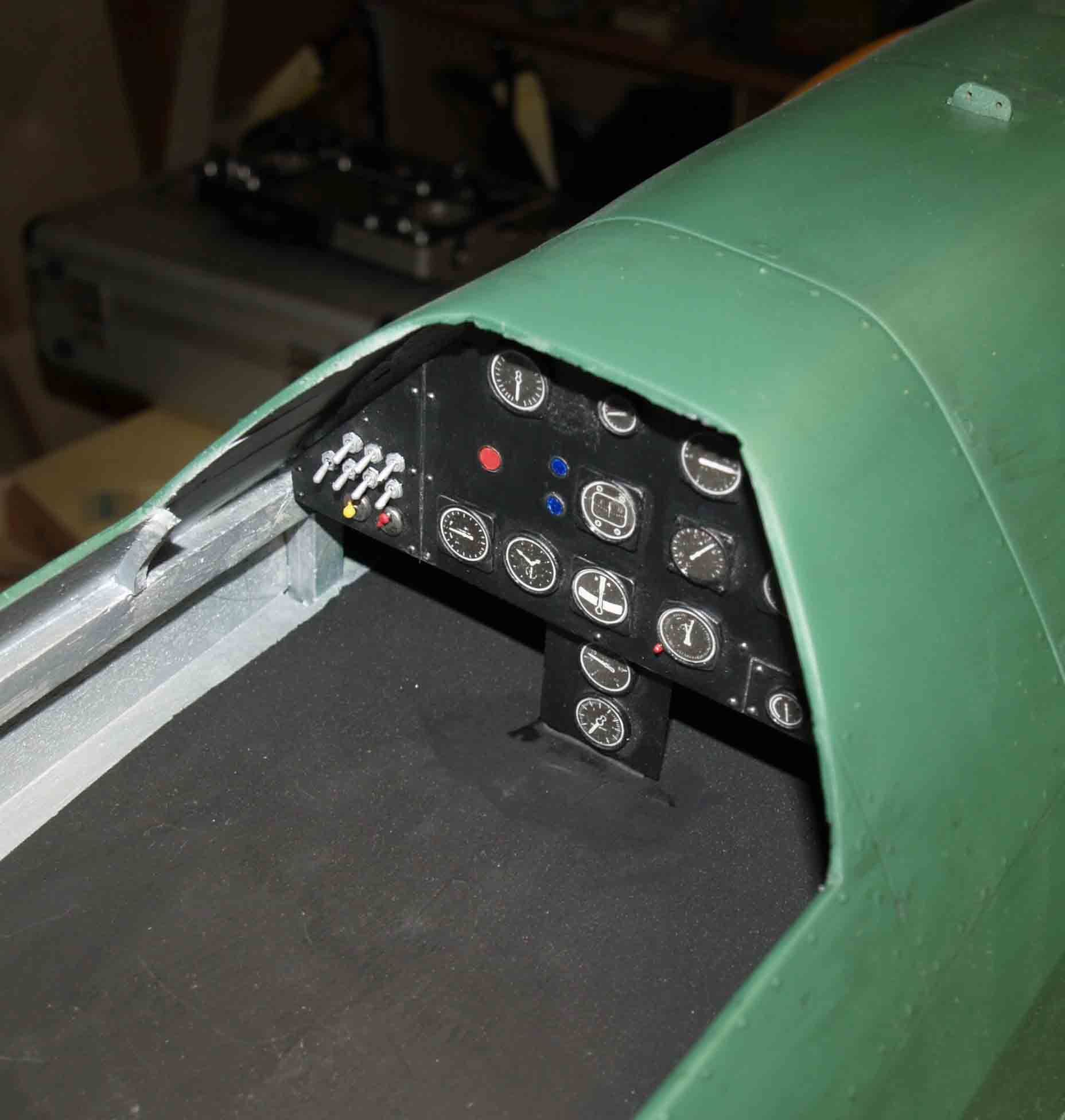

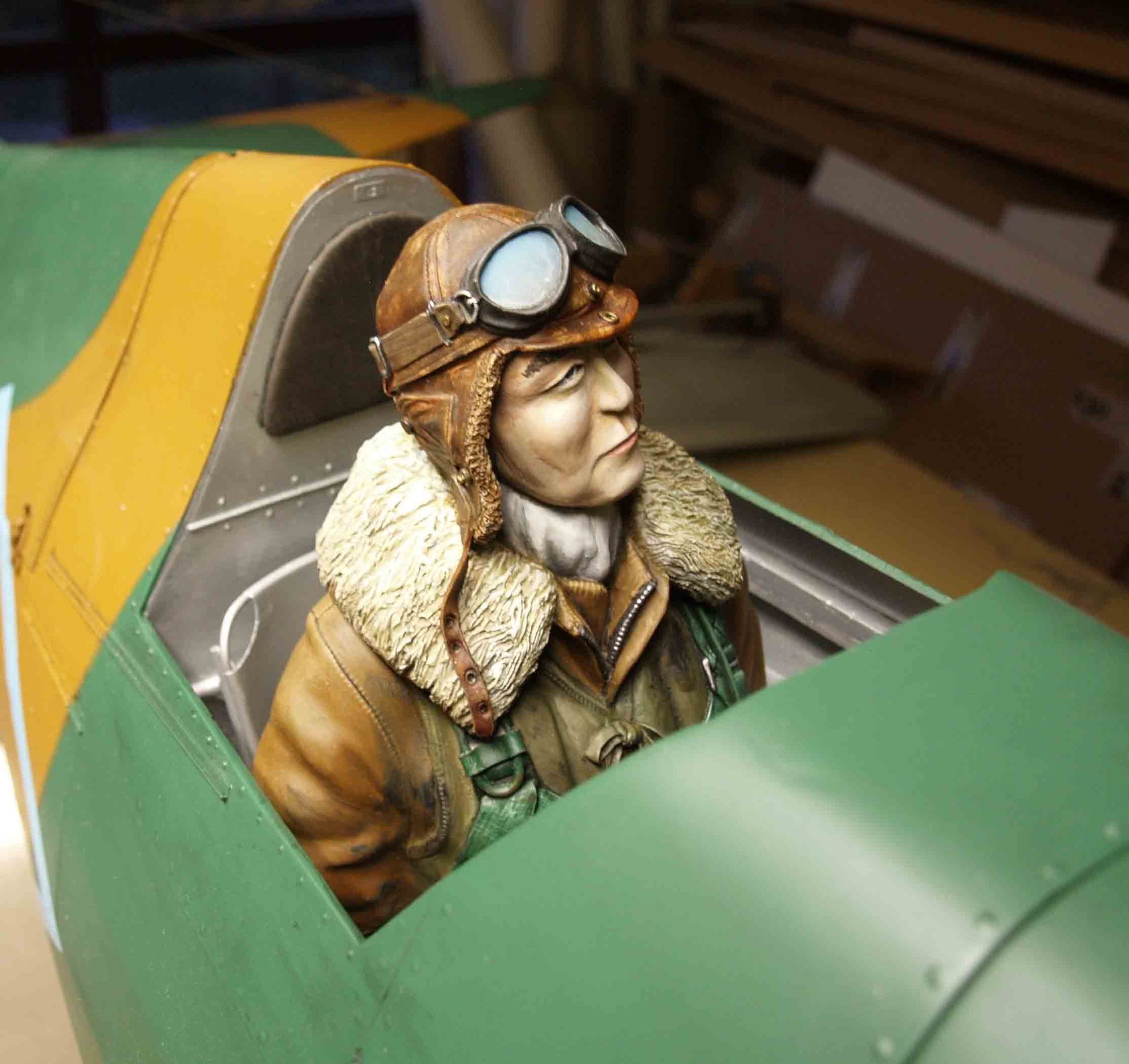

The pilot needs a seat.
it fits
An instrument panel is required for better operation
After adding the canopy and the wind shield, the pilot takes his final place.
For me this is one of the most exciting moment when the whole things comes a life.
For sure, there are many more possibilities for detailing, but I always will only do semi scale.

The engine fits in quite well with the dummy cylinders you have to look close to see the difference. The casual observer would take it the whole assembly as a radial engine.

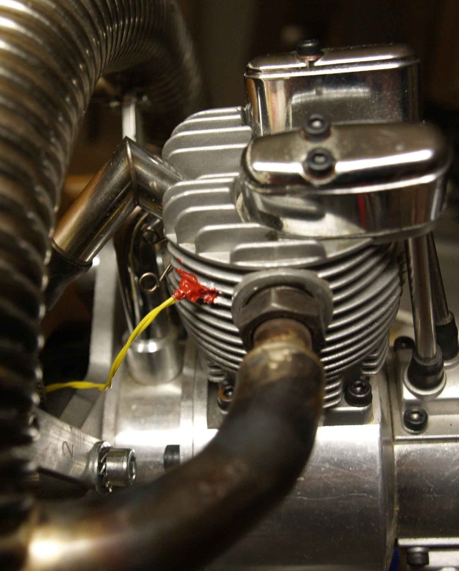

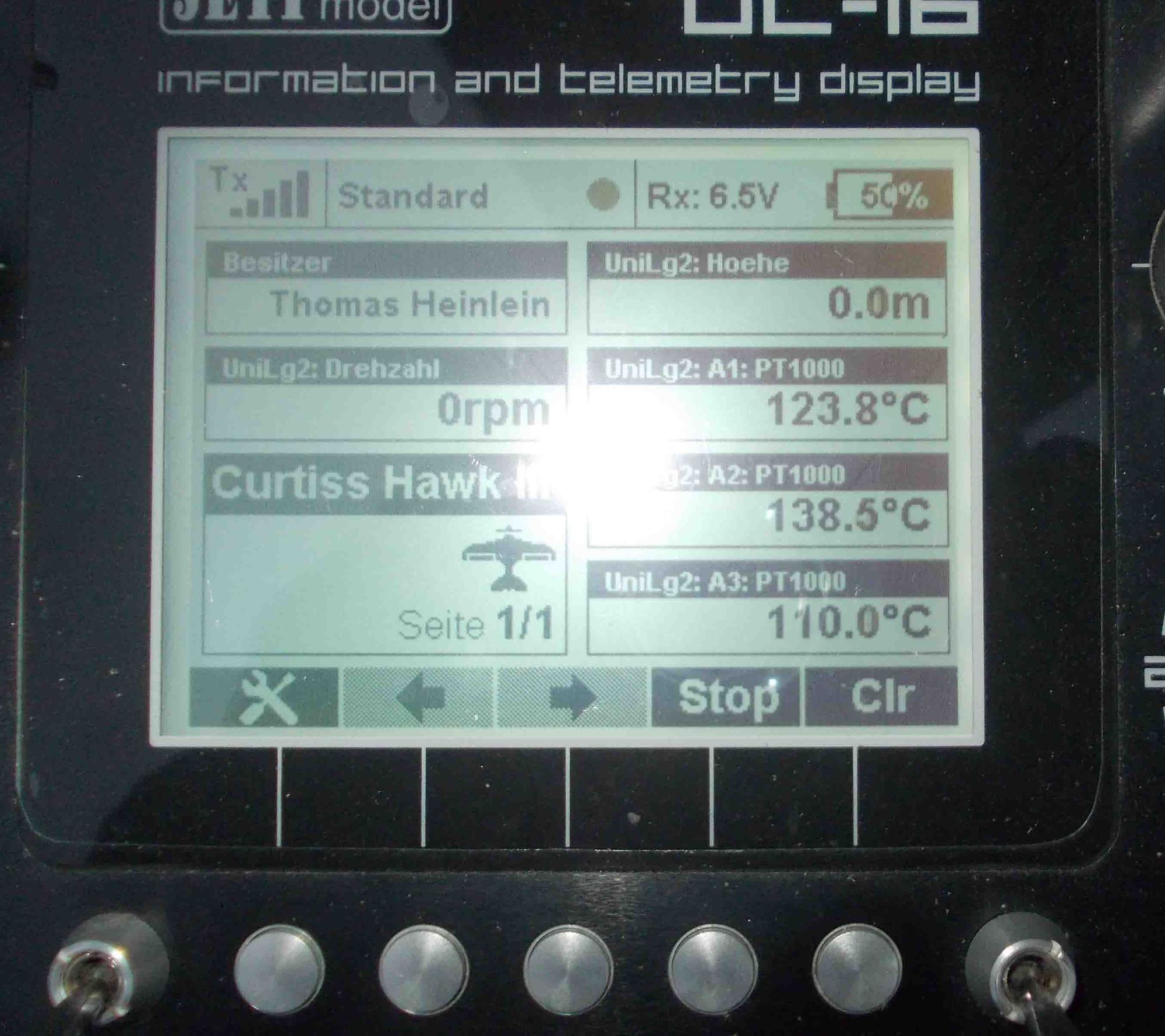

I installed the telemetry this days, temperatur and rotational speed monitoring.
Looks fine doesn`t it?
Today we celebrated on our airfield the end of the season, time to take it out into the fresh air. The air was very fresh, wind strenght in gusts up to 40 km/h.
there is a small video too, the sound is i.m.o. amazing
We also mesured the trust > close to 10 kg, I think this would be enough
I`ve done also some rolling attempts, it walks straight ahead, very nice.

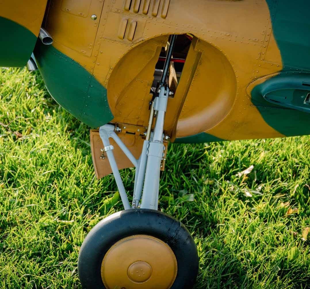

A friend lend me these cool scales.
The weight is okay, the surface load is close to 100 g/dm˛.
The CG moves only a few millimeters when I retract the landing gear.
I`m also very satified with the balance around the longitudinal axis

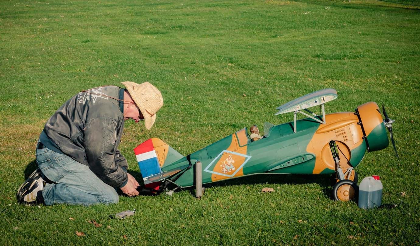

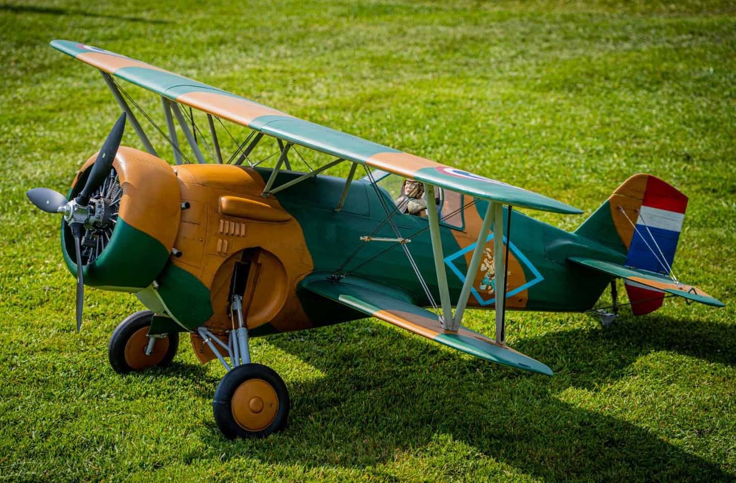

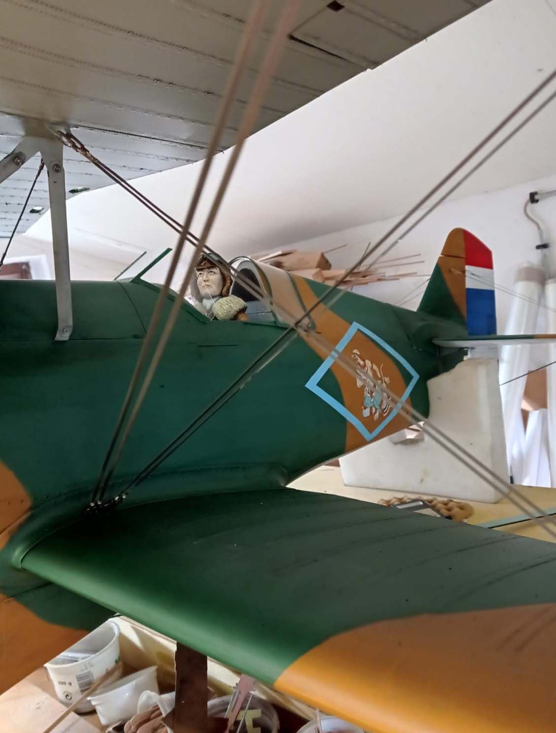

Yesterday I planned the maiden flight, but unfortunately we had crosswind at the airfield. Not very strong but I didn’t dare.
But a friend at least took some nice pictures.
Assembling took me 25 minutes, there are a lot of flying wires...

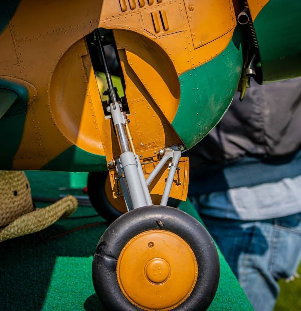

She`s a beauty, isn`t she?
Do you want some details?
The flight season is still young, I think it will fly in the next days.
