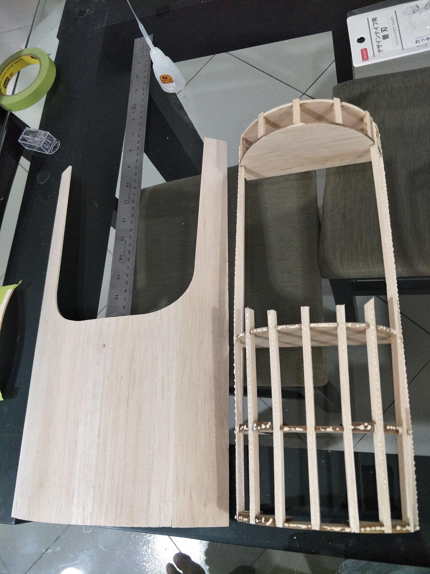

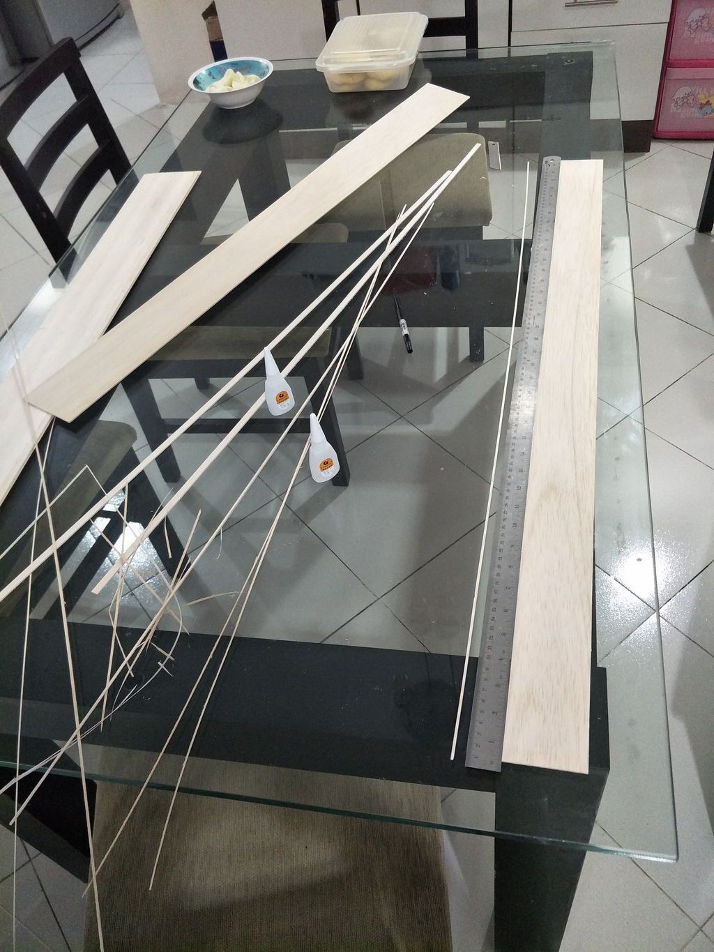

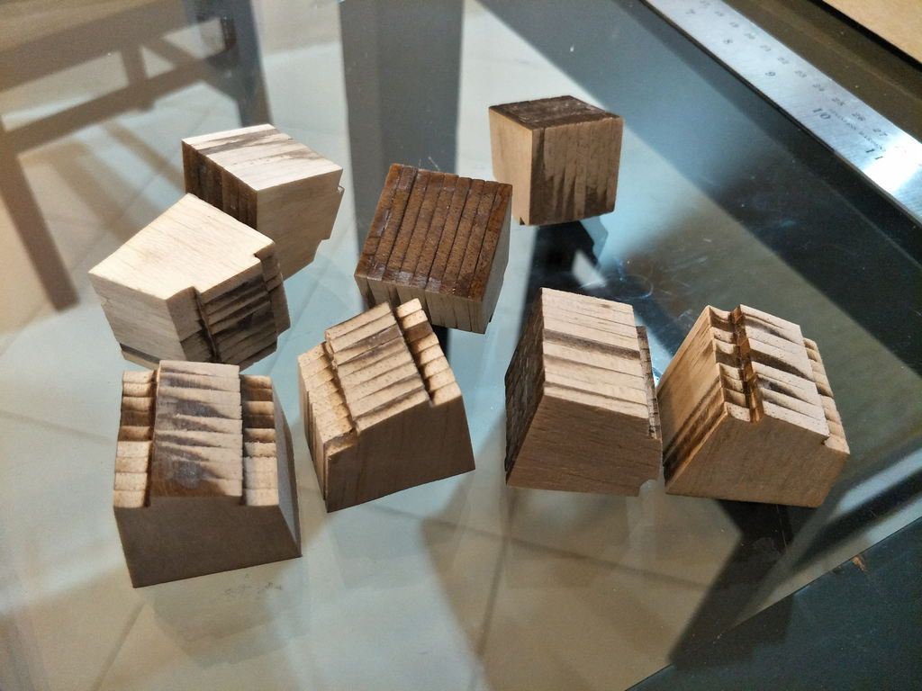

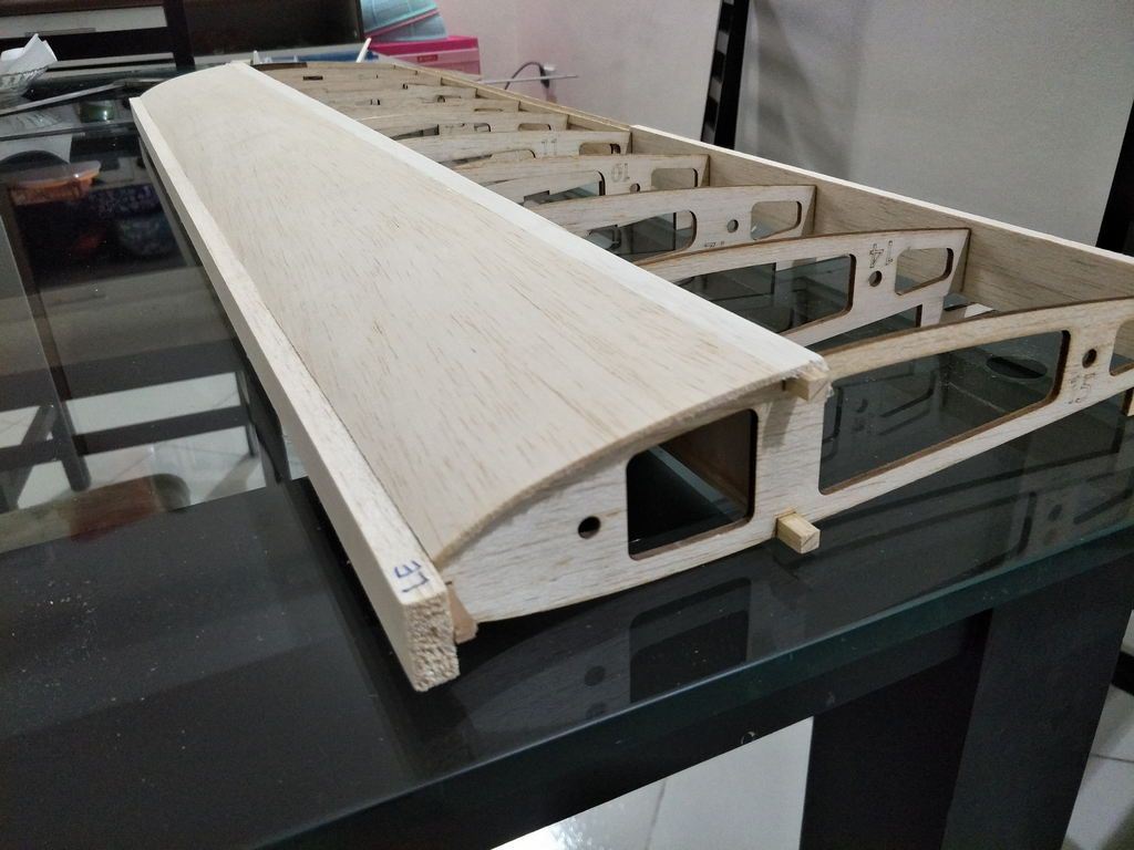

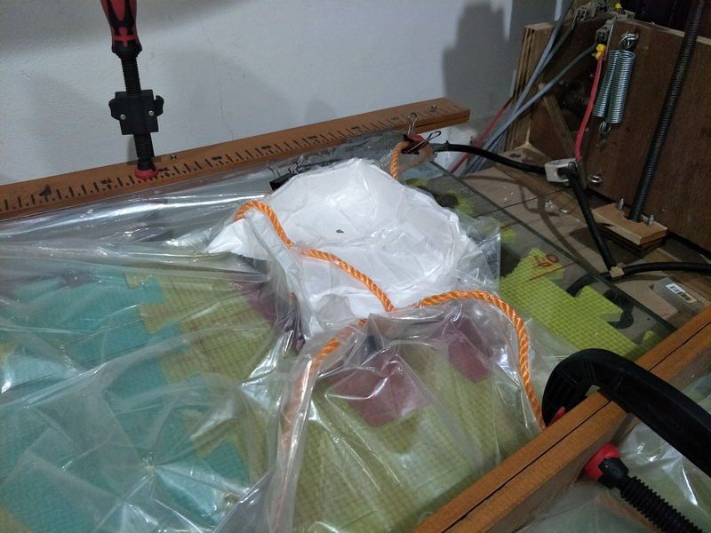

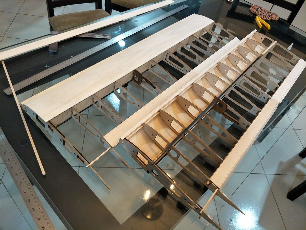

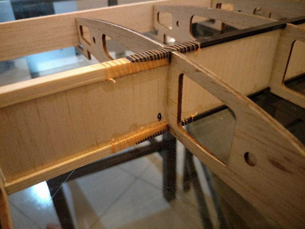

For the rib cap strips, I have always run the grain direction across the rib, just like the dbox sheeting.
However, this plane needs about 130mm cap strips, and I really hate to join the balsa sheets as its only 100mm wide. Say if I run the cap strips with grain direction from front to back (parallel to the rib), what disadvantage would I face?

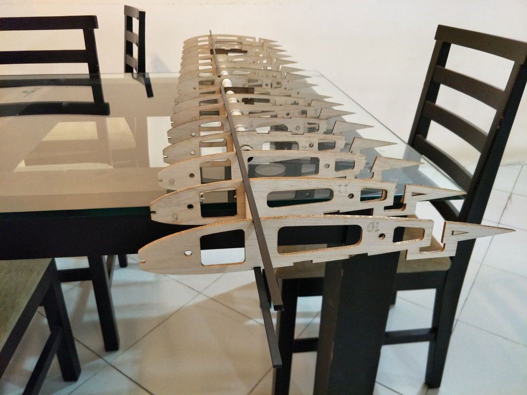

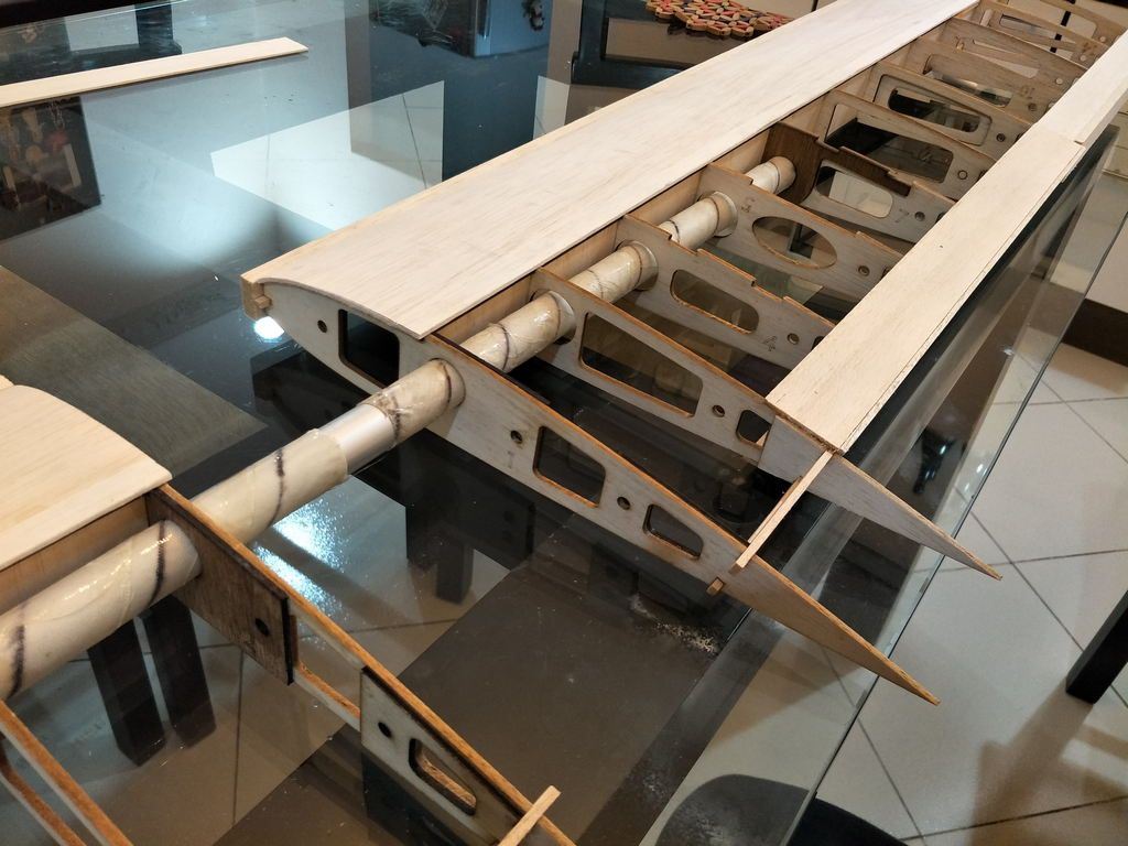

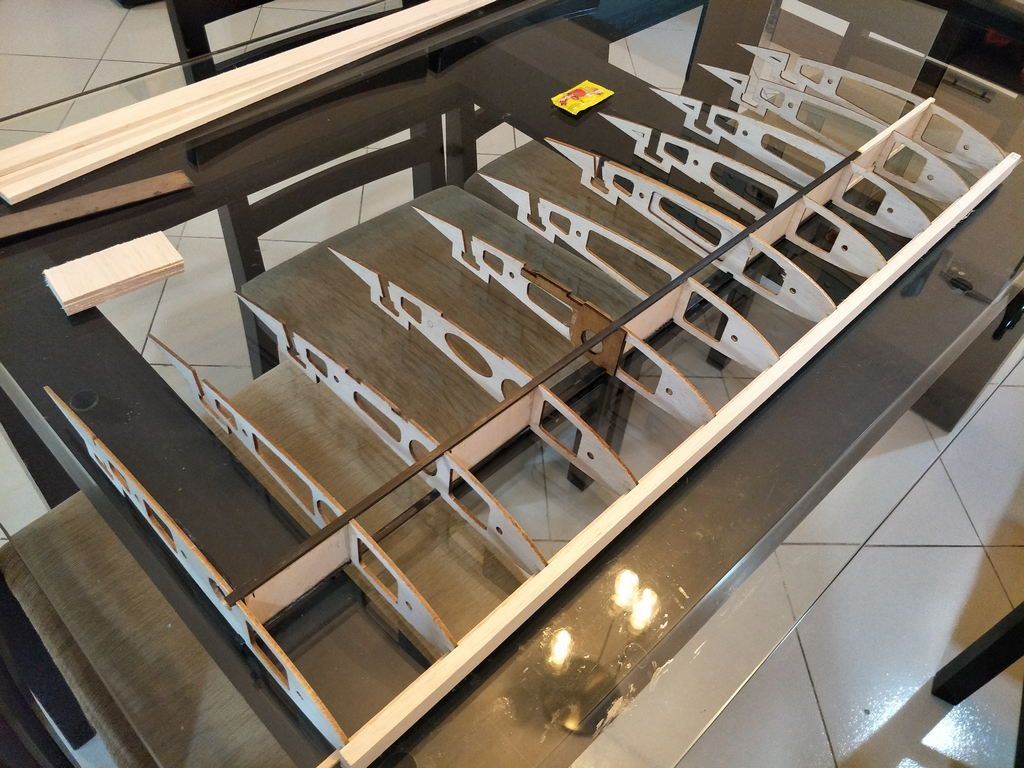

Cut two sets of ribs.

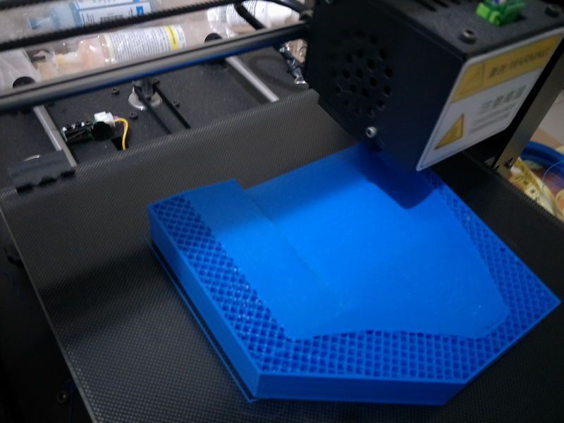

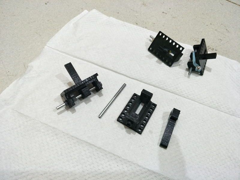

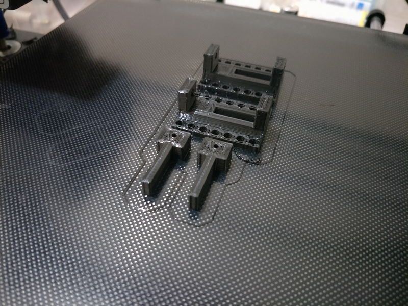

some tools 3d printed help with squaring the ribs, gotta build table with some steel.

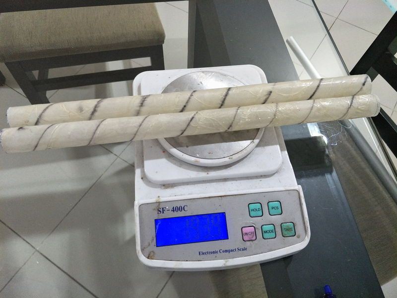

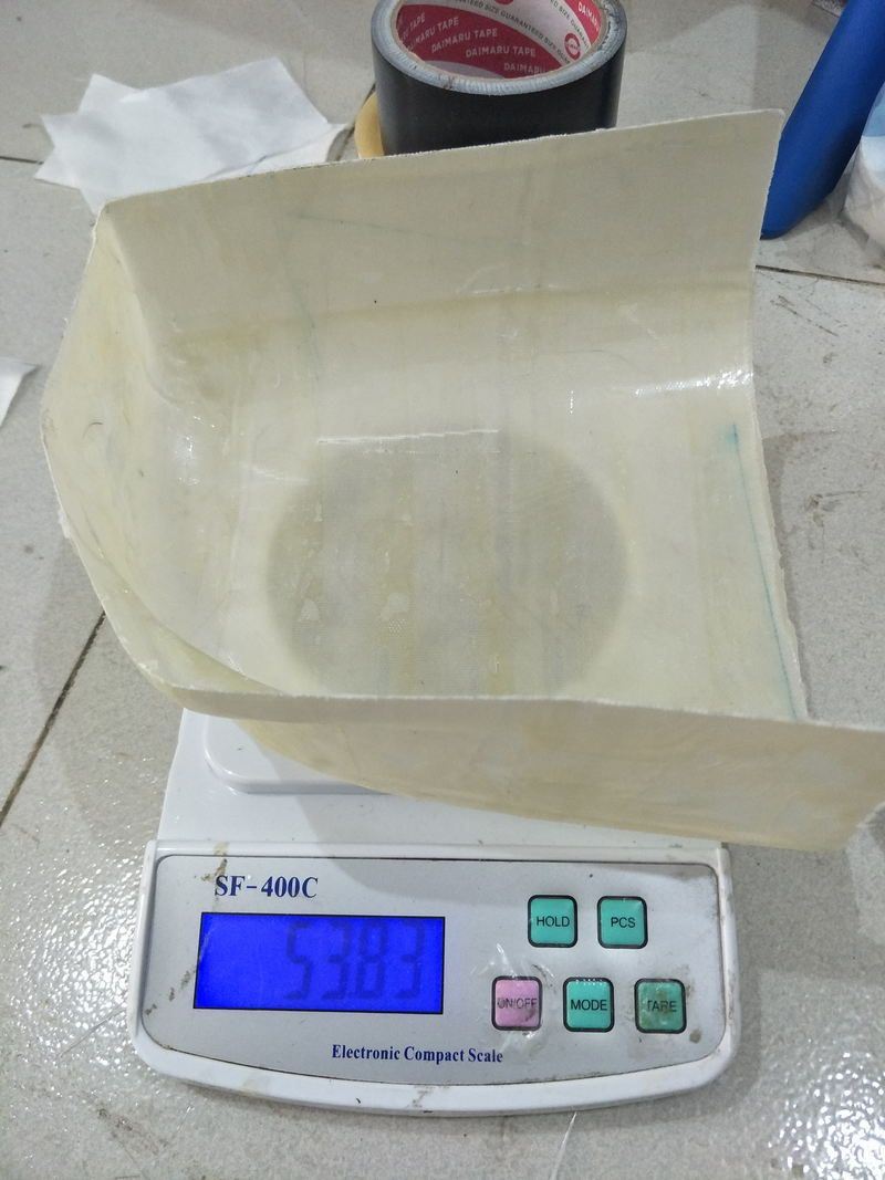

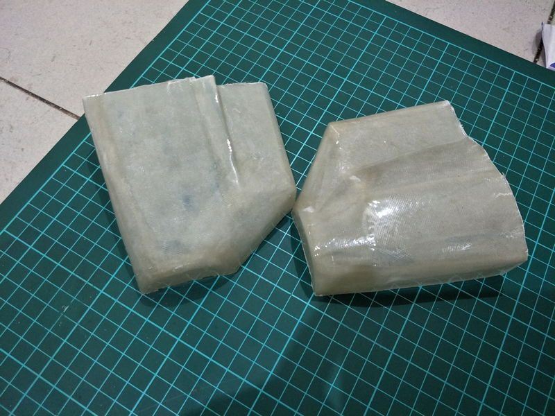

wing tube sleeve fits very well. Made from fiberglass and expoxy.
Test fit the tubes

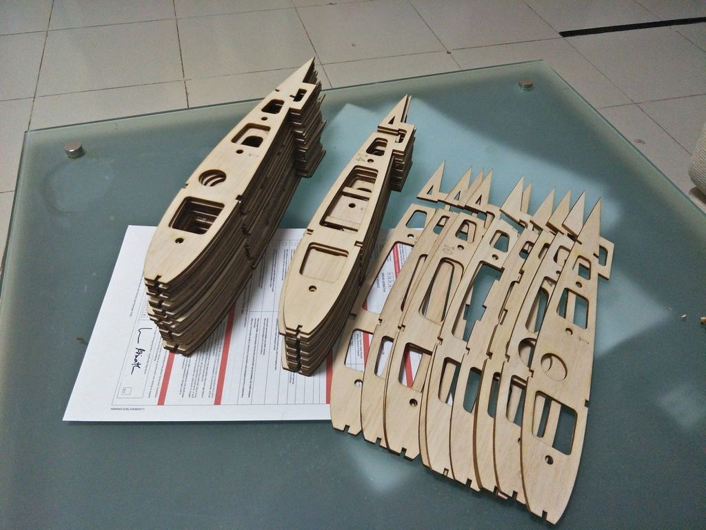

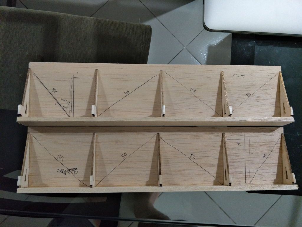

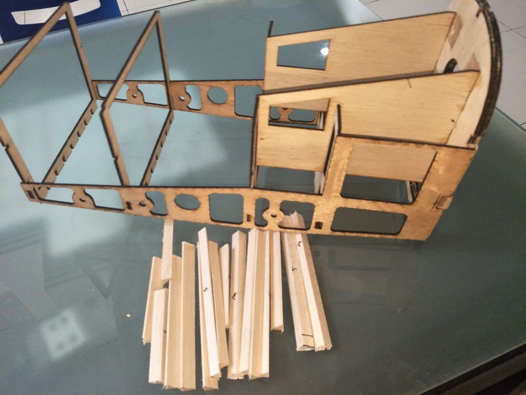

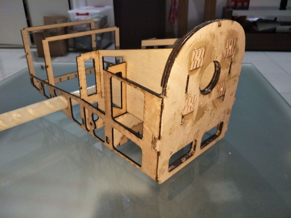

Cutting some formers and fuse sides. No light ply here.
Leading edge glued.

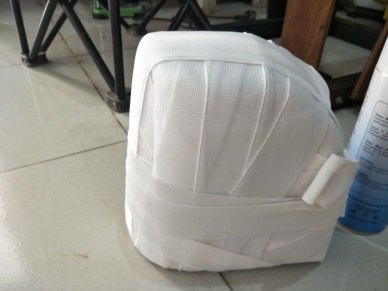

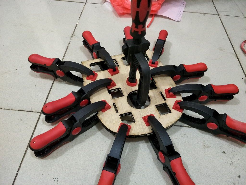

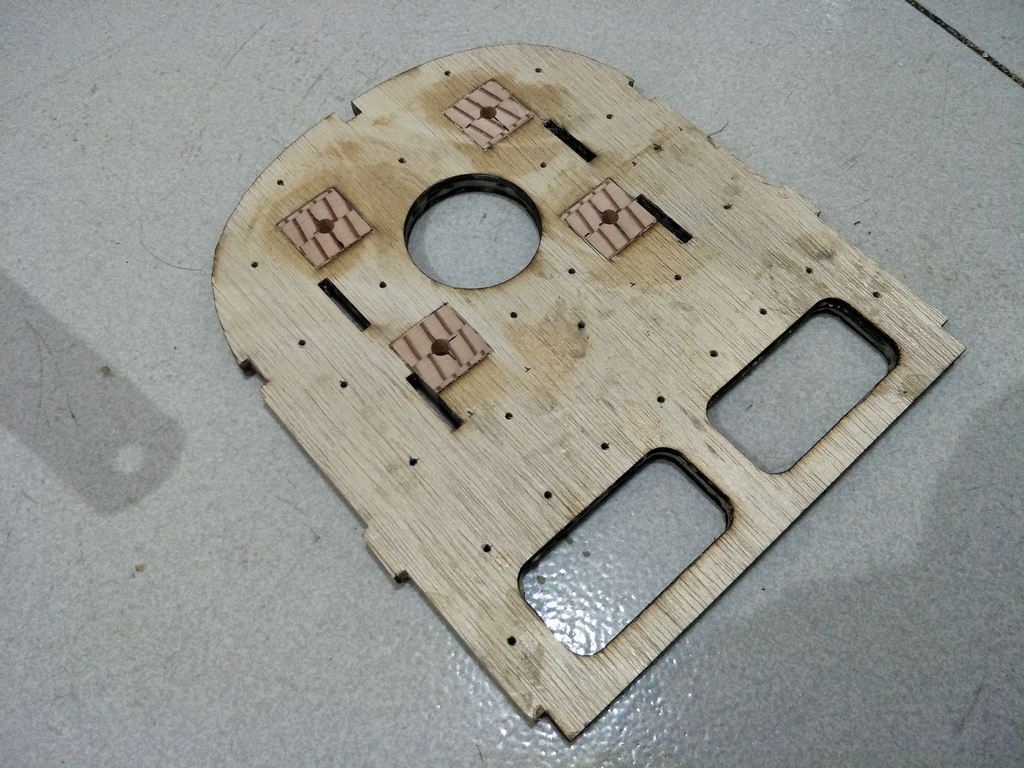

sandwiching the firewall with some carpenters glue.

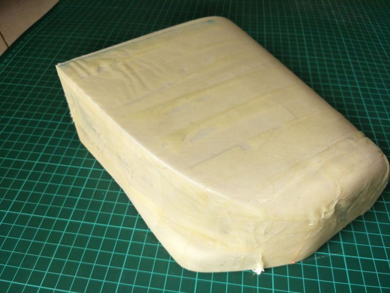

Inserts for the engine mount hard point. Made from imported Birch (or so the seller said). I probably shall use harder wood, but this one is already harder than the ply. I glued them to the ply with some 90mins epoxy.

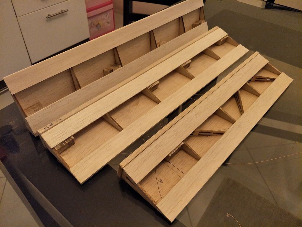

ailerons
ailerons and flaps withe sheetng, gotta glue some cap strips. I should have installed the 45 degree additional ribs of the flaps (wider ones).
Truing the sheets, then glued a bit more sheet to make up the width needed.
Glued it. With CA easy and fast.

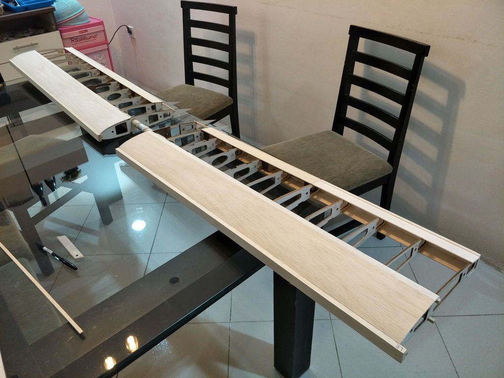

The length of halfspan is 900mm. I glued 3 pieces of 6mm widex1mm thick carbon fiber stick. Its only 750mm long, so I spliced it with pine I recover from used packaging material then I add some fishing line at the splice.
hinge mount point for the flaps made from used balsa sheets glued together, ready to be sanded
Sanded and fits ok.
glued with carpenters glue and tacked with CA, then I saturate some CA to wick. I might regret using balsa for the flap hinge with the plastic robart hinge. On my last build the whole right aileron came off !!! Somehow the hinge ripped off from the wood.
Test fit the tubes

Leading edge glued.
ailerons

small holes so I can soak the ply with CA later

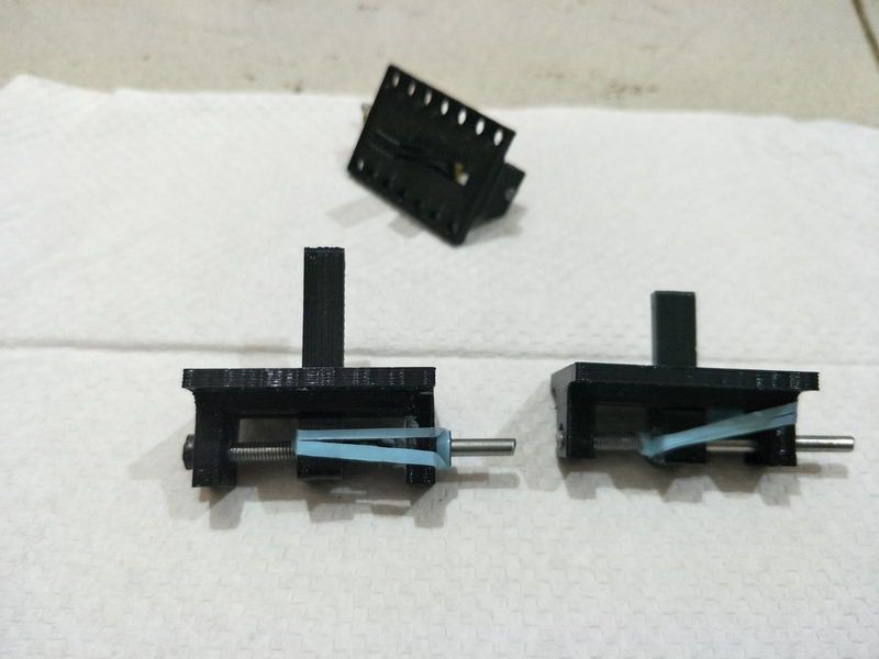

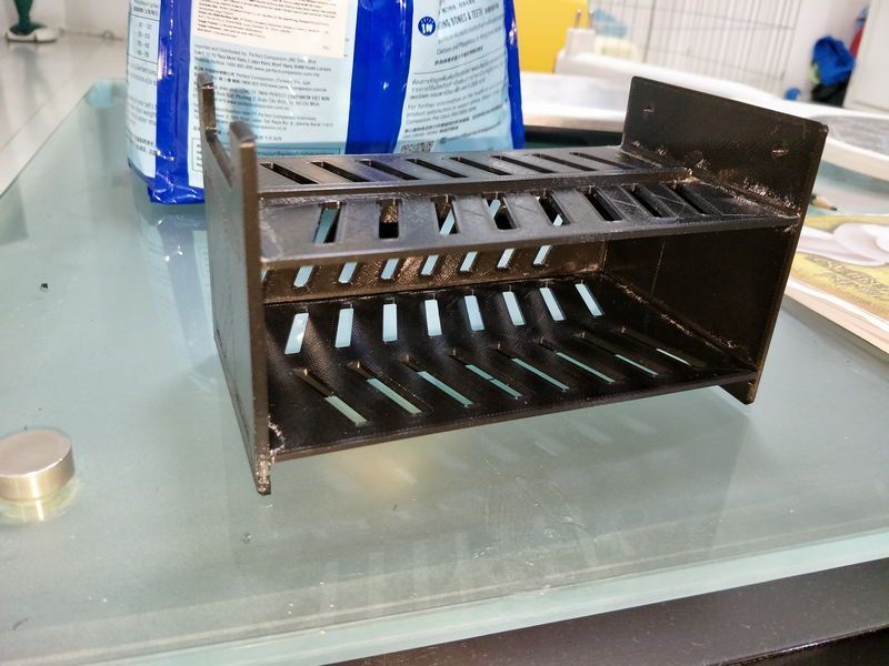

Some right angle tools I create and printed to suit the magnets
eyeball square.

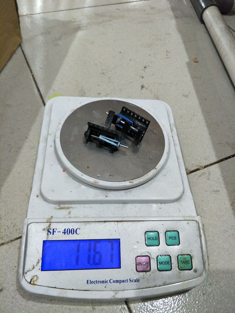

weigh abou 180 grams.
I managed to cut some cap strips, some hard balsa stick for the fuse truss construction, drill holes on the firewall so I can soak it with CA later on, break in the engine, made some right angle tools and install the magnets, tacked half of the fuse formers.

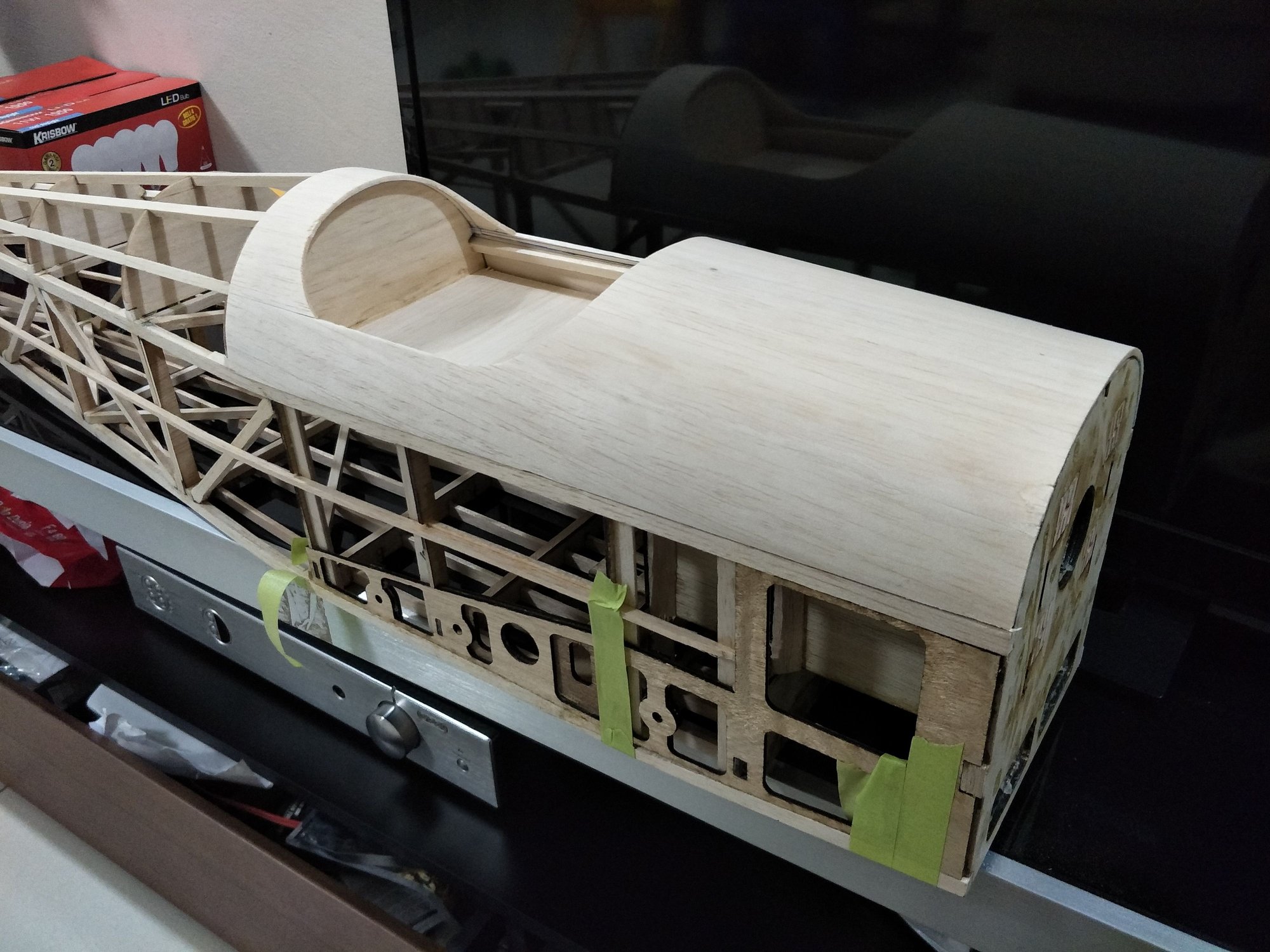

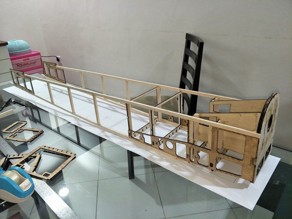

Made a little progress today building the fuse.
Cant decide if I want to keep the ply formers after the wing. I will have to reinforce with balsa sticks anyway. However, I cant find a way yet to align the tail properly without the ply formers.
I am thinking to use the formers as the momentary jig and remove them after I glue the truss structure,

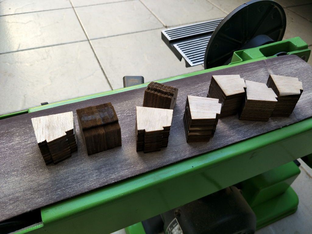

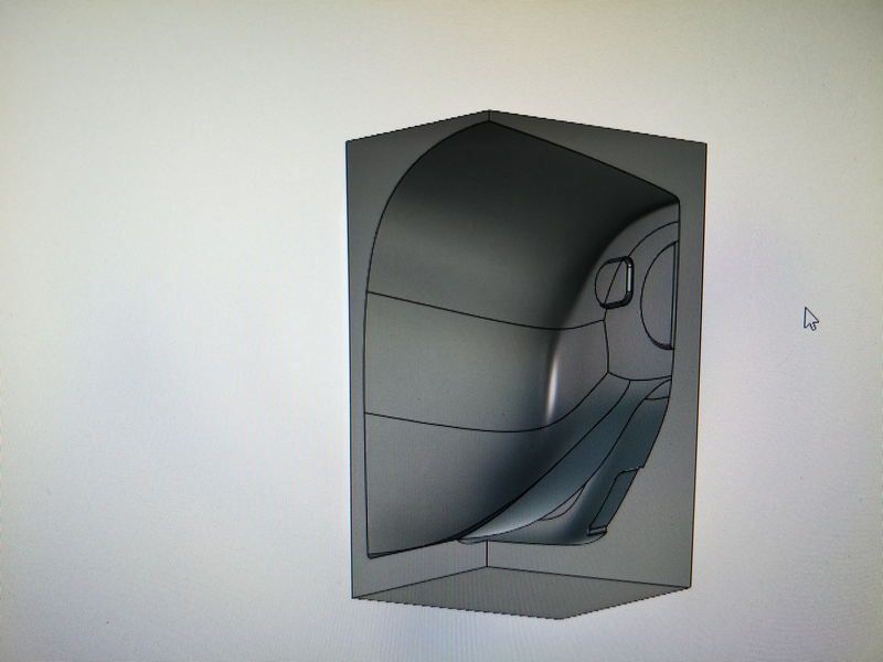

Cut some triangle stock with 3d printed tools
i fill the seams of the join with some epoxy so the plys will soak in, it was just tacked using CA. Then I glued the striangle stock with carperters glue and tack it with CA.
Some progress today. I am now thinking of best way to align the tail without proper tools The fuse now weight around 280 grams. The front part is quite sturdy and stiff.
Test fit with the wing. Its quite big but small enough for easy transport.

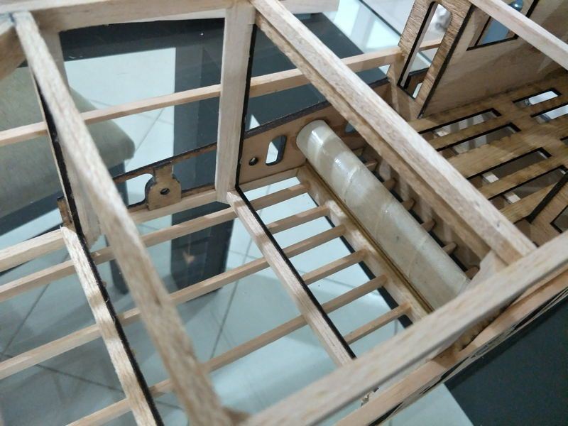

I only managed to install the wing tube sock reinforcement on the fuse, as well as the rear main gear mount. I had to cut new mount since the first cut was 6mm shorter !
Its a bit soft and springy right now, I might have to reinforce it with some spruce stick.

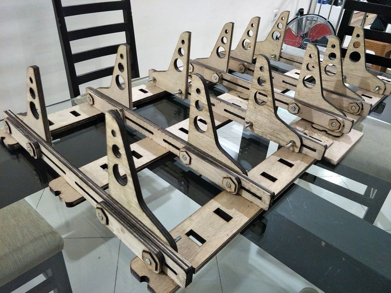

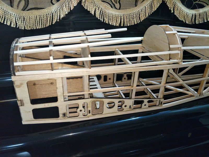

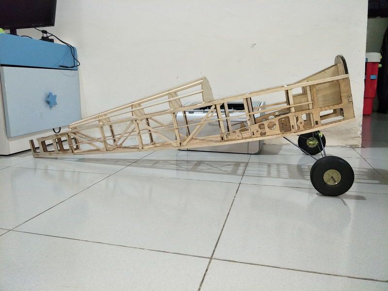

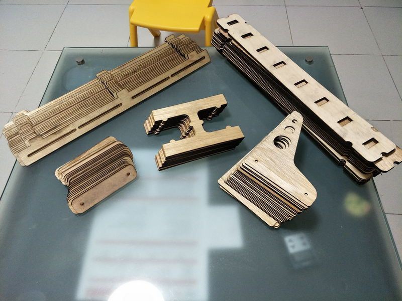

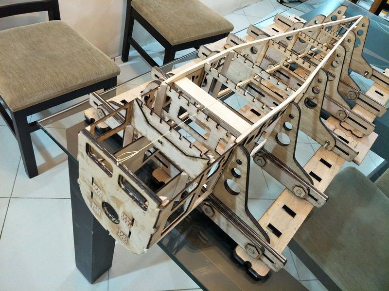

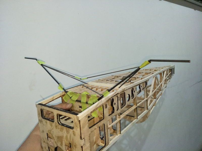

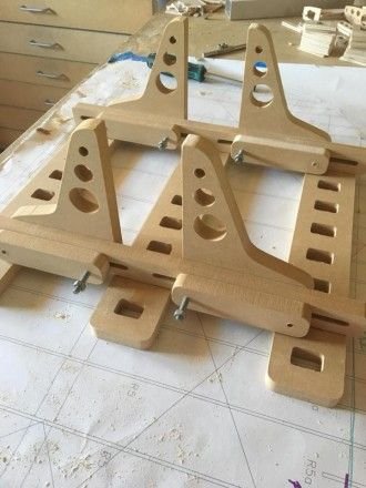

For the fuselage, I decided to cut a jig for it.
Found the plan on aerofred (search fuselage jig)
It seems to be nice since it looks to be able to be extended with a joiner.
Gotta get some material for it, cutting and gluing will probably take 2 or 3 days time.

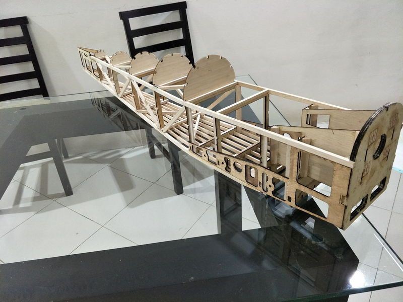

Phew... cutting the jig from 3mm (1/8 inch) ply and gluing them takes a total of 5 hours....
Thanks Barry for the plan https://aerofred.com/search.php?search_terms=all&search_keywords=fuselage+jig
The fuse is "eye-balled-straight", well not really eye balled only, I pulled a string from the firewall and make sure everything is straight.
The rest was easy.

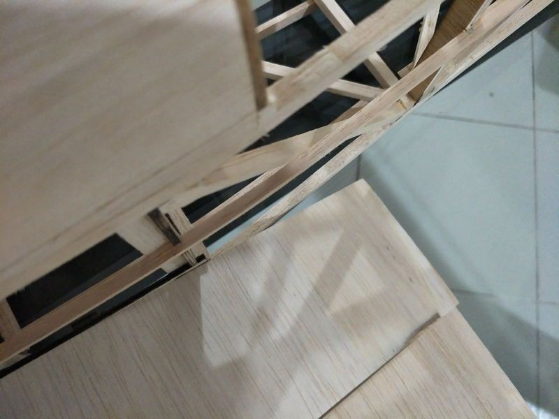

I reinforce the back part of the ply formers with some triangle stock, I should have removed the ply formers.
The fuse is now 400 gram. With turtledeck added, some servo mounting ply, and tail it could weight up to 700 grams at least, not counting landing gear.
The truss is a bit too much, I probably should have used 6x6mm balsa instead of 10x6mm. If I trim the truss, I might be able to save something like 50 grams or so.
The wing is now 800 grams.

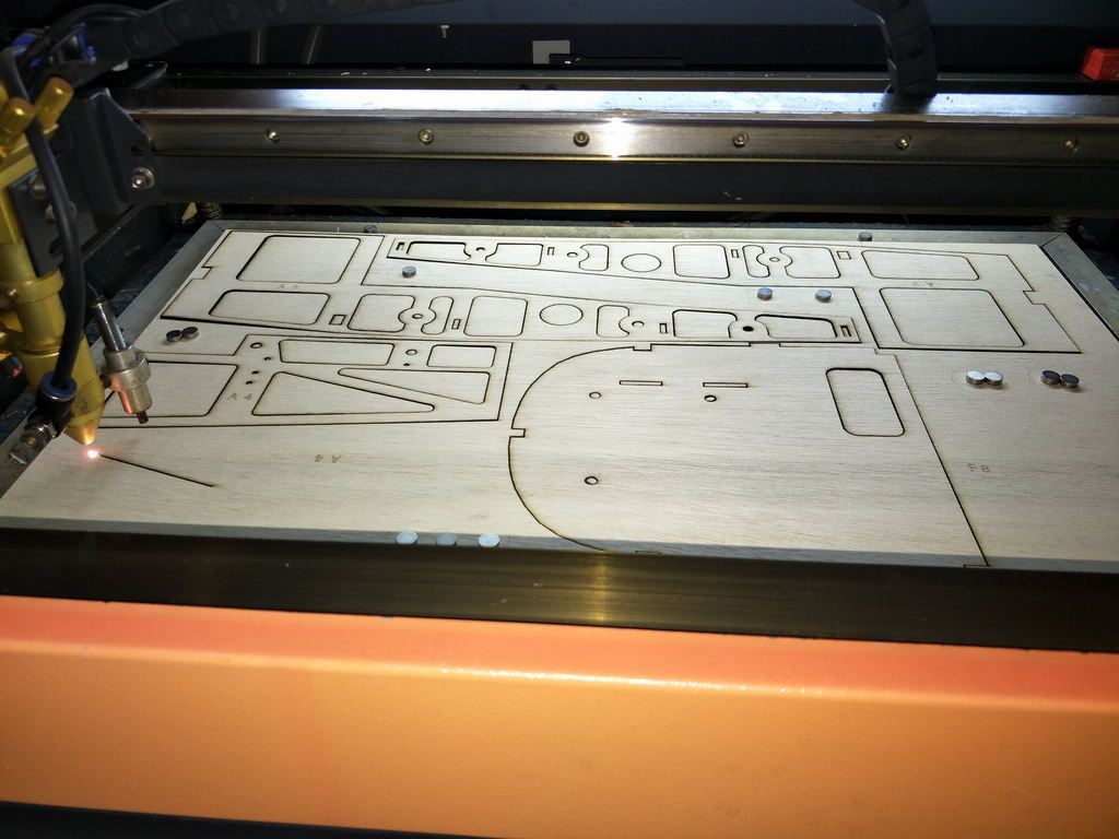

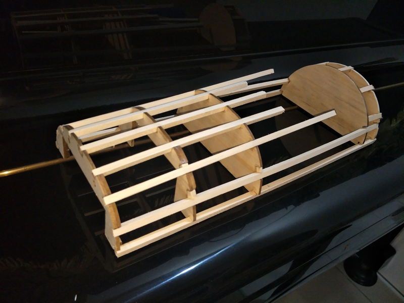

after 3 hours of cutting
quite rigid, since my laser cutter only goes up to 50cm width, I had to modify the plan, and the result is only 200cm width of building space. I need to modify the vertical arm to allow wider build.
on the jig upside down
looks nice but 400 grams is a bit heavy

16 days and I only got this far
However, progress is progress.
I didn't like how thick the balsa I use for the truss.
The fuse weighted 393 grams, I thin out the truss and saved 16 grams.
Then I removed some more balsa and ply formers part where I don't think it adds structure strength.
At 369 grams, I saved 24 grams, not bad...

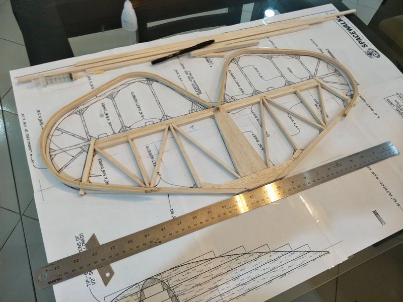

created a jig for the rudder and elevator trailing edge,
and used 3 strips of 2mm balsa to create the trailing edge.

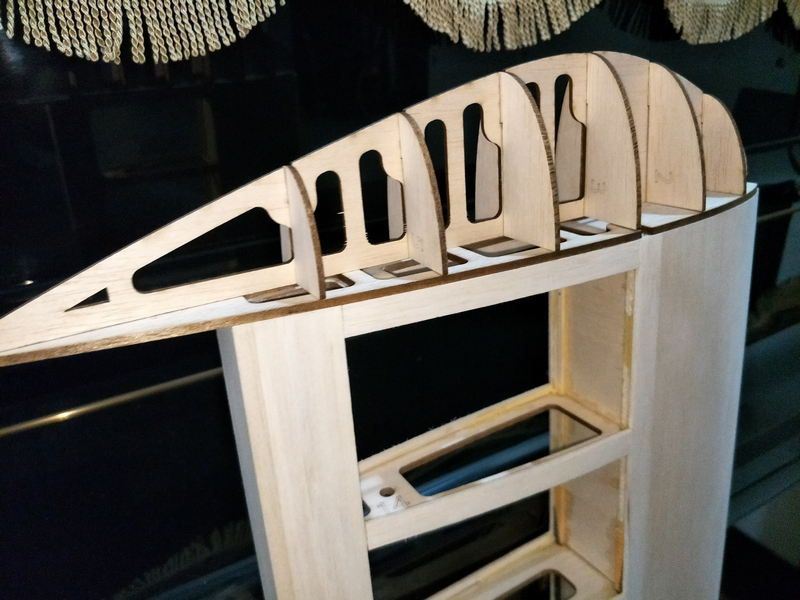

I managed to get the vertical tail and rudder done mostly, at 25 grams total I am very happy.

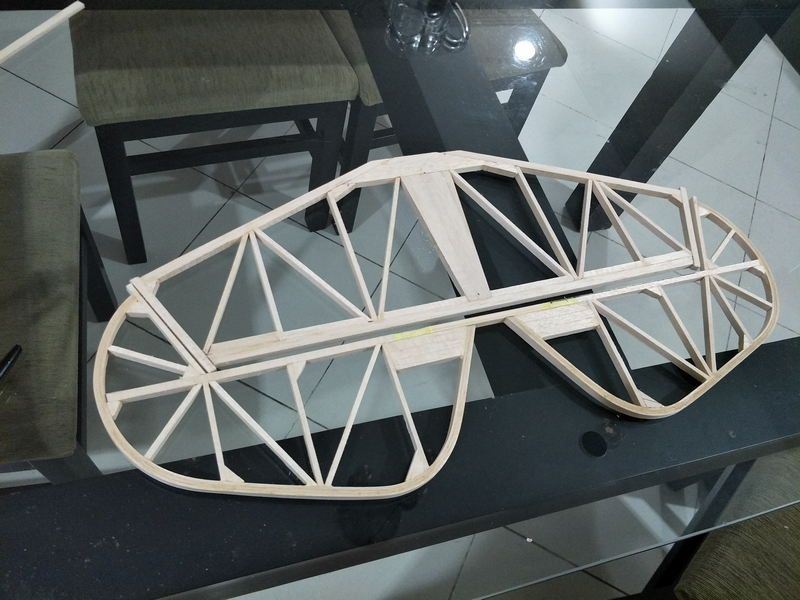

I cant decide on the horizontal tail yet, the plan call for stick construction, however I have created some holes for the spar and draw detachable stab with ribs.

I have sanded the wing, and overshoot the trailing edge at the root Repair underway.

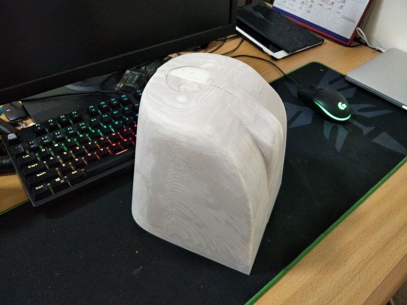

I have been learning Fusion 360 for the past 3 weeks.
I managed to draw the cowl in 3D and made a negative mold from it. I plan to 3D print negative mold.
I am sure its difficult to make smooth surface finish with the negative mold (putty, painting, polishing, etc).
Unsure how the epoxy will react to the plastic, I made two test pieces, one I will spray release agent directly, the other one I plan to cover it with some packing tape then lay the fiberglass.
If I can pull the cowl out, I can just do some finishing to make it looks good.
In the end if everything else failed, I can still print the positive mold, and have a friend to make the negative mold just like how it should be done.
I started to work on the stab, should be done tomorrow. Its 24 inches wide I decided to follow the plan, not removable.
It should be lighter, plus I don't have the need to carry the plane out of town.
I was going to have each elevator controlled separately, servos at front and use pull-pull.
But the extra servos and setup would not be worth it, its supposed to be relaxing to fly and does not need the extra hassle.
The plan call for 1/4 balsa as the leading edge for the elevator, I plan to use hardwood instead for the joiner.
Negative mold of the cowl.
I follow the plan for the stab, unremovable
24 inches ! Small enough to fit my car.

I finished the elevator this afternoon... It took me almost 2 hours.. too slow but I enjoyed it haha.
I love the sandwiching thinner balsa part to form the shape of the elevator, should have done that million years ago..
I made a mistake with the elevator.
I used "harder wood" for the elevator joiner at the splice I wrap PE fishing line and I just realized that I need to bevel that part .......insert dumb moment here...
The splice was glued using carpenters glue and now comes the dilemma. Should I just bevel the elevator part thus destroying the thread wrap, or bevel the stabilizer part ?

I have sanded the stabilizers, mod the fuse and install longerons for mounting the horizontal stabilizer, created the wingtips (havent glue them yet), fabricated the landing gear with some K&S steel. Soldering is not hard, the finish is acceptable for now and I hope it will survive many landings
Next I need to create the bottom hatch for landing gear access, top front hatch, install the wing tubes, preprare servo mounting for the wings, and it should be be ready for the cover.
3d printed the duct.

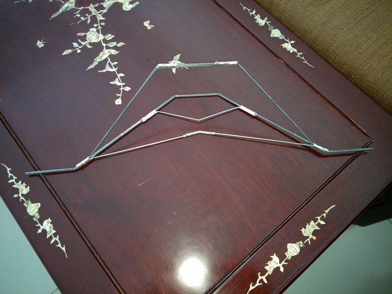

fabricating the landing gear
wheels seems a little to big
soldered

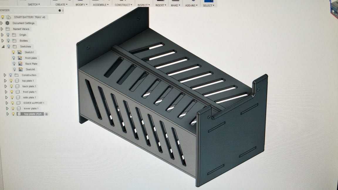

My new starter arrived designed and printed the battery tray. Old ones barely turn 30cc dle, new ones turns like its not there
Looks like its a small scooter starter, modified to be used with rc airplanes.
I got a bit of time to start working on the hatch, The slot for the longerons does not match, I had to re cut using exacto. I hope I got time to make and form the skin tomorrow.
The second longerons does not really match the slot at the back, i just notice it after they are all glued.
I wet the parts and mount the hatch on the plane while holding the hatch with some tape, hopefully when its dry it will conform more or less.
Designed the tray using Fusion 360, I think its the best thing I have learned doing the past 2 years.
printed, glued.
mounted, and portable.
some formers for the hatch all balsa.
the second longerons pulling the whole hatch assembly upward at the back, I wet it, and secure the hatch on the fuse with some tape. fingers crossed.
printed, glued.

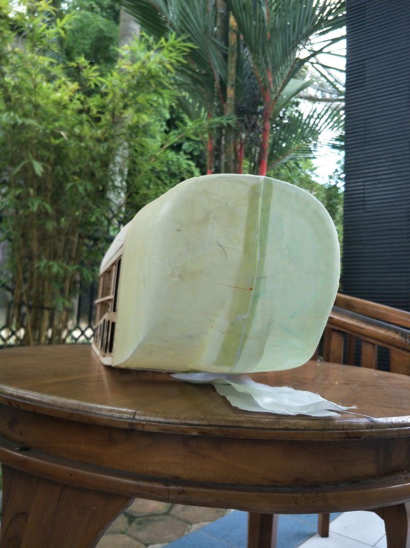

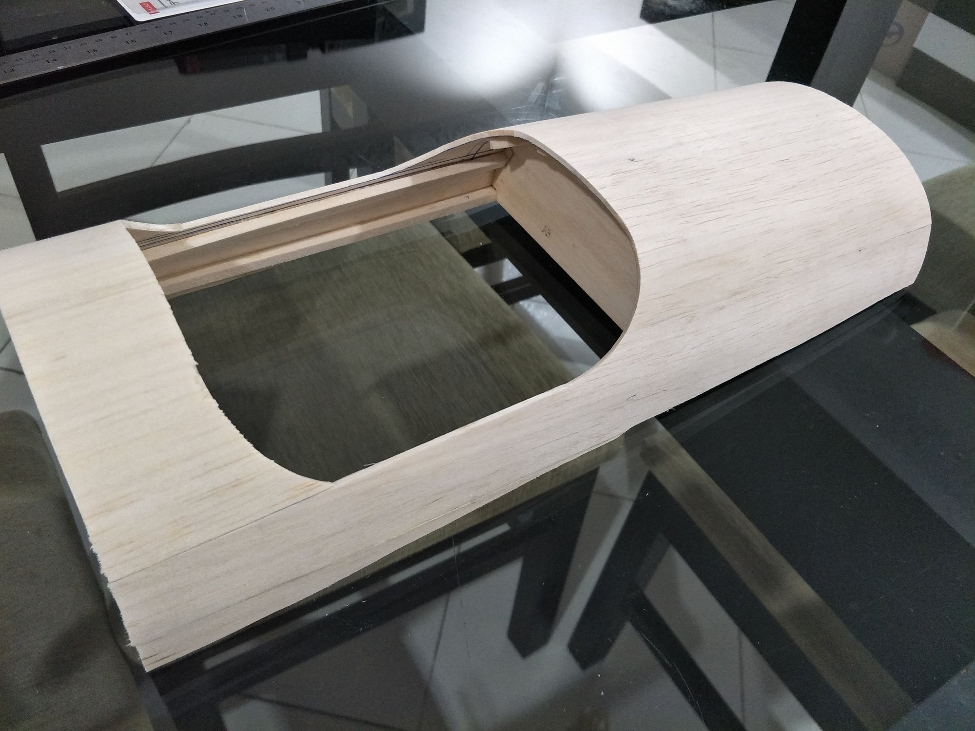

Hatch is done. The weight is 61 grams all balsa, I am happy with it.
The skin is made of 3mm balsa, didnt wrap it long enough but the balsa is soft enough to bent.
I need to make some hatch latch and hide it inside at the base of the hatch.
I need to buy leather for the canopy trim, i will install it after covering.
I will weight the parts before covering.

Progress!!!
I needed latch for the hatch, however its no where to buy here, I downloaded from Thingiverse but its too big, I recreated it with my needed dimension, and had to use my daughters hair rubber band as I could not find any unused spring from pen.
The first version does not slide smoothly, as the rubber is pulling the pin towards the base and had the pin thread to scrub against the hole, I made second version, and installed short carbon tube accommodate a more horizontal rubber pull, now its acceptable.
I have installed the wing tubes and also the tubes at the body. The weight is light enough to make me happy
I just realized I need to extend the trailing edge to flush with the body, I will add 6mm balsa and sand.
The plane looks quite big now. If everything according to plan I should be able to maiden it in 2 or 3 weeks time.
I weighted most of the major parts now
1. Fuse with hatch is 510 grams
2. Vertical Stab and Rudder is 23 gram
3. Horizontal Stab and Elevator is 55 grams
4. Wing Joiner is 130 grams, I should have waited for lighter carbon joiner..... now they are different diameter.

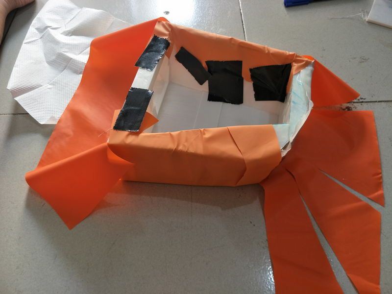

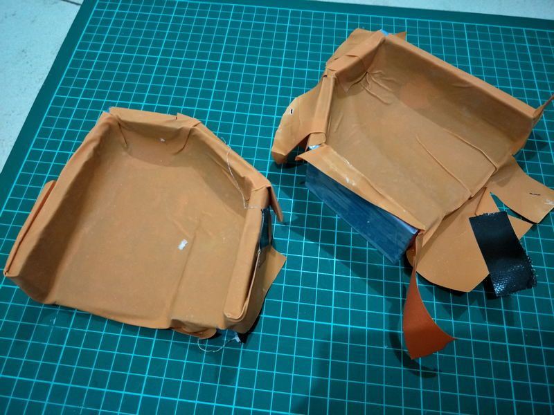

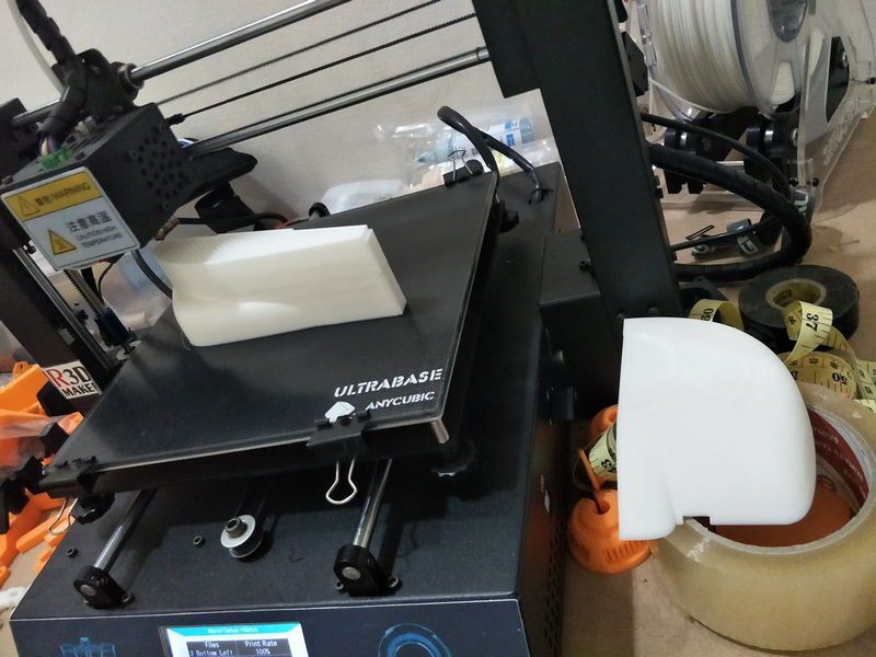

Mean while, I worked on the cowl it self, I printed the cowl as a two part positive mold, glued them together, fill them with car fillers, cover them with packing tape, laid fiberglass differently on each half and I found its easier to work with smaller piece of fiberglass
(For my future reference, I used 35 grams of epoxy on each half, I must apply the epoxy on the fiberglass before laying them on the mold and must absorb as much epoxy as possible with towel paper, also with packing tape, PVA is not needed)
The amount of resin is easier to control, as a result the second half has less resin and weigh a little less.
I could do better on the second cowl run, as I just found out the cloth that I used as wrap does not allow any resin to go thru..
I wrap the mold with some stretch rubber fabric and opening them later feels like Xmas Whats better than unwrapping two presents from my self to my self
Pulled them out from the plug rather easily, next is to join them and paint them. I will bring the cowl to my friends house and see if it fits fine
After the second cowl is done, I will send the positive mold to a friend that work with fiberglass boat. I will ask him do the negative mold.
I am sure I can get better results that way, since I can control the thickness of the inside part of the cowl where the holes are, and keep the outer surface level.
printing mold
CA glued
Filled with car filler
wetting cloth
wrapping with nylon cloth
Mummyfied
opening the present this morning.. can see the unevenness of the epoxy
opening second present
Too much epoxy
Much better
Looks like a cowl now
printing mold
CA glued
wetting cloth
Mummyfied
Too much epoxy
Much better
I printed negative mold for the spacewalker, the surface is not smooth and I know it will requires me do do some filling later with the final product.
So I printed another smaller cowl for experiment, its for a local rule pylon racer , I have been wanting to give it a cowl since two years ago Its a good opportunity to learn and see what I need to do differently, plus I must conserve the difficult to get thin epoxy.
Its not bad, just need some finishing, it came out pretty light as well 28 grams, total epoxy used was around 12 grams.
Currently I am joining both half in the mould.
Sharp corners are not a good friend My vacuum did a good job tho.
