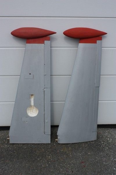

I need your opinion on my own designed jet, does it looks like it has too short tail moment ? What do you think.

I wouldn't say the tail moment is too short but IMO being a V tail as it appears to be I think the tail area is a bit small.

Yes it is a V-tail , and wingspan is 2 metre .

Nils, I designed a similar scratch built jet several years ago for glow ducted fan. I built several profile sub models to determine the tail angle and area. These were made from thin ( 2-3 mm) balsa and hand launched from my house deck. I determined that a 70 * included angle on the tail worked, ie, glided, the best. Also, made several tails and experimented with the different sizes and areas. The sub-models were scaled up for the flight model which flew very well. It was powered by a Turbax fan unit driven by a Jett 50 DF motor. I'm currently thinking about enlarging it 125% for a 2.5 or 3 m wingspan to be powered by a Wren 44K turbine. Good luck on your project.

Thanks Art . What do you mean by 70 included angle on the tail ? Is that the V angle ? I have 120 degree on this . I will use my simjet 1200 on it. I have started to build so i can roughly see how it will look , the wings will be balsa sheeted and the whole plane glassed

The included angle is the angle on my jig/fixture to set the incidence of the tail. This is 1/2 of the angle between both tails or 140 degrees. Sorry for any confusion. .There is a direct relationship between the angle and the projected areas of the horizontal and vertical stabilizers. I did a lot of research
and ended up making various tails out of balsa sheet to experiment on my sub-scale models. It worked out just fine.

Finished covering the wing and parts of fuselage now with epoxy and 22gsm glass cloth. Next will be to paint and install equipment and turbine. I have drawed the canopy on the picture for visual reference. Wonder how this will fly . It will be light , balances ok with the Simjet 1200 in the tail and batteries in front hatch. Also i have some lead in the nose tip. Very exciting project

three fighter jets have a similar profile,except they use a standard tail config...perhaps you should consider the proportions,of the canuck,c100,F104 starfighter,and the Tutor,to get moment correct

Flew it again today on a frozen lake, it did not crash so it was a success Since last lesson learned i mixed in 5mm up aileron following the elevator and it seem to help on the bad flicking tendencies. But today it was very unstable in pitch ,sensitive on the elevator . I hope i can cure this problem by adding some nose weight..and that i dont have too little tail volume on my plane.

I think that you need a larger elevon surface,and a forward balance.

bring some stability by using a bigger spine fin through the vert axis to the turbine
