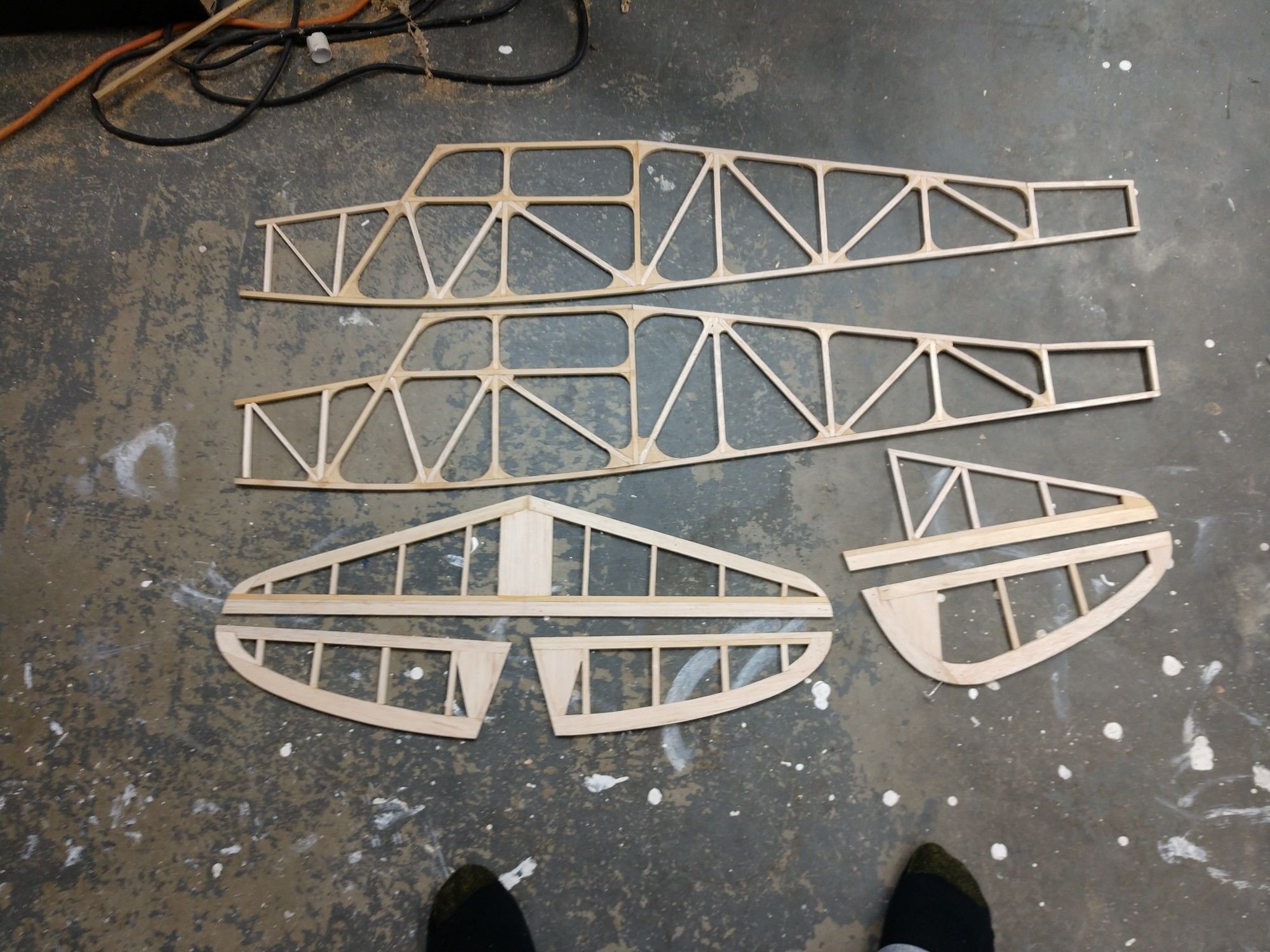

Got some work time in today. Fair progress.
All the tail feathers are framed up.
Major task ahead are Building the wing tip bows, framing up the wings, and joining the fuse sides. I will frame up the wing panels on the table saw bed. Nice and true. But only 24" long, so will have to do in sections.
I have been back and forth in my head weather to laminate up the tip bows from thin stock or from sections of 1/4" like I did the tail feathers. to build up the tips I will have to make another 20 minute trip for wood. I will spend more on fuel driving for the wood than the dang wood cost. I drive a F250 diesel pick up. Paying 3.79$ a gallon. Dang me I knew I should have bought one more sheet
Ken.
Ken.
