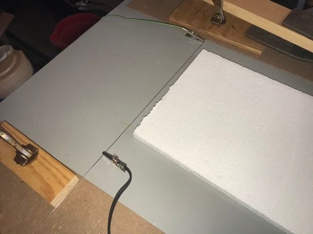

I am 77 years old. Feel like 19. Still learning. Working with foam now; new to me. Started cutting my first airplane yesterday. Even if it doesn’t work out, I will have learned something. I found out I need to make some new cutting bows and make changes to my vertical cutter.
This will be a profile airplane. I’m working with 1/2” stock which I will cut down to 3/8 or 1/4 “. I cut some samples.
Old 08-02-2020, 09:30 AM
  #41
stearman70
stearman70's Avatar
Join Date: May 2012
Location: GuadalajaraJalisco, MEXICO
Posts: 75
My two foam cutters.
It is interesting learn new things. Maybe I'll make foam plane too. I need began construction of my jig to cut foam for wings. I maked one for small cuts. Please, send me orientation for measurements and tecnic info.
Old 08-02-2020, 01:57 PM
  #42
ETpilot
ETpilot's Avatar
Join Date: Jun 2014
Location: East Texas
Posts: 1,059
Received 6 Likes on 5 Posts
Here are some pictures of my foam work; non RC work. The bows pictured did not work too well for my airplane build. I will make new ones. The vertical cutter needs a little rework. An easier way to adjust the wire for vertical and square to table. Easy to do left to right adjust. A pain for front to back adjust. Will change this. Also found a foot switch to turn wire on and off would really help. As well as a fence for the table.
Just sample cuts of wing core and how to thin foam. The wide wire and foam picture is how I sliced the foam thin. Worked well.
The stacked ½” foam for the airplane. My power supply is from a computer power supply. I’ve made 2 of them. One to power the various cutting bows and the other the vertical table cutter. I adjust the wire heat by selecting different voltages and also I use a wire resistor that I made.
