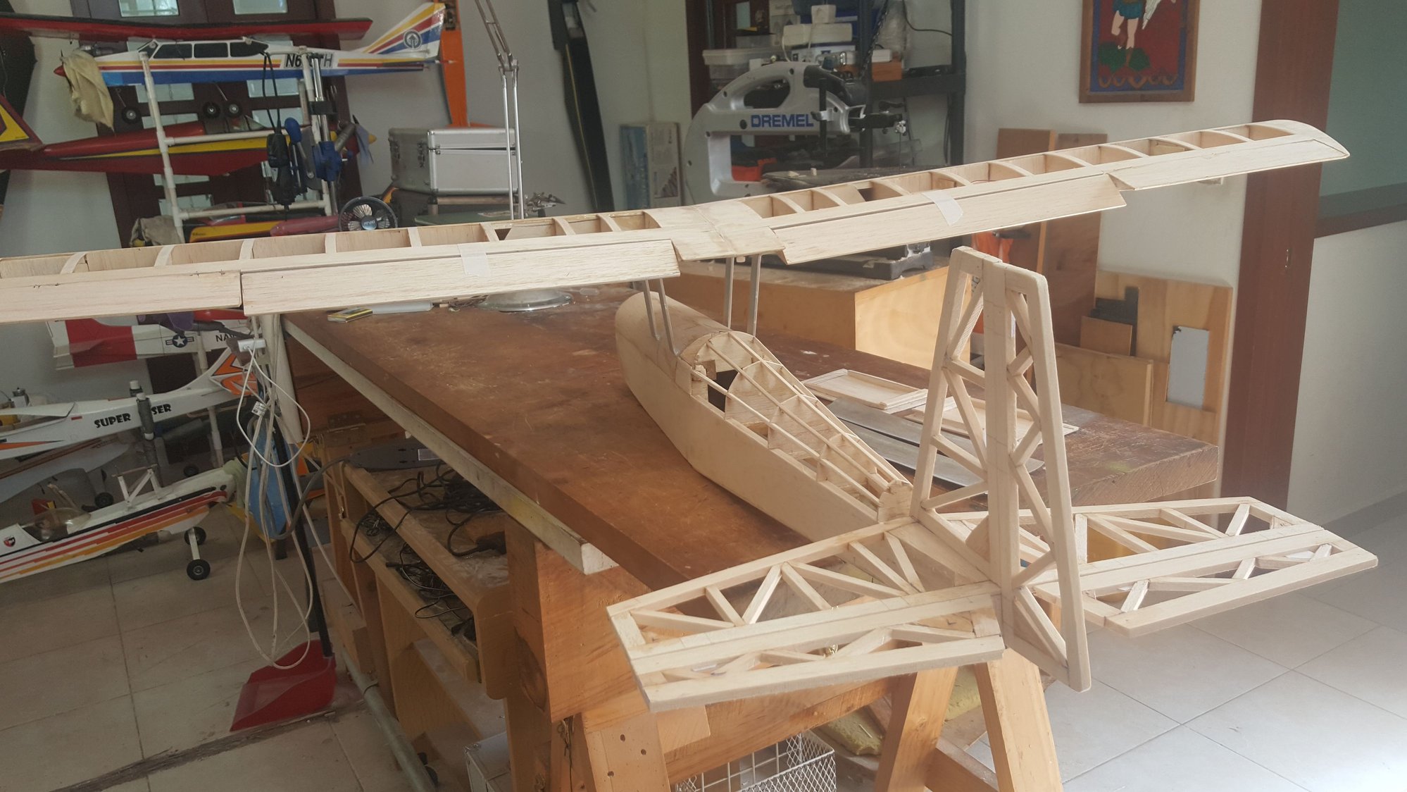

Hello. I almost finished the wing's struts. I think that from this point to forward , the advance will be faster.
I'll make the slatss supports and I'll began to put the plastic hinges in flaps and alerons..
The wing is upside down. You can see the flaps's servo without hatch

Looking good! I like how you did the cabana struts. That was a critical part. Making sure wing is parallel with the datum line. In your pictures I dont see the rib holes for servo wiring. They may be hidden by the sheeting. Once you get the tail attached it will be an airplane in the bones. Good job building.

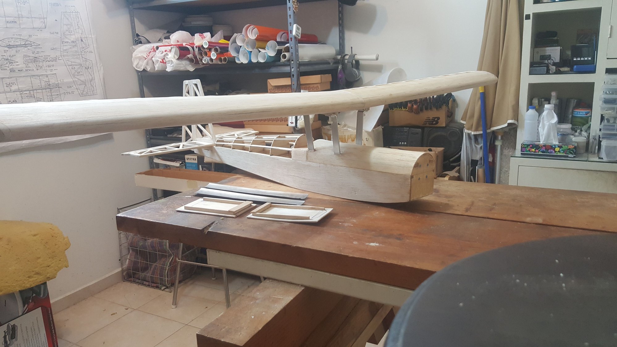

Hello. Everything is presented, not glued. Everything needs to be sanded, especially the empenage, but there is less to finish. I'm going to make you your fiberglass cowling. With the remaining ones I have of film, I'll try the liner scheme.
Here, with slats and hatchs on the table.

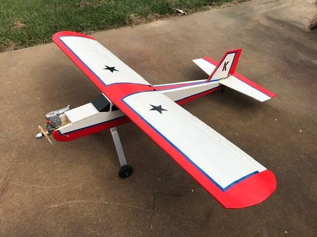

Back in the 70-80s I think I used silk, dope and super proxy paint. When I returned to RC I found SIG Koverall an iron on fabric. I used SIG STIX-IT to adhere it. Then dope and latex house paint. Top coat with polyurethane. I mainly used paint in my builds. Then decided to try iron on film. My KAOS is my third airplane using iron on film. Both systems are good.
I get my film from valuehobby.com. The film is Neucover, 16 rolls $13.99 US. They have white and red but not sure if they ship to Mexico. I can send them a support ticket and ask if you like. Will take a few days for a reply.
Here is my Ugly Stik all covered in Koverall sprayed with latex paint and top coated with polyurethane. The left over blue from 2016 I used on my foamy airplane I pictured. Paint was still good.

Polyurethane resin and accs. to make the cowling
Ready to sand.
All presented, not yet sanded or glued. This is to determine GC and position servos, RX, power pack, etc.
