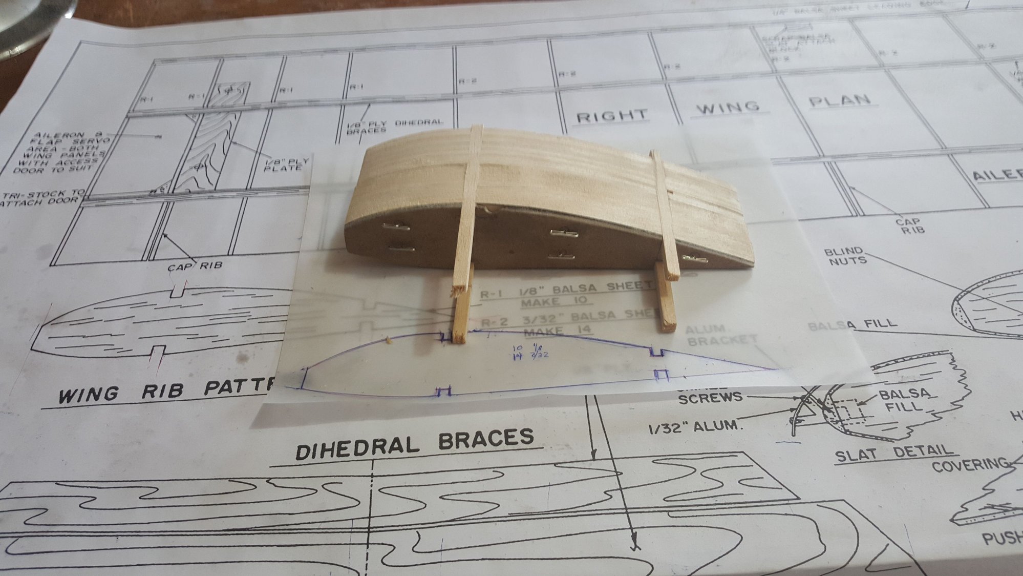

Hello. I am here again. I 'll start construction a parasol plane. I haven´t understood which it is aluminium pieces´s positionat the flaps. I don´t find where I´ll put 8 aluminium tabs. I saw the other pieces that are epoxy gluing to wing. I send you a blueprint. Thanks in advance. I can´t upload blueprint. I send you the link. pharaoh-rcm-04-94-1166 aerofred - aerofred

Those 8 tabs are to make the hinges for the flaps. Two tabs are joined with a steel pivot pin to make one hinge. So 8 tabs will give you 4 hinges; 2 hinges per flap. These appear to be a Fowler flap or slotted Fowler flap. The 2 tabs will allow the flap to move back as it moves down.
I’ve marked the wing plan where those hinges are installed. Buenos Días

Hello. I've seen exactly where the aluminum pieces are going. My concern is as follows: the flaps are only supported by these pieces at their ends. I think if they won't be too fragile held just by the pushrod in the middle part

That is just how it is designed. Two hinge points and the pushrod. As the flaps are extended they move back and down. This opens a slot between the wing and the flap. Air flows from under the wing and over the flap. Gives you better slow speed, more stable airflow over the flap and adds a little wing area.
The plan shows an optional cover plate to eliminate the slot.
By my calculation the distance between the hinge points is 9.5 inches. I would move the bellcrank outboard one rib bay. This puts the pushrod more centered on the flap. You will need a snug fit in the pushrod system.
You may also consider adding a third hinge point. Just a thought.

I am thinking in add other hinge, just in line with pushrod. I´ll make 12 aluminium tabs.
Covering the groove is more aesthetic or functional ?

These flaps are designed to have some airflow over the top. Adding the cover plate would be more for aesthetics. Still even with the cover plate you may still get some airflow. You can test it for a 30-40* flap extension.

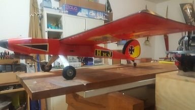

My last two scratch models. Ugly modified (8 changes ) and devastator (aerofred plane) .

Good looking airplanes. Scratch building adds a lot to the pleasure of building.

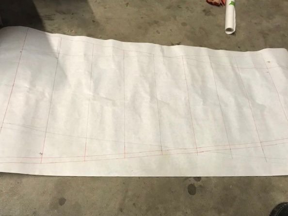

Since I got back into the hobby I’ve carried scratch building to the extreme. I draw my own lines for the build. It is just part of the challenge for me. Here is the finished airplane so far. A sample of my home drawn plans. The wing for this airplane.

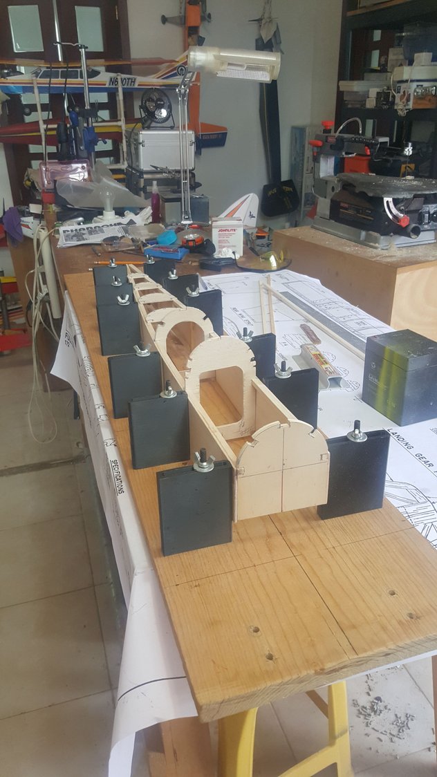

The letters are very professional. All my planes have vinyl letters and images, but I don't make them. I send you the next pictures about pharaoh's construction.

You’ve made good progress. Looking good. Nice fuselage jig. I’ve thought about making one but haven’t yet. I did make a wing jig. Wing jig is good for tapered wings. You have a nice clean and organized workshop. It puts mine to shame. But I’m cleaning up slowly. LOL

Thanks, It is not big and very clean but works. Did you read the Pharaoh's article ? There is a indication that says " Put 1/16 balsa sheet to cover fuselage's bottom, forward and rear."
I see that for cover bottom forward, I need 1/8 balsa or hard balsa and in the rear part, I don't see balsa cover. What do you thing about it ?
