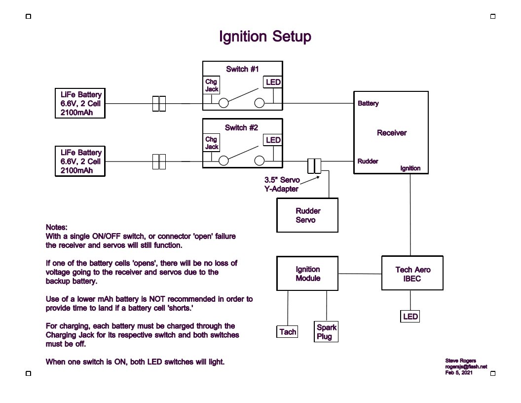

Here is the ignition setup I use on all of my 30cc and above gas planes:
