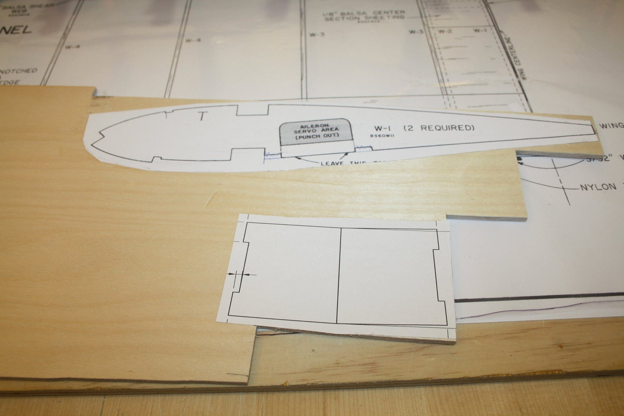

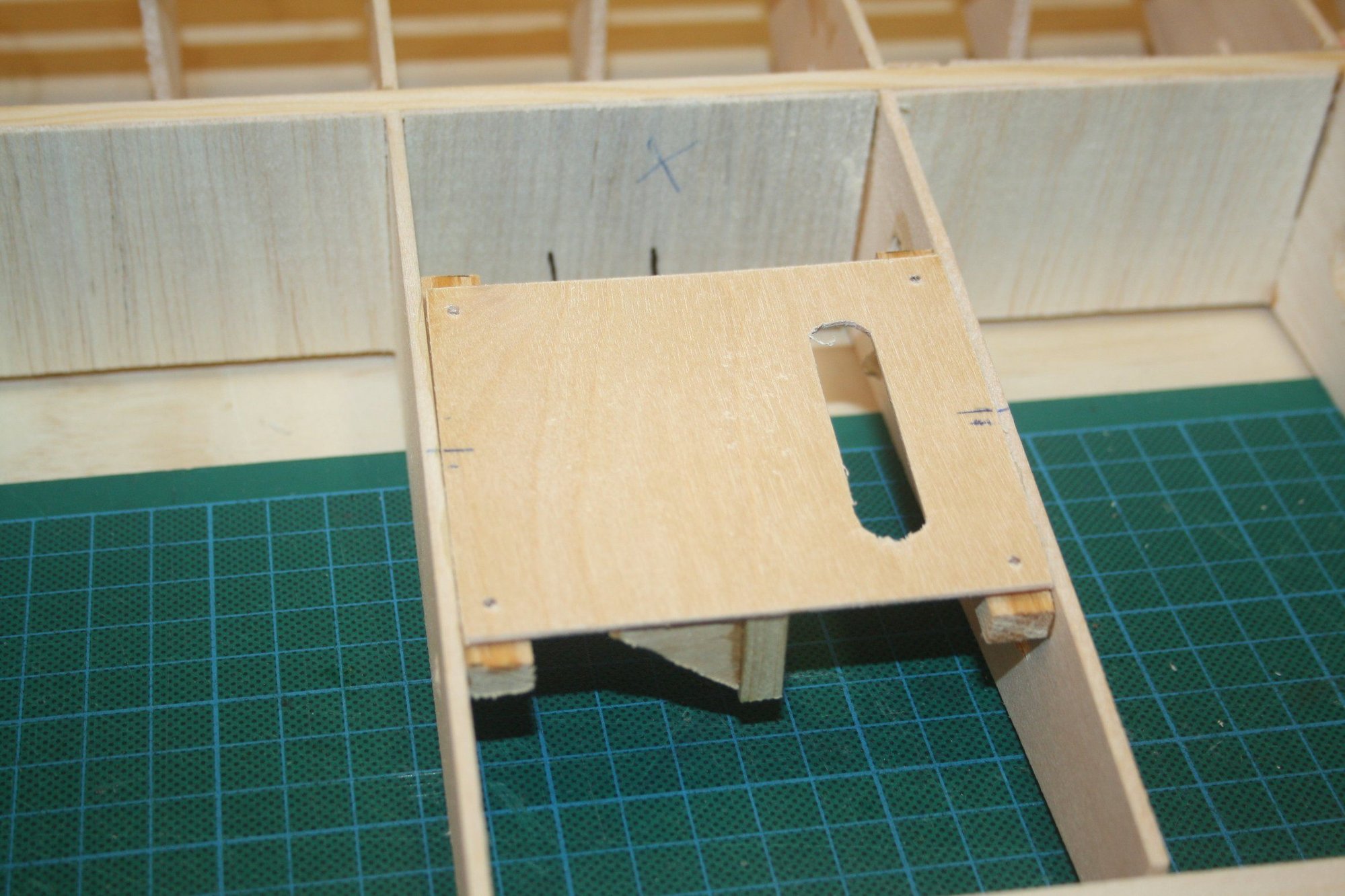

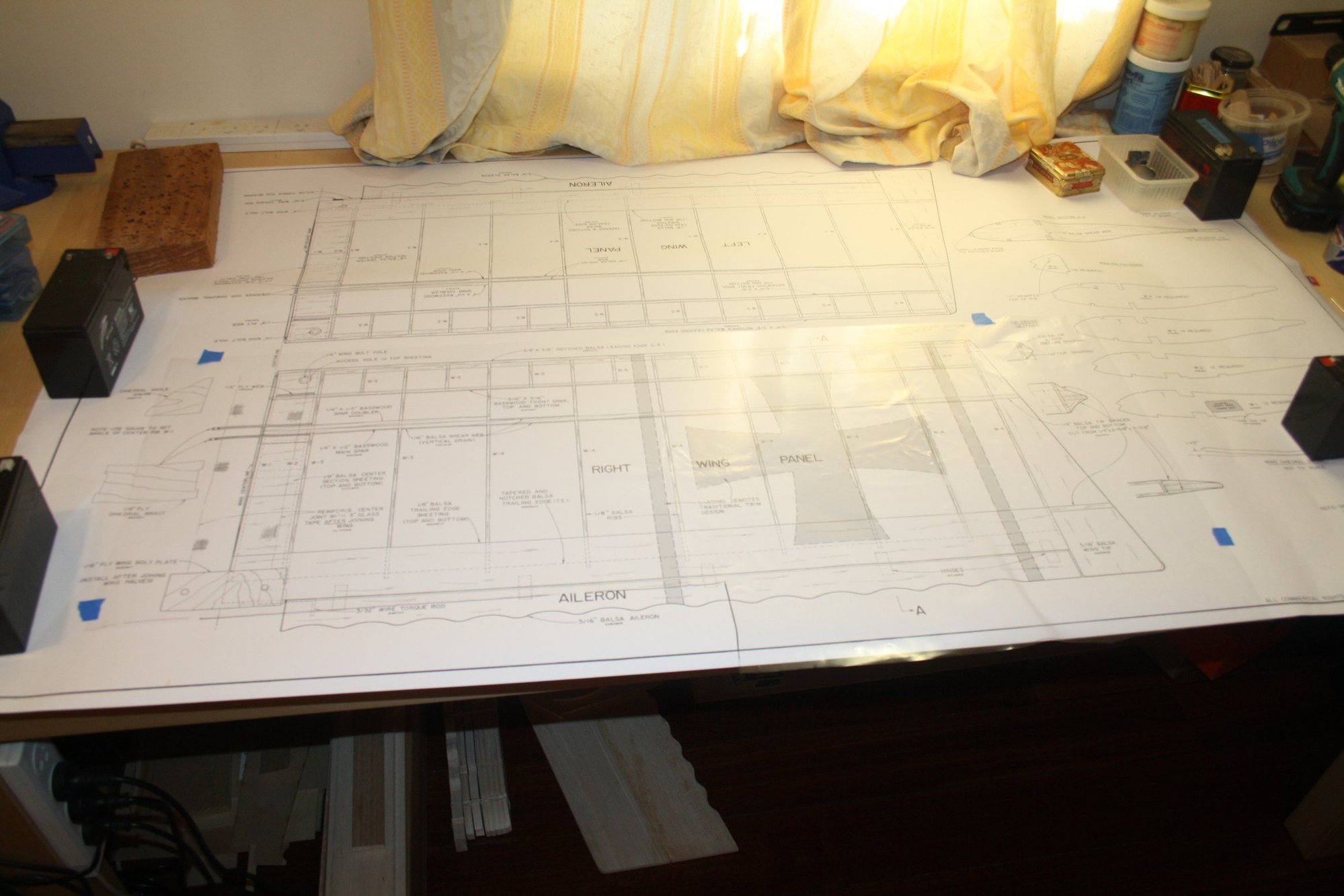

I recently completed the scratch built of a Big Stik 60, and thought that some of the modifications I made will be of interest to others.
Now that my aeroplane has completed 10 flight, I can genuinely say that it is up there as the of the most fun aeroplanes I have ever flown (and I have been doing this since 1987).
The plans I used were a free download of plans "Big_Stik_60_oz11467" available here
https://outerzone.co.uk/plan_details.asp?ID=11467
This version of the "Stik" is Don Anderson's plan for the kit by Great Planes.

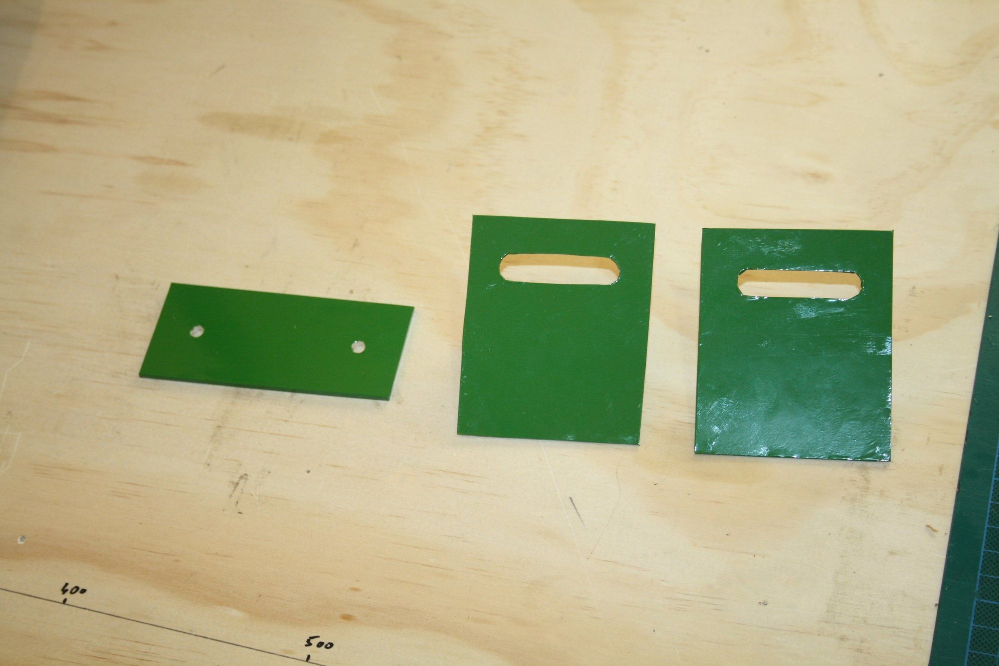

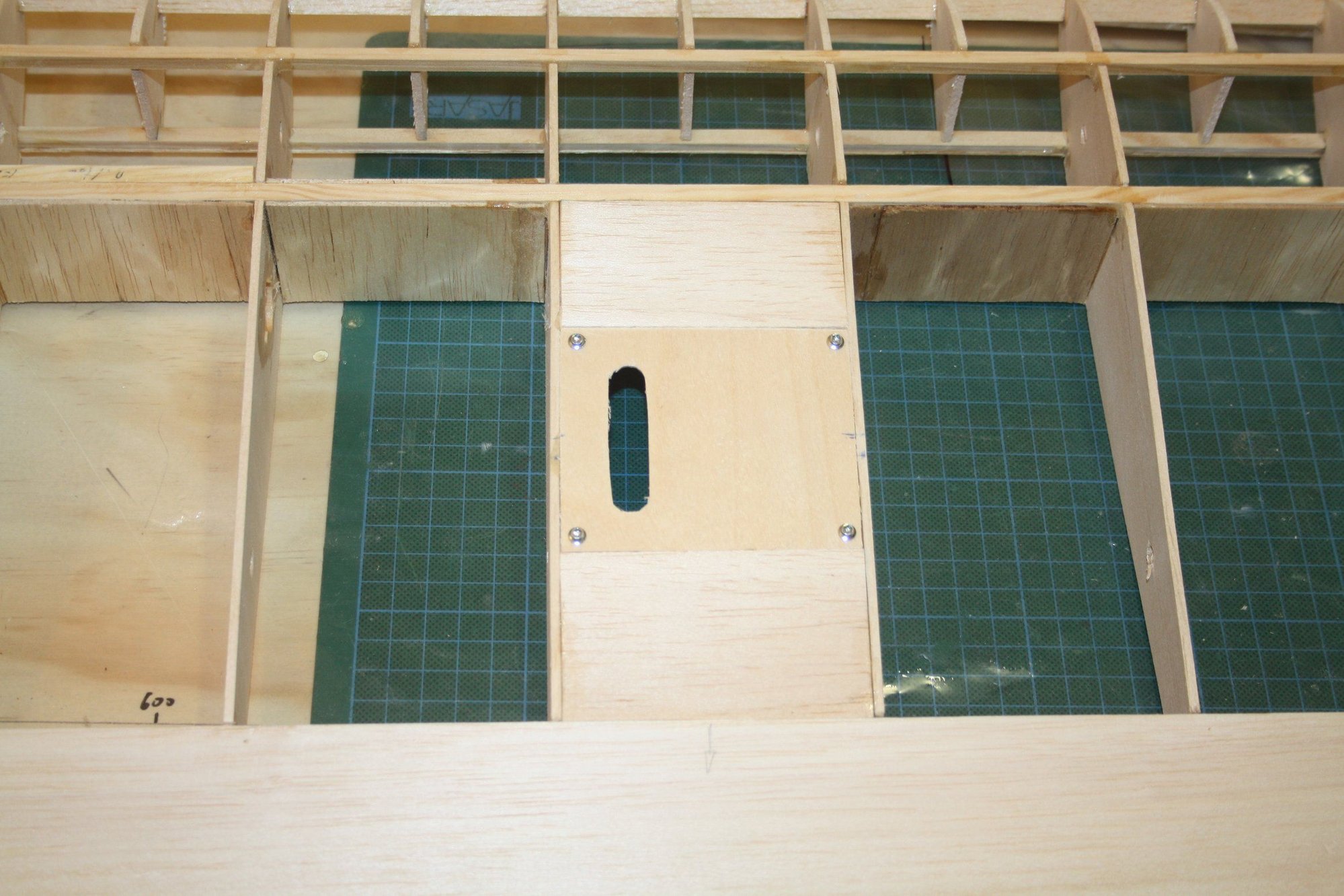

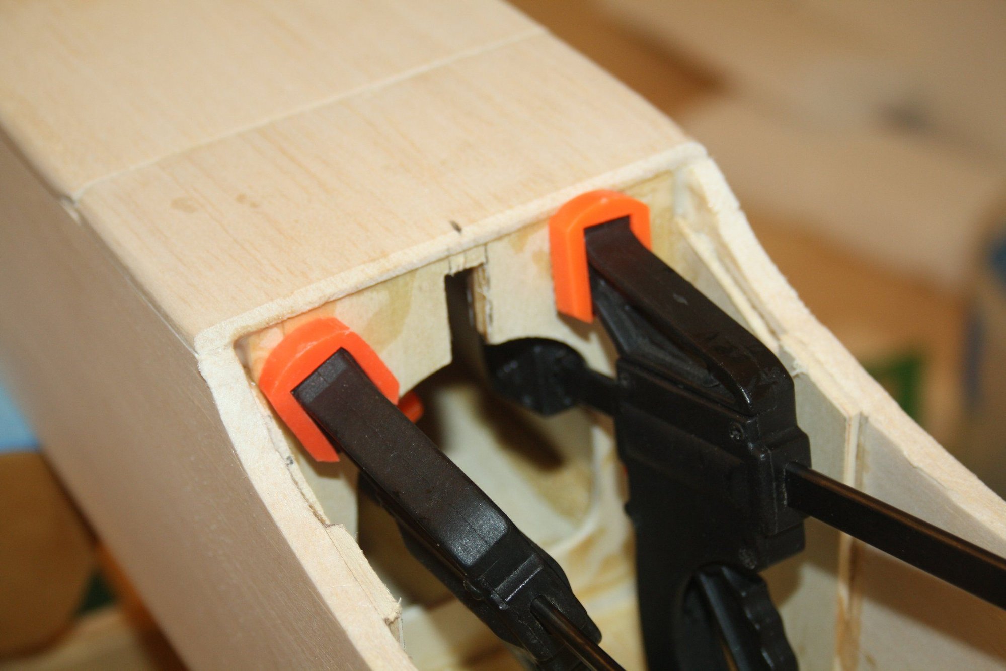

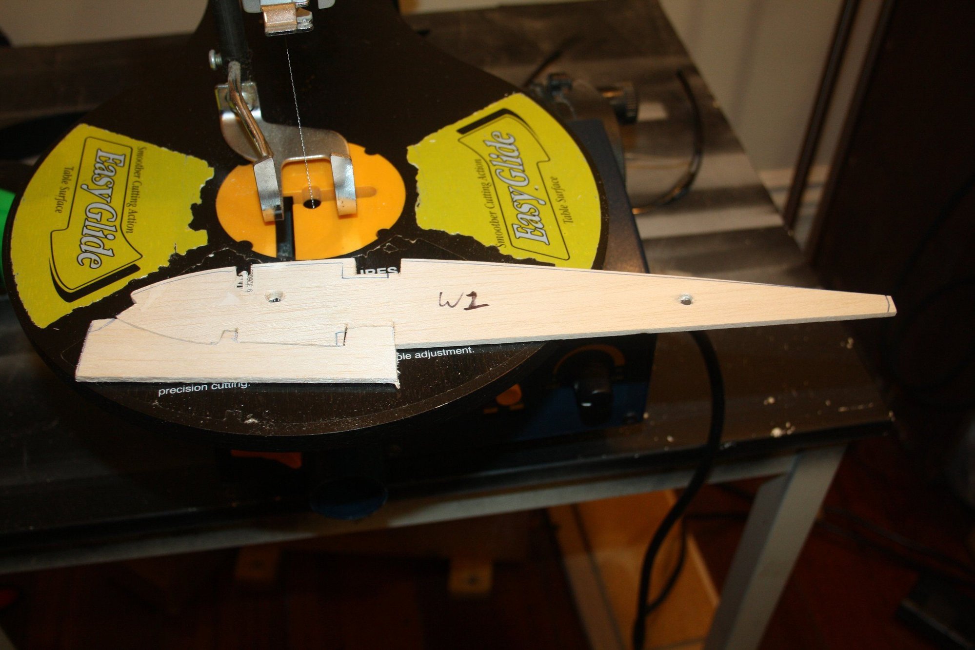

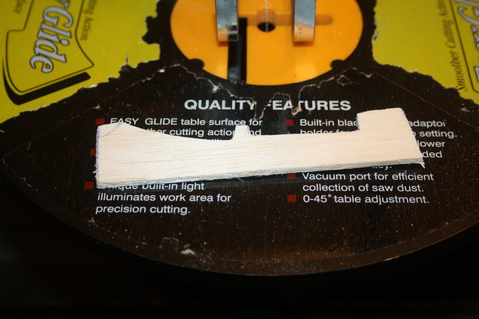

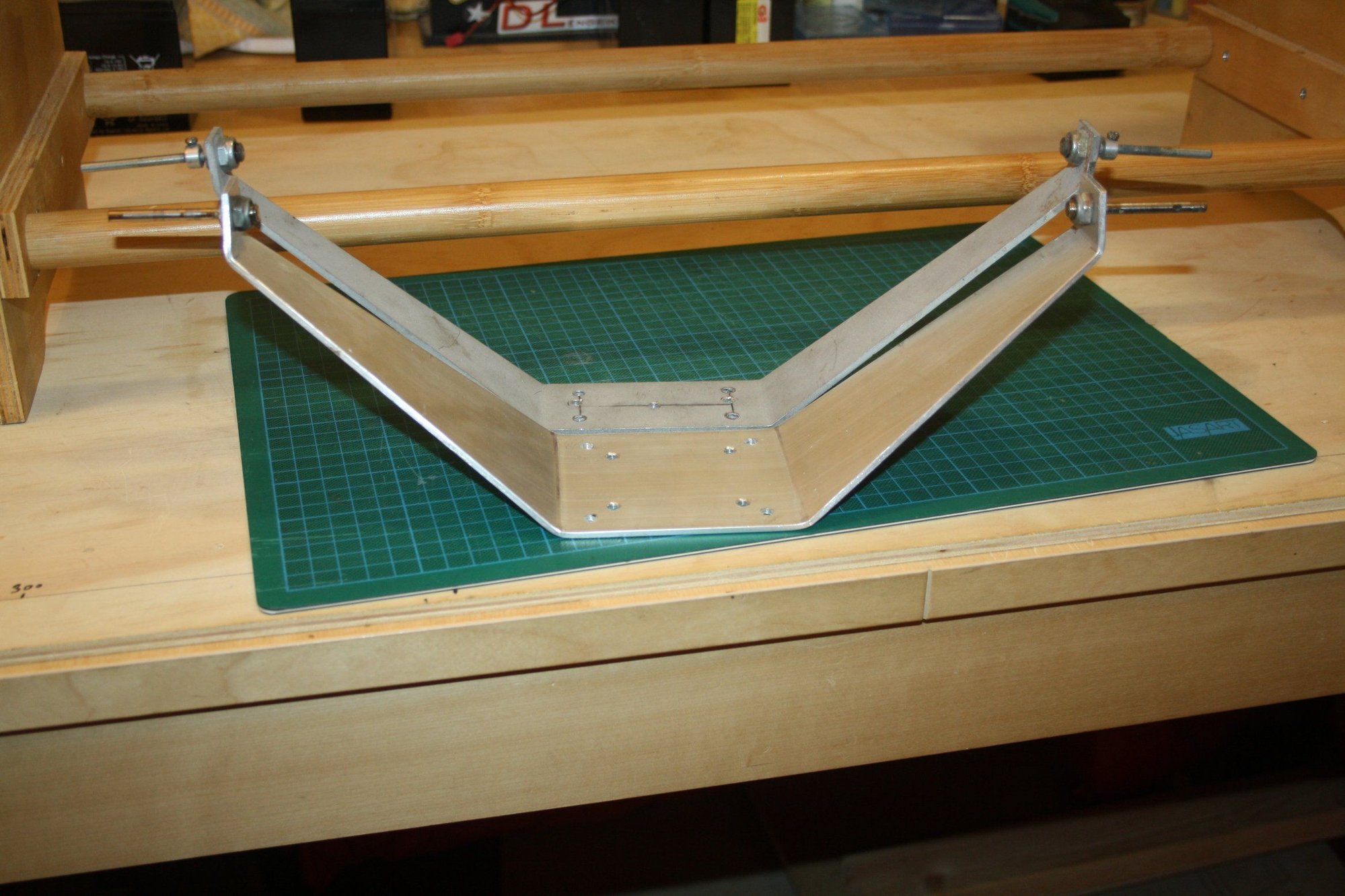

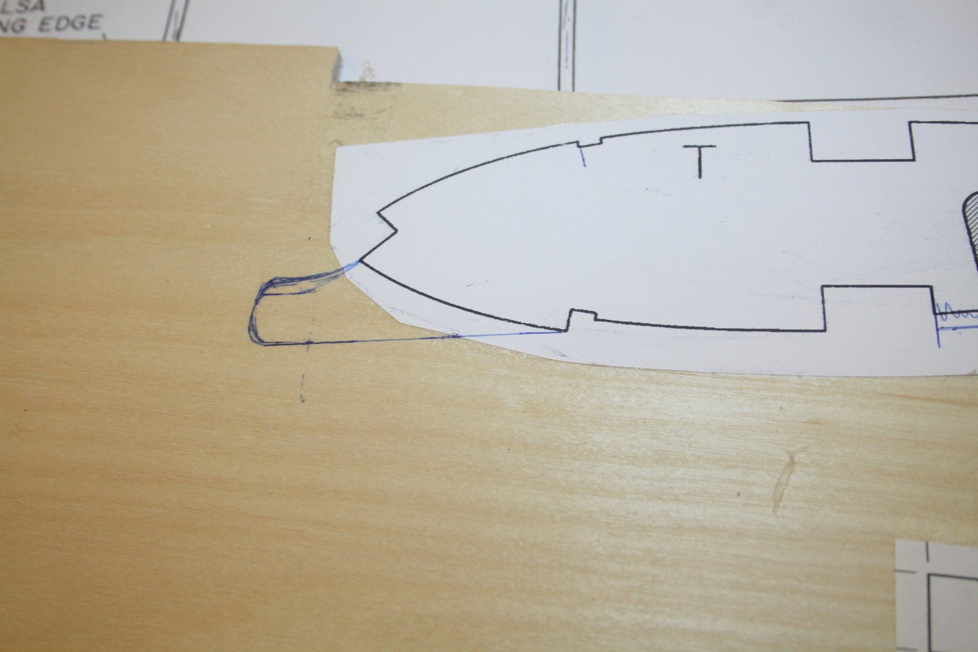

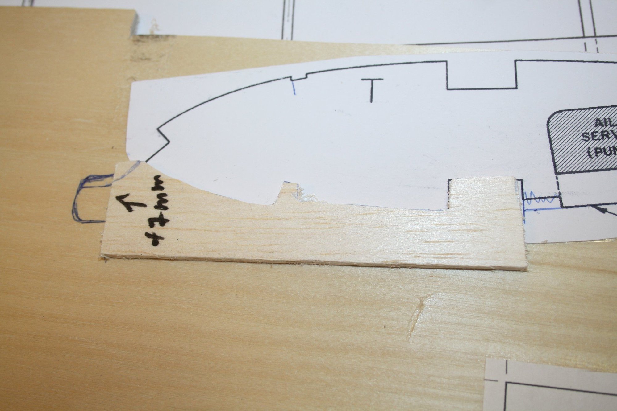

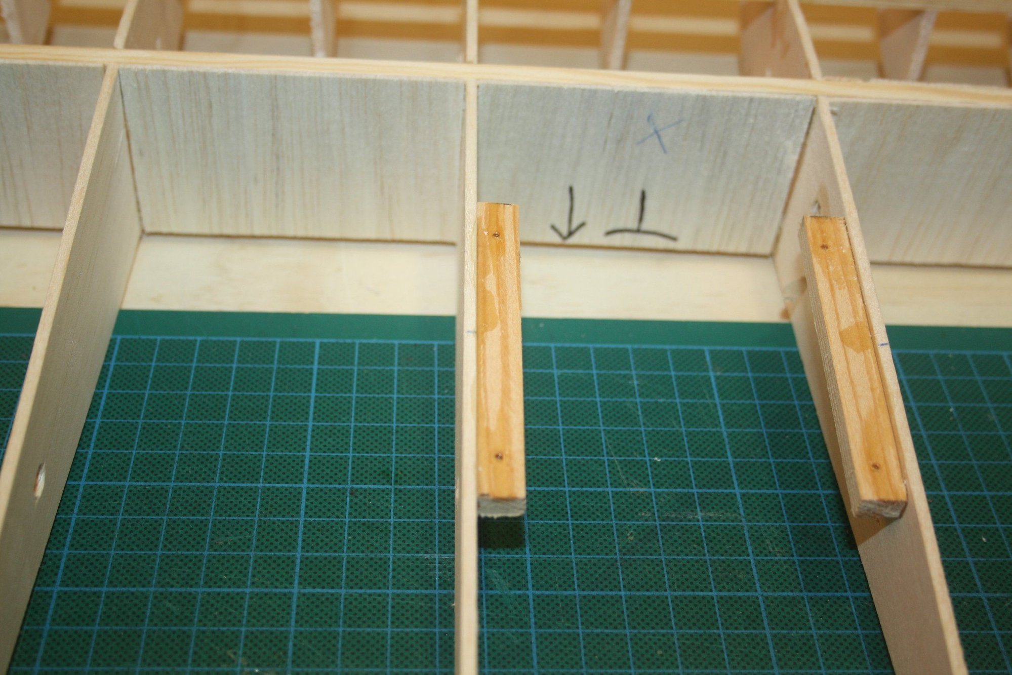

The main structural change that I made was to the way the wing attaches to the fuselage. The plans illustrates a four bolt attachment setup. The later ARF versions by Great Planes used the center rib W1 with a protruding "tab", modified to fit a slot in the fuselage former F2. I copied this concept as it is very practical. As seen in the last photo, former F2 was reinforced in the back (this is what the clamps are holding in the fuel tank bay) to spread the loads.
To establish the height for the modified W1 extended tab, I made a small jig as seen in the photos and attached it to the original Balsa W1. The new W1 was made out of Birch Plywood to take the loads. While I was re-cutting W1, I eliminated the recess for the center mounted servo.
More in the next post,

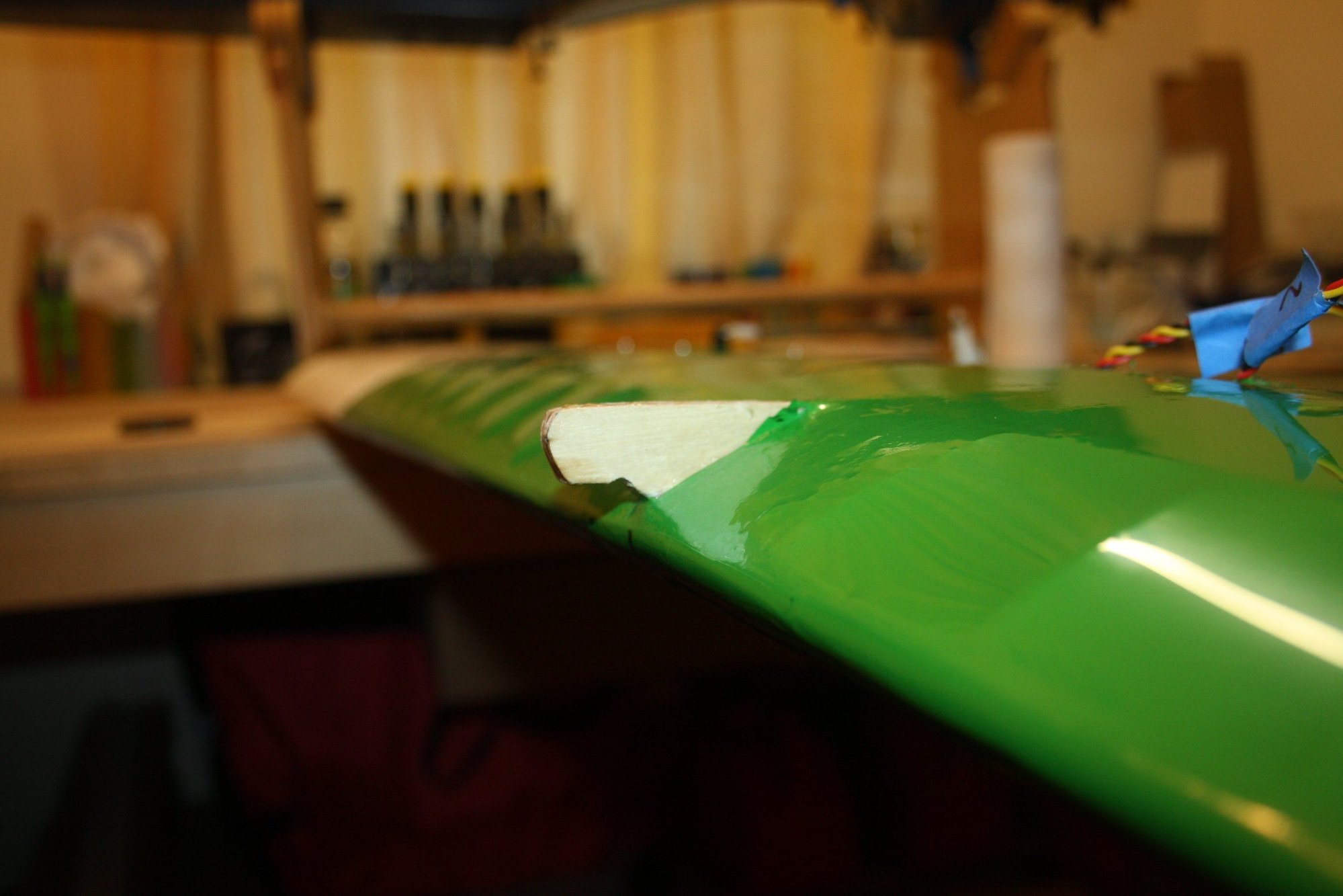

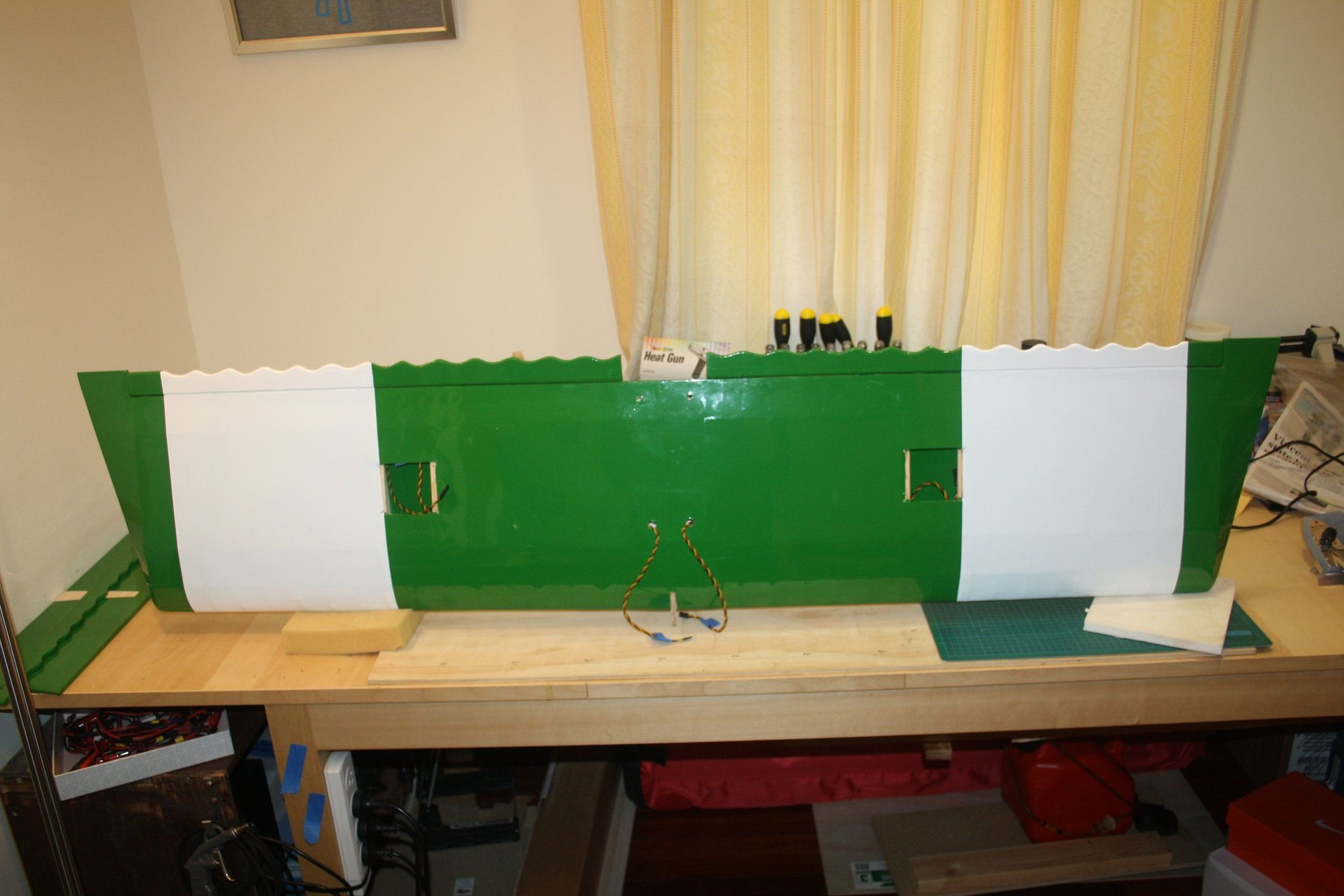

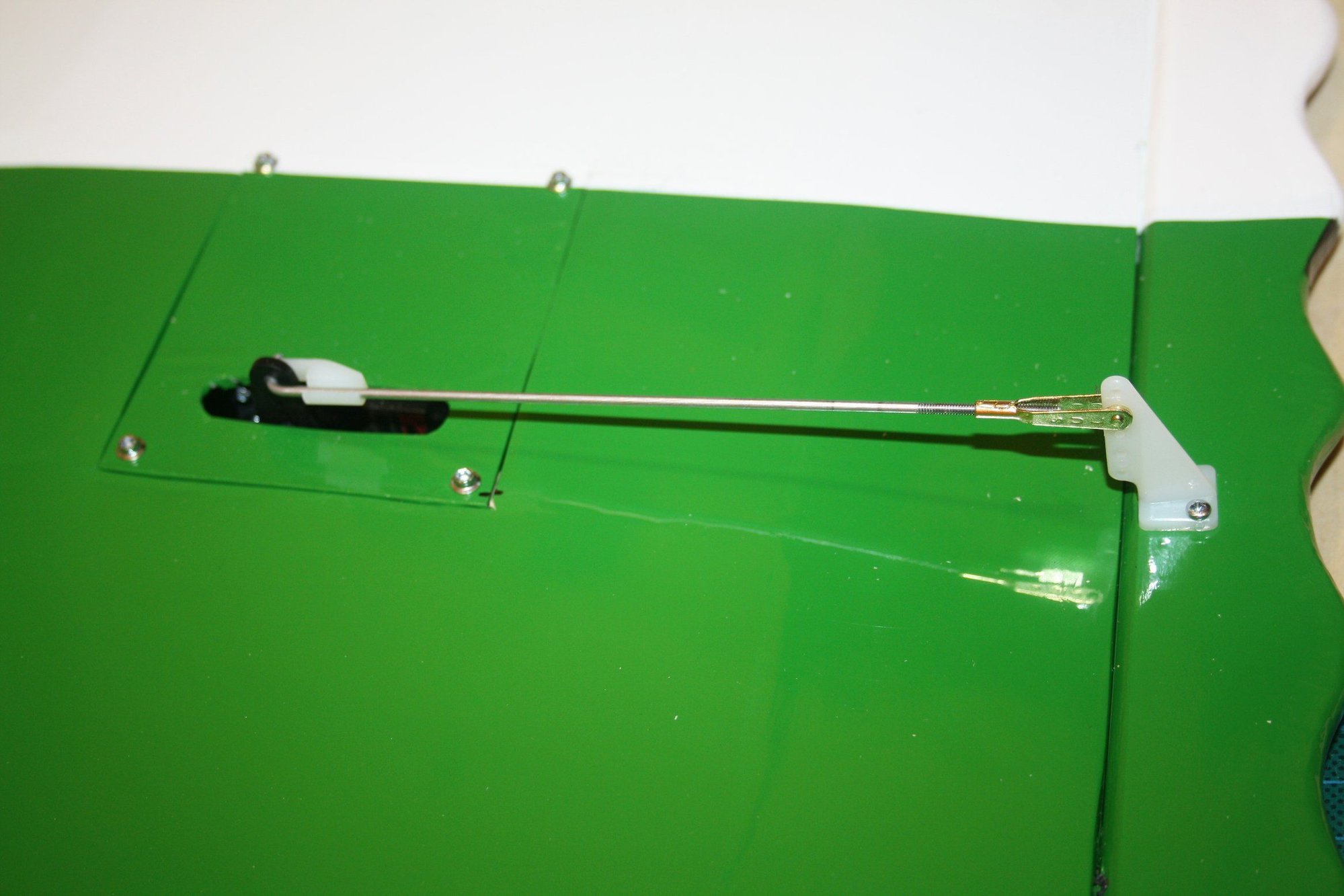

Another change that I made was to have separate servos for the ailerons. This required a very simple modification as shown in the photos below and explain why I eliminated the center servo mount notches in W1.
Cheers,
Eran

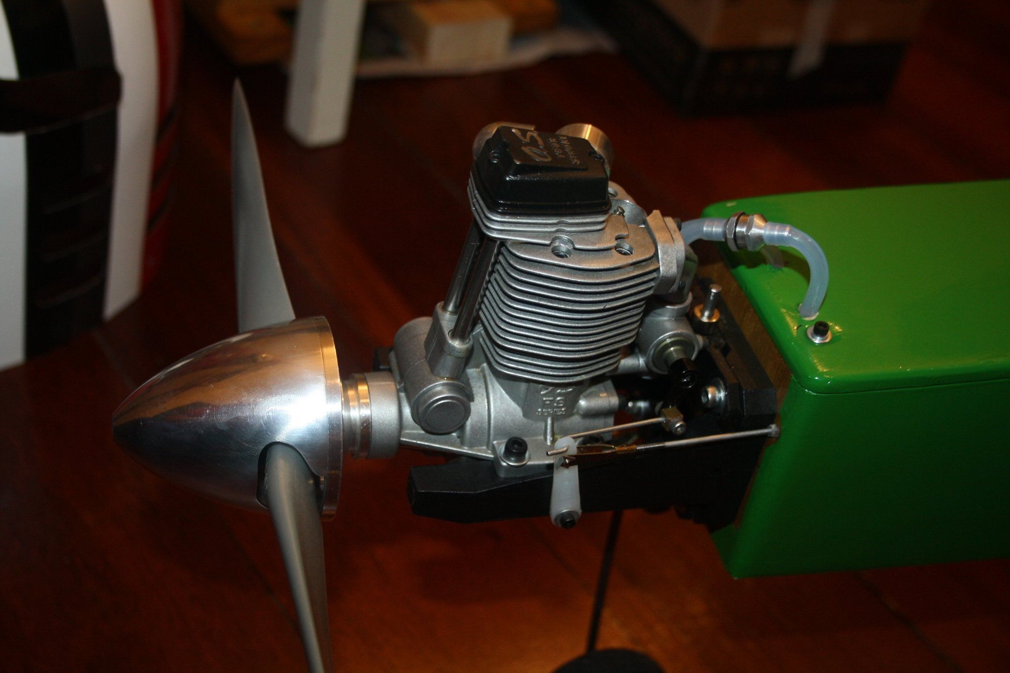

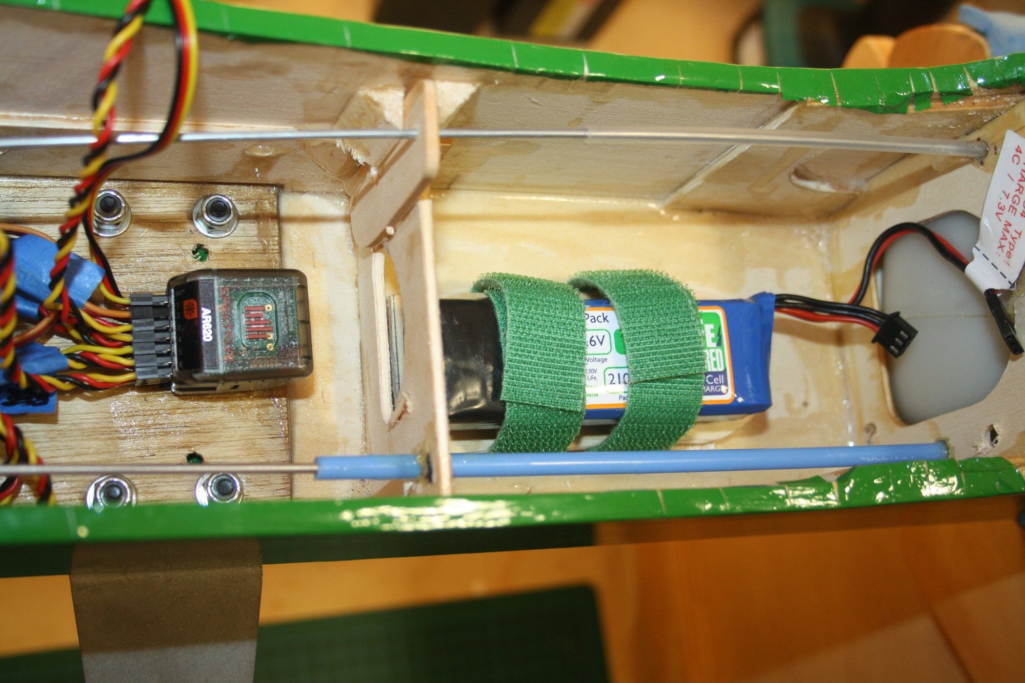

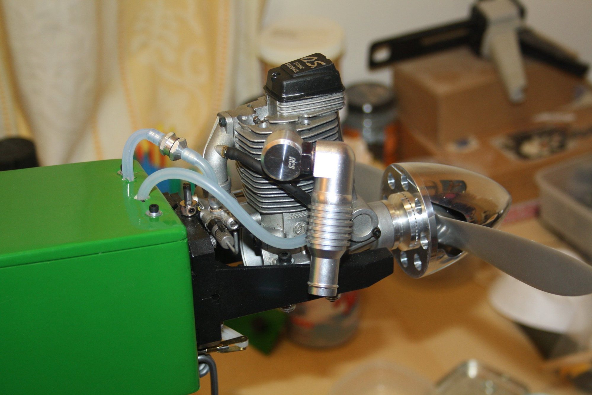

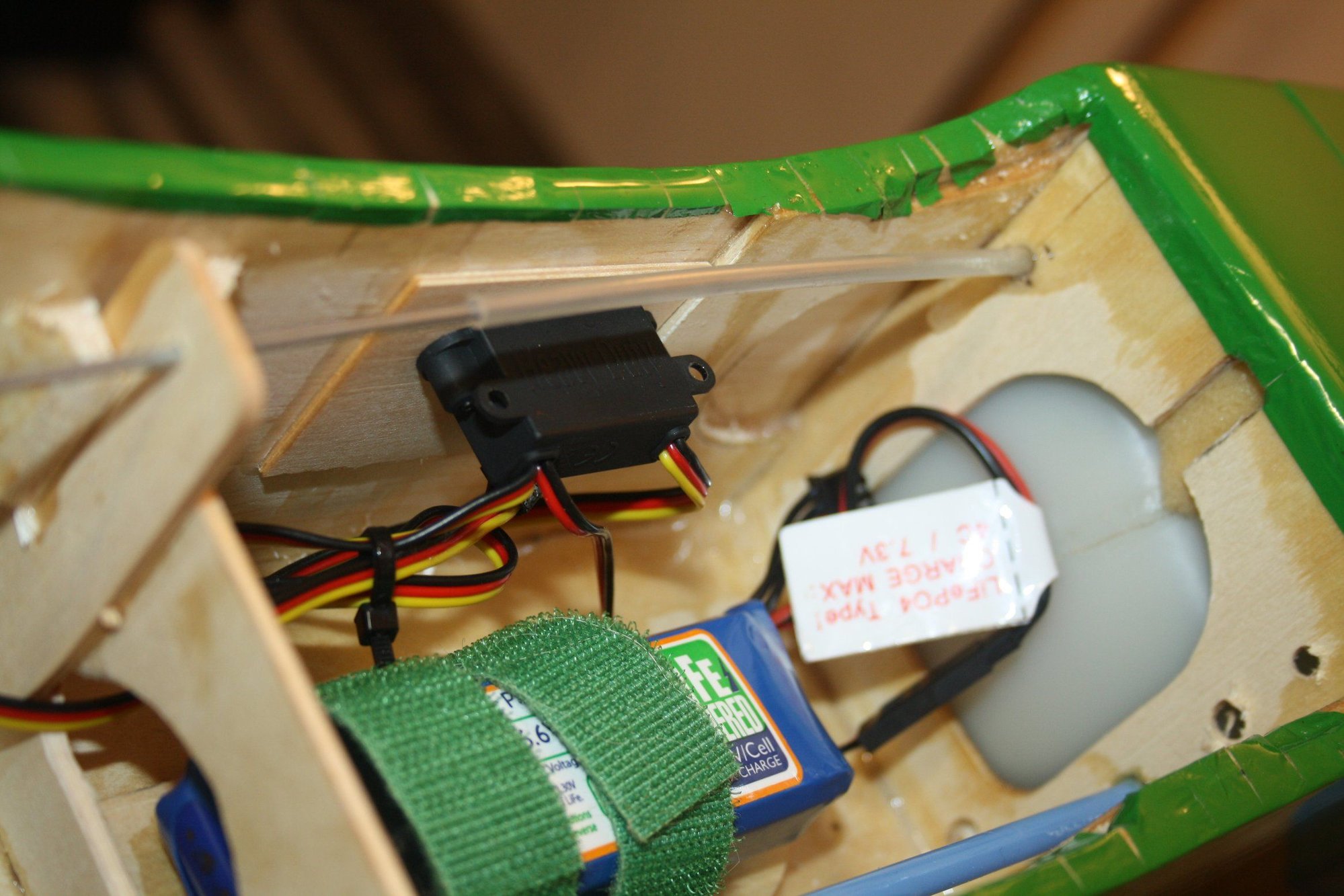

The best experience with this specific model is with a 0.90 size four stroke engine. Between my friends and my own model we now have five of these Stiks, one powered by a 0.60 two stroke (Enya) and the others with four stroke engines (an old Enya 90-4C, O.S. FS-95V and two, including my own, with an O.S. FS-91 Surpass II). The four stroke powered models fly better.

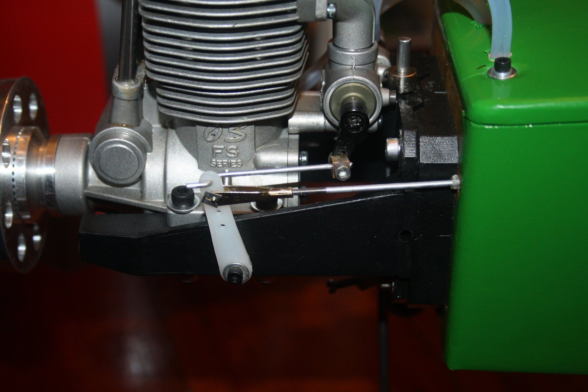

Before assembling my aeroplane I noticed in the hobby shop a throttle linkage made by Du-Bro that I have never seen before. It does make connecting the throttle of a four stroke engine easier.

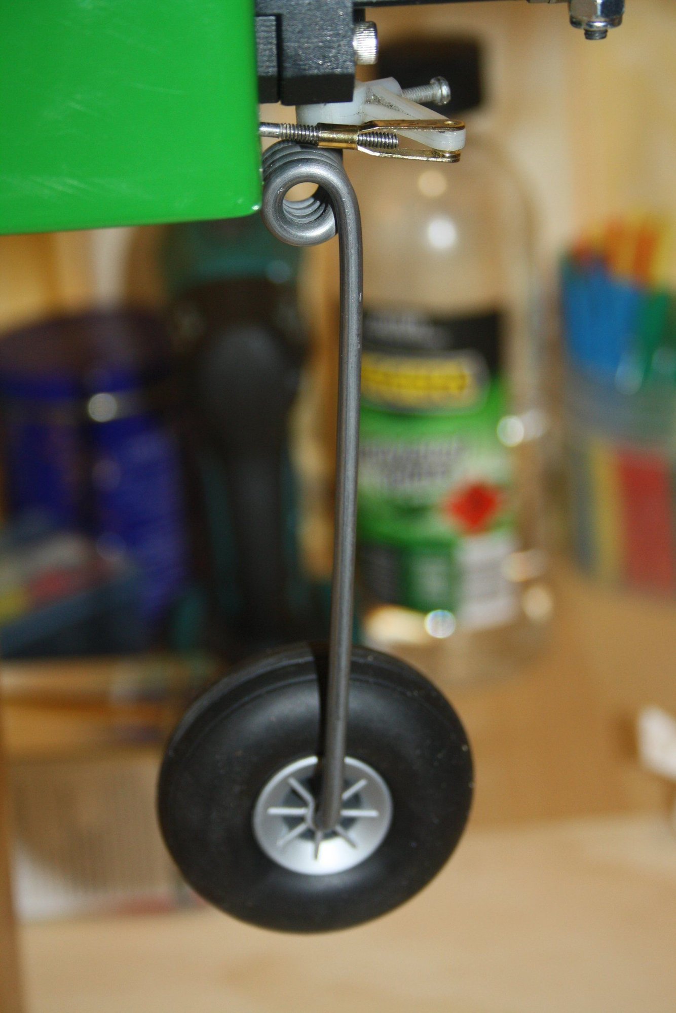

Due to the larger prop used with the 0.90 engines (a 14x7), a longer front leg and main gear are required compared with the plans. A friend found a main landing gear in his spares box that fitted. I think it is from a crashed Great Planes ARF version of this plan.

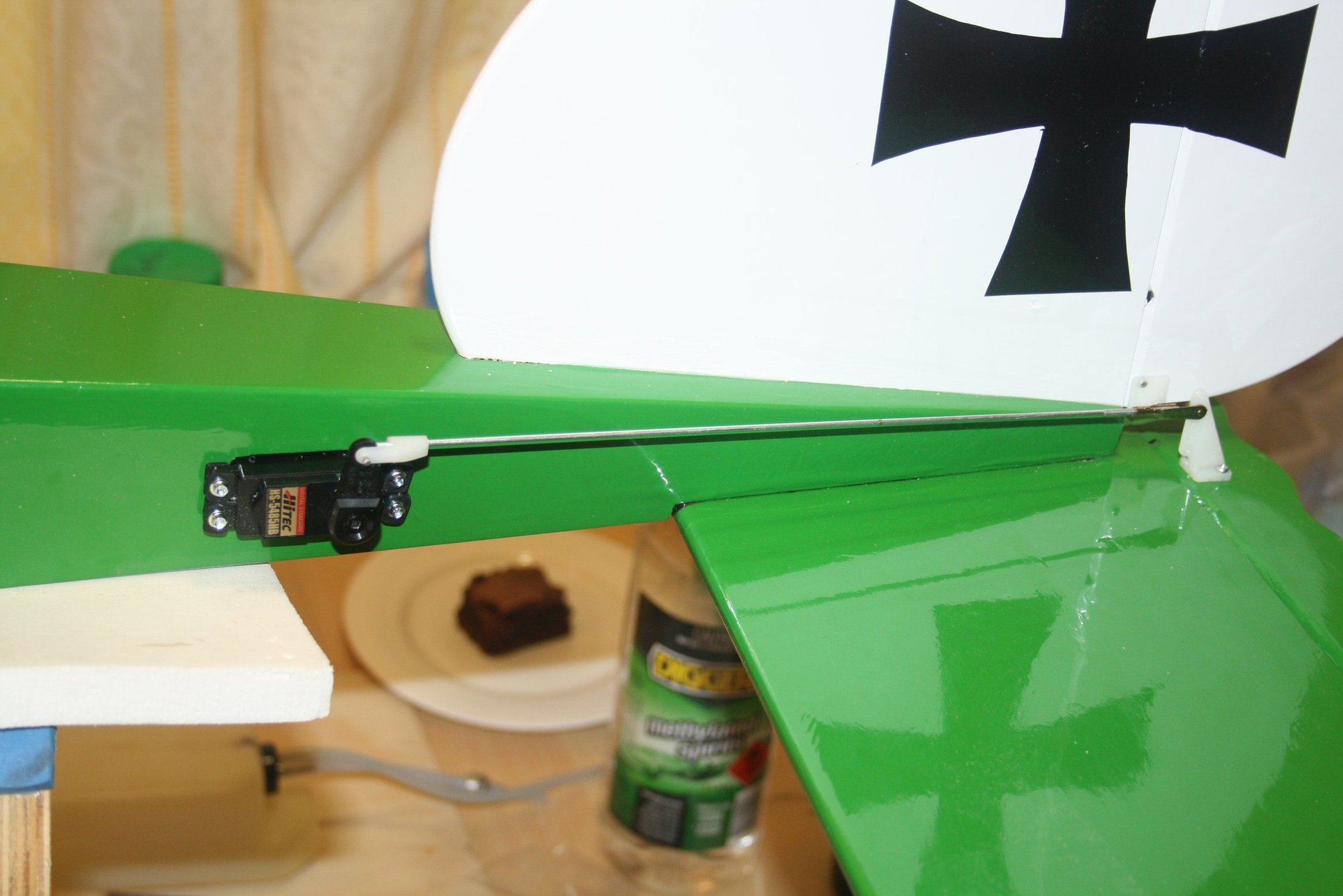

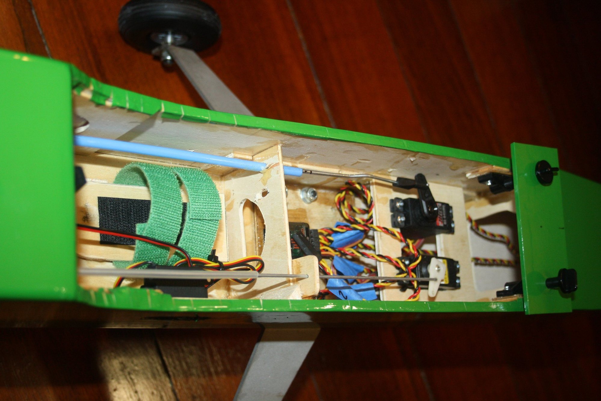

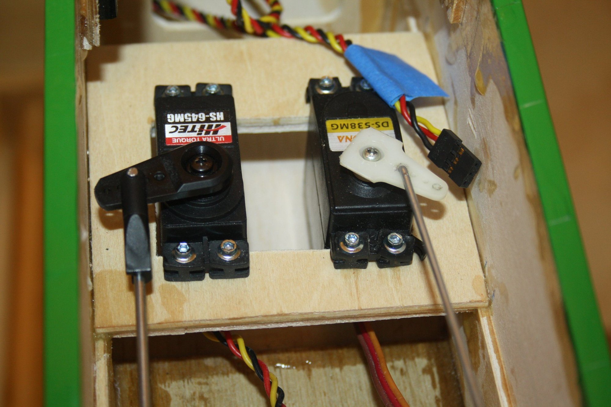

To counter the extra weight of the heavier engine, the rudder and elevator servos were placed in the back. Make sure you stagger them in the narrow tail section and that you avoid the space taken by the vertical fin as it protrudes into the fuselage. I placed a lite plywood doubler inside that tail section areas.
The throttle and steering servos were placed at the back of the main bay under the wing, as shown in the photos. No additional weight was required to balance the aeroplane.
