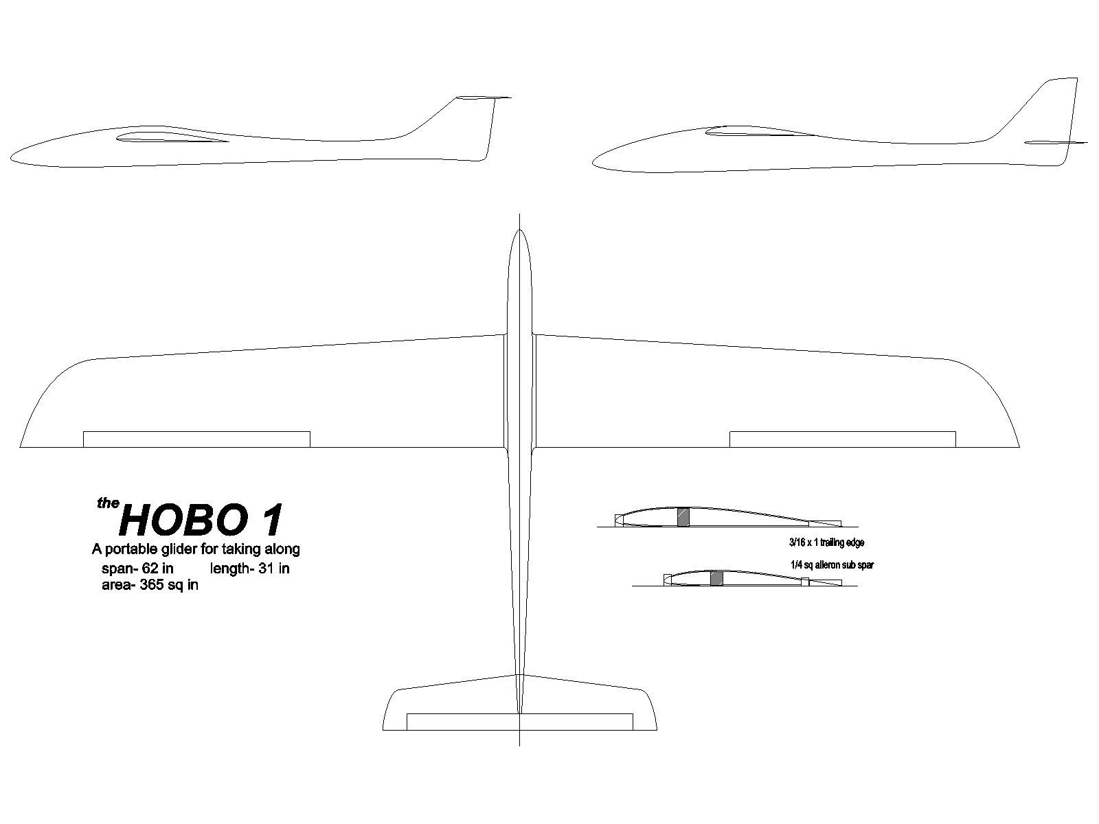

Here's a couple of doodles I've done over the years. The structure would be done using thicker sheet then get glassed for skin strength. Surface areas and tail moments are based on proven designs of the time these sketches were done. Plagiarism CAN be a sort of compliment after all...

Nearly finished the design and just wanted to check a few things.
So the wing is going to be 2.160M including tips. Body is 0.845M excluding slanted back V tail. I have used the AG34 air foils and designed a I beam spar design.
The wing is going to have a 3 deg slant from the horizontal and a following 2 degrees around 1/3rd of the wing.
Ailerons are going to be the 1/3rd of the wing and im not sure about the flaps.
In terms of flaps, it will be very hard to design in but if I installed spoilers it would be very easy to do.
is there any pro's and cons of each?
In terms of the I beam, is 8mmx2mm Sitka spruce OK? I can machine any size as I already have a 2"x2" 16ft length.
I've decided im going to make the fuselage from fiberglass as I already have some.
In terms of the air foil, does 5 degrees seem OK for angle of attack?

Here's my own thinking when it comes to designing such a model....
If I'm using ailerons anyway then I need a sub trailing edge for the section of the panel where the ailerons go so I can close the wing structure and also have a place to support the hinges. And if I'm doing a sub trailing edge anyway then I might as well make the sub TE extend for the whole span and use flaps.
Flaps offer up a wider range of use than simply adding drag and killing lift. And especially if you have ailerons and flaps you have the option of full span camber changing which provides the ability to slightly lower the flaps for aiding with slightly reducing the sink rate when in lighter lift. Or for slightly reflexing the whole span of the wing to reduce camber and allow the model to fly faster at the same rate for aiding with getting back upwind on stronger wind days. All in all flaps offer a lot more than simply giving you a way to bring the model down quicker than it would otherwise.
On the other hand spoilers are only good to bring the model down quicker than it would otherwise........
I do feel that some dihedral in the wing even with ailerons aids with making the model more self correcting. Plus it can aid with reducing the need for "top aileron" to avoid the model wanting to steepen up the bank angle in a turn if not corrected. But without seeing the drawing I'm thinking that 3° at the center line dihedral joint and 2°more at the outer panel breaks might be a touch too much? Or not.... It won't be far off at any rate. Mind you I'd be more likely to do it with 2° at the center line break and 3° at the outer breaks. Depending on where you put the outer breaks it can aid with making the whole wing as seen from the front follow more of an elliptical arc for dihedral. And that's not only a more pleasing shape but also puts the dihedral out at the tips where it does the most good. That's why the 5 panel wings are so popular. It puts the higher angles out at the tips where it provides the most roll response to rudder inputs on RES models.
For spruce spars you'll want to go with more like 8x3 or even 8x3.5mm. If the wood has much grain runout this avoids any weak spots that would otherwise occur in the very thin 2mm size you asked about. Plus if you will go the "easy way" and add the shear webbing as front or back or box in the spar with front AND back glued on webbing the 3mm provides more gluing area to the front and rear edges of the spar caps. And that's an important factor. The glue is more than strong enough for our use. It's the lack of joint area on the 2mm wood though. There's so little joint area that it can easily rip away the wood fibers. Going up to 3mm thickness aids this by providing a 50% increase in the glue joint area. The outer panels is a different story. For those if it's not too much trouble you could get away easily with 8x2mm since the loads are a lot less.
This also assumes an electric launched glider. If you will be flying off a winch then for sure increase the spar caps to more like 10x3 or 10x3.5mm. You'll need that for dealing with the loading off a winch or stronger high start.
Small point but you don't really mean angle of attack. Rather you're describing the angle of incidence. The AoA is something we control in the air and which changes with changes in flying speed and due to higher loading in turns. The angle of incidence is what we secure the wing at so the fuselage is pointed more or less into the airflow to give a lower drag value. OK, terminology done.....
We want the fuselage to be at a low frontal area aspect when we are flying at a blend of the best L/D and slightly faster speeds. And at those speeds we are generally going to be running a glider at rather low lift coefficients and thus lower angles of attack. Like down around 0 to +2°. 0° you ask? Yep, on airfoils with camber the zero lift angle is actually a negative angle. The AG35 airfoil for example with 2.3% camber only provides zero lift at around -3°. At an AoA of 0° it is operating at a Cl value of up around 0.4. And that's roughly the value you'd be flying with during your best L/D flying. And at higher cruise speeds for penetrating back upwind you might well end up at more like -1° or so. We only fly at more like 0.8 to 1.0 Cl values and angles of attack at the point just before stalling. So even when flying in a thermal we're likely only up around a Cl of 0.6 to 0.7. And at that point the actual angle of attack with the airflow is only up around +3°. So as odd as it seems the right choice for setting the wing's angle to the rough centerline of the fuselage is going to be down around 0°. If you proceed and set it at +5° then it will end up flying around looking like it's diving and holding the tail surfaces well above the obvious glide path line. And that means you're making the fuselage frontal area exposure bigger than it needs to be and making more drag than you want.

Hi BMathews, I have sent via We transfer as i cannot send pictures yet.
From the plans I sent,
So in regards to the sub TE extend for the whole span, do you mean have a the flaps like how the Ailerons are designed as apposed to a thin flap which is under the wing. This would make it much more easier to make and less compilated.
Thanks for your input regarding the flaps. seems like the flaps would allow much more flying adjustment and as it wouldn't be too hard to add, would allow a slightly simpler wing stricture.
We my biggest concern is regarding landing, is actually landing and not just gliding over the ground which as I have not flown a glider, im probably worrying about nothing. Round me, most the land is hilly and flat areas are rare. lol
From the plans, I can change the angle easily enough. In terms of the wing tips, I was going to have the top and bottom of the I beam Spar extend slightly and steam a curved section of spruce where it will glue into the extended I beam spars.
In terms of the plans, do they look OK other than the 3/2 degree angles being swapped?

So this will be a slope soaring model primarily? In that case you don't really need the outer dihedral break at all. But the original 3° at the center will make the model act a touch more groovy and self leveling by enough for use with ailerons on a mostly slope soaring model. And not having the outer dihedral angle makes building the wing even easier.
Landing with the flaps down CAN be an issue. For this reason a lot of folks prefer to buy servos with metal gears since they are a bit more durable. The other option is to retract the flaps just a slight moment before making contact with the ground.... Or hillside bushes in your case.... And in fact with the loss of the lift from doing so it ensures that the model drops down smartly right at that point.
The first option. It's also the easy option since you maintain the wing ribs as one piece. It's also easier to build. And we do like easy as long as it's still effective. And for a model which sounds like it'll be primarily just tossed off the tops of a slope using the separate pieces between the ribs is easily enough to make the wing very strong.
There's no need to fit the pieces so closely that you can glue the webbing to the ribs as well as the spar caps. It won't hurt if you do though. Since the real goal is to box in the spar caps and I like "easy" I tend to make the webbing pieces in these cases about 1/32" less than the rib spacing so it's easier to fit them. And that means I don't bother gluing the webbing to the ribs.

If you have a lot of slopes that you can access to fly from then this shifts the goals a fair amount. Up to now my posts and suggestions have centered on the idea that you were working on primarily a thermal model that would occasionally be used on a promising looking hillside. But if you have more hills than flat areas and have access to the slopes at their tops or well up the side of the hills that see the oncoming breezes that alters things a lot. At this point I'd suggest a shift to a slightly more compact model with a more moderate aspect ratio that is geared to slope flying. Such a model would be less likely to be damaged during the often rough arrivals that describes "landings" with slope soaring models in brisk conditions.
I got the drawings and as promised have posted them below. I have a couple of thoughts. Overall the design looks fine but for two main things. First is that the V tail surfaces are far larger than they need to be. in particular the top view. They could easily be made about 2/3 their size and it would still be enough to provide a good degree of stability.
The other issue is the low number of wing ribs. The spacing in the third picture below looks great. Might even be more than is really needed. But the other wing plans have what I feel personally is too few ribs to best support the covering and limit the distortion of the wing section due to the shrink "tenting" that occurs between the ribs. For wings where I'm after the best performance possible with a film covered open frame structure I like to go with no more than 2" spacing. Your setup looks more like it is pushing towards 3" spacing.
If I'm right and there's more slope than flat land and more slope updrafts than there will be thermals then I'm going to suggest something less long legged than your current plan. Something around 60 inch span and light but sturdy. Something like these suggestion links....
I got these suggestions from a search on Outerzone for RC gliders in the 50 to 70 inch span range. Some of these would be at their best in brisker conditions. But there's also a lot of simpler and lighter models that could work well in the lighter lift days. Anything in this list or on the search page results catch your eye?
There's certainly nothing wrong with the design you're working on but I do feel that it's focused more towards flat field thermal flying than to slope flying. The long aspect ratio wings are going to tend to be more susceptible to landing damage in any but the lighter conditions.

Thankyou for all your input. So what you helped me designed is infact a thermal glider? If we say for arguments sake, if I was to continue with this design for thermal gliding, I should have more ribs and look into the areas of the tail? In terms of everything else, does it seam like it would be a good flyer? I know vague question. lol. As I plan to build more than one type of glider, I would like to see this through for those days which are not as windy.
In terms of the hills near me, I have very steep hills and gradual slopes. Getting to the crest can be a little difficult as it gets very steep and you cant drive there. Most of the slopes are 3/4 of the way up the mounting. At the lower spots, the hills are gradual with some large fields with grass. The area I live is Cahir, An Chathair, Aharas, Co. Cork Ireland. We have lots of hills and cliffs 3/4 of the way up the mounting.
Thank you fro your suggestions, there are a lot of suggestion there I can borrow from.
I think the ribs were spaced 70mm in the larger plan and 35mm for the bottom plan.
I think what I will do is probably go ahead with this one for the time being and build another for another project. The plans you suggested really open up what you can build for a slope glider.

Well, it was you that picked the thermal glider to use for the basis for your modified design. So it started as more of a thermal glider right off the bat.
There's certainly nothing at all wrong with flying a thermal style glider at a slope. It's just that you'll want to use a bit of discretion with the wind and how the wind complicates and can increase the "arrival energy" during slope landings. And mostly that is the issue. In stronger conditions it is good to have a smaller and more durable model such as many of the suggestions above. But your current plan will be fine for light to moderate slope conditions provided you have a place to touch down which won't destroy the model each time.
There are some specific rules for moving between a standard and V tail. The rules and easy match equations show up at a number of web sites. HERE IS ONE SUCH SITE that provides some good reasoning.
