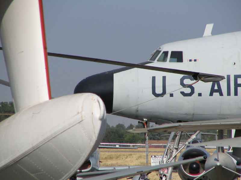

Old 08-03-2006, 04:34 PM
ec121connie
Join Date: Dec 2005
Location: Sacramento, CA
Posts: 34
Default RE: Scratch building 105" W/S Super connie L-1049 G
Hi CONCORDEFAN,
I drove out to the museum today and discovered that they had moved all of the display aircraft into a fenced containment area while the new museum is being built. They have the planes stacked tight. I'll head back over that way next week and see if I can get a better angle for a photo or two.
This Connie was originally a Navy D model. It was recovered from the bone yard in Arizona and flown back here to be painted in the Air Force colors. The tip tanks on the Air Force version were a little different. These are much closer to the civilian version.
Here are three photos. I should be able to get you detail shots later. Just let me know what you need. The majority of the components, Gear Doors, Struts, Props and Spinners, ETC should be very similar to the aircraft you are modeling.
SeYa .....

Old 08-04-2006, 07:28 AM
Props4ever
Join Date: Aug 2005
Location: Mississauga, ON, CANADA
Posts: 4,196
Hi EC121,
Those are nice shots, you are right, your Connie is very much closer that "G" model i am modelling, for my purpose it just dosen't have pax windows as on civil version but rest looks good though...I will let you know what i need, for some strange reason i can't upload my pics of our Connie here in TO.....
Sammy
