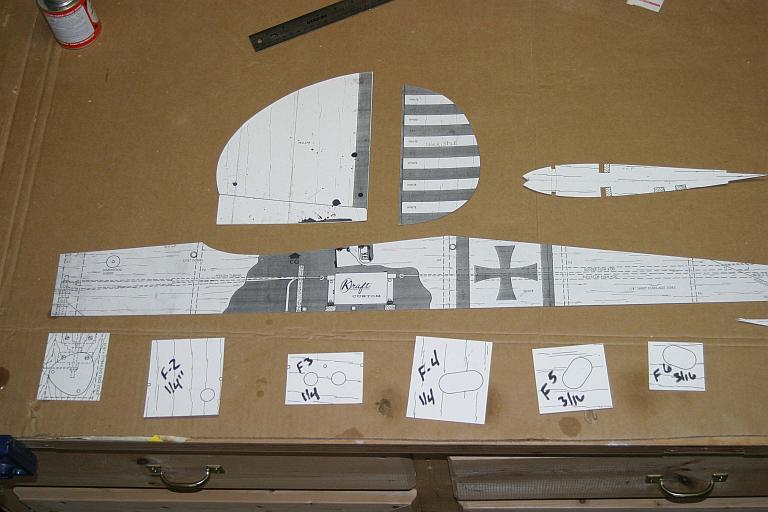

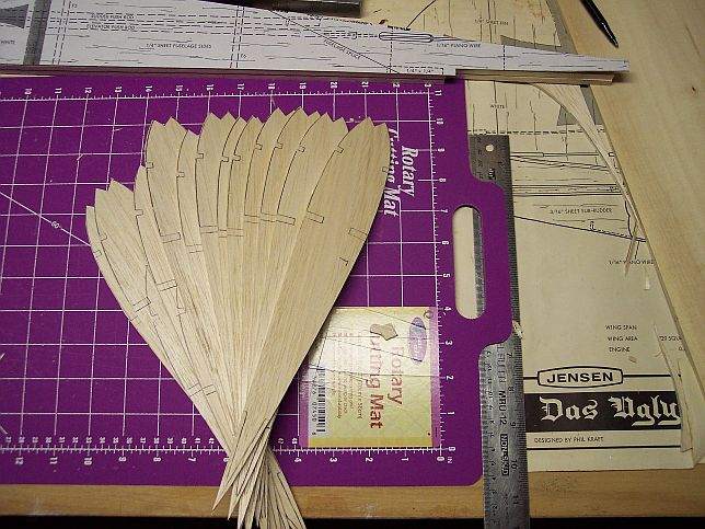

This is my first build in a lot of years. I pulled out the set of plans from my dad's Jensen Ugly Stick. He built this in the late 60s I'm sure. Last Saturday I woke up to about 4 inches of snow here in Virginia. Good day to start building! So, I'm finally getting started.
I got most of my templates cut. I had the original plans copied and then I went to the local craft store and bought some relatively thick "chipboard". Used rubber cement to glue the fuselage sides ribs, bulkheads etc to the chipboard then cut them out. They may not last an eternity but I can get a few builds from it. Only planning on building one anyway. Who knows, maybe someone will ask me to build them one. I always enjoyed building more than flying. Well, almost more.

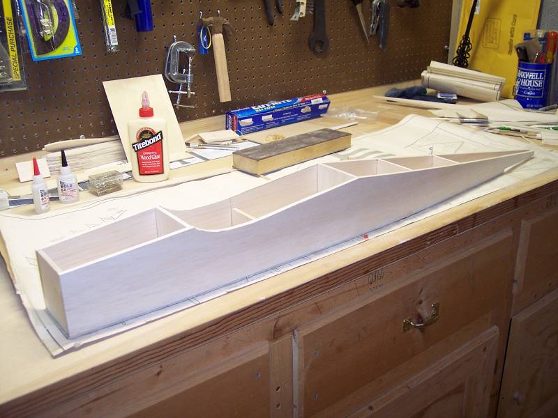

It's good this is a quick build. I could only muster up about 2 hours of shop time this weekend. I didn't have my camera so no pictures today. The fuselage is glued up and drying now.

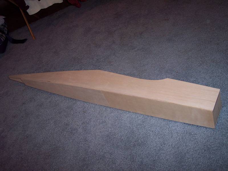

Fuselage is together and the bottom glued is now glued on. I forgot to bring my digital camera home so no pics yet. Got to figure out the next step. I guess some sanding and rounding of the bottom sides then I'll glue up the horizontal and vertical stabs. I'll probaby do the wing up and test balance since I'm not sure how it will go. I'm assuming the servos will mount in the rear most postion.
Leaning toward the trike gear. I remember the same landings with my old sweet stick as you described 8178. It was a real sweet thing to land. Still working and thinking on paint scheme as well. I have a good idea. I'm gonna use some type of silk n dope method and actually paint this bird.
