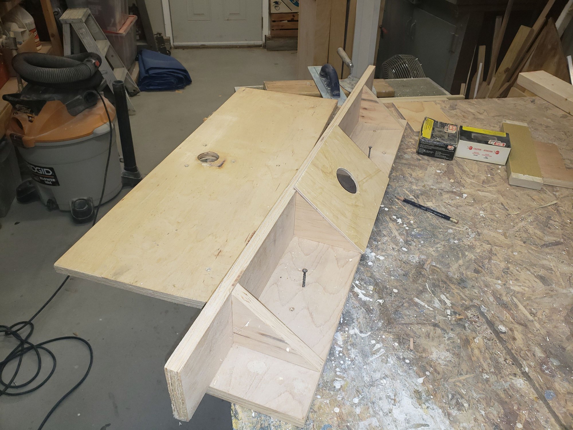

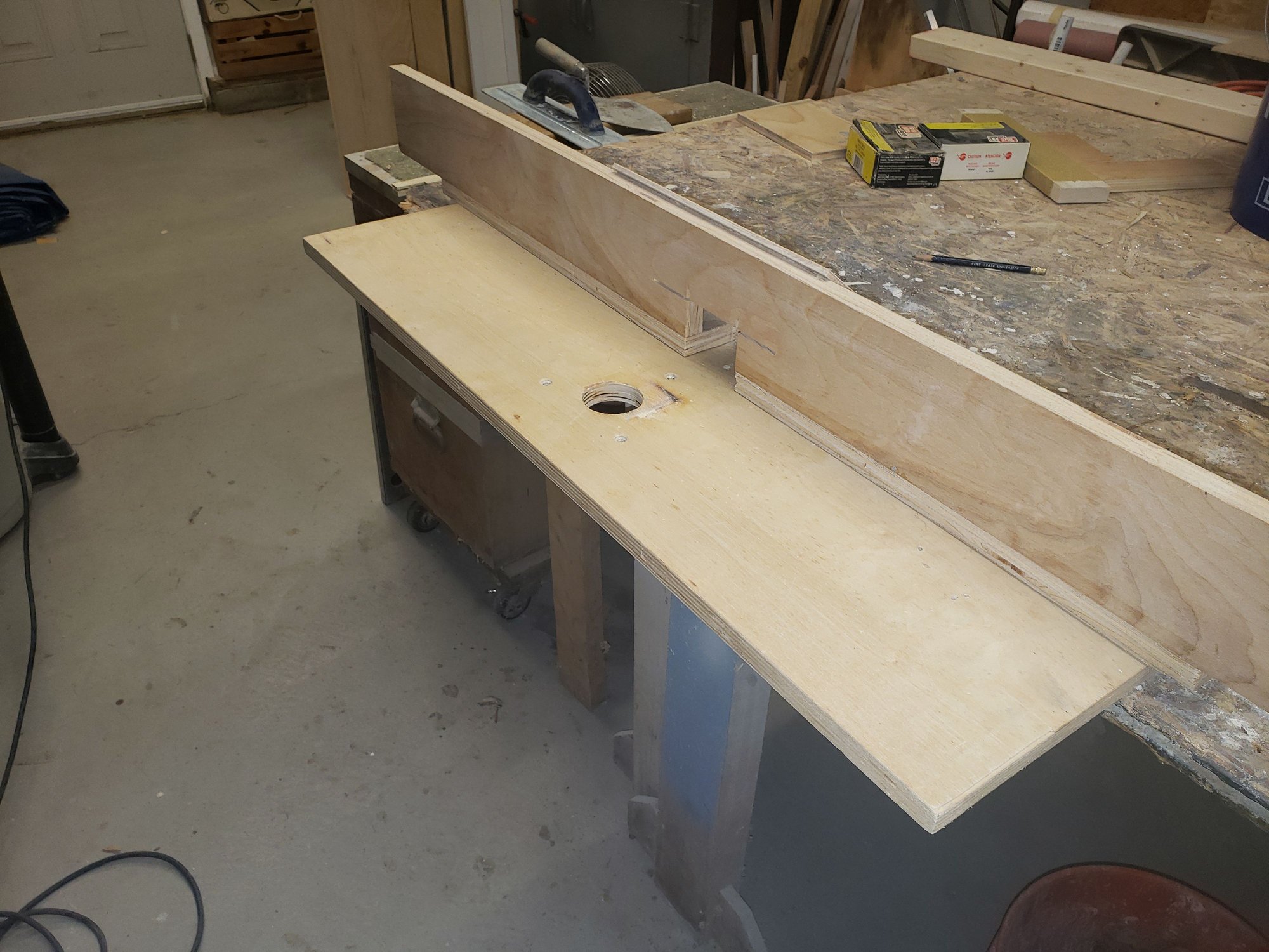

Well you better add some sacrificial piece if you use the table saw fence,
I'm a carpenter and cabinet maker by trade,, I gave away my router table and fence and use a super simple set up that stacks in the corner when not in use, ,made from scrap 3/4 ply est cost of materials at the time,, $15
Just clamps or screws to my run out table, fence has hole for dust collection,, K.I.S.S.
