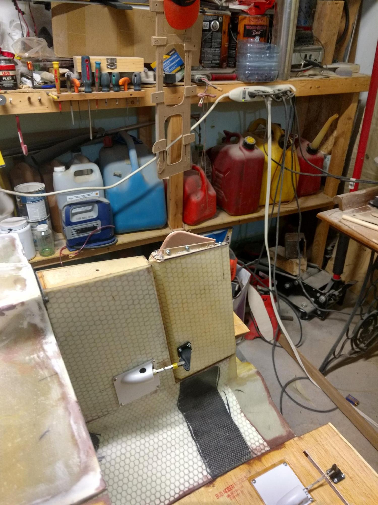

Just snooping to see if the photo uploader has improved lol This photo is from last year. Was working on the engine pod molds. All molds were finished last winter.

Finally home long enough to open the mold... I have a fuselage!! Name:  smile.png
Size:  819 Bytes Very happy with the results.
Weight so far...
2 wings...1273
2 Horizontal stabs..654
Fuse..2155
Total...4082 grams or 9 lbs
Still have to include the vertical stab,wing tips and ailerons..so possibly under 12 lbs. Much lighter than I expected. I was figuring about 15 lbs. The wings will be made much lighter in the future as I have redesigned my method for holding the wings on.

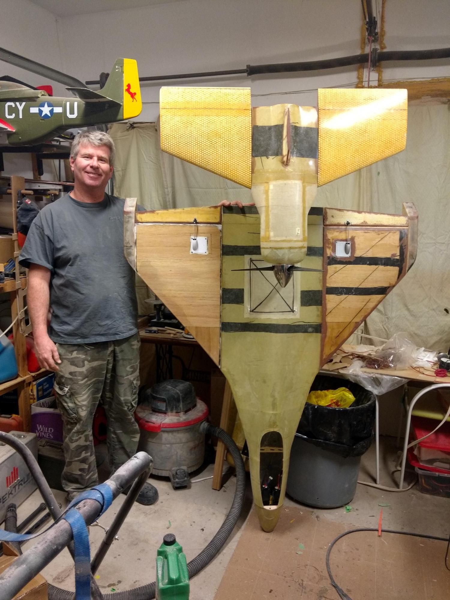

Old 01-19-2019, 03:04 PM
  #111
Vettster
Vettster's Avatar
Join Date: Sep 2007
Location: Beeton, Ontario, CANADA
Posts: 1,314
Just need to run ESC wires.
Install battery tray.
Rx.
Do the CG.
And then I guess maiden the darn thing.
For Scale reference... Im 6' tall

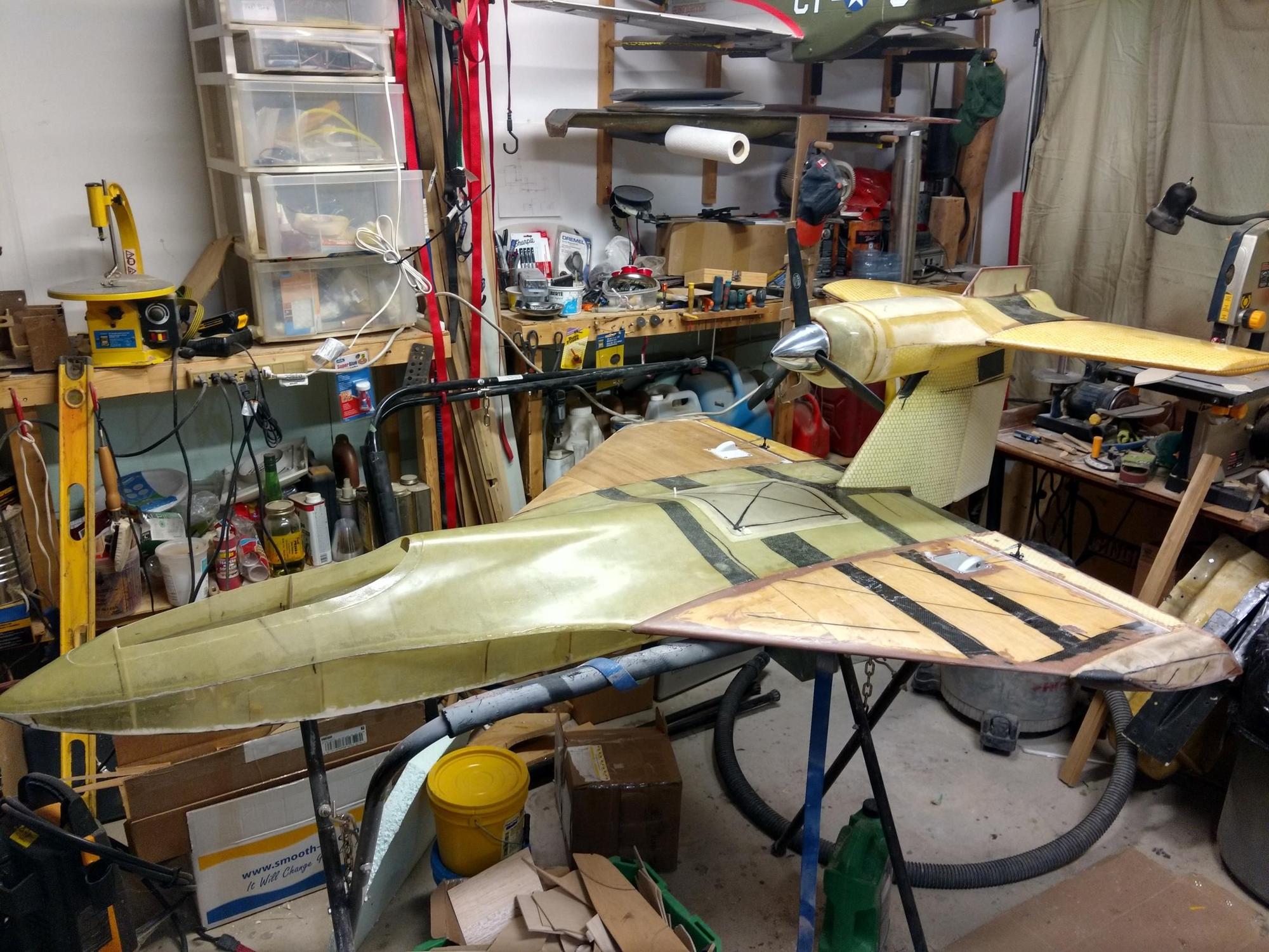

Originally Posted by Square Nozzle View Post
Hey Trevor, those aileron servo covers look very close to what I made for my Turbine NorthStar. Have you been in my work shop? Great minds think alike.
Ha! Sorry to hear you spent time working on them.. I got em at Alibaba, 20 sets for about 30bucks
Today I got the CG set..(im not working outside in -35 windchill thanks) Not surprising that I had to add about 2lbs to the nose. Total takeoff weight with the electric version is 22.5lbs Pretty much the exact same as a Sprint jet however the Wetjet has a MUCH larger wing area and will carry twice that much weight if need be. lol Name:  wink.png
Keep in mind that the next one out of the mold will be even lighter as I have redesigned the wing attachment method and that the Horizontal stabs will be much smaller. I do realize how huge they are Name:  sneakiness.png
Size:  683 Bytes lol Seemed like a good idea at the time
