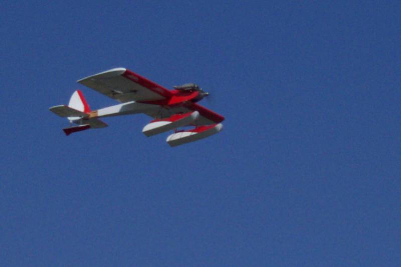

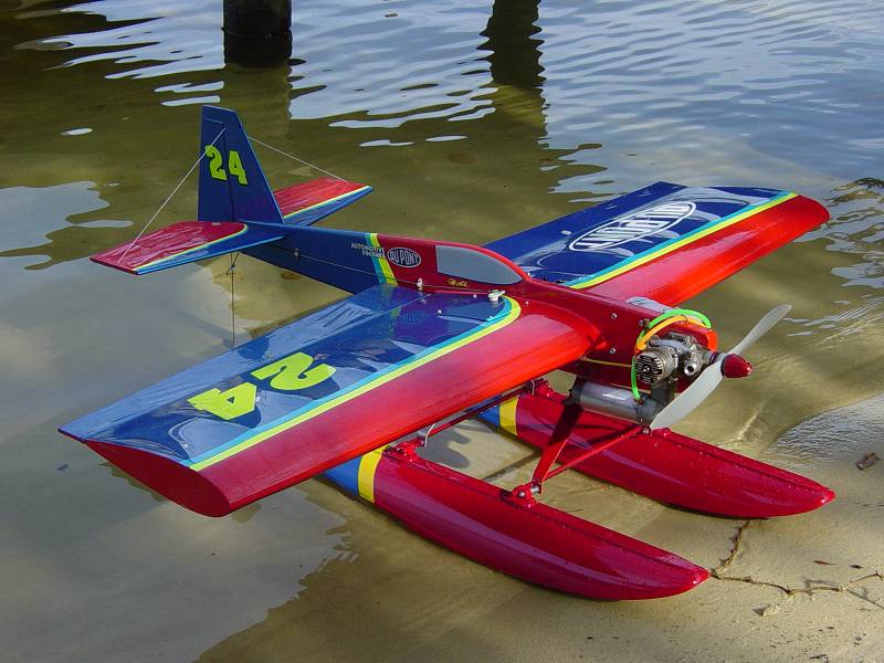

Any acro or 3D plane flies great on floats. I usually use an old one that has been retired. Sticks are great, too. I have owned or own a Sig Fazer, Florio Flier Stuntwagon and Uproar on floats.
Guys want to start with a trainer, but high wing planes with dihedral can tip over in wind. You've seen a high wing trainer pick up a wing tip when taxiing crosswwind. On a seaplane, it will dunk the outside float and the plane will tend to rotate tail into the wind. Then the tail picks up and over you go. I find the low aspect ratio acro planes handle better. Turn 'em into the wing, hold some back stick, pop the power and you're gone. They fly inverted great, too. The floats give lift inverted so on some planes you don't even need forward stick.
My preference is for sheeted foam floats. I've tried all kinds, but foam floats can't leak or sink. You can break one half in two, 5-minute it back together and keep on flying. You can buy then pre-sheeted or just the foam core.
Here is a link for sheeted floats. My Uproar has these. [link=http://www.geocities.com/planefunfloats/]Plane Fun Floats[/link]
This guy sells unsheeted floats. [link=http://www.seaplanesupply.com/index.htm]Seaplane Supply[/link] I have tried the old timer floats, not his, on my old Stuntwagon. As soon as I hit power the tail picks up and you are on the step. I have them on a Stinger 40 now, but haven't had a chance to test fly it. I think this type float has possibilities for acro planes.

Here's a trick I use to cover up servos on the bottom of the wing. You know the plastic bubble packs that spinners come in. I use these to cover the servo. The back is open so any water that may splash in just drains out.
Another trhing, get some Corrosion-X or other corrosion prevention from a boat store or marina. Comes in spray cans. I usually open up the receiver and servos, wet down the PC board and let it drip dry, then put the covers back on. I also spray in the switch and all the connectors.
