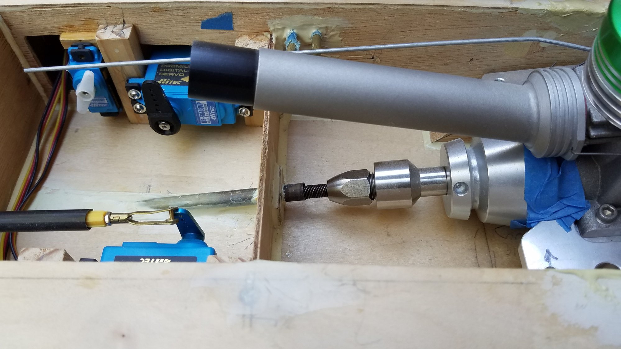

Well hello there! after a long hiatus from all things RC, I now have the time/life to get back into it.
What I am looking for is any info or guidance to convert my Dumas Miller American 1/8 scale to lipo/brushless.
I started the build during a family issue as a distraction, and was going with a CMB greenhead .87 nitro, but now am re-thinking it.
I would be happy and grateful for any input given. Just looking in the past 2 days, I see the word "Leopard" for the motor, (1100 to 1200 watts? needed for this hull/weight), and a big ESC.
Again, any guidance would be of great help. I am in the final stages of detailing the hull getting ready for seal/paint,n and that's when I got the notion to go brushless.

Got any pictures of where you're at in the build? You may need to take the bottom off the boat to do the conversion you're looking at.
As for your original plan on using a CMB .67 green head, the boat was never designed for that much power and might cause issues when running. That said, it is very doable to get the boat running with that CMB but, as with all projects, there is a learning curve as well as a lots of testing

Good Morning Hydro,
Thanks for the response. And I will toss a few images here in the next couple of days. I knew the Dumas boats tend to be "heavy", (I did the sport AVL and a Miller back in the late 80s/early 90';s) so that's why I went with the green head. I did re-enforce the motor bay (side and bottom), the sponson rears, and the transom/bottom plate, just for "stress loading". I have no issues if I have to open the belly to re-do the driveline.
But with the "environmental/"social" aspects" of nitro, I was thinking I would get less grief from onlookers etc., etc., etc...
But I still love the smell of nitro/alcohol/castor as it burns...
Give a day or two and I will have some images up for your perusal....

You are not making the best power choices here @Bill D, this is a heavy boat with a rather obsolete bottom design. The Dumas AVL will not perform well on 6S, amp draw will be too high; use 8S. Install a 100 mm long motor with a Kv of ~850, more Kv will just eat amps. TP motors are more expensive but much better than Leopards and are available in the correct 100 mm size for this boat - 92 mm is really too short. An ESC with a minimum 150 amp capacity will work well. An x457 prop will give decent performance as long as the overall setup is good.
This is essentially the NAMBA 1/8 scale race setup, which is well-proven and relatively mild yet gives wonderful, realistic performance. If you’ve ever seen them run you will know what I mean. When you need more speed, change the prop.

TP will build you one, the 5Y is the closest. http://www.tppowerusa.com/motors/bui...series/tp-4070
Another perhaps better option is the HET 700-98-840, these are good quality motors too.

Here are the motors listed in the R/C Unlimited rulebook:
i. NEU 1527 1.5Y 850KV
ii. HET Typhoon 700-98 840KV
iii. Turnigy SK3-3994 850KV
iv. TP 4040 10Y 830KV
As far as ESCs and batter packs:
Electronic Speed Controls (ESC)
a. Any ESC may be used as long as it is rated to a minimum 130 Amps and rated to handle a
minimum of 8s battery configuration.
b. Anti-spark resistors are advised on all speed controllers.
Batteries
a. A maximum capacity of 8S Lithium Polymer (LiPo) batteries are approved. The maximum total
mAH capacity of the battery pack(s) will not exceed 6000 mAH. Only LiPo batteries with a cell
rating of 4.20 or less volts per cell are approved.
b. LiHV batteries with per cell capacities to 4.35 volts or higher are not approved.
c. Manufacturer’s minimum discharge of 30C constant shall be allowed.
These are what are allowed in R/C Unlimiteds. Throw in a hard or flex shaft with a 57mm prop and you're good to go

That said, you're dealing with a heavier boat than the guys race with. To get it to run, be it in competition or just to fun run, will require more power than the dedicated racing boats will to obtain similar speeds. Equal power will give you a boat that will run but won't have the top end the dedicated race boats do. If you want to try to use lighter stuff, feel free. If that lighter stuff fails due to overloading, what can I say, that's the breaks of R/C boating
I posted what the guys racing use in their boats for a reason. IT WORKS!!!!!
Like I have stated, I don't need a rocket just a boat that will get up on plane and throw up a rooster tail, if the boat only does 40 mph that's fine
for what I have intended it to do. Several years ago I set this exact boat up for a club member in stock built form with a K&B 67 nitro motor, very
heavy boat but with the nitro motor would run in the low 50 mph range on 65% nitro, but I am no longer into nitro boats, the reason being I am
looking to go electric. There is no longer a lot of the racing sites here in Louisiana and Texas that I used to run hydro's & mono's on so I will have
to have my fun at the local lake. I think under the circumstances electric is a more viable power source due to the advancement of brushless motors.
plus I don't have to worry about the noise factor to nitro related running.

All water proof servos, the rudder servo has the torque almost twice as much and the "quarter scale" servo they recommend for this hull...

So I am looking for some input to flip this hull to elec/LiPo, and looking for any help with guidance. I think I can stuff in a 6S 5K mah with out any real mods to the nose, or may have to go 4s2p....
