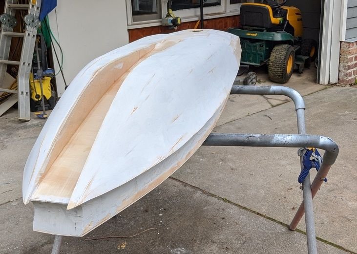

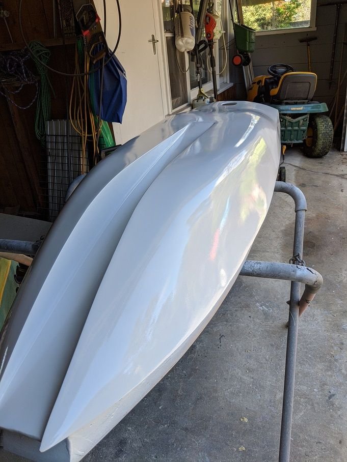

Interior of hull, pre-fibreglass.
Hull design, skirt will be held in recess.
Jet drive with ruler to give scale.

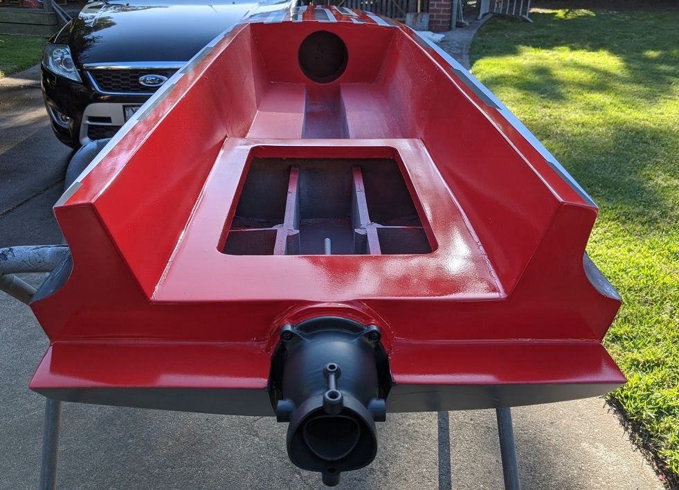

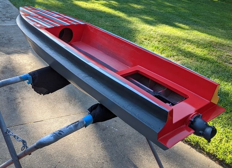

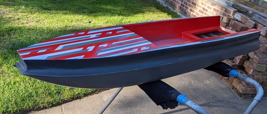

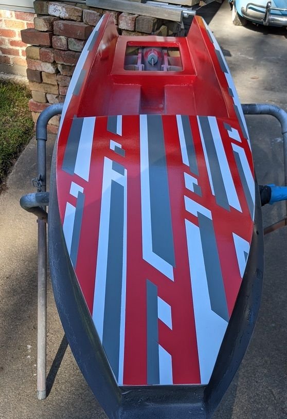

Hi Everyone,
Thought you might appreciate some updated photos.
Still have to make the collar
Central section will be filled with the electronics pack
Been waiting for the motor for 2 months now SSS56104
Jet drive is installed
