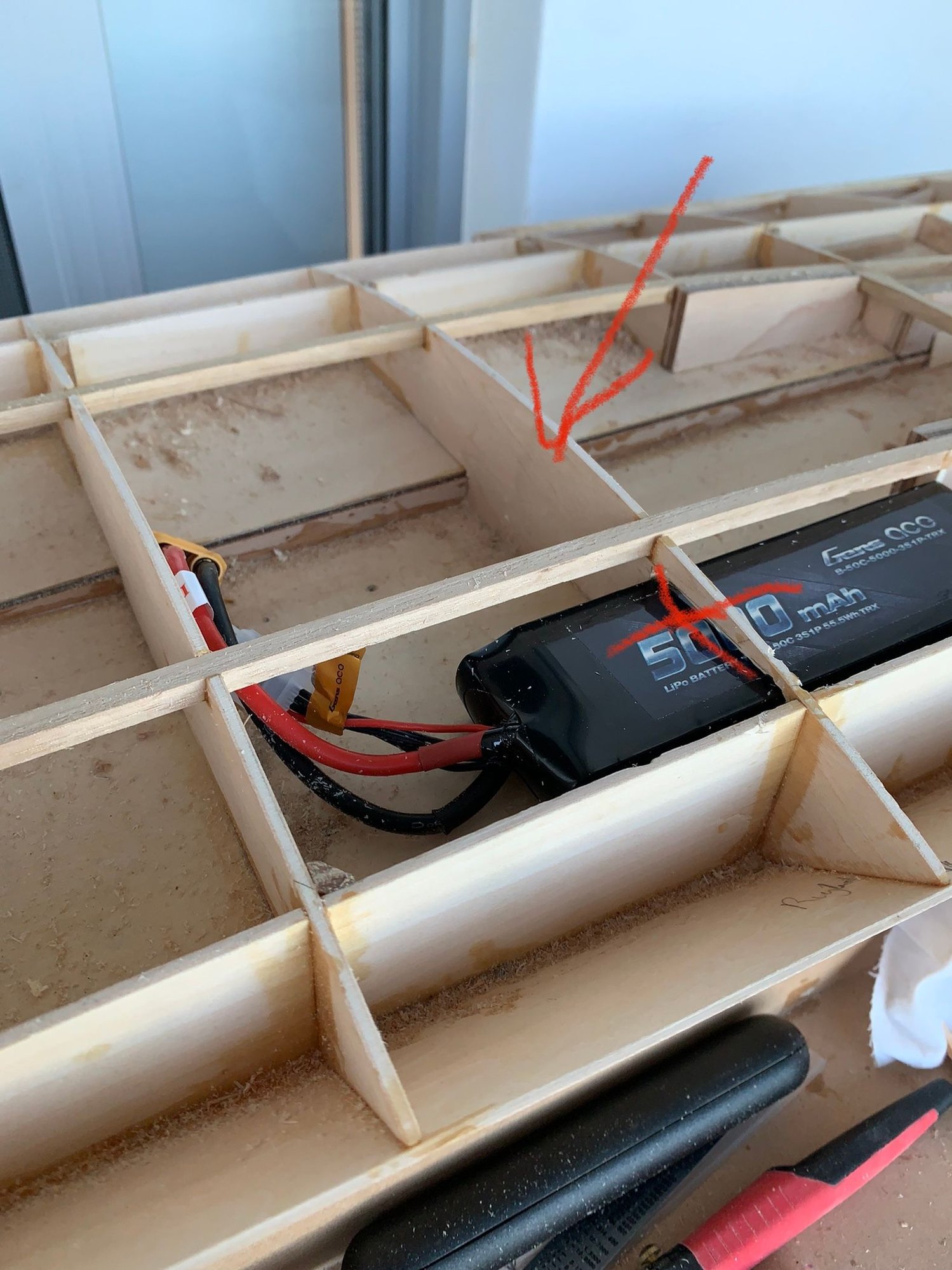

Old 05-25-2021, 10:12 PM
  #97
Vilante
Vilante's Avatar
Join Date: Oct 2020
Posts: 52
Perfect.
It looks like Iíll have to remove this bulkhead completely. I was hoping to cut a hole in it like Iíve done but you wonít physically be able to get the batteries in with that bulkhead there at all.
I will need to support the deck strip though or it will lose it shape, so Iím thinking of cutting out a strip of aluminium the same shape as the inside of the deck strip and epoxying it in Joe (after trimming the bulkhead to fit it in. Then when I put the decks on and remove that bulkhead it should retain its shape in that area.
The worry then will be that the deck over the battery there will have nothing to rest on and might sag?
Old 05-26-2021, 05:37 AM
  #98
Hydro Junkie
Join Date: Nov 2004
Location: Marysville, WA
Posts: 9,361
Received 56 Likes on 54 Posts
Had to think about this one for a bit. Since you're making the frames out of lite ply(not my first choice but what the heck), my recommendation would be to add a 1.5 to 3mm plywood doubler on one side of the frame in question from the top of the frame down to the top of the pocket you cut for the battery, taking it all the way across the hull. This will give you some additional strength and support for the decking, It may not need the added support but it won't hurt anything either

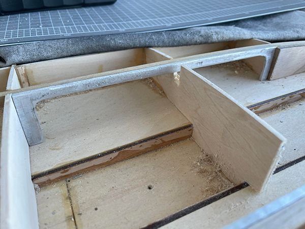

So, any updates?
Moving a little slowly
I decided, as I'm removing one bulkhead completely to fit batteries in, that I'd create an aluminum brace. I've done the braces that run down the boat but I will have a perpendicular piece mimicking the bulkhead (but with clearance underneath for the batteries) to support the deck on each outside edge, and strengthen the boat in this area.
