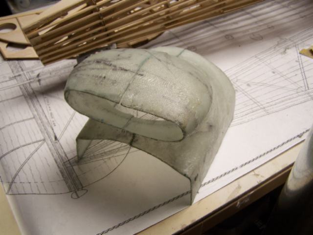

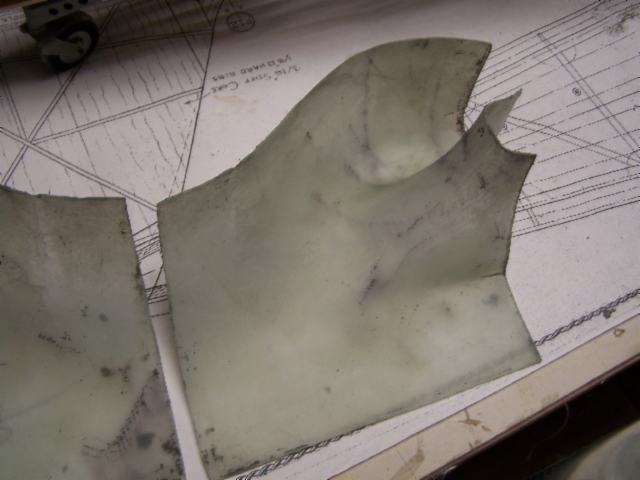

I did make the molds for the air intake today

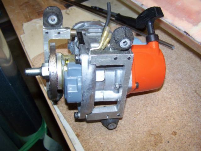

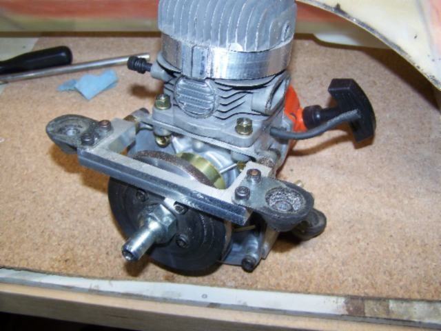

finally received the engine . started the conversion by machining a 1lb flywheel , next was to make some billet motor mounts , I used 4 rubber mounts to help deal with the vibration of this high compression power plant . The .24 carb was replaced with a .36 . . Motor mount blocks were epoxied into the hull and motor mount studs were epoxied into the blocks for mounting .. Next I removed the new cylinder and machined the 3 center fins just enough to make them round . I then machined a 2 piece sleeve that will clamp to the outside of the barrel to water cool the center portion of the cylinder . The cylinder will be fed by dual water inlets from the rudder . Still waiting for the driveshaft . but will move on to the muffler once the water jacket is done ..

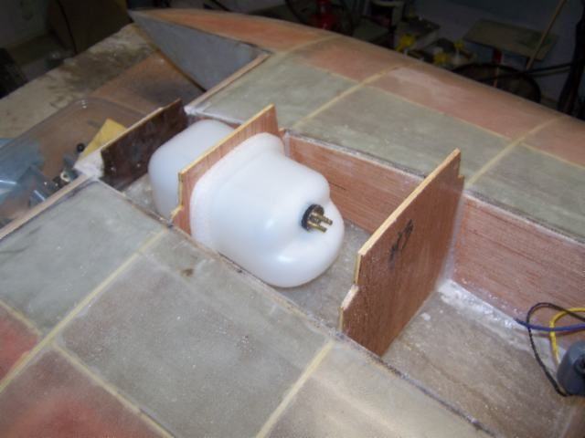

Just finished the exhaust header pipe, the ports are so massive on this engine I needed to use SS pipe for a ZDZ 210cc engine , was a little tricky having the header pipe exit the engine and not cover the mounting bolts .. The pipe is a Greeves that has been cut in half and shortened . added a extra baffle plate to help cancel noise . will have to do some testing to make sure the exhaust is not to restrictive .. also mounted the fuel tank . once the drive shaft arrives I can finish her off and get it read for paint ..

Flip that pipe over or you will have water issues. With the pipe opening pointed down, that prop will throw water right into the pipe and, since there's no way to drain it while running, it could fill the pipe up to the bottom of the exit tube

Good point friend , it's a modified pipe form one of my planes . the down spout is a plane thing . I will cut it off straight or tilt it to the left .. After much thinking about the top panels I think it's best to join the scoop section to the front cover . I can hinge the whole assembly at the front of the boat and have a latch at the back of the scoop . This way It will only need one attachment point for the cover , This will give me easy and fast access to the fuel tank , batteries , engine and carb settings . the other option I considered was to bolt the front panel on and have just the scoop section quick release but I like having easy access to the fuel tank and batteries .. The second option would be stronger on a flip over but doubt that will ever happen .. ..
