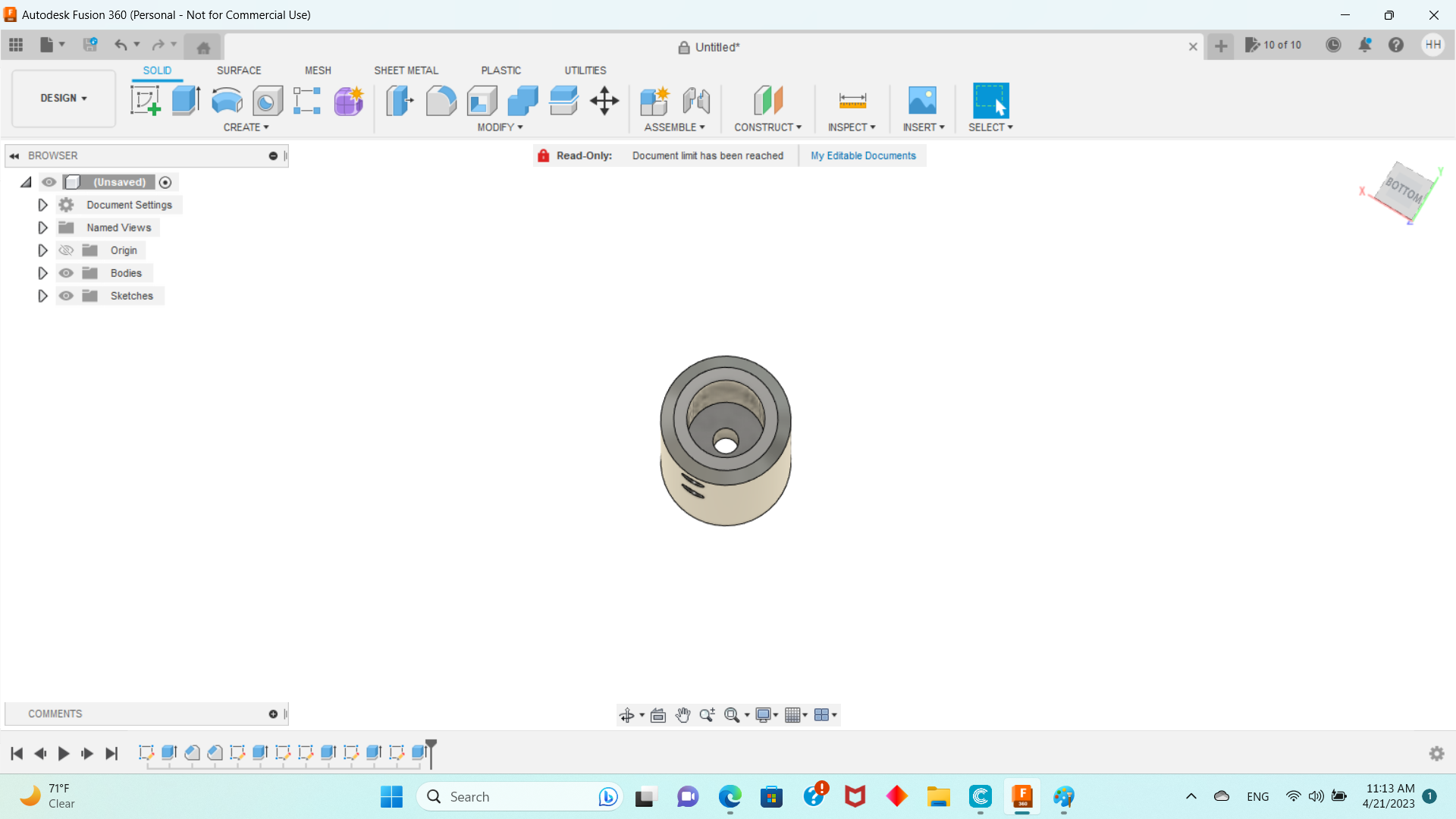

Default Clugh overkill push/pull 6mm rudder control arm.
I cant deal with the flex and I do not want a z bend or anything like that so I drew up ends that will achor 3mm ball ends to a 6mm ground shaft I took out of a salvaged printer which has stiff straight ground shafts. The obvious progression would be carbon fiber rod but you can see how it works. The set screw secures the adaptive assembly to the shaft on locking flats ill grind onto the shaft. The 3mm ball end is also aprx 6mm so it glues into an interference fit and 4/40 pre threaded anchors. Lets see how that goes. It will be a straight shaft setup directly to the servo. So I have to slim down the servo tray to put it right on the right rail. I want the rudder rock solid so ill accept the additional weight. If that's what slow me down I have other issues. I think a fluttering prop slows you down even more!

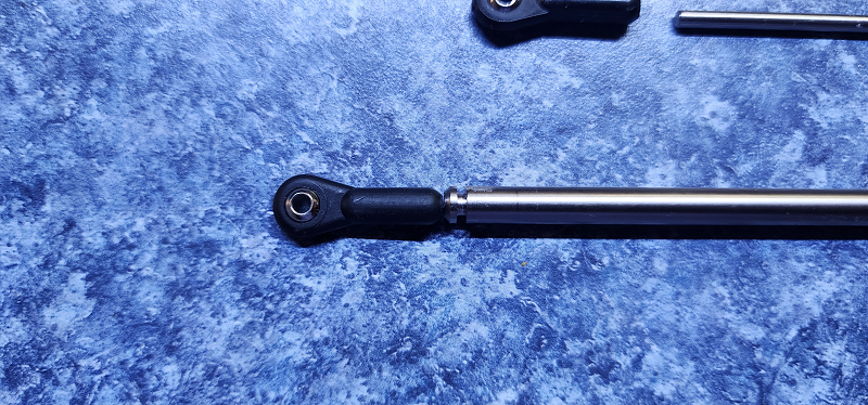

Hi
the final version came out nice. I reamed the 6mm shaft side and left the ball end side raw so it is a NICE TIGHT interference fit both ways. Really nice no lies. Ill have to memorialize this one in CF rod and see if the boys are interested. This is a fairly long one and the rudder is not moving unless the servo does and I don't care what side of the boat the rudder is on it does not care!! Ill weigh it when its cut to length. This is going to work really well. I guess i can design a larger ball yoke really and thread the rod. In Cf composite adhesive is strong enough.

As a machinist and engineer myself, it seems like it would be a lot easier to just turn down the pushrod/shaft and thread it for the ball end.
Or even just thread a piece of tubing (stainless, carbon, aluminum, whatever you like) and use a short piece of threaded rod to connect the two.
Not that the 3d printed sleeve won't work, but it doesn't seem like the easiest, cleanest, fastest, or strongest way to do it.

Really so you'd turn the 6mm rod down 4/40 thread??and consider that stronger than 12mm diameter PLA overtop of it with a 6 mm high impact nylon insert and the 4/40 also threaded in . That's interesting! Js
Why didn't u help the boys out and build the pushrod for us so we could use i? Plus you don't turn a hardened ground shaft u grind it and pay 10 times the electric bill and no u wont manually machine it faster or with less waste so that's a dream. Silly to fire up a lathe for it .

You said it was ground, you never said it was hardened, we were supposed to guess? And if you took it out of a printer, I assume it's just a linear rail, in which case it's only case hardened anyways. It would only take one small (albeit annoying) cut to get below the hardening. If it IS fully hardened, it isn't really the right material for a pushrod in the first place! Besides being way overkill, by using hardened shaft you're now risking breaking as opposed to bending. Of course, at that size, you'd tear the rudder out of the transom before your pushrod bent, so you're not gaining anything anyway.
FYI, I do make my pushrods, but I just use 4mm SS rod and thread it. There's a reason no one makes pushrods like you are here, it's hugely excessive and overly complicated. You're adding weight and complexity with no added benefit.
