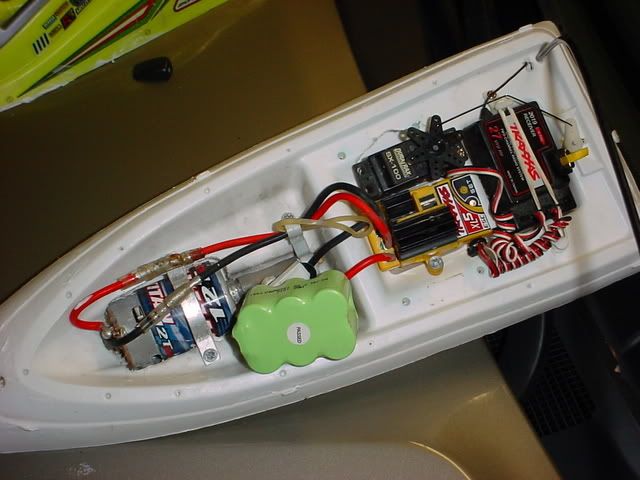

Heres a pic of my 1 modded ZZ2 I can tell you also they go like heck on 8 cells !!!
I have a got a few ZZ2's

HOLEY [email protected] thats alot of zz2`s i think you should send some to me so you can free some space up lol

Yep thats my video. The hull can't take the power it was more of an experiment. Don't bother with the zig zag hull its crap and takes on water.
