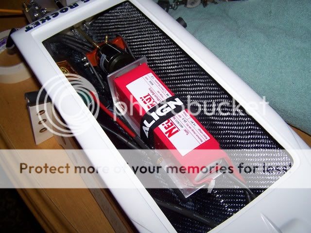

Hey guys, just thought I would post my setup since it's a little different from the norm. 2200kv outrunner, Scorpion 120 Commander water cooled esc, prather s215 s&b, single 4s 5000mah 46/92C lipo:
