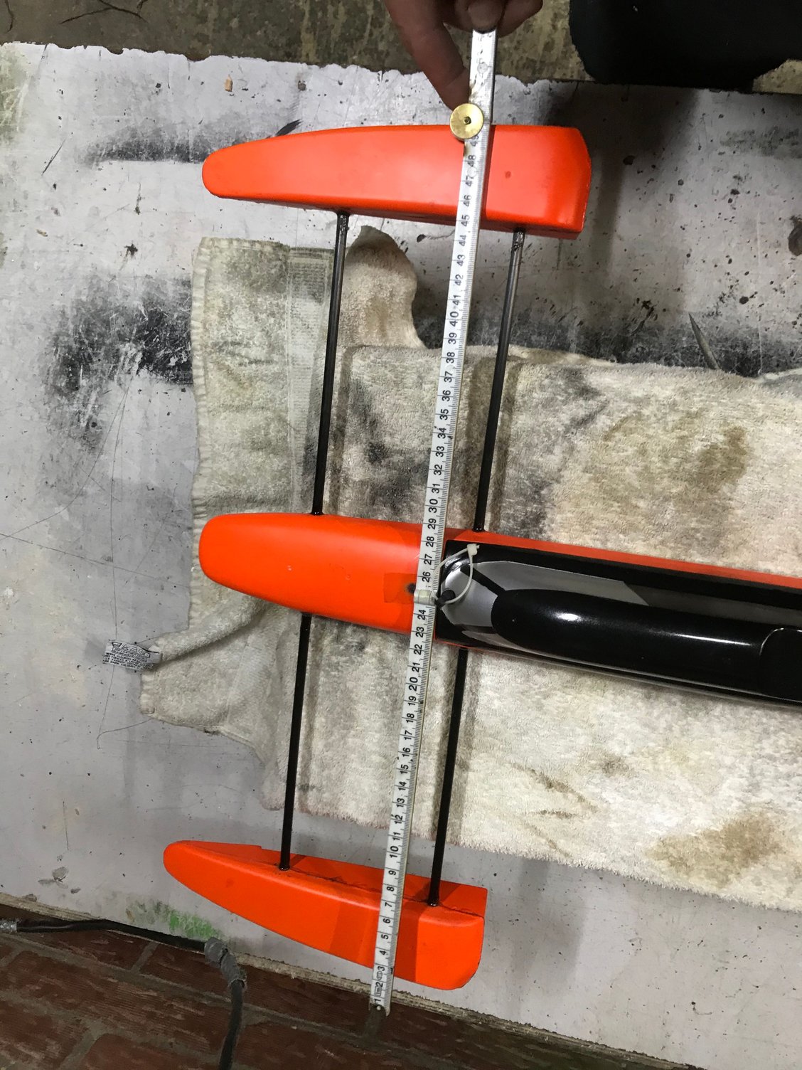

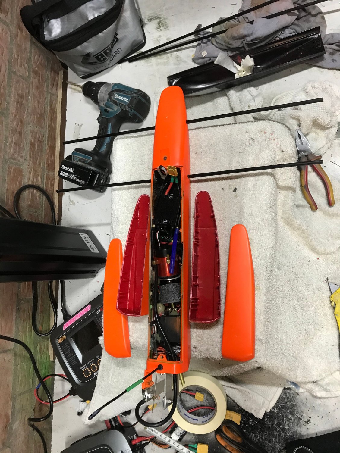

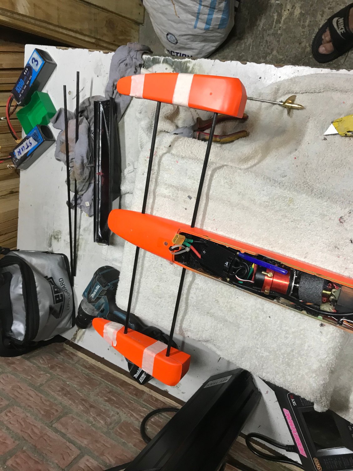

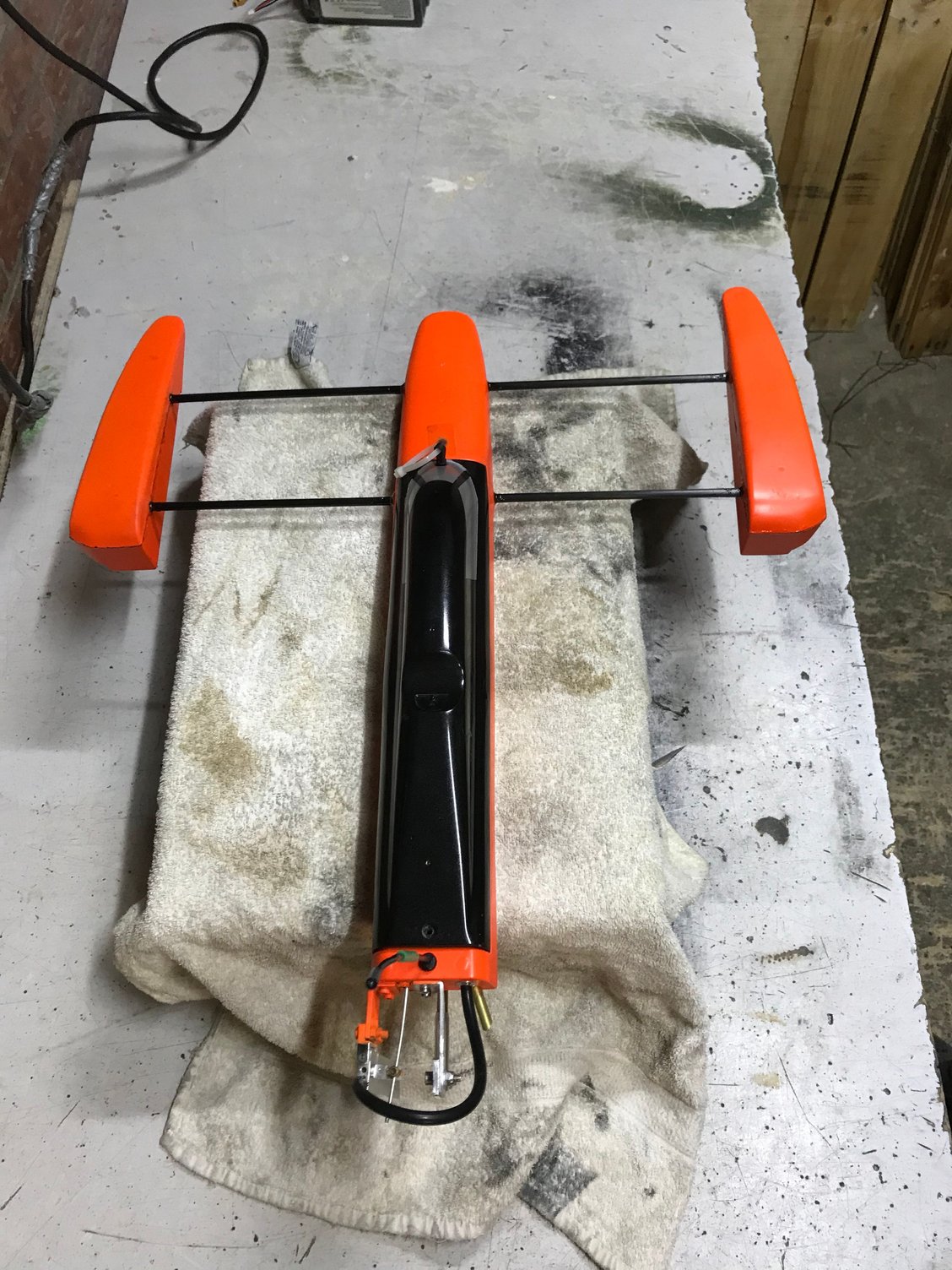

changed the motor for a 3900kv 3650 inrunner.
still have my 40x1.4 prop installed.
started on 2s: too slow😂
went to 3s: looks better but not that fast.
tried a 1300 mah 65c battery from my small bolt... this looks way better.
I could hold up with a Sonic Wake 36 with leopard/seaking and 4519 prop..
in the video one of the pontons came loose. Didnt bother because I was about to open them up and fill them with foam, and widen the Arrow Wind.
its now 50cm wide instead op 36cm stock. And I used 5mm carbon rods to add stiffness.😁
the good thing is that the motor and esc are cold as ice. First I want to figure out the handling and have the hull set right.
after that I will try bigger props (ordered 42mm 1.6 cnc). And maybe try 5s or even 6s.
but for now this rigger brings a huge smile on my face.

I think the rigger with this setup, compared to the sonic wake, will do around 50mph.
unfortunately my gps device doesnt fit the small area inside the hull.
I will try to maybe ducttape it to the outside of the hatch. But first well see how the widened arrow wind behaves. I Need to set the strut more positive I think for less hopping on the rear.
