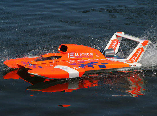

Hydro Junkie 05-25-2021 04:00 PM
5 Attachment(s)
You won't find fiberglass in any of my wood hulls. As far as I'm concerned, if the boat is properly built, it's just added weight. The only FG you will find in any of my boats is the cowl and tail feathers if I built it. I have a FG 1974 Valu Mart hull that I've been restoring and the one pictured below that I've been racing for the past several years. I bought both, the Valu Mart being assembled by a guy in California that likes heavy boats(it weighs at least 8Kgs without fuel, radio gear, driver or any other detailing parts) while the one pictured below is 6.35Kgs RTR and is all FG with birch ply added to stiffen the bottom of the sponsons, used as engine bay side bulkheads to support the inner edge of the decks and used to build the integral radio box.
