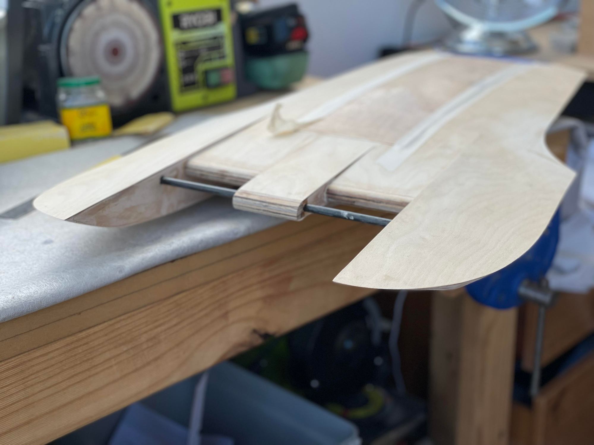

Vilante 01-23-2022 02:23 AM
I didn't see your images last time sorry. I've already strengthened the transom substantially and planned to use a metal plate inside the boat further strengthen the rudder mount.
Finally getting some time to work on it. Not far off giving the outside a coat of epoxy. Is it normal to coat it and wipe it off or leave it? And is the epoxy usually thinned for this process?
How are the rear wings usually mounted? That's the next job along with the cowl.

I use aluminum tabs with the mounting holes bolted into the rail the I slot the deck skins to accept them. I then use nylon screws of really small metals one that I hope sheer off in a blow over etc. If you've already glued the deck down u may have to measure and slot them blindly and glue mounting tabs in place. Even though it looks nice id round those sharp edges on the deck. The aero is better especially if it gets loose. Those sharp edge make the air chose a side promoting adverse aero when it gets squirrely. Unless you need it perfectly scale you may as well incorporate the newer sponson top deck aero into it for a more stable ride. .Look at a modern hydro in this area and you will see what I mean.

So you're looking for something metal protruding from the deck vertically and then you bolt horizontally thought that?
What about the top section of the wing? Just a rod through and some glue?
Does anyone know where to get the tie rods or what they'd be called? I'm sure I could get something from an RC plane but I haven't been able to find anything.

Yes...
This could be as basic or elaborate as you want. In the past my vertical stabilizers were made from a ply fiberglass sandwiched and cured in a vacuum bag. I sketched on the flat wing cores lines to follow and shaped them to the final symmetrical airfoil with the belt sander. They are really strong. Ive seen wings with foam cores like plans from a dumas circus . It all depends on your goals. Id think the wings could be make direct from things fiberglass sheet etc. The horizonal I've always wanted servo operated but never went there. My version of this boat may get those active surfaces and the optional front canard you see in the plans soon enuf\. I've changes the profile of my wings to more swept because the paks are so unattractive. Have you rolled your turbine stack yet? You also know the boat can be the Tosti Asti, right?
https://cimg1.ibsrv.net/gimg/www.rcu...702cf47857.jpg
https://cimg5.ibsrv.net/gimg/www.rcu...3b32dcd05a.jpg
You can use full length threaded rod from the airplane hobby shop inside K&S aerofoiled shaped tubular aluminum for the vertical anchors. They make it and it look good when u do it right. I single rod through the horizontal will work but you'll still need a small bracket mounted to its underside because now it can pivot to different angle of attack and youll need a way to lock it in position one you find the angle you like. For your small hydro you can us it to help with things like tail hop in theory.

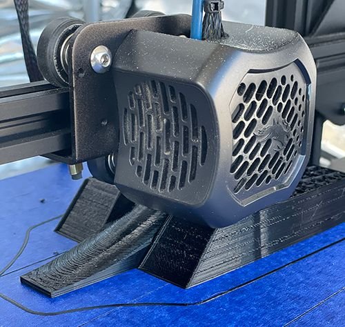

Vilante 02-07-2022 07:22 PM
Well I've done lots of sealing and sanding and I've got the mounts for the wing mocked up. Need to find some time to blue them in etc.
I've spent a lot of time modelling up the cowl, which I'm printing a test of now. I am learning the CAD software at the same time. I've learned a lot, but I'll need to start over to get it right, so that I can make it hollow etc.
It will have to be printed in 4 sections, this is the first. Fingers crossed it translates to the model :)

Use the print as a plug and make a fiberglass epoxy cowl. All you really will need is a vacuum bag. Im enjoying 3d printing as well. For you wings if you are drawing in fusion use a "shell" feature after finishing the sketch to hollow them but make the wall thick enough that its not too fragile. If you slow you print speed and make sure the PLA is totally dry the quality of your print will improve.
