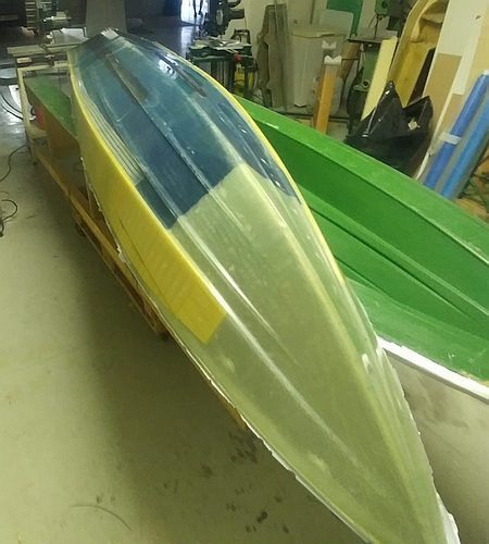

upper deck came out of mold, now you may see the size..... the guy is our composite expert who is producing the hull and all needed composite parts....

Default hull #1
is ready to be painted yet. Color test with wing was positive.

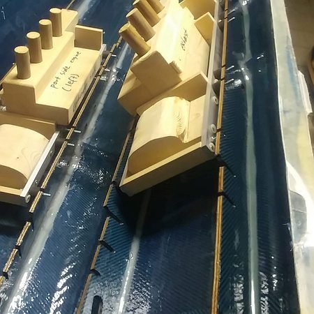

Default hull #2
this will be mine, is ready yet but the upper and lower halves have not been bonded yet because the rails have to be glued in before. These raisl have to carry all internal sub-systems like
- 2 x RAT HOUSE
- 4 x gas tank
- 1 x RC-box
- 1 x battery box
- 1 x E-pump carrier.
pic are talking self.....

test of package with wooden dummies passed, today I have pre-assembled the first 4 drives, but you can see: thrust ball bearing still missed.
What you can see: the rocker bearing is the only part which we did not design,

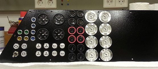

meanwhile I have prepared the dashboard
night time.....
daytime. The LED-lights with and w/o symbols I have found in ebay, the other ones I have build by my own.
