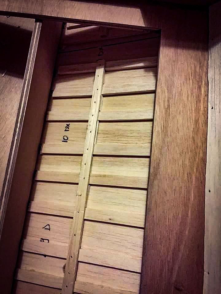

And here are the first photos of the hull (without deck)!!
The construction of the hull, for structural and ptratic reasons (assembly of mechanics and hardwear) was divided into three phases:
1- Hull construction and walls. Radio compartment construction. Engine arrangements, propulsion and steering system. Installation of the exhaust system. Cooling system arrangement. Electrical system arrangement. Fuel system arrangement.
2- Widening of the upper part of the calico. Structural reinforcements for complete deck. External covered profile construction.
3- Complete covered construction.
Here we are at 25% of phase 1.
In PHOTO 1 you can see the complete hull (actually still to be finished in this photo), as it will be for this whole phase, divided into 5 compartments: 1 will house the radio compartment, 2 will host expansions, tank and axle output, 3 engine compartment and upper cabin with future chamber and FPV system (insulated) 4 and 5 empty with floating filling.
The length from bow to stern is 210cm. The maximum width is 45cm.
The internal truss in marine plywood (7mm) laser cut from a single sheet of marine plywood of 260x120cm. The laser cutting is extremely precise but all edges MUST be sanded in order to take away the laser burn and be able to work. The CAD rendered drawing, the cut (which lasts depending on the material and thickness of the same) in our case lasted about 35 minutes. Each piece is assembled by gluing with epoxy resin and nailing with 6x2mm brass tacks (one every 6mm apart)
The primary interior of the hull is made up of balsa tablets (4mm) placed perpendicularly. In turn reinforced by balsa strips 4mm thick x 10 wide at a distance of 3cm from each other. These strips are then reinforced by a double transversal strip always 4x10mm (PHOTO 2) each pair of transversal reinforcement strips is finally covered by a last layer of 2mm balsa. (PHOTO 3). All this procedure is by gluing with epoxy resin and nailing with 6x2mm brass nails. Final result e.g. PHOTOS 4 and 5.
This lack of reinforcement even in the middle of the side member will not be done in compartment 5 as in addition to weighing down the bow it would be superfluous for two reasons: the section is shorter than the others and twisted, this gives a natural resistance more than the sides of the previous sections ; another point because there are the intersections between the fiberglass coverings of the hull and the bulwarks, which offer considerable resistance. (PHOTO 6)The entire hull is covered with orthogonal textured fiberglass fabric and epoxy resin with the "wet on wet" technique.
The hull has 6 layers of 160gr / m2, the side parts 4 layers of 160gr / m2, the deck 3 layers of 110gr / m2. (I will put time lapse reeds if I manage the hull cover phase)
Detail of the bow, finished (missing the final calyx of the upper part that "connects" to the deck (Phase 2) (PHOTO 7)
To test the resistance of the hull we built a section of the hull to test its resistance.
The result is a high resistance to twisting but at the same time elasticity. High impact resistance. (repeatedly hammered hard with square head of the hammer and no damage that could compromise navigation.
Thing not to underestimate absolutely: the weight. So complete and coated hull weighs 5.5 kg. We estimate a final weight of the complete hull (hull only) of 8.5 kg. Complete in order of navigation, empty tank, of 18kg; with a weight / power ratio (Kg / hp) of 1/1.

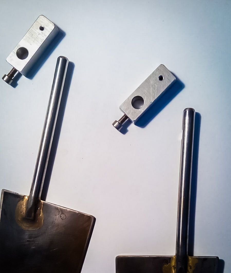

And here is the most delicate construction phase.
Positioning and fixing of engines, axles, rudders, hull float filling, main water intakes and carburettor linkage.
In this post the construction of the axles, rudders and main dynamic water outlets.
In the next, the most complex, the positioning of the engines (positioning of the construction, axle supports, positioning of the rudders and water outlets, fixing of everything).
