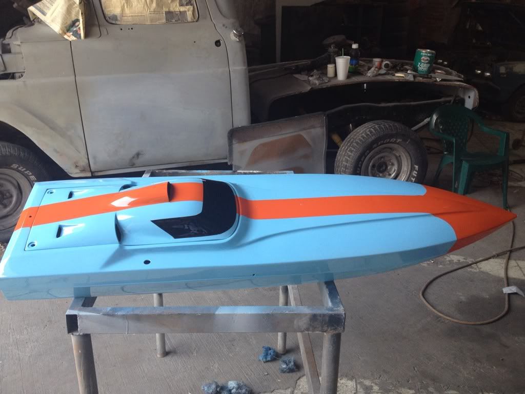

Hi
Finally after some shipping issues and one month of desperation, I receive my MHZ Ocean Spray hull, now it's time to start with the project, I'm going to put a Zenoah G260 with Bonzi Clutch and Bonzi pipe, MHZ Z-drive, etc. I'll keep you update as soon as I receive the parts.
Here's some pictures of my new baby.

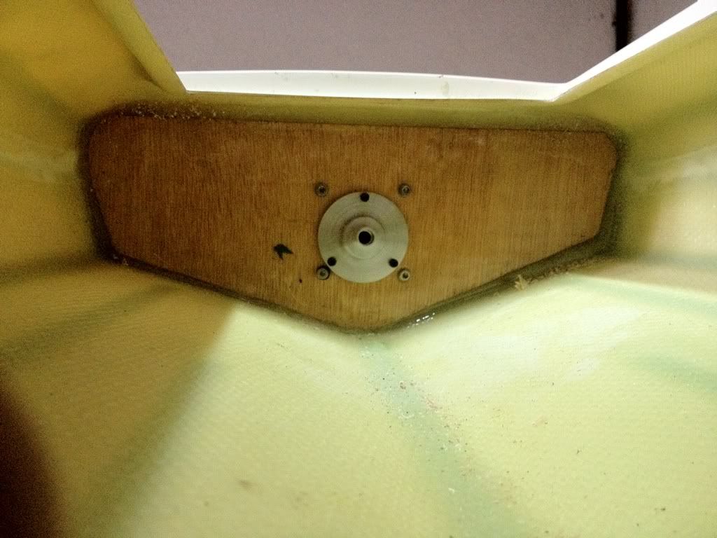

Ok guys now I need help, I have the Hull, the Zenoah G260 with Bonzi mounts, Clutch and Hanson Pipe, and the Z drive, Im a first Builder so here comes the problem, what's next? what kind of hardware do I need? can someone help me?
In the Z drive instructions it says that I need a Flex cable with square end but what kind of Flex cable?, the Zenoah have round collet.
The hull dont have rails Im going to build it from wood what's the best CG for this set up?
I know Im going to need a water pump, one is fine? I think I need to route tree water lines (head, pipe and flange).
Thanks for your help.

u can also purchase square end collets for the zen although iam not to sure on the web addrss try ware house hobbys or www.hobby-sports.com

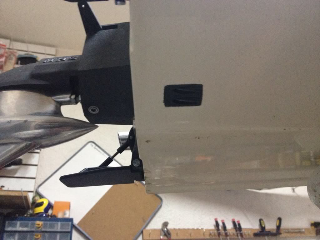

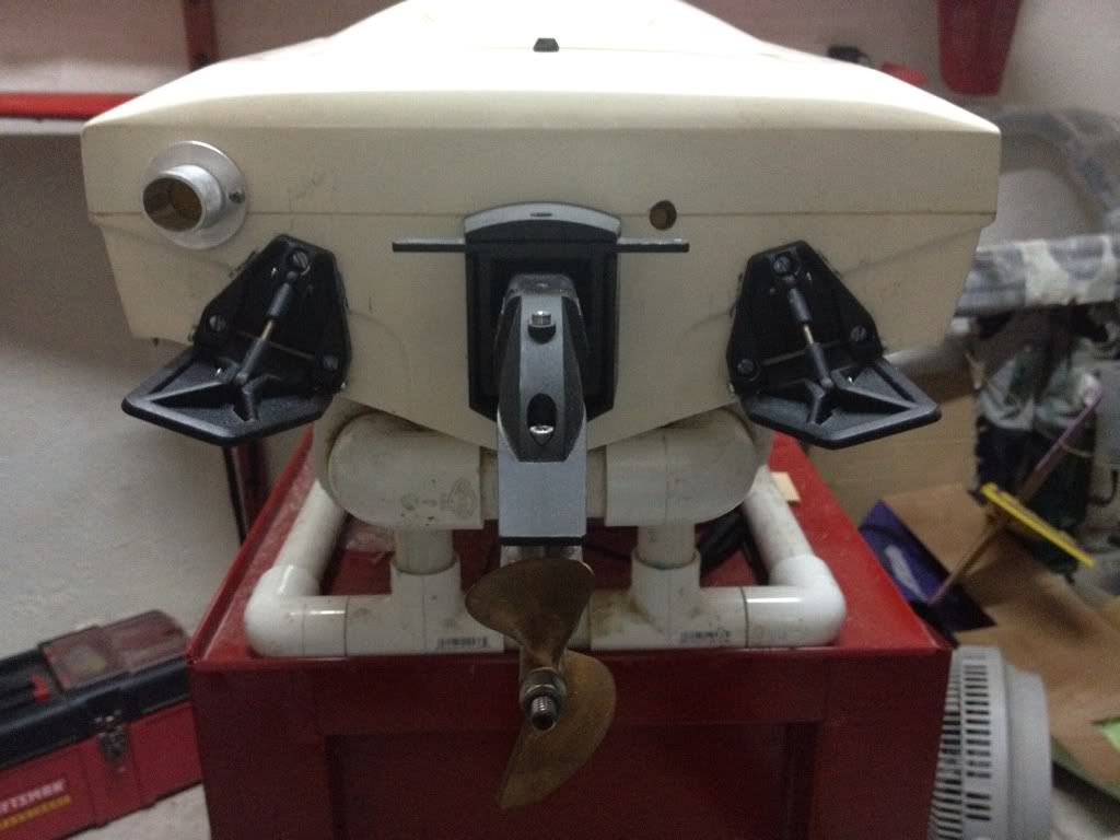

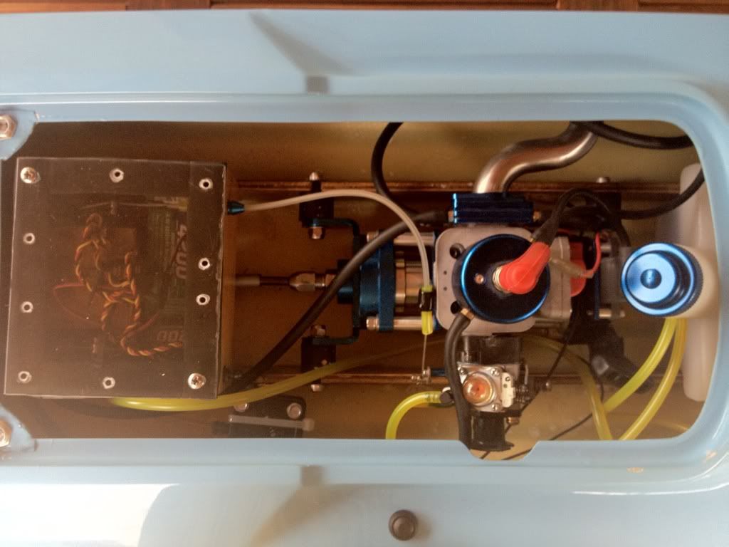

Well after 7 years of waiting I finally finish her, It was a long wait because I focused on other things, now that I have more friends with boats I was able to finish this project, the final setup is this:
MHZ Ocean Spray Hull
MHZ Z-Drive
MHZ Trim Tabs
Bonzi Sports Zenoah G260PUM
Bonzi Sports Tuned Pipe
Bonzi Sports Clutch
Bonzi Sports Prop
Bonzi Sports Fuel Tank
Custom Radio Box
Spektrum Radio
Hitec Servos
Here's pictures of the build and finished
2 videos of the day of debut
http://www.youtube.com/watch?v=msBknxX_G58
http://www.youtube.com/watch?v=JFVFM...feature=relmfu
The Boat runs great and fast (much faster than my shockwave 36) in straight line, but on turns it's a little unstable, I think she needs turn fins, I'm going to try ones.
Sergio

Thanks guys, yesterday I went to the lake again, the boat runs better the more I use it, I have still getting problems on turns, I'm waiting the turn fins to try it and see if she can turn better, the only problem I had yesterday is that it broke the flex shaft I dont know what happen yet, In the week I'm going to check it, here's a vid of the second day with better view.
