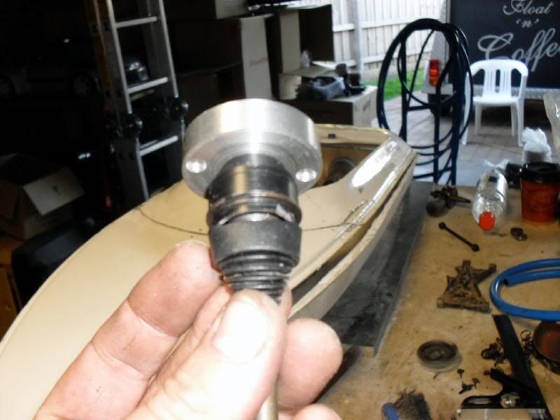

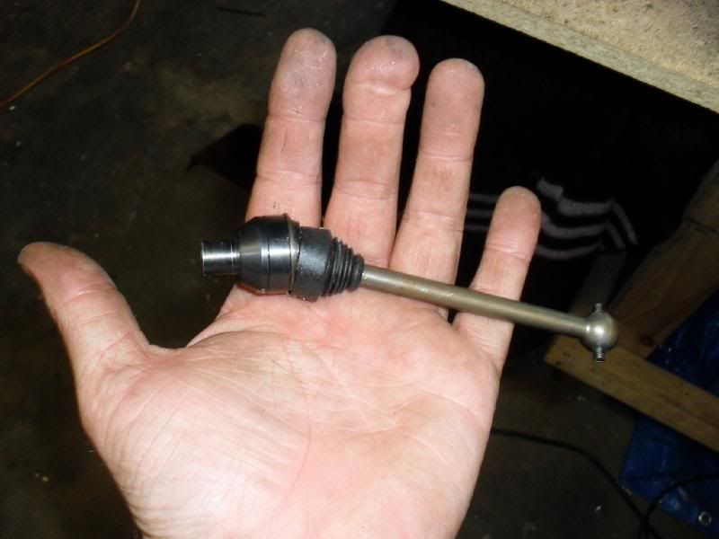

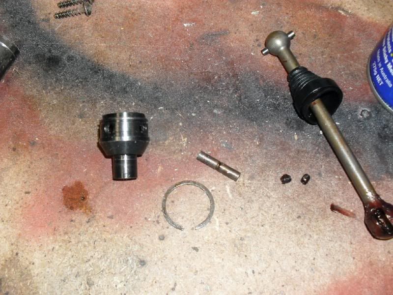

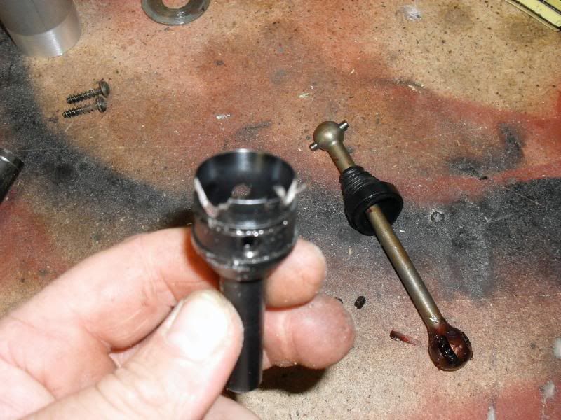

was out bashing the 5B today and i was telling a fellow baja/boater about the shaft for the jet unit
and he gave me a CVD
it was a Skunkworxs, 4x strong than anything on the market, ultra indestructable, whizz bang CVD drive shaft!!!!!
........it was destroyed it in one bash (lets hear it for manufactures testing procedures...hip hip.....) anyways so he gave it to me (ok for what im doing)
this is the damage caused in a stock cy26cc 5T
put it in the lathe and cleaned up the edge and shortened the shaft
made an adapter to fit the zen pum clutch bracket
a grub screw will hold it in
sitting in the boat

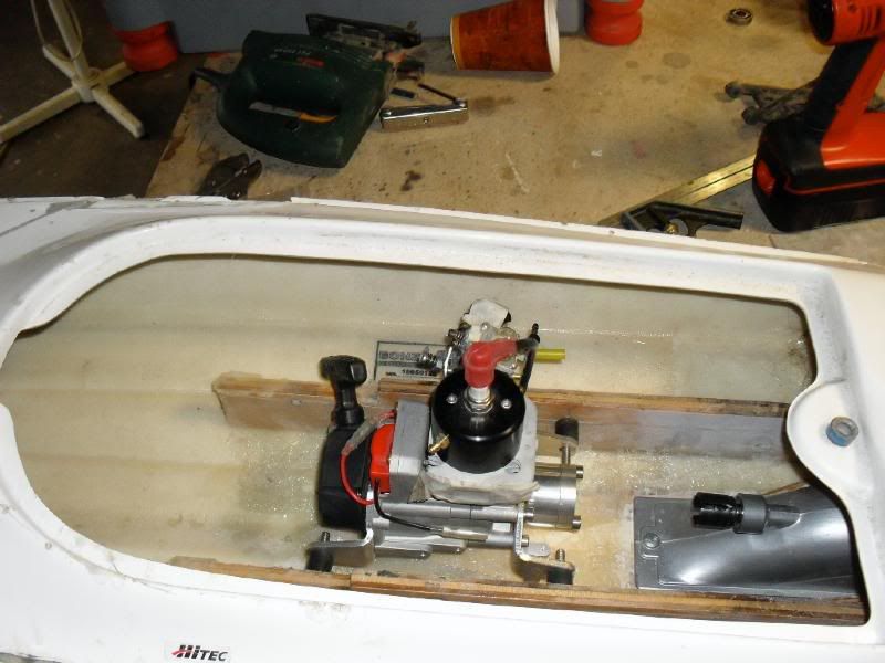

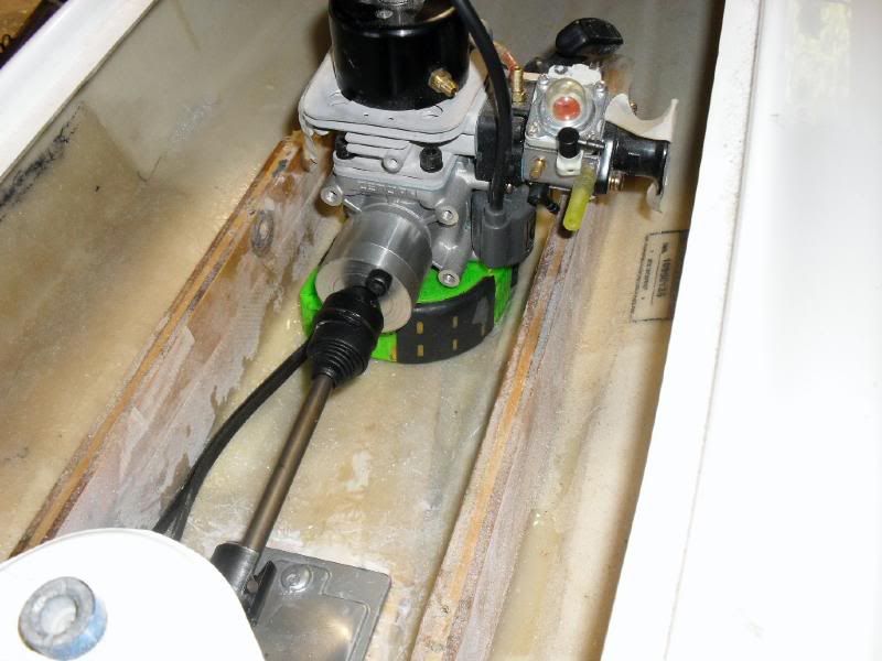

Think engine needs to be MUCH closer to pump ... you want a CG on the squirt hulls to be @ 25-27%
* here a conversion I did a few years ago.

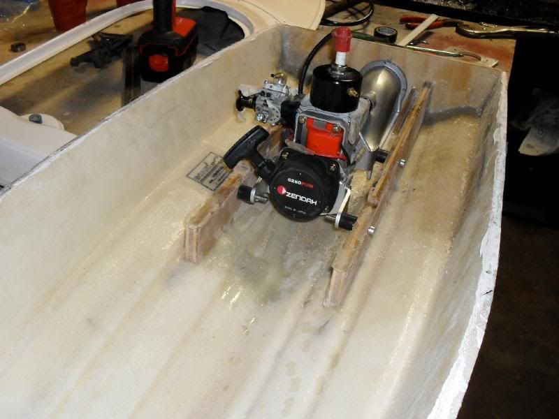

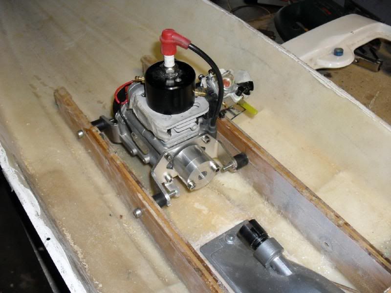

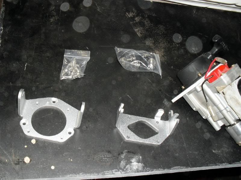

my mounts arrived today yeppy ;D
AND a cool change came through so it out to the garage first time since xmas eve!!!!
MOUNT KIT
FRONT ENGINE MOUNT ON
REAR ENGINE MOUNT ON
DISCOVERING THE FRONT MOUNT WAS UPSIDE DOWN, RE-ATTACHED RIGHT SIDE UP
AFTER ALOT OF PISSING AROUND MEASURING, DRILLING, FINDING LONGER BOLTS, ETC SHES IN!!!

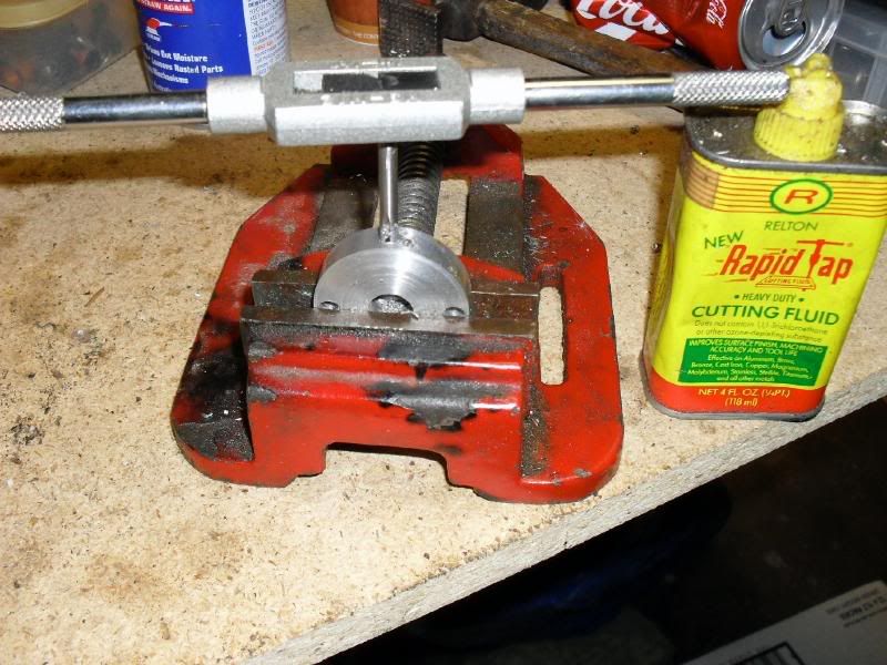

TAPPING THE HOLE FOR THE DRIVE CUP GRUB SCREW RETAINER
RE-INSTALLING THE DRIVE CUP CARRIER
ENGINE POSITION take 1

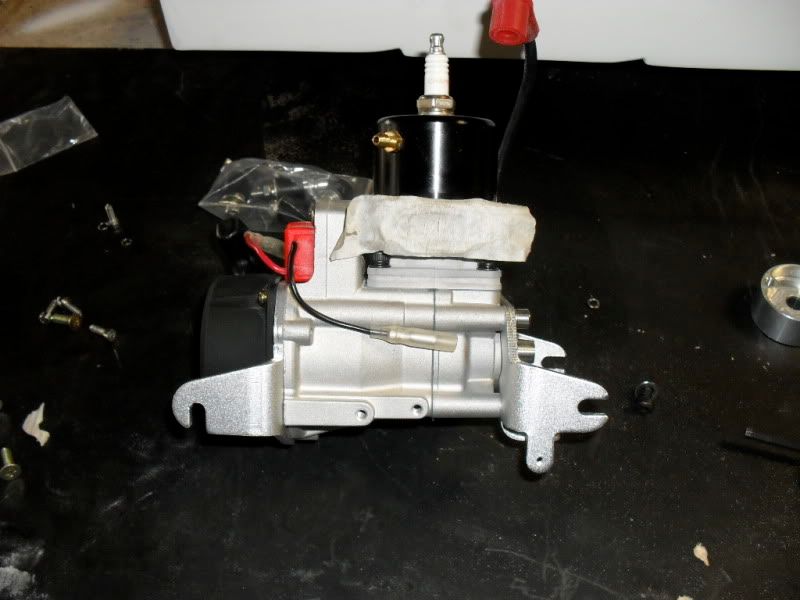

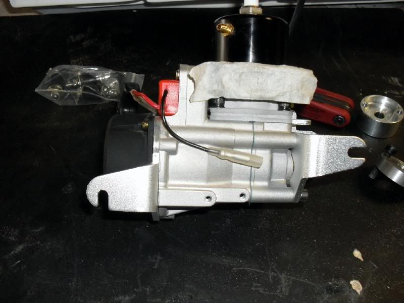

i have some question for yas
QUESTION 1
what are these two tabs for
QUESTION 2
i need some suggestions on pipe placement... i know alot of race boats have there pipes crossing over to even up weight and have half the pipe sticking out the top/back
i want the pipe hiding inside the hull possible only sticking out the transom alittle... to do this requires the pipe to run down the side of the hull (on the inside) what is commonly used to counter weight this??

The tabs are for a belcrank type throttle setup,you can also use a cable setup if you prefer.By the way i think those mounts are anodized silver so be sure you use a grounding strap for the motor or remove some anodizing where needed.
Mart
QUESTION 1
throttle linkage you have the mount on upside down

ORIGINAL: Nosedragger
QUESTION 1
Yea well spotted it is upside down in the hull but in a cpl of the other pics its on the right way up lol.

da mad maori
Join Date: Jul 2006
Location: , AUSTRALIA
Posts: 771
Default RE: My Jet Boat Build...
yeah it is upsidedown lol the engine doesnt want to be on an angle like prop boats so i had to "improvise"
cool so those tabs arent that important cheers guys

mill them off and use a cabe
