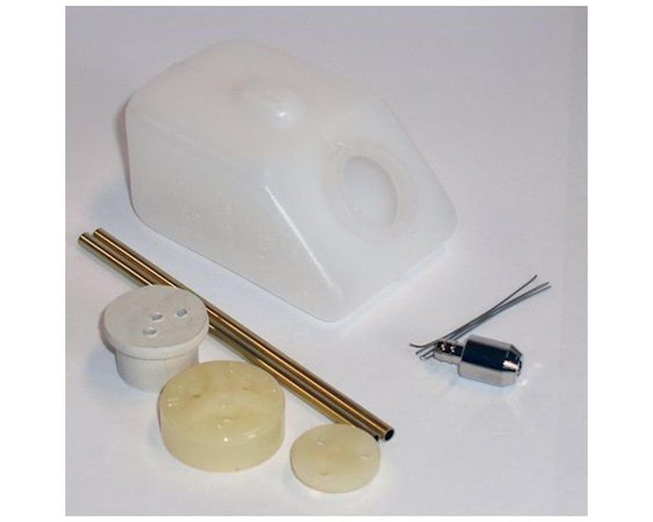

Okay, here's my thought on what you're dealing with:
1) Change your battery pack to a flat pack. You can place one of those vertically against the side of the radio box, using less room and having less weight
2) Swap out one of the servos for a mini or micro as they are much smaller than the standard ones you have in the boat now. Use the smaller servo to handle the throttle as the throttle won't need nearly the force of the rudder
3) As I said before, put the fuel tank in the nose instead of in the radio box. I'd also use a square or slant tank rather than what you have in the picture as they are less likely to leak than the one shown
4) Be sure to install pushrod boots where the pushrods come through the sides of the radio box. To not do so is asking to get water in the radio box and possibly end up with a radio failure
Not to be harsh or anything but you made the same mistake as many new boaters, including me. Before you install the deck on any boat, you need to figure out where everything will be inside said boat. That way, if you need to make minor changes to anything, you can. There are also many times where things need to be installed prior to completely installing the framing. I have that very situation with a pair of boats I'm presently building. Due to the arrangement of the boats, I have to install my fuel tanks under the deck on the left side of the boats, behind the motor. To make this work, I have to install the tanks through the frames in the lightening holes. The only way to do this is to install them while I'm assembling the framing because to do so after the framing is done will require major cutting of the frames, weakening the hull. Here's a link to a picture of what I'm dealing with:

Thank you for that information. It's exactly what I was looking for.
I'll order a battery pack and servo. Monday I ordered a different tank- https://www.amainhobbies.com/dubro-2...-dub402/p29329 I'm not sure if that 2oz tank will be too small for a .15? I have absolutely no idea how much fuel these motors burn. Do I need to reseal the bulk head or can I stuff some foam up front? Maybe some expanding foam to hold the tank in place? I've already purchased some boots for the pushrods!

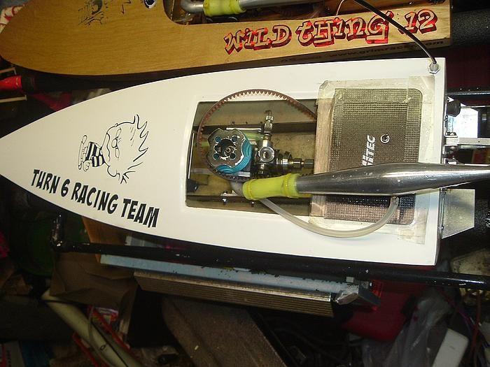

Old 09-03-2020, 03:28 PM
Hydro Junkie
Join Date: Nov 2004
Location: Marysville, WA
Posts: 9,361
Received 56 Likes on 54 Posts
My first boat was a Dumas 30" Pay'N Pak so I know how bad the directions are. My boat was like a brick on the water, heavy as hell and underpowered using an HB 20, the appropriate sized engine for the boat. Now, 38 years and a lot more experience later, I built another one, but with a lot of changes. The new boat was built using birch ply instead of the mahogany, is lighter, wider and probably faster. I, like you, installed a modern engine that will kick out twice the RPM of the HB and is made for boats. Here's a link to a picture of the boat with just cockpit work and painting left to do, taken back in 2011:

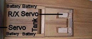

Old 10-20-2020, 08:05 PM
kevinsburns
kevinsburns's Avatar
Join Date: Oct 2019
Location: Kenton, Ohio-USA
Posts: 54
A 75cc fuel tank is around a 2 1/2 oz tank, Sullivan makes a 2 oz tank that is much smaller than a rc truck tank.
I wonder why no one told you that?
The batteries, if you know how to solder you can remake the pack using 4 AA rechargeable batteries and lay them along the inner sides (Two on each side). Preferred would be as close to the keel as possible and make a floor over them.
(You want to avoid a top heavy boat so try to keep the batteries as low as possible. I wonder why no one told you that?)
Servos:
One up front on the side of the carb arm, and the other in the rear on the side of the rudder arm.
RX rear opposite the servo.
I wouldn't use a mini servo but if you do try to avoid the el-chepo minis and go with a Hitec mini.
I wonder why no one told you that.
Tank:
Place opposite the throttle servo up front. This keeps the weight centralised in the hull, you want it on the right side. if you notice my image all the weight is on the right of the radio box area. This keeps the center of gravity low when turning to the right.
Also nothing wrong with Dumas hardware at all. Just stay away from the rudder tiller arm as they are cast and do crack easy.
Just my 2 cent worth.
