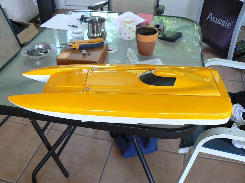

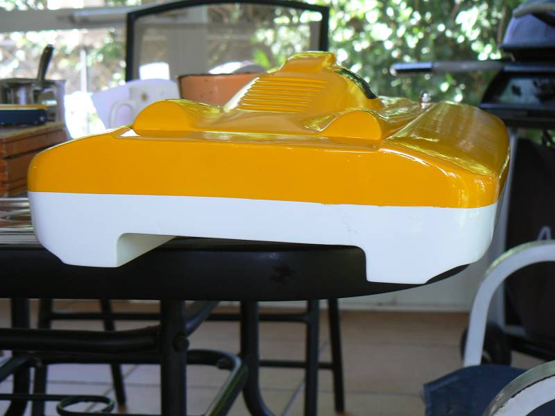

Thought I got far enough to start the post. Here we have a 30" SW cat hull that I ordered my plans an intentions for this build are as follows:
1. OPS .45 cnc'd shaved balanced an ported from Twisted Liquid
2. Aeromarine running gear polished
3. Make hull rigid an supported to handle a large block motor with minimum vibration transferred to ride
4. True hull, smooth imperfections, sharpen edges
5. Reliable speed shooting for 50's
Heres the photos as I recieved the hull.

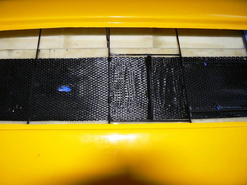

Next I'll show you the results of my strengthing procedure Im doing. It'll be a magic trick 6 feet of carbon railing for the support structure. maxium strength min. weight

Now in these pictures I used 7mm by .5mm carbon strips an some carbon rod 2.5mm to add support for motor, fuel tank, radin box an general tightening up of design on the inside. Weighed rods after they were cut an I prefer to mix my epoxy by weight also so total additional weight to hull is 25 grams!!! Way more rigid an much less flex overall an will give added strength when I put the main railings for all the mounts. You can also see I added floatation to the front an will add more to sides when I get it all mocked up.

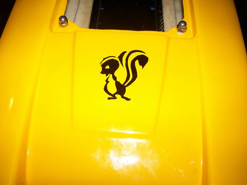

) so I also did some research an since this is a "Skunk Workz" Hull I found the old Lockhead Martin skunk works logo made a stencil an sprayed it oon the front I think it turned out sweet

I wa figuring arounf 33% but was planning on doing a adjustable mounting point where there were multiple points I can bolt the engine mounts to to adjust from 35 to 30% cog. what do you think?
Also getting in the carbon fiber strips .25" by 2.5" for the railing similair to how ron olson set up a .12 mono (I think it was that one) just waiting on ups to get their butt in gear an more pictures to be posted!!!

Ive had problems with using certian types of aluminium when making supports for my race motorcycles, they were all casted then machined so there maleability was high. Now maybe the stuff you could get would be stronger but then I see problems with using them in the applications I used CF,
1. weight the railing an rod I used was billed as half the weight of alum. An its always been my approach to make things lighter is to make them faster!
2. Bonding the CF seem to bond more permantely to the fiberglass in the hull. With alumn. (in the past w/bikes) when enough force was used the bonding agent (resin/epoxy) would pull apart instead of transferring the stress onto the whole contact patch
3. Price (at least to me) it cost $8 US ( about 4 for you proper english gentelmen
) for 8' of rod/rail
I am by no means an expert as I constantly refer to the shared knowledge on this site but these have been my findings in years of fabrication in other industries. In regards to polishing I plan on polishing the strut, rudder, an any other hardware that will be exposed to the water then I will lightly sand the pieces to give just enough surface to allow the water to blend around than to slide over a perfectly polishe surface. I just ordered the hardware an should recieve next week so I'll have plenty more pictures. It helps that Im a professional photographer in the evenings to be able to post so many shots an trust me, Sam, I'll have PLENTY more.

also decided on my main rail material you can order it from mcmaster.com they do a variety of things I use in the jewelry world an even Tom moore uses a similair material for the spar on his fire fighter boats. I am going to use the Flame-Retardant Multipurpose Garolite (G-10/FR4 Epoxy Grade) in 1/4" thickness 2" for the rails an inside support for the transom.
Kinda thick but its what I had laying around from another project.
I know 1/4" might be alittle extreme in thickness but the weight compared to epoxy/glass covered 1/8 plywood I think will either be similair or slightly lighter plus this stuff is hard as nails great tensil an vibration absorbstion (spelling?) rates are great thus giving me a super strong support for the motor with minimal vibration transferred to the hull. I plan on adding it this weekend so I'll have pictures soon.
