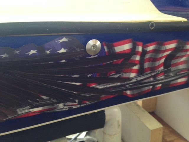

Ok guys I know I have been going for a bit. But here is where I'm at.

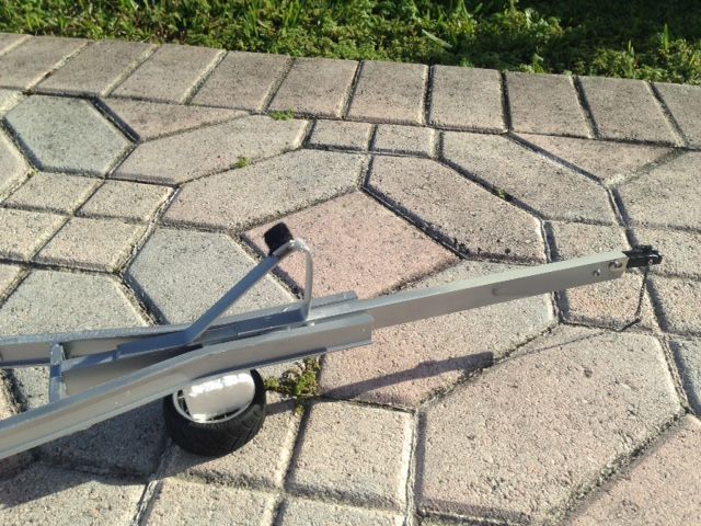

Couple trailer pics. I built the trailer by hand myself. I even made the fenders. LOL. By now I'm sure you all know about the CEN Racing F450. Took me months to get one. It tows great. I'll see if I can upload a video.
