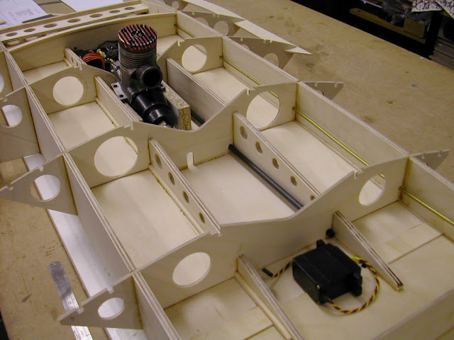

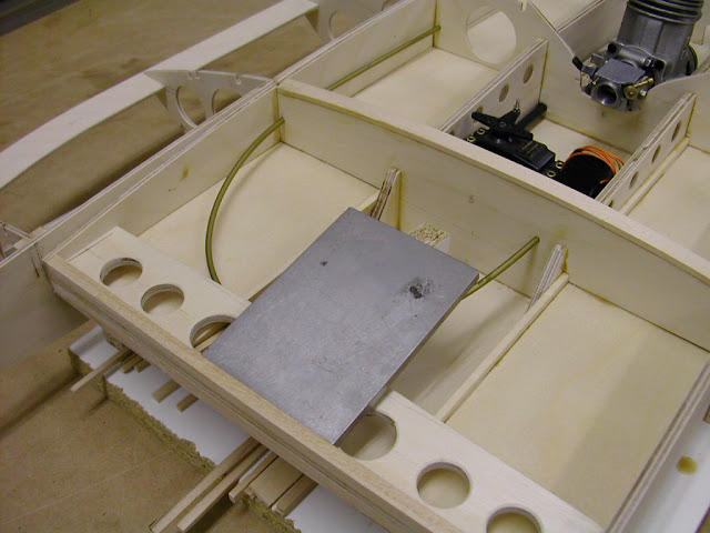

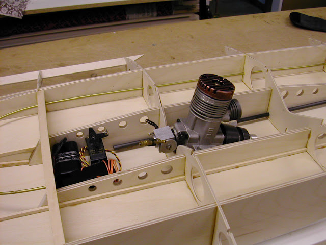

Here are some pics which show my intended layout The radio and rudder servo will both be boxed in and watertight (well hopefully!) the steel plate is placed to show the area I shall put ballast in the form of sheet lead to trim the CG. Ideally this weight should go as you say as far forward in the sponsons to reduce the amount of ballast for a given effect. I have considered 'weight boxes' in the sponsons but think that this will lead to leakage problems - what do you do and use for trimming aids like this?

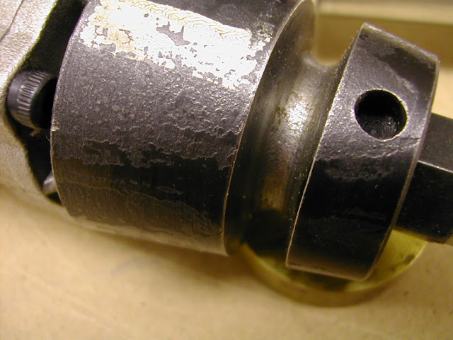

Jeff it was interesting to hear that you have an aluminum flywheel fitted. I had wondered about this as one of the engines I sold was a KB 40 with such a flywheel. I will make one up to replace the one fitted which I have to say and as you can see I'm less than happy with.

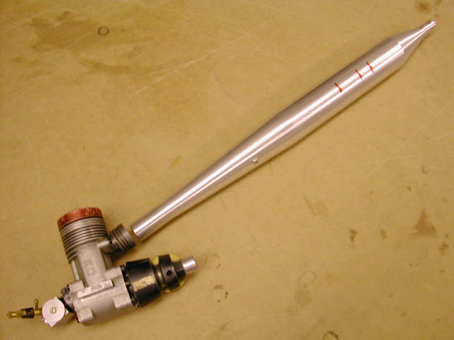

Thanks for the info on the pipe which I may look into - buuuutt - yesterday a friend who I have not seen for some time called and brought me a brand new 60 pipe which he thought 'I might find useful'. Before I knew him he apparently flew semi serious R/C aerobatics and had this spare! It has a long chamber so it may not be suitable, it's baffled -where the three marks are and fits the exhaust perfectly. Do you know anything about these pipes? I have owned many many engines over the years but only one with a pipe, that early OPS so am totally in the dark here.

Old 01-29-2009, 04:53 AM

These three show the projected layout
This is the state of the flywheel
And these two the pipe details

I see one thing I would do before you start skinning the boat. Along both sides, where you have the two sides laminated together, drill some lightening holes through them to lighten them up. As it is now, they are considerably heavier than needed. Another reson is that it will let air circulate trough the boat so it won't rot from the inside due to trapped water. Trust me, water will get in. Just out of curiosity, is that 3mm ply in the framing? Let me help you out a little. Here are some pictures of boats i'm working on to show you what I'm talking about
