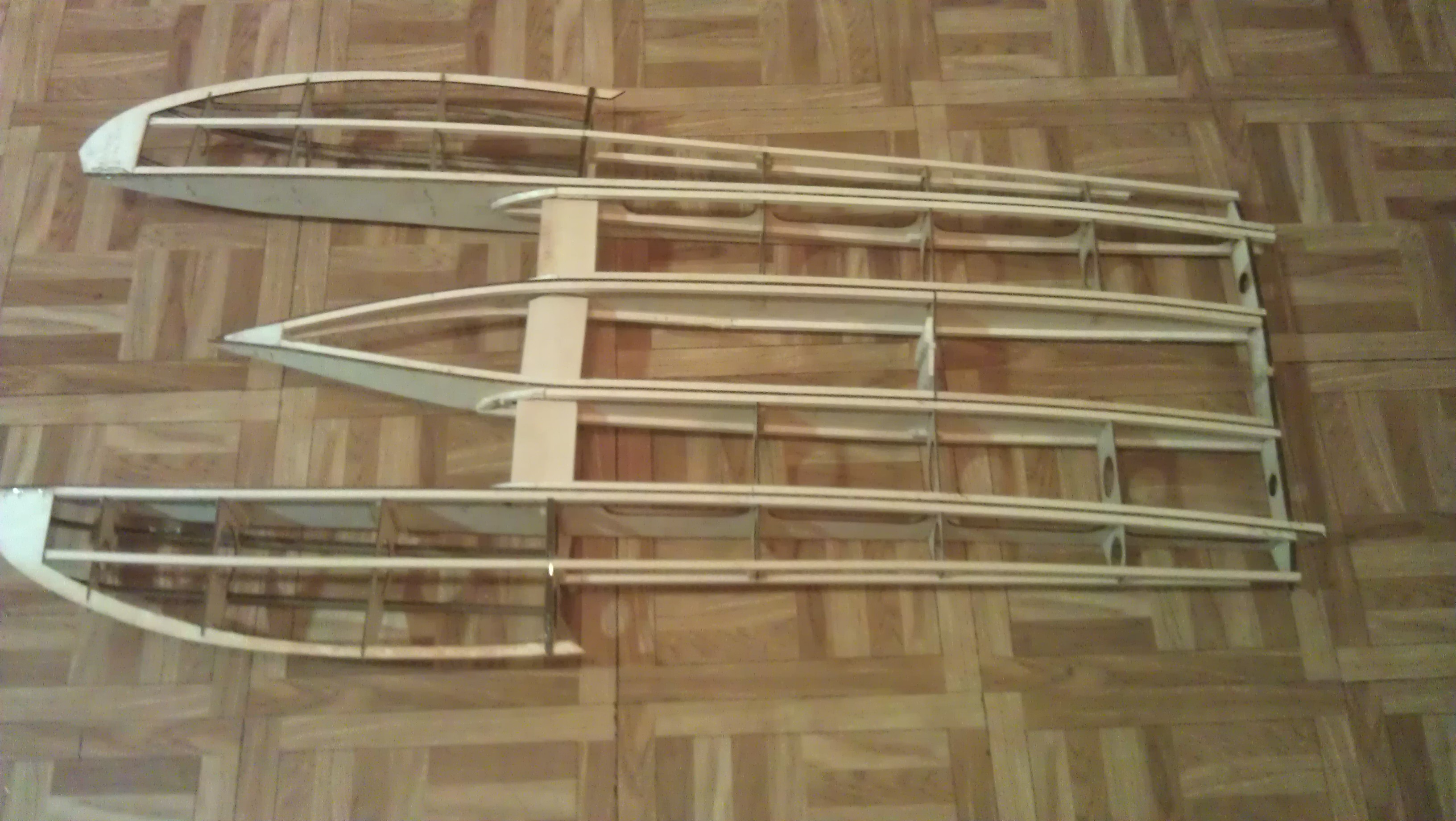

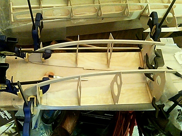

Rather than deal with nine pages of mixed info and stuff, since I'm getting back into building, I figured it's time to start a new thread. I've decided that, to prevent confusion, I would concentrate on one boat rather than two or three. My subject for this thread will be the 1973 Pay'N Pak. I know building jigs, tools and several other subjects were discussed in the other thread so I won't get back into those subjects unless someone has a question. That being said, time to get back to the build.
So far, I've laid out all the internal framing onto a combination of 1/16, 1/8 and 1/4 inch thick aircraft grade plywood and have cut out most of the parts. I've tack-glued 1/4" stringers to the sponson insides where the hull bottom will be attached and along the bottom edge of the sponson as can be seen in the first picture The Pak is shown on the left side of the picture, the 1972 Notre Dame is in the center while the 2009 Oberto is shown on the right. . All tack-glued parts are attached with 15 second gap filling CA/super glue to speed up the process of attaching them.

After doing some final finish work on the framing, I epoxied the right sponson transom to the right sponson inside and the sponson insides to the transom. For the boat to perform properly, THESE JOINTS MUST BE SQUARE. I next dryfitted the engine bay walls and cross frames into the sponson insides to verify the fit. This is a must as Newton plans were all hand drawn and do contain errors. It's better to find and fix errors now, before the glue is applied, than after and have to dig out the ill-fitting parts

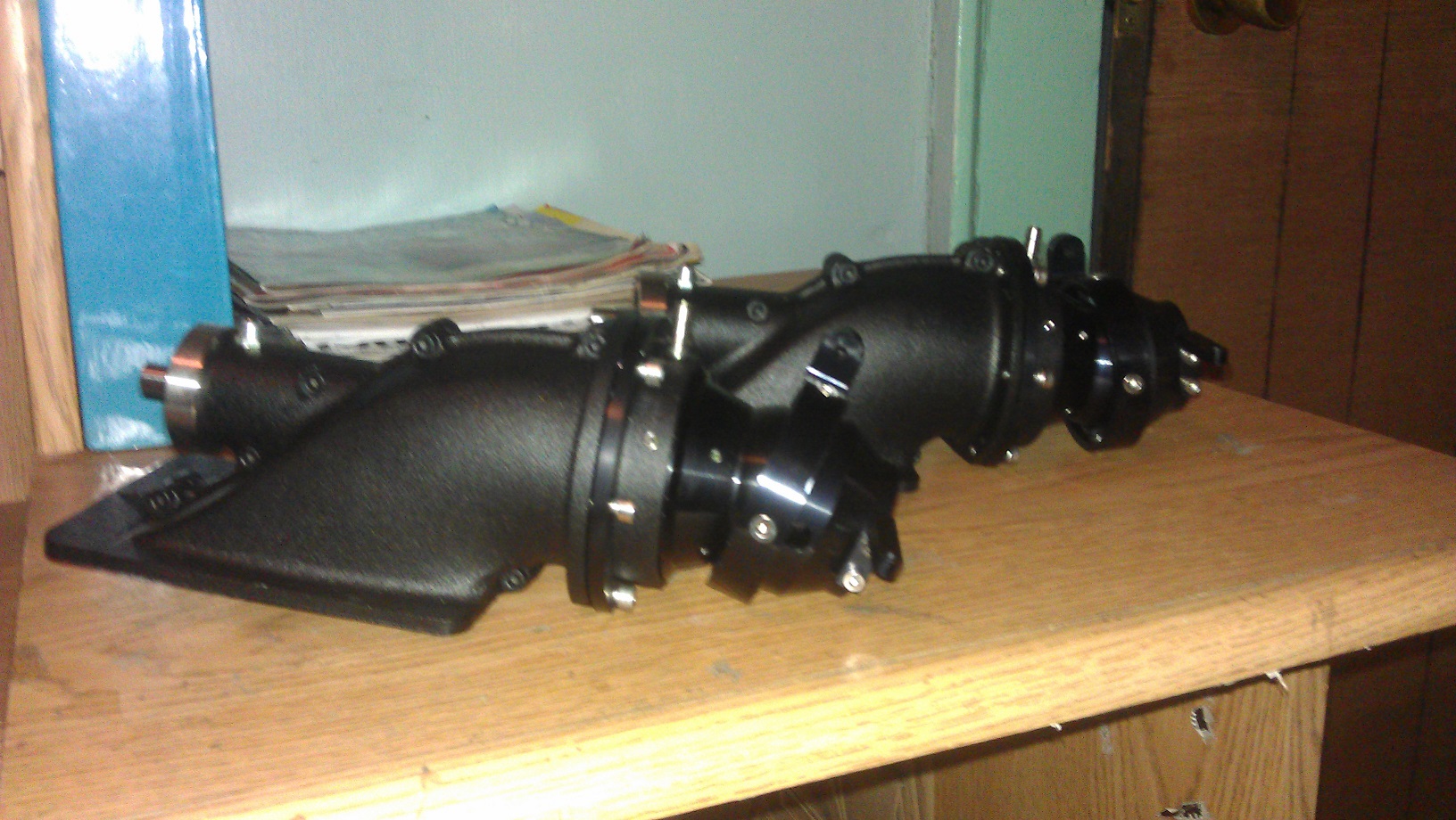

just got 2 mhz jet 52 drives going to thy and get it together this weekend, have to modify back half to accommodate the 2 waterjets http://www.rcuniverse.com/forum/atta...mentid=1916671http://www.rcuniverse.com/forum/atta...mentid=1916672http://www.rcuniverse.com/forum/atta...mentid=1916673
Hydro Junkie 09-06-2013 07:05 AM
Trust me, that's going to be a futile exercise. For the jet drive to work, the back end of the boat MUST STAY IN THE WATER. For a hydroplane to work properly, the back end of the boat MUST FLY ABOVE THE WATER!!!!!!!!!!!!!! Just so you know, all of the full sized hydroplanes built since 1949, starting with the Slo-Mo-Shun III & IV, have been prop riders. This means the rear of the boat is supported by a combination of air going under the hull and the prop.

thats why im building 2 i like being different just want to see how it will run it will be my water toy, depends on how it runs i might take them out and pun both in a deep v and keep the other hydro to scale

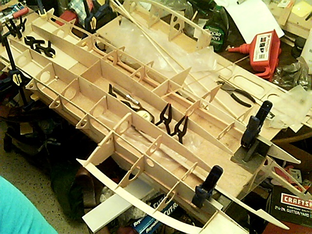

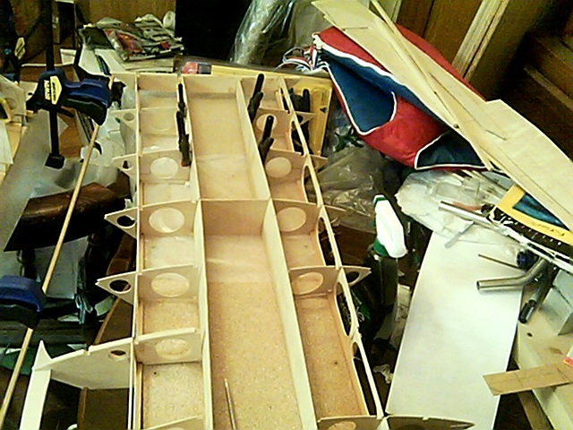

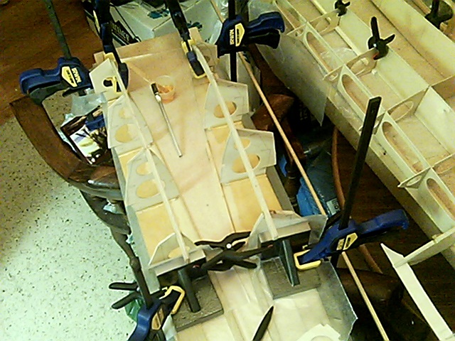

Okay, I finally got to post some pictures.
The first one shows the Pak when I was gluing the rear framing together.
The second shows the framing glued in up to the middle crossframe. The right sponson is also all glued to the sponson inside. The glued on rear bottom is also visible under the clamps.
The third and fourth show the sponson cross frames installed onto the sponson insides to my replacement 2000 Elam hull. I now need to get the lengthwise frames fitted and installed so that I can start adding skin.
I didn't take any shots of the Executone this time since I haven't done anything to it in several months

Went camping last weekend and thought "I'll take the boat with me so I can work on it a bit". Needless to say, it took some major damage on the trip so I've spent two of the last three days repairing the damage. Yesterday was spent at the Hydroplane & Raceboat Museum on a research run. Since I'm building the 1973 Pay'N Pak and the full sized boat is being restored there, it was kind of a no-brainer. I found out a few things yesterday:
1) The plans I am building from have some serious issues when it comes to the top layout and the location of the center cross frame. Everything is roughly a foot to 18 inches too far aft. Needless to say, this can and will affect the boat's balance. Correction of this may result in a boat that won't need as much balancing weight to run properly. Time will tell:rolleyes:
2) I hadn't gone so far with the build that correction of these errors wasn't an option.
