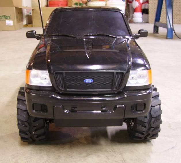

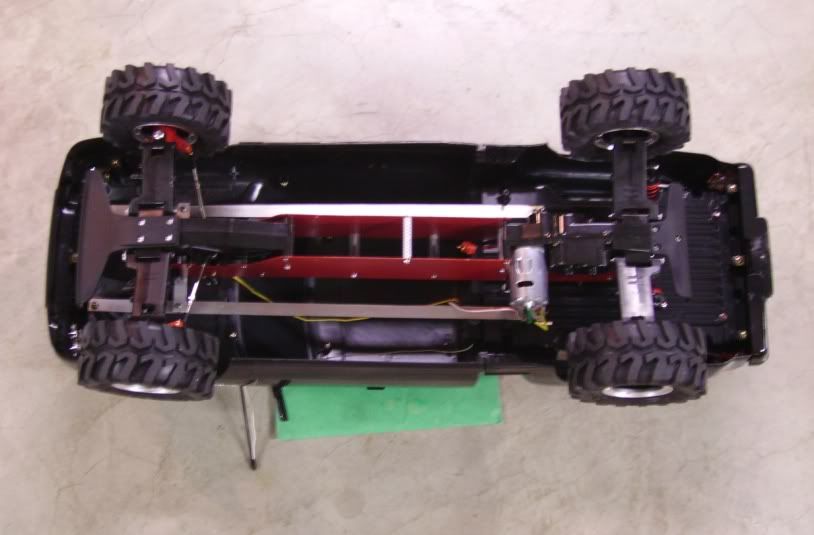

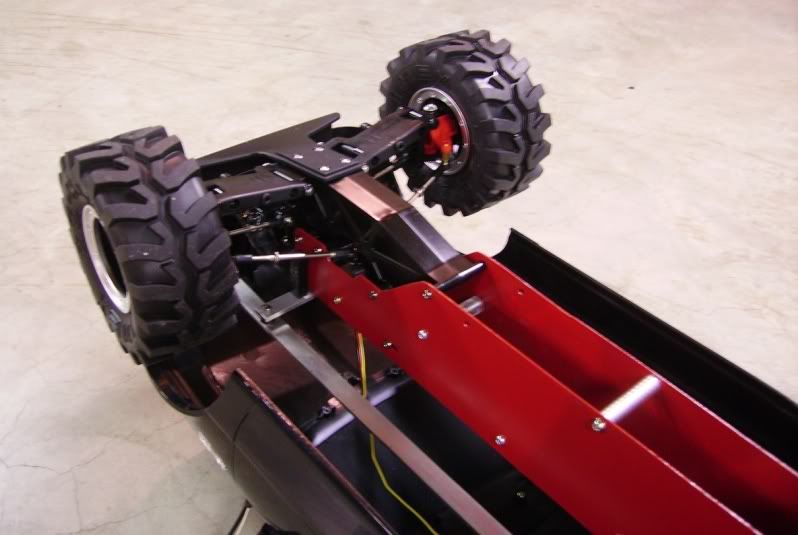

I'm nearing completion of my 1/6 scale Ford Ranger. It uses a BF Xtreme chassis extended to fit the body, which I took from an Artin RC I bought off ebay.

It started life as a toy RC tuner.

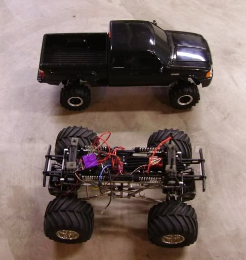

Size comparison

one question what did you use to make a chassis? i want to do a custom chassis on my bf xtreme

Thanks. I used some thin steel sheet metal that I had laying around my basement with aluminum crossmembers. If I were to do it again, though, I'd use about 2mm aluminum. It would have been faster and easier to cut, and be lighter and more rigid(since it's a bit thicker.). I used a mounted band saw to cut it out.
To fit the body, I stretched the chassis to a 17" wheelbase. The longer wheelbase really affects performance, it's much more stable steering at high speeds. It can't even do donuts very well anymore.
