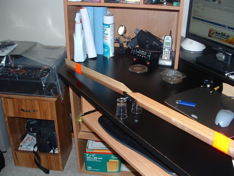

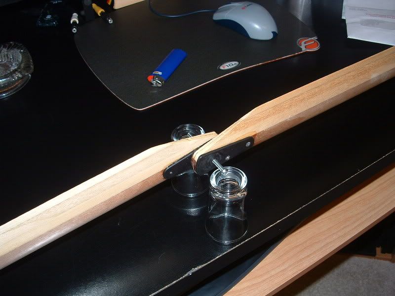

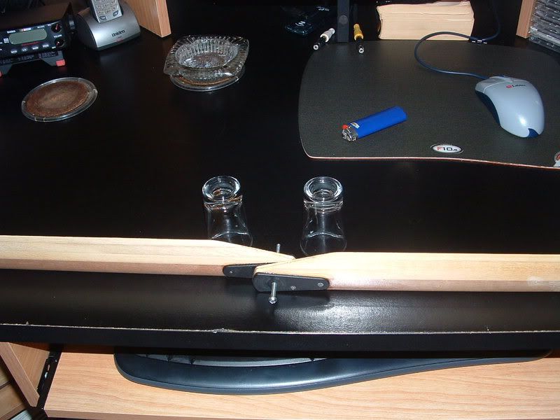

No, they are balancing on the two glasses (you bolt the two blades together tight) Make sure they are strait then you balance them on the two glasses (the blades should teater on the two glasses), then make sure you have the same distance from the tip of the blade to the table on each blade.

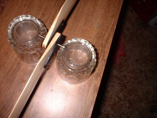

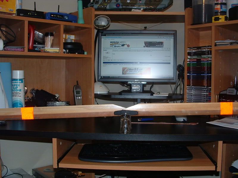

Get a bolt that is long enough to go through both the blades and sticks out about an inch on each side of the blades, you might have to put a nut on the outside of each blade if your bolt won't hold the blades tight together (your blades have to be tight together so they won't flop). Make sure the blades are strait, then balance them on the two glasses, if the tip of one blade drops down and hits the table, that is your heavy side, put your tape on the other blade until the blades sit level.

You can buy a cheap balancer that works the same way (balances on two glasses). That method does work, I did it that way for years until I bought a good balancer and I never had a problem.
