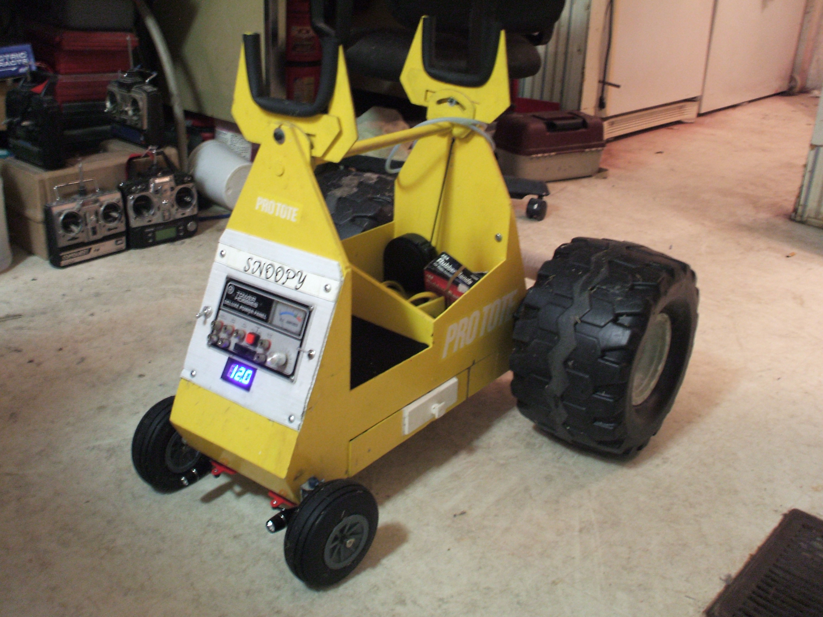

I went to a scale fly-in and arrived late. Had to park a long way from the start up box so, for the next time I made this. Used a set of motors off of an old Power wheels and a brushed Esc. Made up my own steering system and put a retractable dog-leash from the dollar tree on the back to tow my planes. It has two 5000 Mah 3s lipos for power that run the power panel and the wheels and radio. Gets more comments and looks than my planes and it works great. Has no problem towing a 12 ft Tele-master!

Are they headlights?

Well, now I know what to do with my daughters Barbie bike that she hasnt used in years.

Yea they are headlights. Made them out of a couple of those clip on hat lights, also from the dollar store. They are mounted to the steering servos so they turn with the wheels. Took the batteries out and ran them off the receiver. Guys at my club say I have way to much time on my hands! I can carry this one but I need to get some smaller rear wheels. They hit the back of my leg. Hey Bogbeagle, you ever been to Alconbury or Lakenheath? I spent 4 years in both! Sure do miss the U.K.

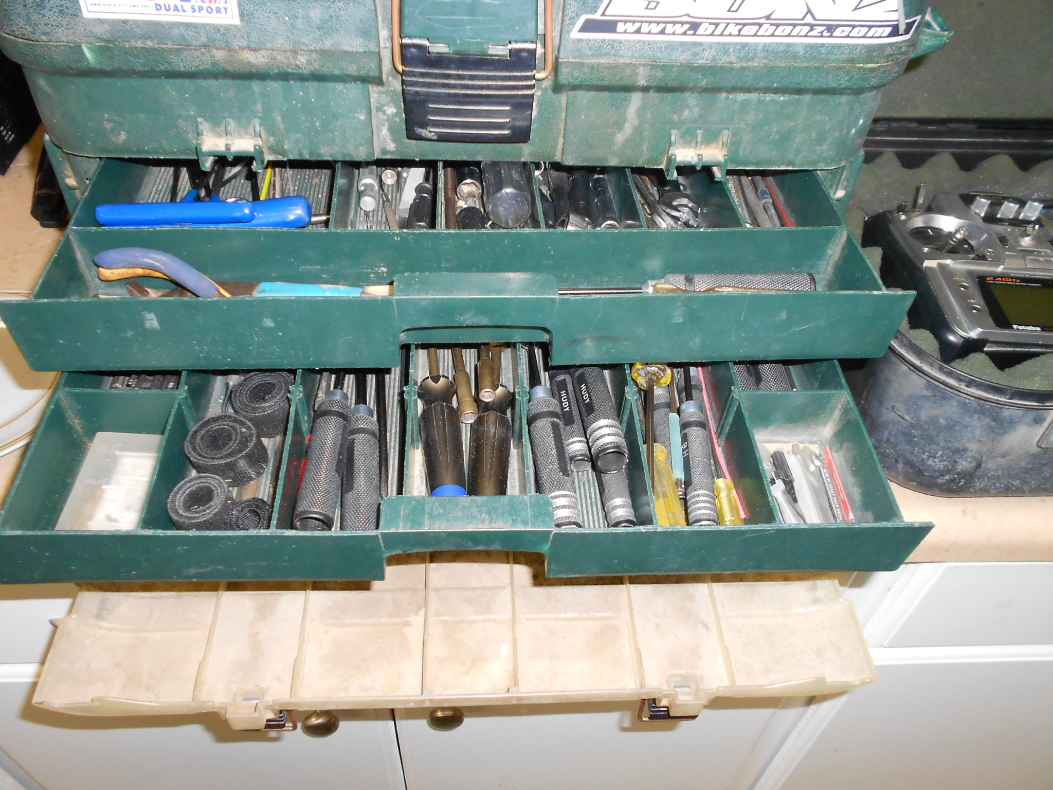

Since I started flying EP and Gas in addition to glow,, the one box fits all stopped making sense, too big too heavy,
I have a fishing tackle box that holds tool, spare parts, screws etc, and a gun case for my TX, Charger and flight packs for the day,
Then depending if I'm flying gas or glow I just grab that bottle,, It all takes up a pretty small foot print and eis easy to transport up and down to the basement with the fuel staying in the garage,,
Started using the Tackle box for tool when I was racing cars/Trucks, a good complete too set is a must.

Scale, you're just like me. I gave up the double level rolling "do anything anywhere" boat anchor for two smaller ones, 3 if you count the gas can for my gassers. One for glow and gas (a field box with a few drawers for tools), a tackle box for my electrics, and the trusty red plastic gas can. For a while I tried the roller,but found out quickly whatever you put in it, what you really need is at home on the bench. If I can't fix it, I don't fly it, so I usually take 3 planes to the field and fly what can. I have a workshop at home for a reason.
