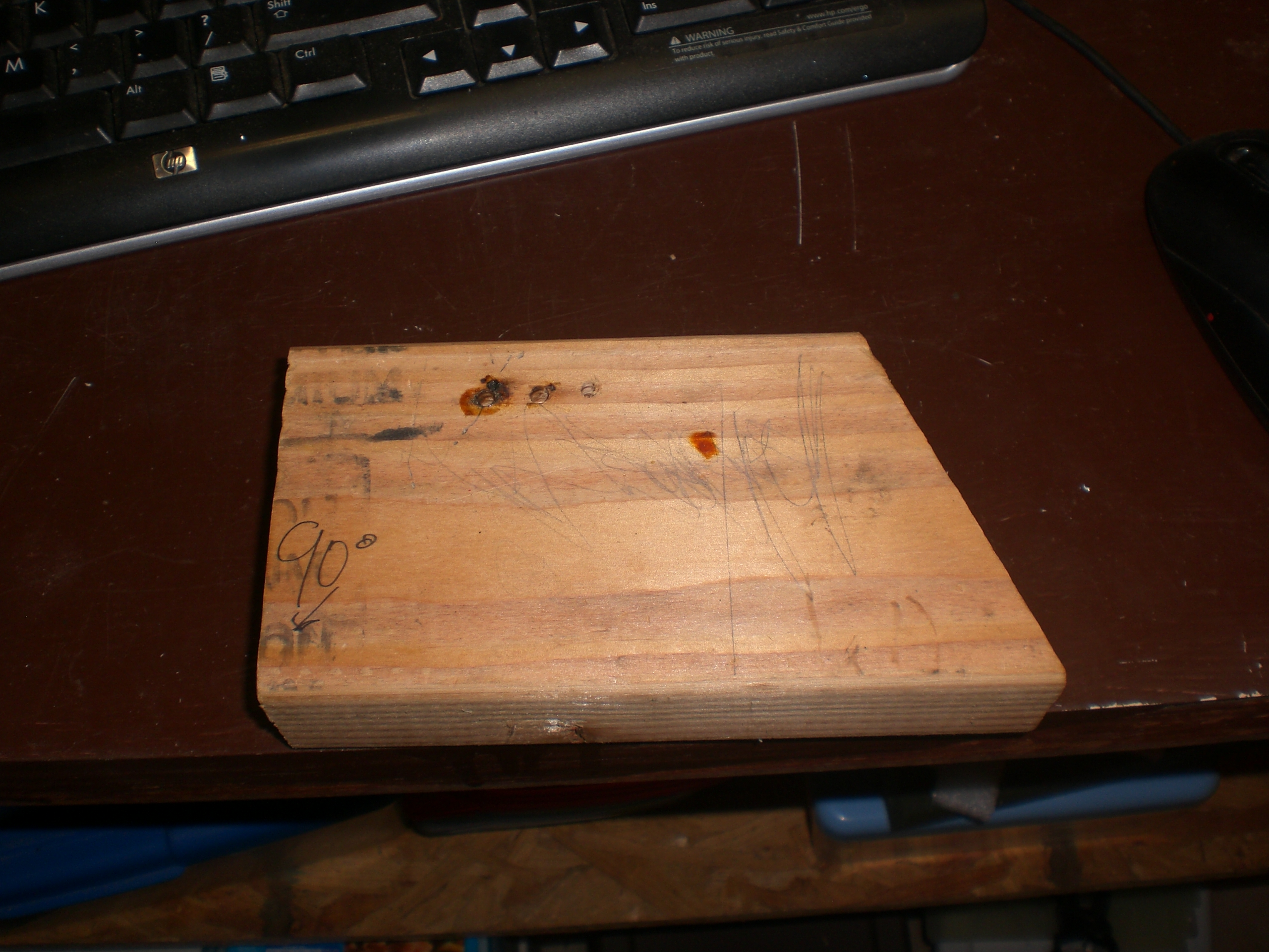

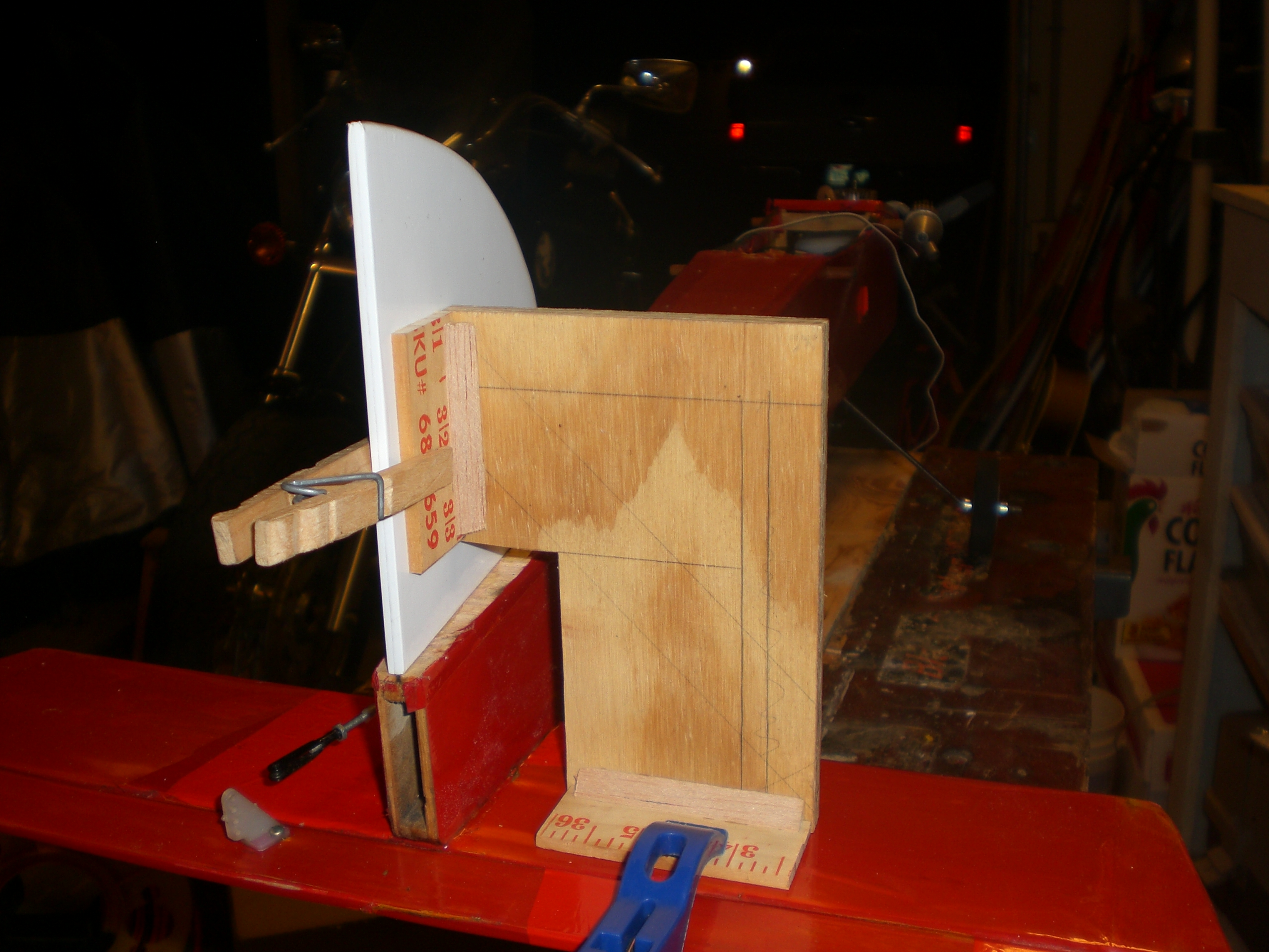

these are some that I have in the garage right now. Left is a sanding block for sanding the V on the front of control serfaces. The 90 with the quarter circle cut out is for aligning the rudder post when installing. And there is my $.50 yard stick incidence meter. I almost always build to 0,0,0. If I do want to check washout or for wing warps, I use an angle finder. But most time I just level everything with the bubble. It's really pretty accurate, and for the best accuracy you just make sure it is always facing the same direction, everything will be in line for sure that way.
The second picture is my "heavy 90" I cut it into a 2X4 (obviously), tweaked the saw until I got a good 90 (even most of the store bought 90's I have at least a little off!) But it has three different hole sizes in it that I use for soldering bullet connectors onto wires. Just put the connector into the how. and solder away.
Austin

and this one I made to align the rudder repair on my old beat up ugly stik.

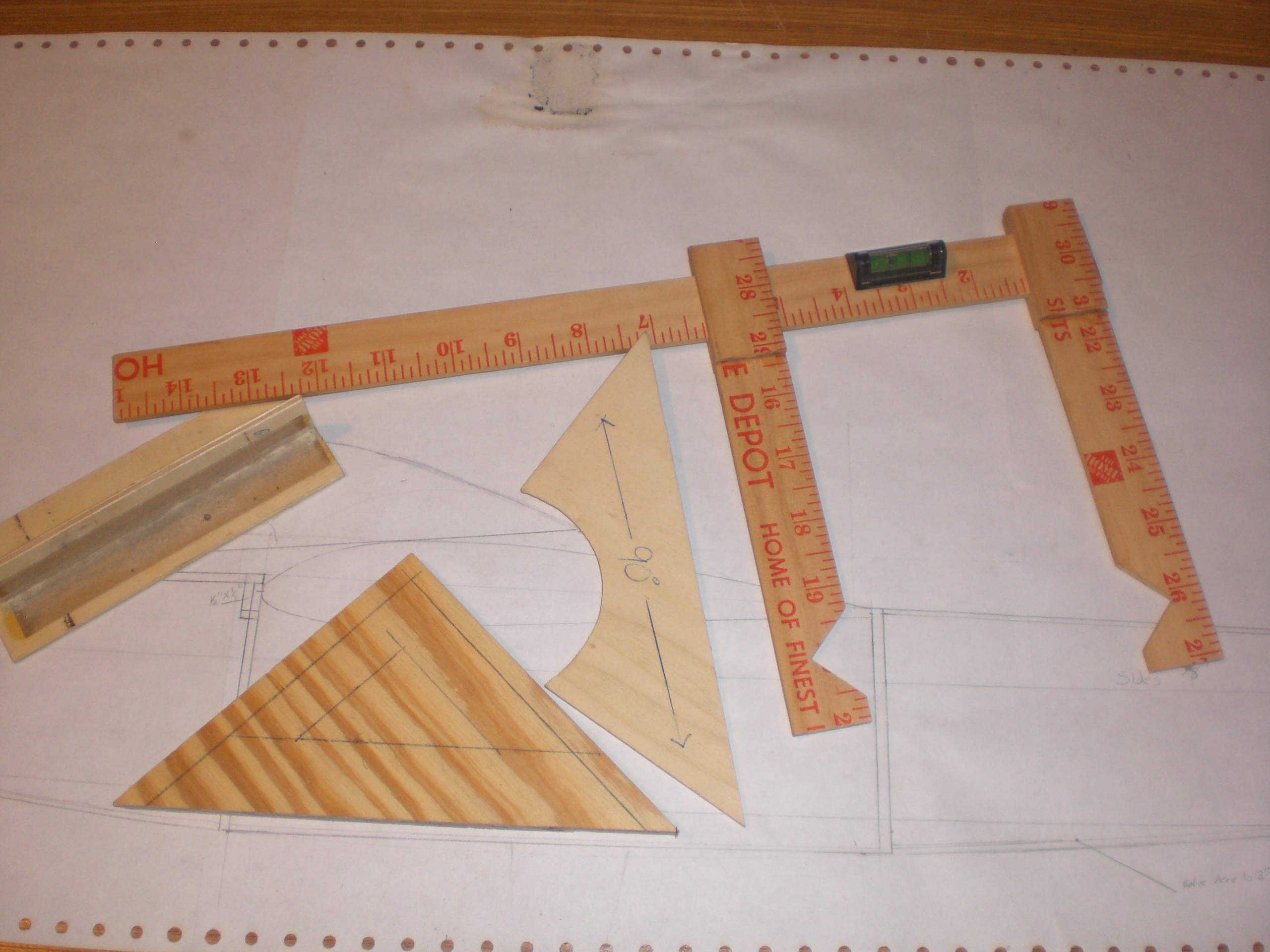

I have an incidence meter that looks very much like that. Mine's made from hard 1/4" balsa. I didn't think to mount the level like you did, I just set a string level on top of it.

yes it does, I've been wanting to make a smaller balsa one for the smaller planes. I figure if you are careful in building it, and if you always reference it the same way, it's probably as accurate as any I could buy, certainly accurate enough for a sport flyer like me.
Same with my triangles. I sand and trim until I'm satisfied that they are "good enough" I have at least 4 "speed squares", 2 framing squares, a drafting "T" square, various other objects for squaring. I can take any 2 of them and strike a line off of the edge of my building table and they won't line up exactly. The drafting triangles you get from the art store are good. Some of the carpenters squares will be square on one side of the blade, and not the other. Most levels wont read the same if you flip them end for end. But, I'm buying "bargain" stuff for the most part. I know if I looked beyond the local hardware stores and went to drafting or engineering supply houses I could pay a lot of money and get more accurate stuff, but I have to tell myself it's a model airplane, I don't work for NASA, I don't even fly competition...so it's good "enough."
Austin

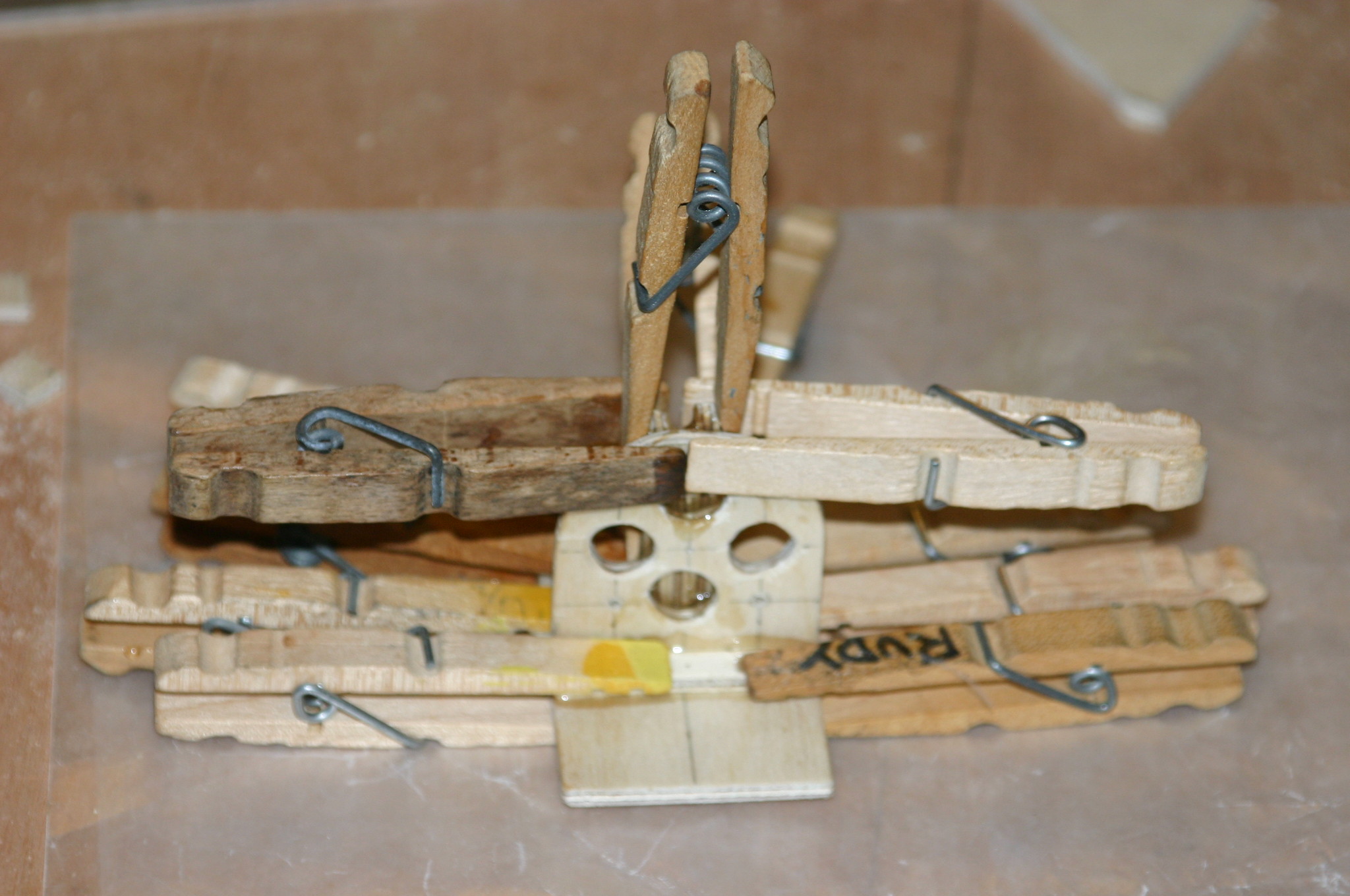

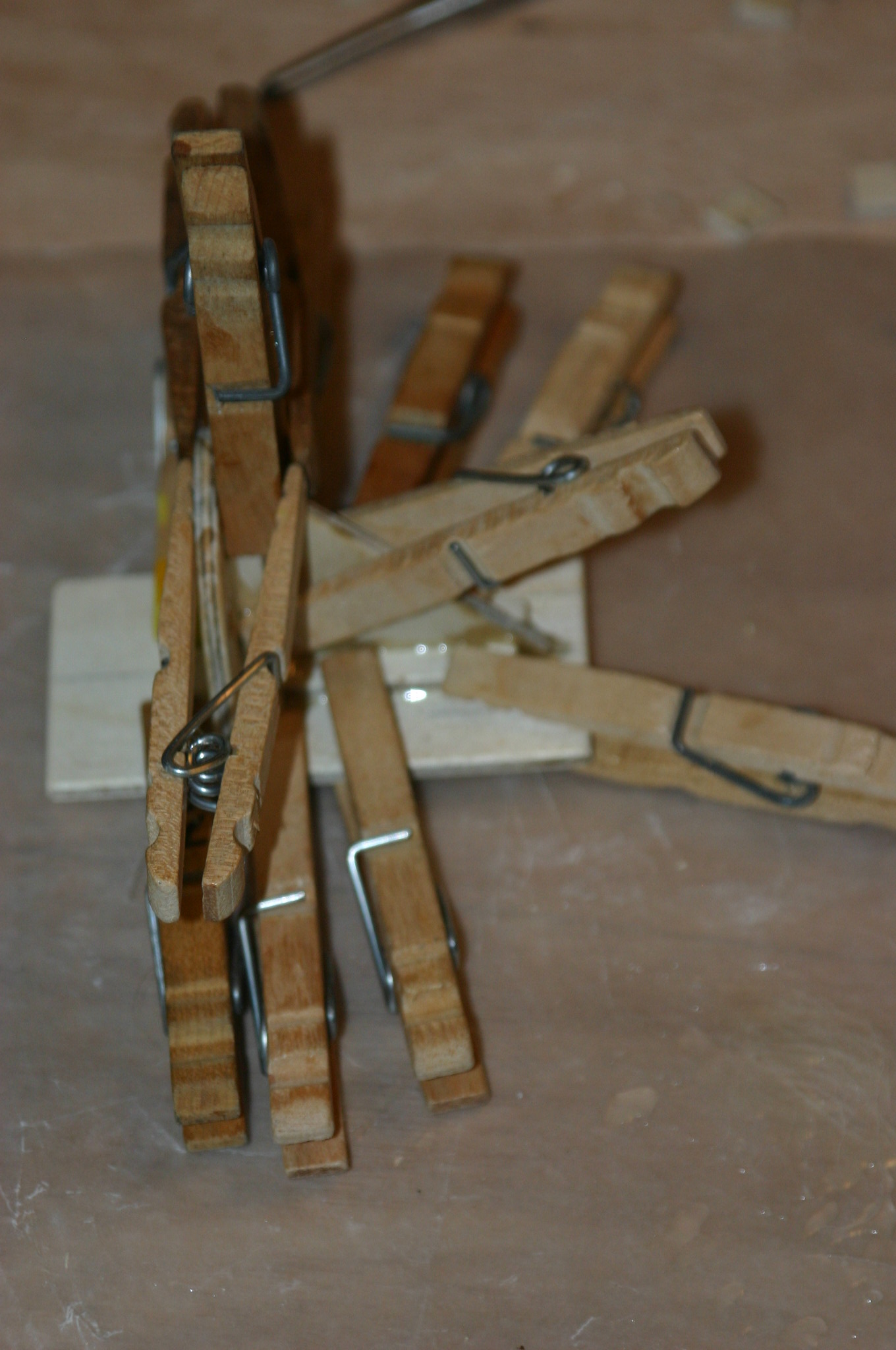

This shows spring clips normally used to hang wet laundry on a rope. The clips are taken apart and reassembled differently.
