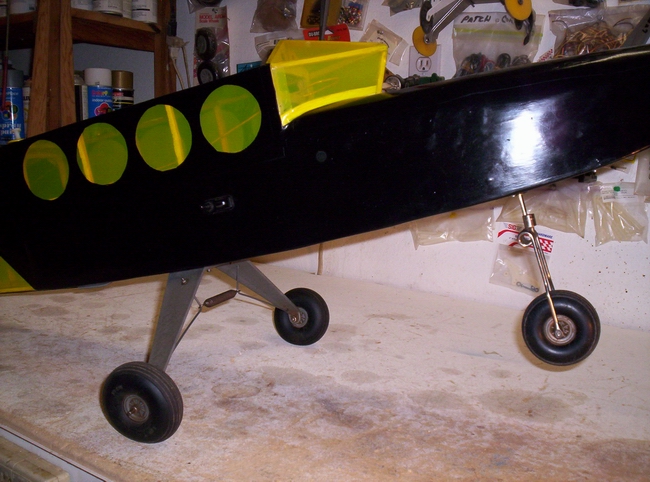

Redoing a cub.....how does one make the windows look good........i can not get the molded windows so if any one has a good idea please let me know............thanks

For side windows a technique that I have used on a number of airplanes now that seems to be far more durable and look much slicker than the moulded drop in types is simply transparent monocoat! Both clear and the color clears work for this very well. The sides window areas are simply covered with the clear panels and then an opaque section of monocoat is cut out in any window pattern and apllied over the clear monocoat. I try to get some examples up in a bit.
John
