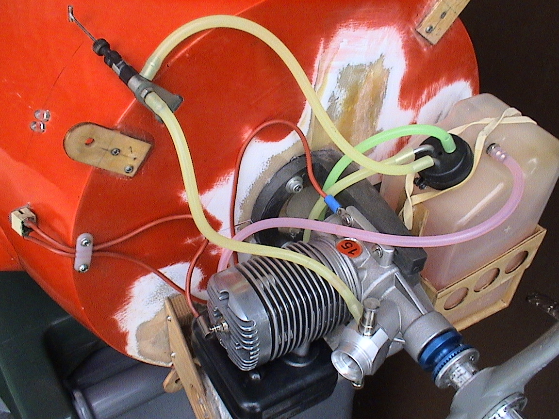

Hi!
Needle extensions are are a No No! Causes vibration that turns the needle...
Opps! Saw that I used an extension on my Top Flight GEE BEE R-2 but a short light one at that.
Name:	GEE BEE R-2 003.jpg
