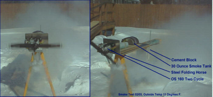

Default Two Cycle Smoke System
Here's a complete system setup diagram as we installed it in Smokey. Recently bought an OS 160 two cycle and applied this setup to a test bed for break in and smoke test. Filled the back yard with smoke after about 10 seconds of running smoke.
Bob J.

RE:
which smoke oil did u use?
what muffler for the os-160?
any kind of pre heater?
how much oil/tank do u rec. for the os-160 for 5-7 minutes of smoke?
Smoke oil: Been using regular diesel fuel from the gas station. That's diesel making smoke in 11 degrees. Tried the Super Dri once. Can't tell the difference, except for price. The way fuel prices are going though, the diesel price is catching up to the Super Dri.
Muffler for OS 160: Using Slimline #6018 Large Volume Pitts
Preheater: Made my own, 1/8 brass tubing wrapped tightly two revolutions around cylinder close to head.
How much oil: I am guessing 25 - 30 ounces for 5 to 7 minutes. Made a 30 ounce fiberglass tank to fit a Sig Sukhoi I ordered back in July. Going to run this test bed a few more times. Will probably be able to tell you to the second real soon. I would also like the answer to this question. Can you believe how well this thing smoked in 11 degrees?
Bob J.

looks like its smoke very well in the cold have u flown the system yet. are you using a resistrictor to control the amount of fuel you are burning?

Have not yet flown the system. Been developing it since November. OS 160 engine is new. Breaking it in on 10% nitro while testing smoke components at the same time.
Restrictor: What is a restrictor? Using the system exactly as layed out in the diagram above.
Bob J.
