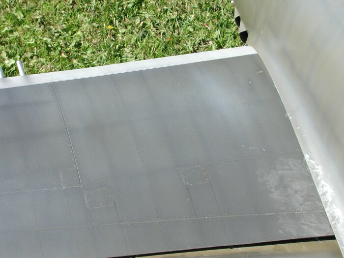

If all you want to do is flatten the shiny paint to look "old"
Mask the canopy off, then give the whole plane a "mist" coat
of gray paint that is highly thinned, and sprayed at a higher than normal pressure. This in itself will make the paint seem aged.
And /or get a plastic model of the subject so you can locate
panel lines etc,then lightly draw them on the plane with a
pencil . Get some drafting tape and some graphite.
Always keep in mind how the air flows over the airframe.
Put the tape on the leading edge of the pencil mark.
Very carefully .place a small amount of graphite on the
tape in several locations. Use a cotton ball and lightly
drag the graphite off the tape onto the surface. This will
produce a shadow effect. With some practice this can be made
to work well . I strongly advise that you don't try this for
the 1st time on your new scale model . Get the technique
worked out on a test plane . When your happy with the
results then do your front line model .

Here is the way top gun winners weather their planes. First your plane must be painted with a two part paint system that after the paint cures it is unaffected by its own solvent. Most automobile paint fall in this category. LET YOUR PAINT COMPLETELY DRY. Now mix a small amount of dark brown paint (color of motor oil mixed with dirt) . start with wings and spray a mist on one wing panel let it set for few minute then get some paper towel folded into a small square dampened with your paint system solvent and start taking off the paint in a single straight wipes chord wise . what this does leave a small amount of paint behind the rivets and panel lines etc. Do the same for fuse but this time it is from top to bottom wiping motion simulating left in the rain effect. My be good for your next project

what Foxx refers to is Dave Platt's system that he used with the old two part Hobby Poxy. Many of the Top Gun planes use two part PPG which does not allow for this. The system has a quick drying base coat which cannot take thinners, and is ultimately covered by clear coat. using pastels is a viable alternative, you take a small piece of pastel and turn it into powder, it can then be wiped into joints or used to tone panels. Airbrush misting can also be used to tone panels or create soot and weather effects. For bare metal on panel line joints, you can use Rub n buff a candle making product. When the weathering is complete you cover with clear coat. Additional panel toning can be done over clearcoat by masking off panels and using fine grade steel wool or scotchbrite.

When using the Dave Platt wash effect on PPG Concept, use an enamel for the wash (such as Model Master) and use mineral spirits as the thinner. Mineral spirits will not affect the fresh PPG. Also, mineral spirits is good for removing the panel line tape residue from PPG. Concept can be used as a one part color (no clearcoat) for painting on your markings, etc, and is not affected by glow fuel. The only time a clearcoat, with Concept, is required is if a wash is used that is not glow proof (such as the Model Master). Good luck, Greg

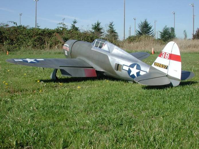

I have used the Dave Platt method with latex paint. After the latex has dried, use steel wool to wear down the paint. Instead of using solvents, I used Windex to wipe off the wash and create a faded and streaked appearance. The washes were created by thinning latex paint. I then clear coated the plane with Nelson Hobby flat clear. I did not have to contend with the toxic fumes form auto paint or the epoxy paint that Dave uses. This method has been used successfully by Top Gun contestant Roy Valliancourt and it is a heck of a lot cheaper than automotive paint. Plus you do not have to spend a small fortune on the equipment needed to spray automotive paint. Total cost to paint the 1/6 scale P-47 in the picture was around $35.

You have a nice looking model. I am confused however. I have been in the refinishing business for over 30 years and the spray guns for latex based and solvent based automotive paints are the same (with the possible exception of using a larger needle/tip combination for the latex). What is the price difference for automotive paint equipment you are referring to?
