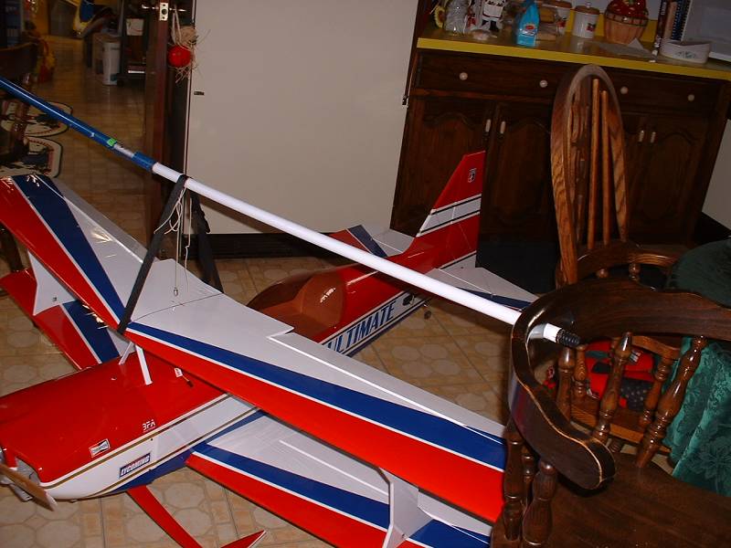

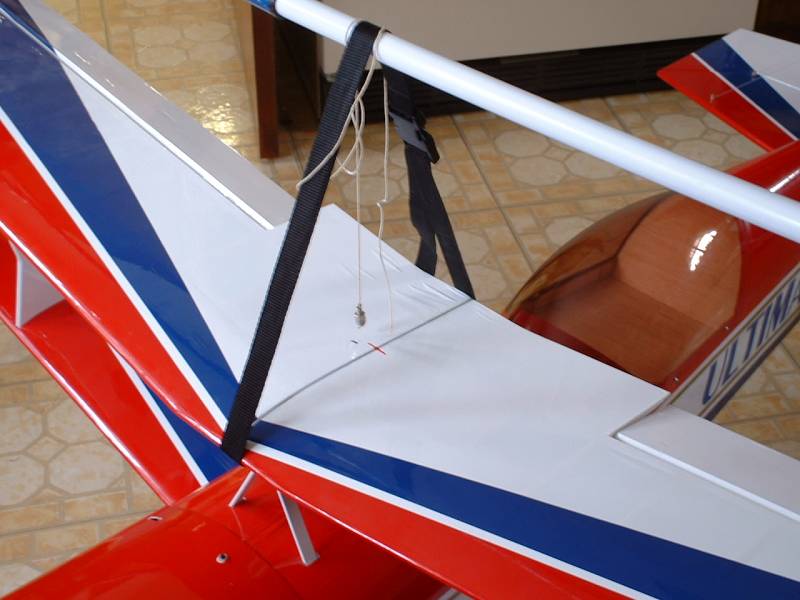

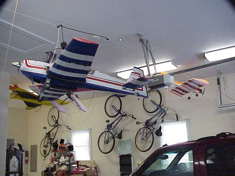

Here's my version of a similar setup, using nylon webbing "slings".... the really important part of using strings or slings is that one must adjust the airplane horizontally so that whatever the longitudinal "datum" reference line is - is parallel to the ground. That is the ONLY time the plumb bob will point to the real center of balance. If you set it up with nose slightly higher than actual reference, the bob will show "tail heavy".... get the tail a little high, and one could be in REAL trouble, 'cause the bob will show "nose heavy", and that could be ugly.
Pics show how I did my Ultimate bipe and a Goldberg Yak...

That was exactly my question earlier. The pointer will show the models cg but it will not show TRUE cg unless the model's datum line is level. Nose up, forward cg. Nose down, rearward cg.

ORIGINAL: tashley
What I actually said was:
ORIGINAL: krossk
Not quite - the plumb-bob will always point through the center of gravity, regardless of the plane's orientation. That is why it doesn't really matter how you suspend the model.
The true CG will not be located on surface of the model, but rather somewhere between the top and bottom surfaces. If you want to locate the projection of the CG on the top surface, then the datum line must be horizontal (perpendicular to the plumb line).
