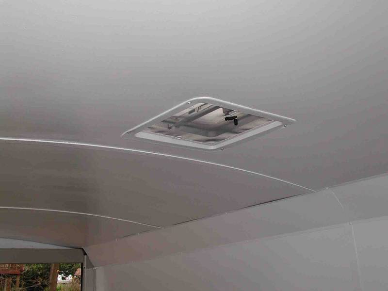

'dunno what they cost, but these are the vent in my 7'X16' V-nose. The side vents can be closed, open to exhaust, or open to intake (scoop); one vent in the right side front top, and one in the left side rear bottom. When towing, opening the front vent to scoop and the rear to exhaust provides a pretty good flow of air. For parked situations, open both side vents and the top vent keeps the trailer at or near ambient temperature.
The parts page is down right now, but the manufacturer's web site is : http://www.hortonvans.com/default.htm
You could also likely get the same items at a good trailer supply house.
Don't skimp on vents - the water and critters you keep _out_ might save your trailer.
