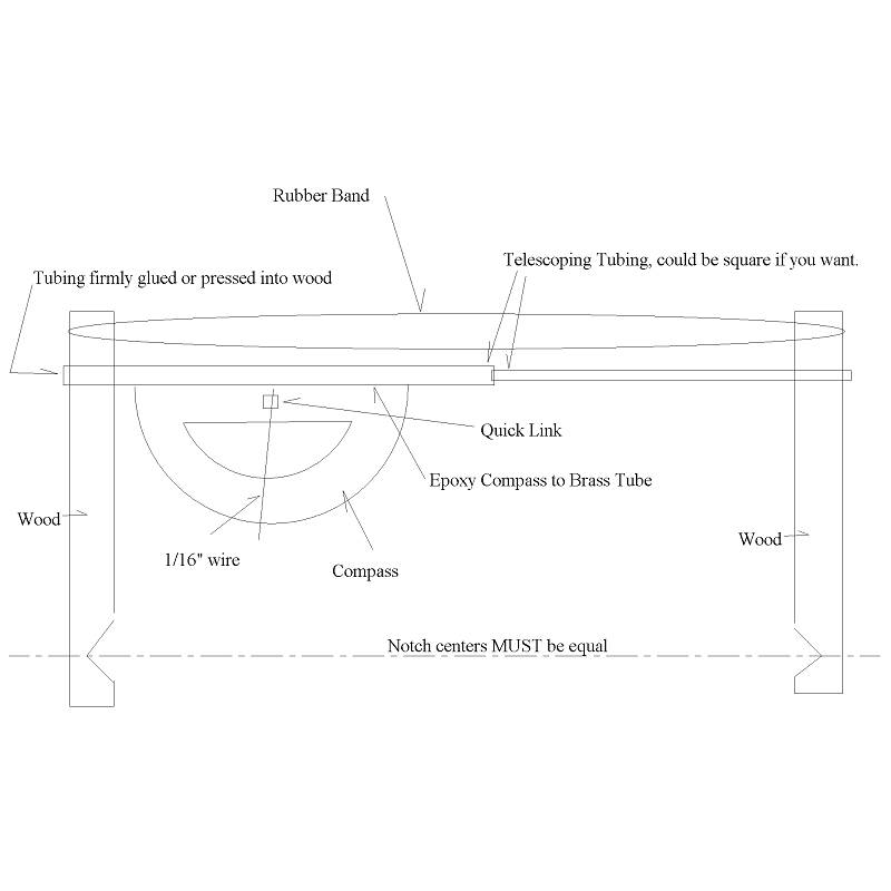

I make an incedence meter. Cost about $5. Just as accurate as the robart I have.
Edwin
