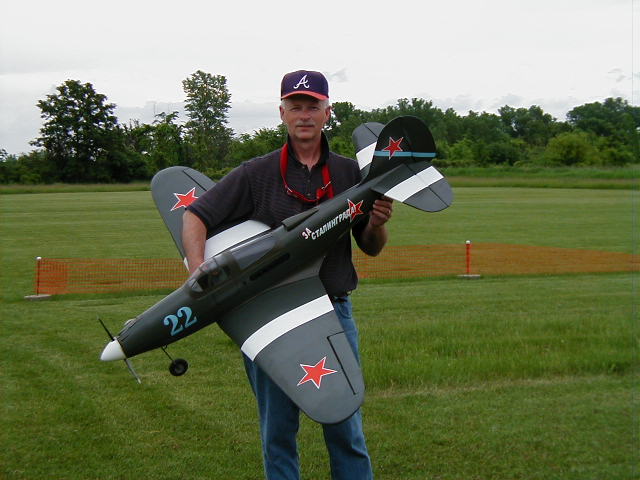

Default I Use It All Over
I use balsa rite for film under monokote. I use it all over the airplane (typically fully sheeted Top Flite warbirds). I apply it directly from the can (no thinning) using a foam brush. I give it a very light sanding to remove bumps after it's dried.
I iron the monokote down over the entire surface of the aircraft (not just the corners). I use about a 2/3 heat setting on the iron (not too hot, not too cool) with a sock.
The only time I've had bubbles is when I applied a lot of heat GUN heat, so I don't do that anymore. I shrink as I go using the iron, and the stuff holds the monokote like it's welded on. I fly my airplanes all the time, and none of the monokote comes loose like it did before I started using the balsarite. I don't like to "glass and paint" so I try to use monokote for all my colors and trim. I'm attaching a picture of my TF P-39 which has been flying for 3 years, and which has not had a smidgen of let go.
I agree with an earlier post that it's difficult to get it off the airplane, but it seems to me that that's the point-keeping the covering on the airplane.

what a beauty dhable ! I think it's also important to let balsarite dry or cure fully before putting any covering on. any residual solvent may cause bubbling during heating or under hot sun. that's why a thin layer is better.
