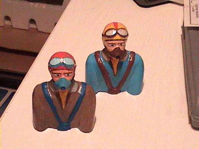

Default painting a hangar 9 pilot
Make sure you scrub the pilot in soap and water after you cut the little deformities off from when they molded it. Also cut your pilot to fit your plane if need be before you start painting. Cotton, fiber fill works really well for stuffing the pilot (it should have come with some already in it), but you always have to add some so that the pilot will keep its shape. Cut a styrofoam base that will fit inside of the pilot's body .Glue the pilot to it and then glue this base to your plane. Latex paint works well. Always paint the lighter colors first that way if you mess up, it's easier to cover with the next darker shade. If you need more information, let me know. I paint around 400 of these a year.
Roy

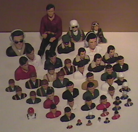

Default my modest fiberglass pilots!
check them out!
