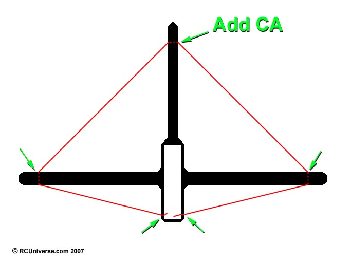

I've herd about useing weed eater line for a stabilizer guy. But I've never made a guy before. Help?

Just drill holes through the Stab, Fin, and fuse, run the line from the fuse, through the stab, rudder, other stab and back into the fuse.
Secure all joints with CA (If you can manage a knot on the ends, so much the better)
