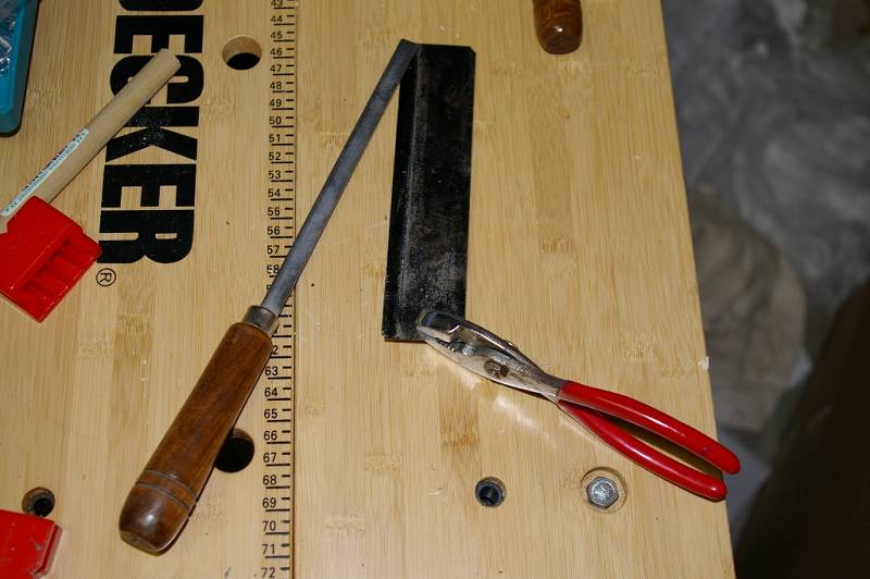

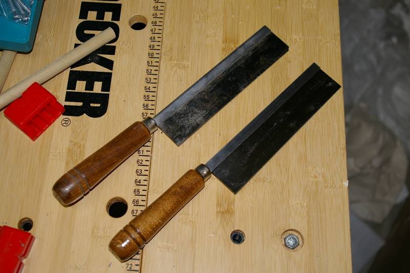

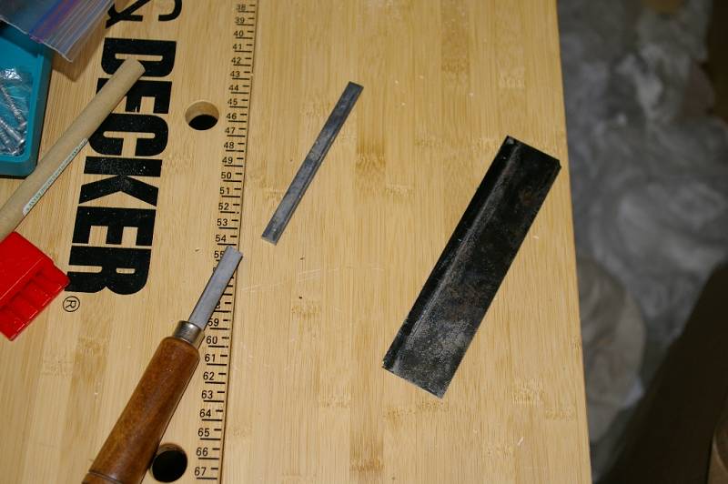

This is what I do to my old Zona razor saws when I get a new one.
Remove the blade (it'll pull out with some pliers no problem)
cut the back brace down to 2-3 inches long
re-insert the blade backwards and solder it into whats left of the back brace.
You now have a flexible flush cut pull saw.
I can post pics later if you want.

Old 03-13-2007 | 12:46 AM
sscherin's Avatar
Joined: Aug 2005
Posts: 1,152
From: Eugene, Or
Default RE: Flush Cutting Saw
OK 4 pics..
I couldn't find my modified saw but I did dig up an old spare to I hacked it up for ya
I didn't solder the blade to the handle yet but you'll get the idea.
pic 1 new and old saw
pic 2. remove the blade
pic 3 hack the back brace off with a hack saw and file the burs off.
pic 4 insert the blade backwards and enjoy your new flexi pull saw.

ORIGINAL: sscherin
OK 4 pics..
Sweat!! Thank you very much.
